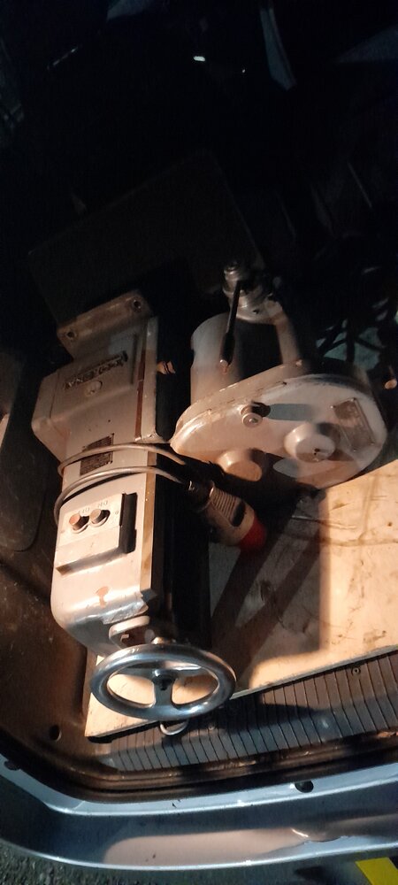

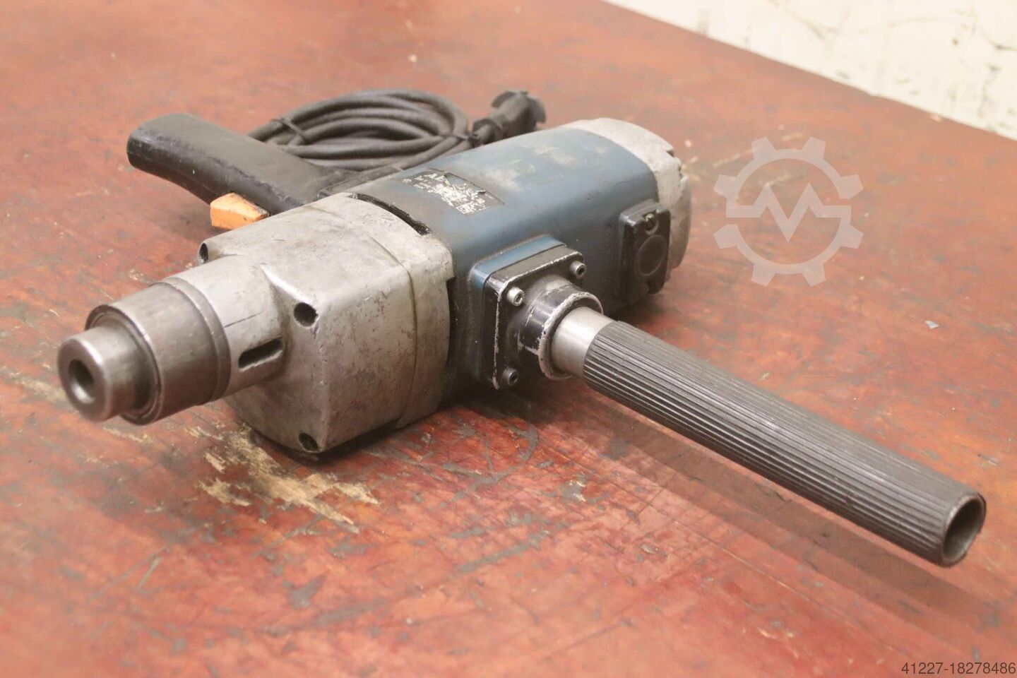

Anyways I've got one of those Stihl 25" rollomatic es light bar in used but still good conditions, for 10 euro
And I've gave up and got another masculine drill for 20 euro
AEG BZ22 Morse taper 2, no mechanical gearbox, just fixed gear and 2 electric speeds selector.
It has what looks like a 15 or 16mm morse taper drill was worth the price by itself.
I've decided to disassemble it for checking it's conditions because of the cracked plastic motor housing but I've discovered it's just a cover layer on the aluminum housing beneath.
Problem is that I cannot remove it because it's part of the brush holders.
Otherwise I would have completely removed it .
Anyways it looks brand new inside so there would be a restoration video about it.
It has some serious and chunky gears in it, almost 30mm thick.

From the looks of it that's a very good candidate turn into an entirely reasonable milling machine, as long as it will accommodate you adding a drawbar to the quill (which is normally the biggest limitation on drill to mill-drill projects).
Looks more like a boring drill than a bench drill
It's a high speed drill. I like the built in z axis plus quill feed, which could simplify a conversion. It actually reminds me of an unusual mill that I used to own that also shared more than a passing resemblance to a boring machine.Looks more like a boring drill than a bench drill
I've already got a mill with a 40 int spindle but I wouldn't mind something a bit lighter and quieter for smaller jobs late in the evening. If I can manage to convert this for a reasonable price I think it could be worth keeping. Like I said earlier I didn't pay much for it.Bearing King have started selling Chinese bearings as "own brand", by basically doing QA on them on import to check that they're in spec.
I have no doubt that they getting "the good batches" from the same manufacturers who are also supplying the fakers.
At the end of the day, a decent proportion of the fake bearings are basically indistinguishable from the real thing, it's just that being fake there's no consistency to the QA so no guarantees that your particular bearing will hold up as it should which can really matter for some applications.
If it's only running in deep groove ball bearings those may not hold up too well to milling, but it's very likely that you could find appropriately sized angular contact or taper roller bearings to replace the existing ones when they fail (or preemptively).
The runout may not end up being as good as a "real" mill (unless you spend roughly "one used Bridgeport worth" on a matched set of bearings), but it would probably be more than good enough to complement the accuracy of an inexpensive X-Y table.
This is the old mill that reminds me of today's purchase.It's a high speed drill. I like the built in z axis plus quill feed, which could simplify a conversion. It actually reminds me of an unusual mill that I used to own that also shared more than a passing resemblance to a boring machine.
Owning a mill will inevitably make it much easier to build another one!I've already got a mill with a 40 int spindle but I wouldn't mind something a bit lighter and quieter for smaller jobs late in the evening. If I can manage to convert this for a reasonable price I think it could be worth keeping. Like I said earlier I didn't pay much for it.
