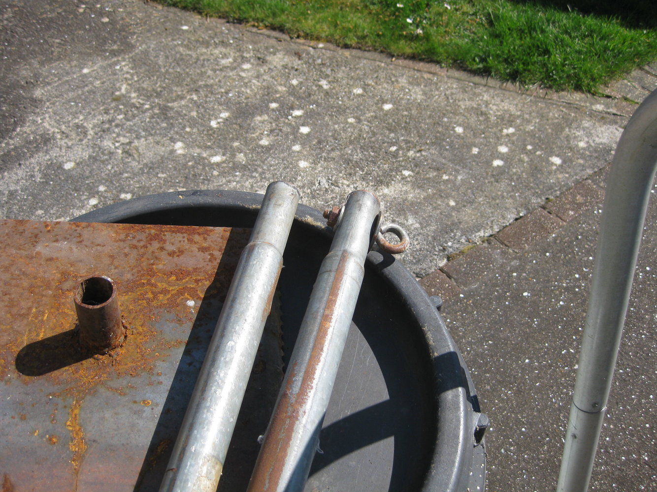

I've had a beer, any chance of a photo?

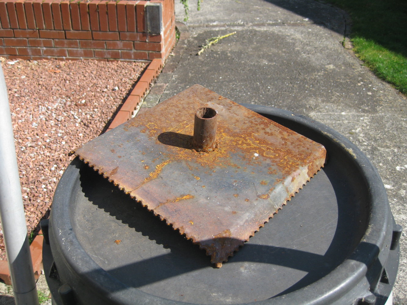

The old oil boiler heat exchanger plate .

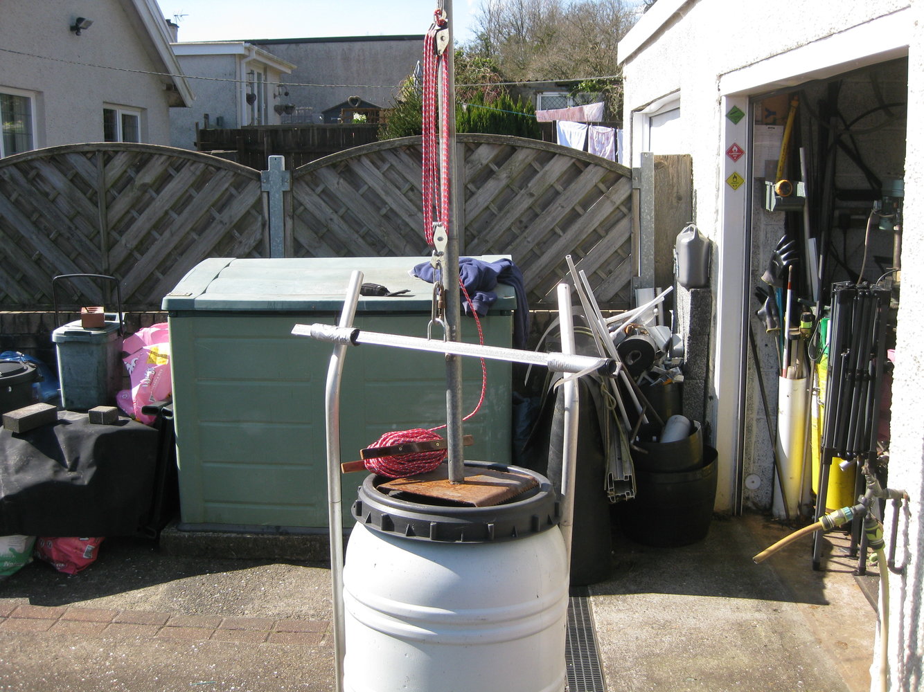

Two of the inter locking tubes one with the lifting eye . Note the open end is uppermost just incase it opened up a tad when I had a 6x 5 fence panel six foot up off the & floor blowing in the wind .
Excuse the mess I'm have a couple of mancupboard clearing days .. ( first time in 3 or more years ) .
I picked out the tubes & bits as I came to them
It's only set up with two vertical tubes .. The highest I've had them is nine tubes from floor plate to the top pulley hook /eye with my wife inserting the extra ones whilst I was on a strong stepladders holding the others together & lifting at the same time . The spreader bar is attached to the fence panel with 200 kg cheap ratchet straps , the pulley set is able to handle 250 kg ( IIRC £6.00 Amazon ) The line surprised me I was thinking that the 30 mtr hank would be cheap Chinese rubbish .. was very pleasantly surprised to find the internals were thousands of fine twisted fibres instead to the chines low budget stuff of a similar diameter that has a four inch wide random weave fabric & separates at about 90 kg . core inside the outer case.
As I said in the earlier post , I used a pair of 9 inch G clamps to hold a lashing bar to which the vertical poles are lashed centrally to prevent kick out at the bottom or falling out at the top or slipping sideways .
One lashing bar at the top of the posts and one at the base on the same side ( my panels sit on engineering bricks set on a cast in concrete cill betwen the concrete H section fencing posts ........stops weeds from next door , allow small creatures to move from garden to garden. Also to allow wind to blow over & under the panels to stop strong winds simply ripping them out of the H section posts .
I put the insulation sleeve over some 3 inch rain ware plastic tube so the protectors can be slid along the spreader bar for other liftings , It also helped stop the ratchet straps sliding off before I'd got them tightened.
