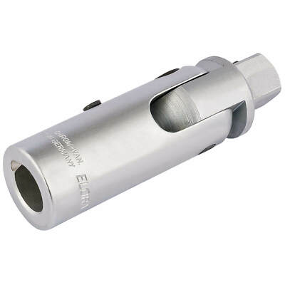

Last week I broke 3/4 ratchet 3/4breaker bar 1/2" breaker bar

That breaker bar is old school Britool! it didn’t break where I welded it,only on the swivel.The T bar is elora,a few of you aren’t looking closely.

I often break 1/2" breaker bars.
Never broke a 3/4 one - I got two Elora breaker bar heads - both have 30" handles I made up from bright mild steel round bar.

The so called breaker bar is in fact a half universal joint device called a " Swingle or nut spinner " it is simply meant to screw on ( or take off ) nuts using a socket to the point where putting them on you start to need a stronger T bar & extension prior to using a torque wrench to correctly finally tighten the nutsThe "t" bar and the short extension are made by Cadbury`s, the breaker bar looks like the pin has walked, that's normally what breaks off a lug like that.

Yep, that’s what I think. Remedy is to buy better tools. Over the years I have ‘spiralled’ nondescript 1/2” socket extensions, but never a Britool one, with a 300Nm torque wrench.
Probably not the same quality these days - all mine were bought back when Britool was Britool! I don’t use cheap sockets, either, if the job is demanding.
