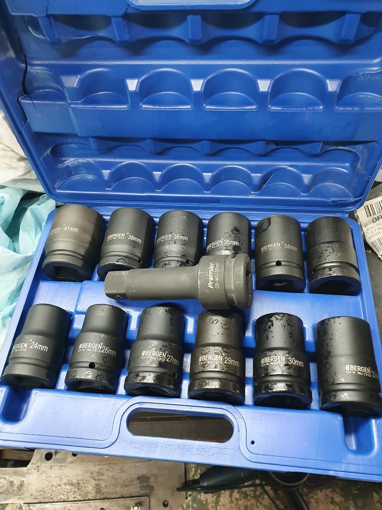

My 350Nm torque wrench is 1/2" drive so I don't think that is correct.Mostly, over 200Nm calls for the 3/4” socket set, but I don’t think mine start until 22mm?
Yes I have a 330Nm 1/2 torque wrenchMy 350Nm torque wrench is 1/2" drive so I don't think that is correct.
Not with a rattle gun, I hope.Tightened to 200 would likely require a good excess, over that torque, to free it off. Mostly, over 200Nm calls for the 3/4” socket set, but I don’t think mine start until 22mm?

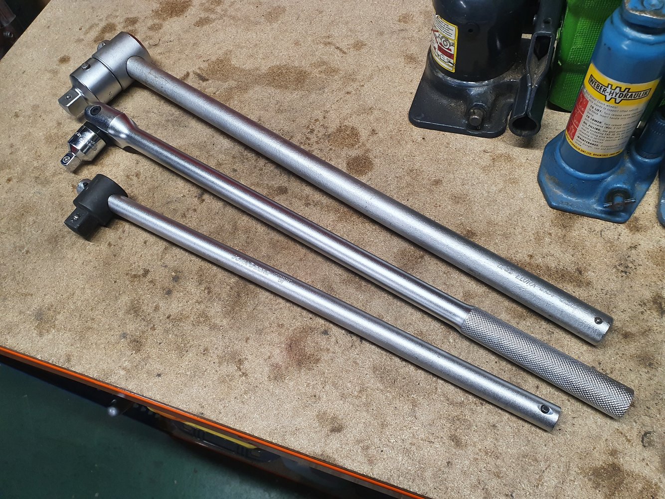

I don't like to use extensions (between socket and wrench) at the top end of the torque range, either - and never use pipe extensions on breaker bars. Getting a bigger breaker bar is the answer to that problem.
You have obviously never had to undo any trailer wheel nuts that haven't been moved in 30 years then. I have a 5ft 1" drive breaker bar and sometimes have a 8ft pipe over it.- and never use pipe extensions on breaker bars. Getting a bigger breaker bar is the answer to that problem.

It keeps manufacturers busy making new 1/2" breaker bars![]()
