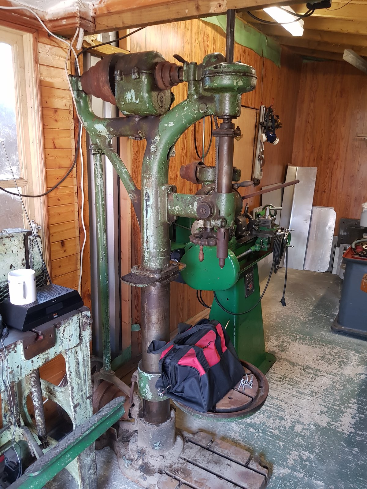

Here is mine. Before the workshop turned in to a nightmare
Here is mine. Before the workshop turned in to a nightmare View attachment 203350 View attachment 203351

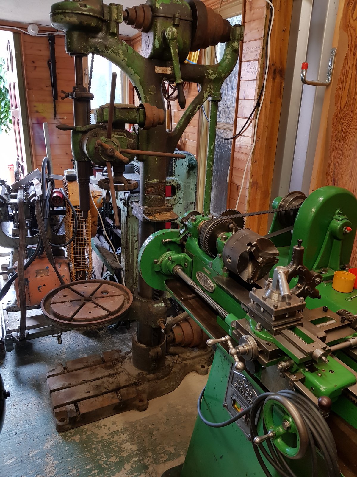

My one is back geared.Oh yes - virtually identical. Is the top gearbox a back gear or a planetary gear set? I’ve seen both on these types of drill, mine has a back gear which heavily reduces speeds by about 5:1.

What's wrong with the trailer?
Nothing 'wrong' as such. Just looks a bit lightweight to be putting 750kg on. Doesn't look like it's braked either so if the drill weighs 750kg it's definitely above the legal limit for an unbraked trailer. It's also right at the front so I imagine the nose weight is considerably more than allowed too!

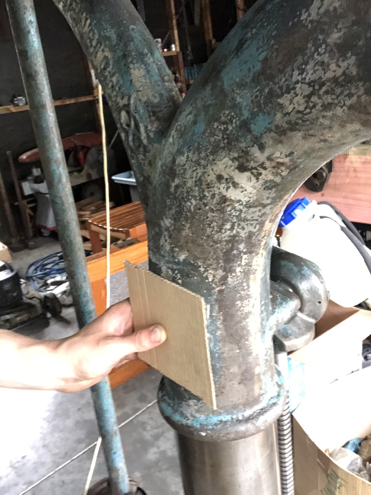

Hard to tell what the original colour is by you photos. Best place to look would be underneath the base casting or under the switch box, less chance of being faded by the sun.
Try this site to find the correct RAL colour for your drill & get it mixed to suit.
https://www.e-paint.co.uk/RAL_Colourchart.asp
My machine, my choice - after all I’ll have to look at it all day
The correct colour is a blue grey. I don’t really mind though, I paint things the colour I likeMy machine, my choice - after all I’ll have to look at it all day

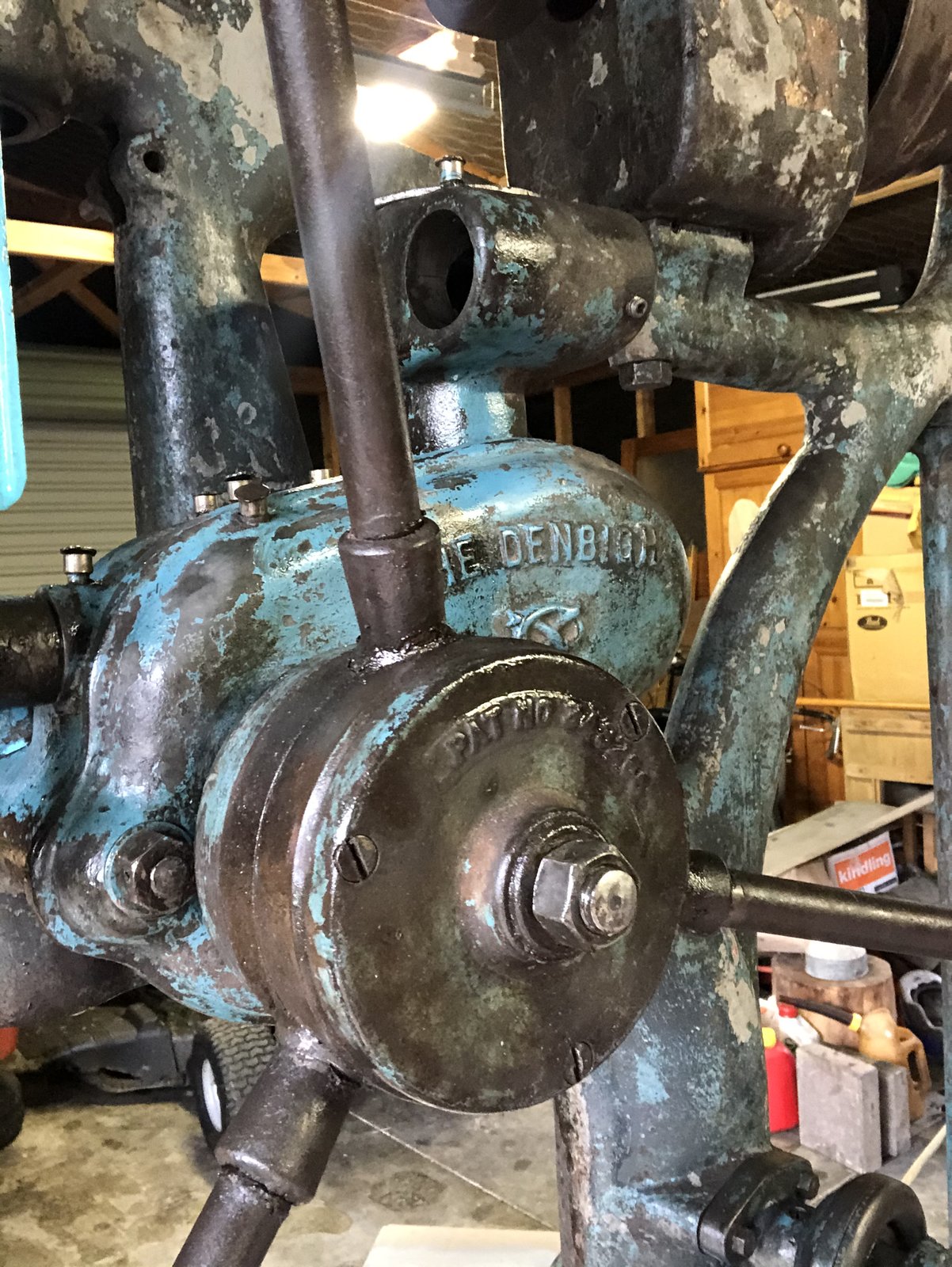

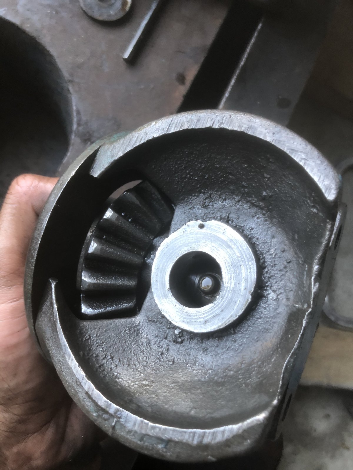

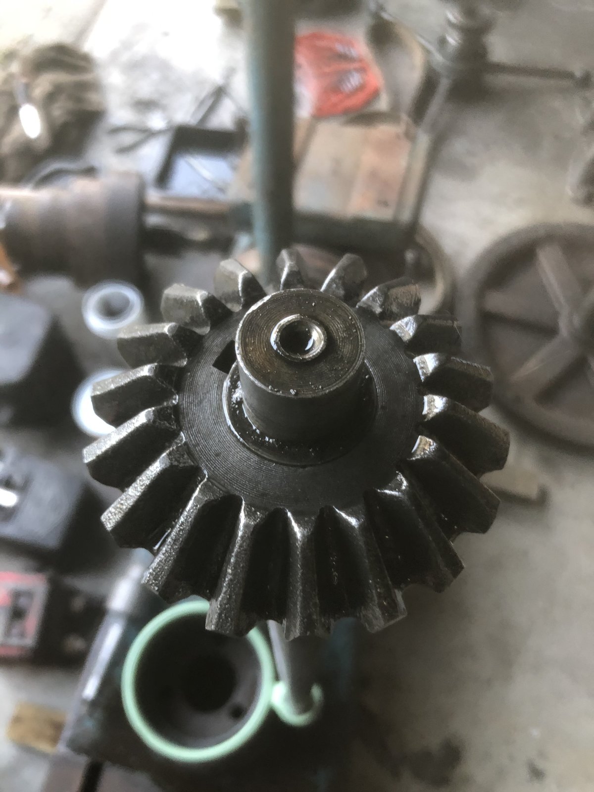

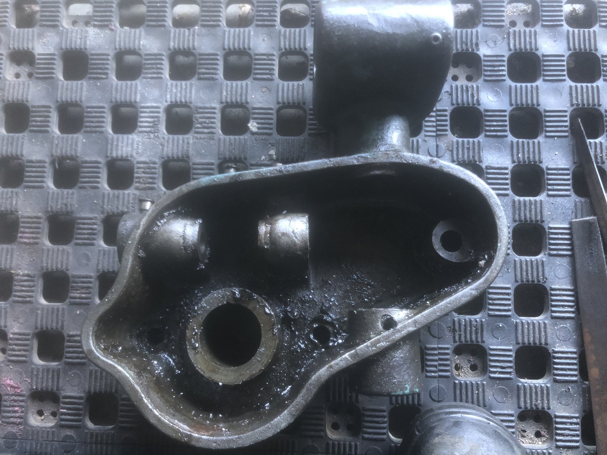

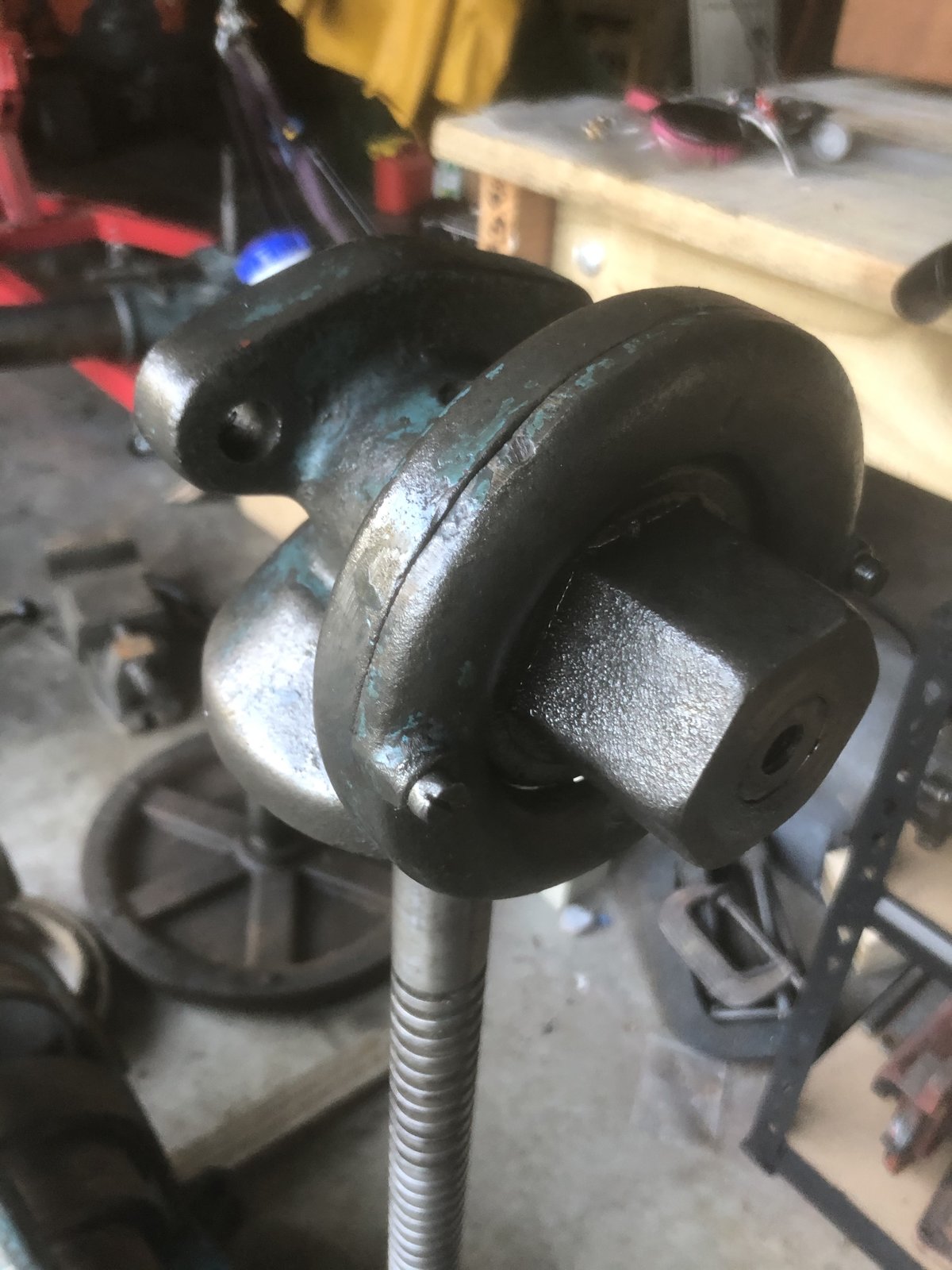

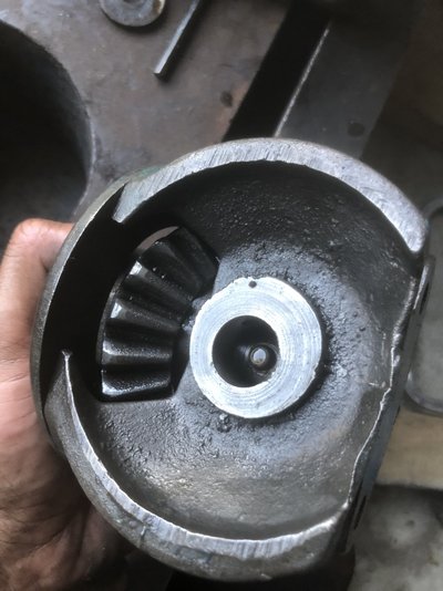

Today I cleaned up the internals of the skew gear which controls the table rise/fall. It was full of grease and was turning very slowly. The gears were painted too - not sure why this had been done, was the light blue repaint not original. Now it is degreased, oiled and works like a dream.

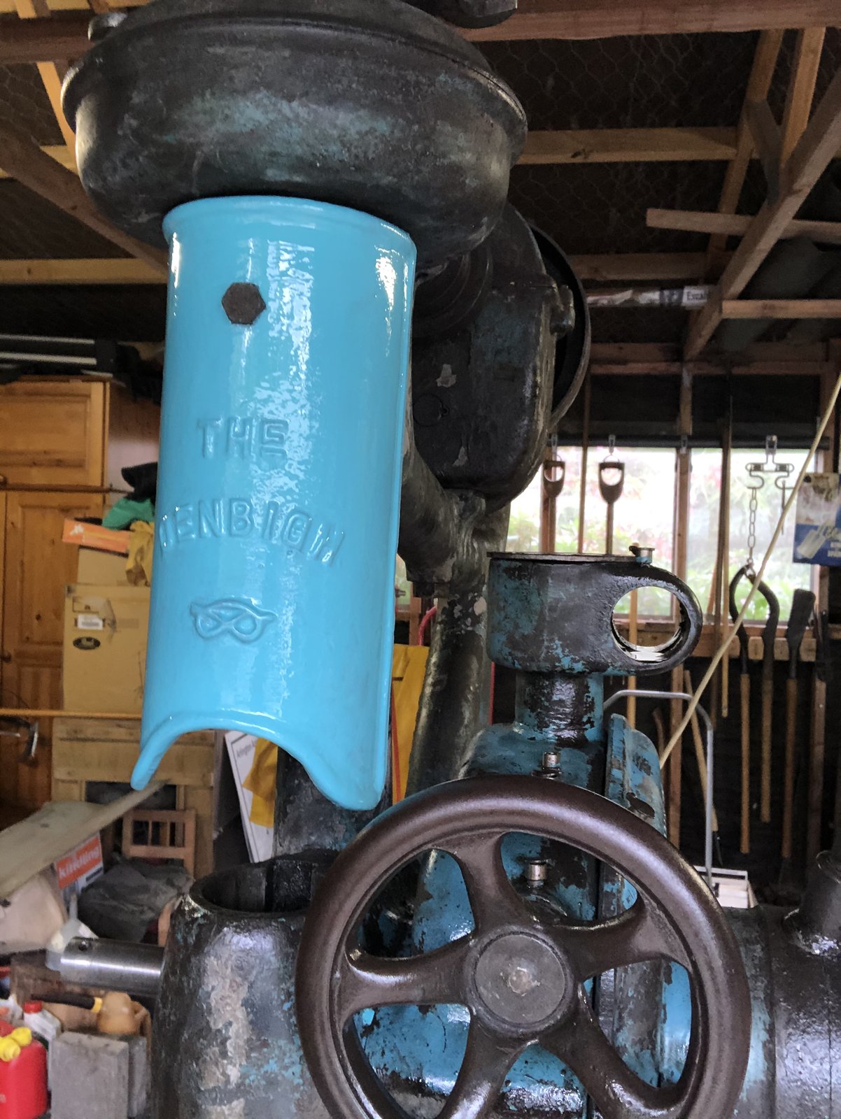

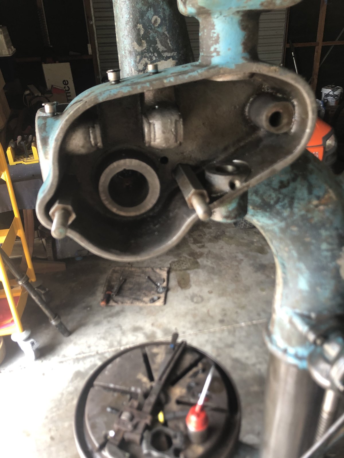

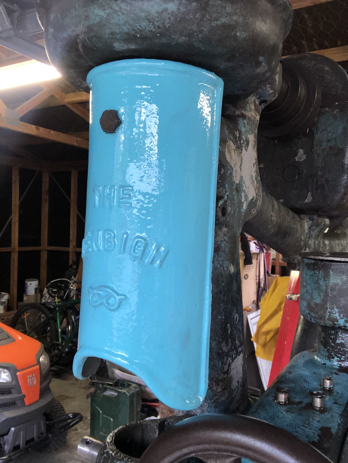

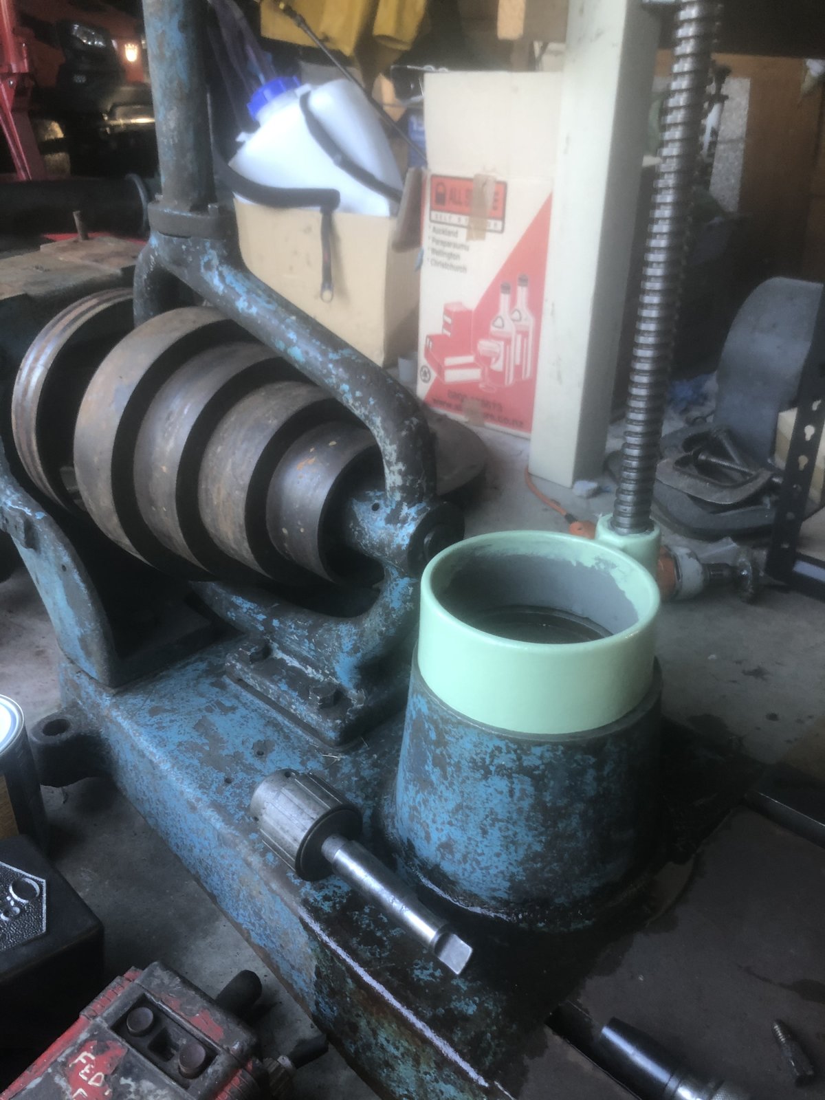

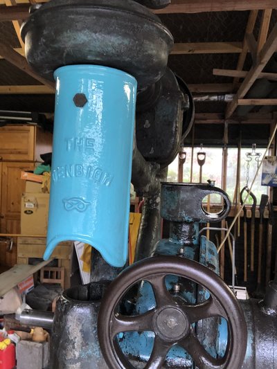

Some images of progress. I chose a different colour paint, and reassembled the automatic feed gearbox. It’s simpler to have it all back together and complete than in a box, for both space saving and memory issues! I love the new colour, can’t wait to pick the lettering out (:
