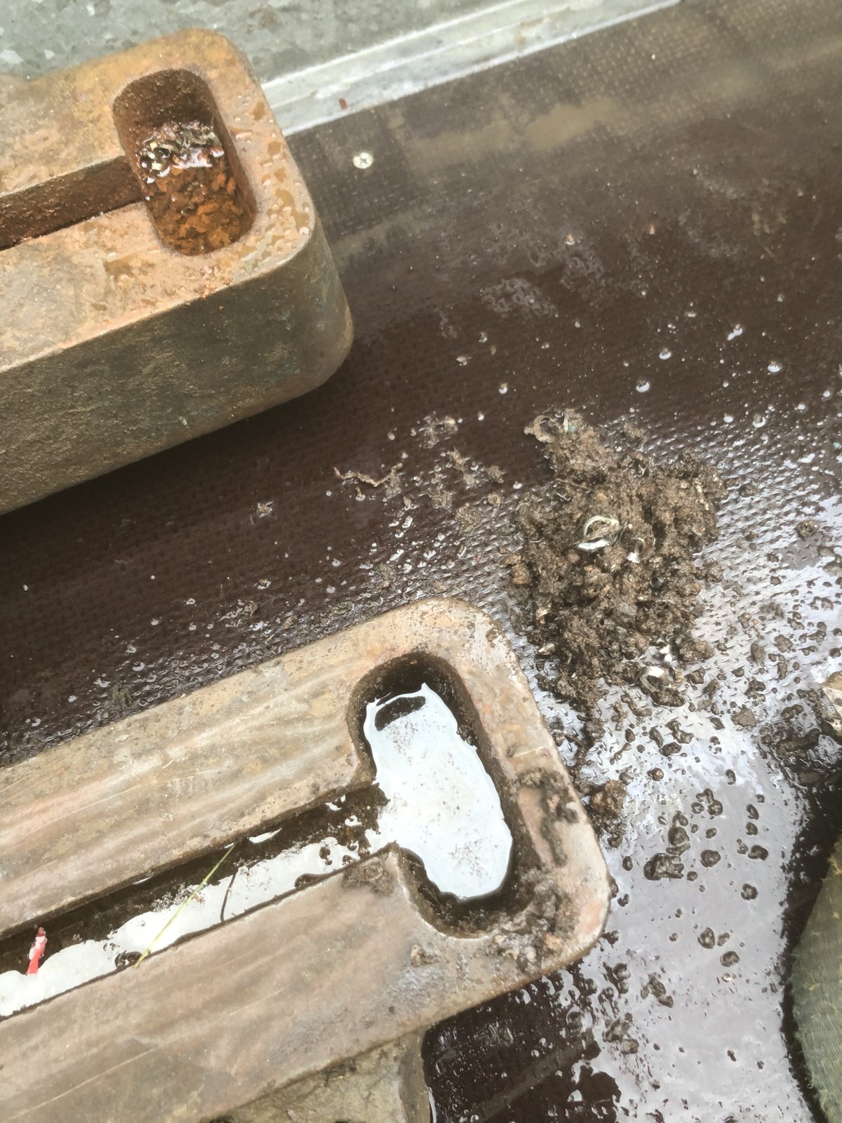

    And that’s a wrap for today.

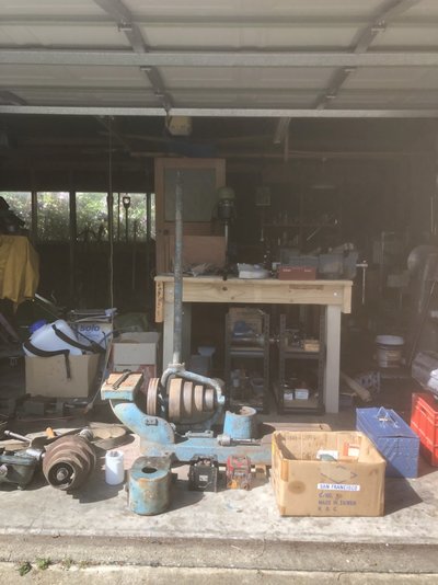

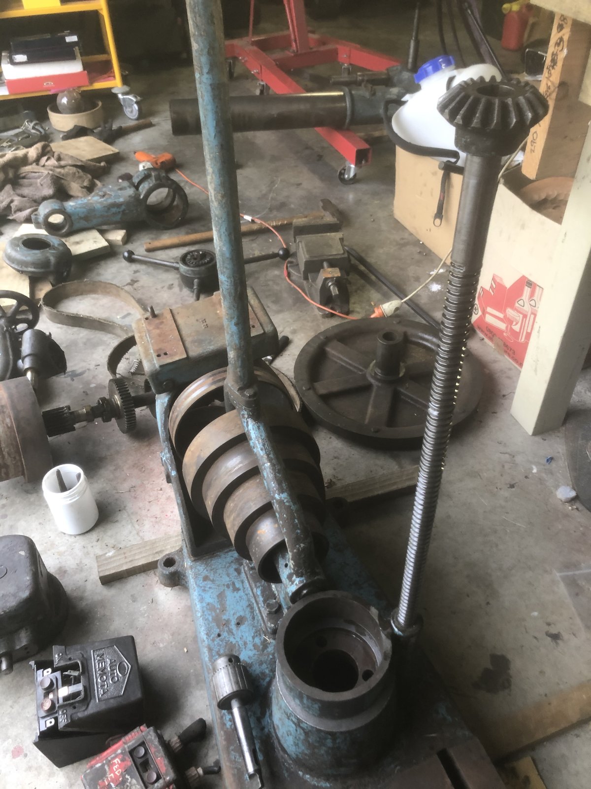

    Home and waterblasted the main components, that’s looking much better. Cleaned out the T slots, put the motor bracket on, separated the belt and blasted the pulley cone before reattaching it. Can’t wait to refit the column!

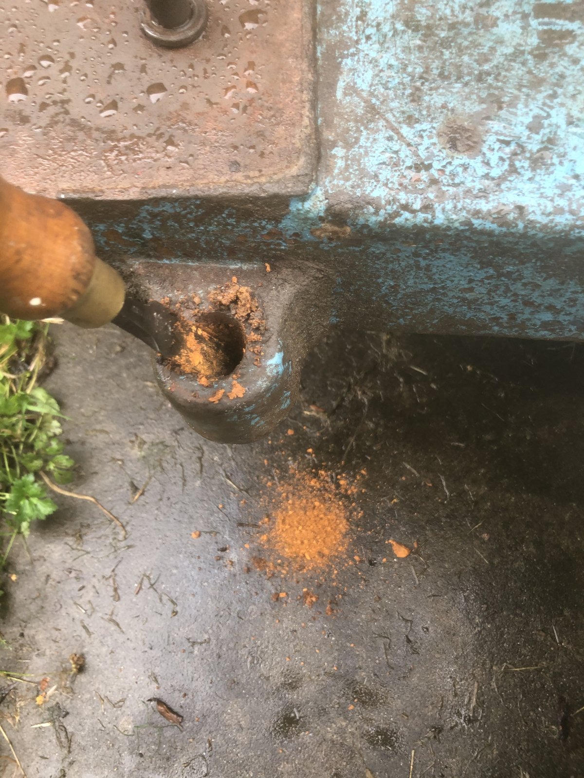

    Whilst cleaning I managed to find some rich iron deposits. Unfortunately they were on the machine! The mounting lugs were full of caked rust and grease. The T slots were full of grease and swarf. All of it came out in the end though.
    I love wet days as they’re ideal for waterblasting. Outside my house a small river forms in heavy rain, and I spotted these happy ducks playing in it!

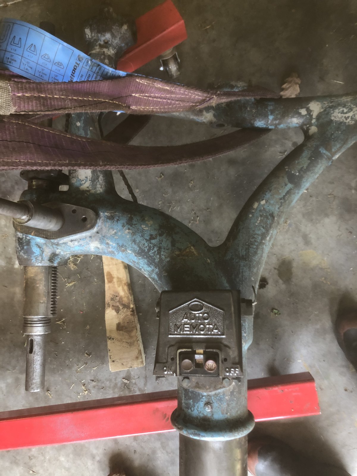

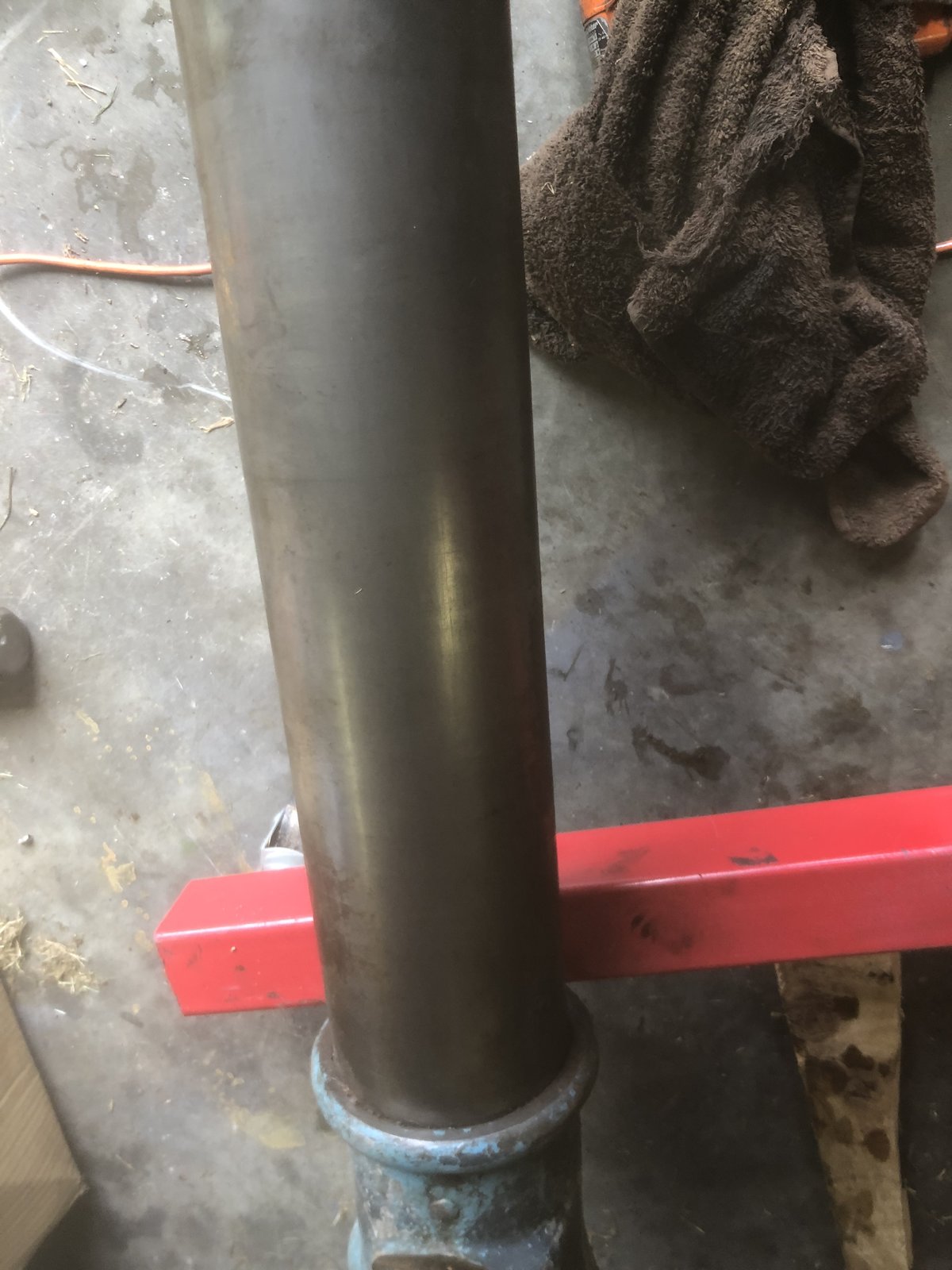

    Getting the table bracket off the column was tough. It’s been repainted once and had been done in situ, probably never been apart before. Lots of oil, twisting with a wooden handle through the eye, and finally a vertical raise with some wooden-plank-protected love taps from a 6lb hammer and it was free.
    The column looks in great shape, and that should polish up nicely. I want the bracket repainted and back on the column before I mate the column to the drill base again. It will save time in the future.
    The switch I have looks a good fit on the machine, nice and early c20. I’m still undecided on the colour for it, Denbigh drills were originally a blue/grey but I might go crazy yet :D

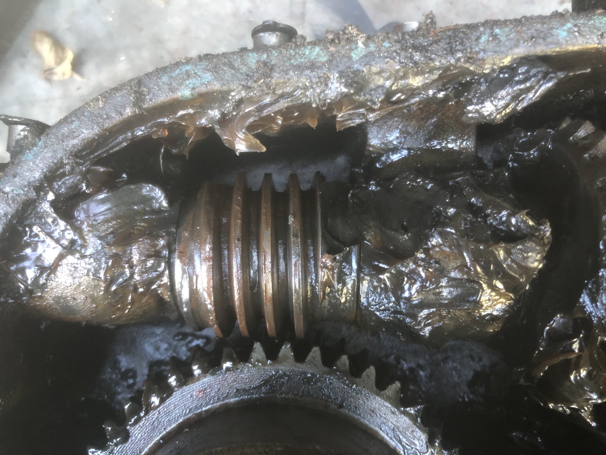

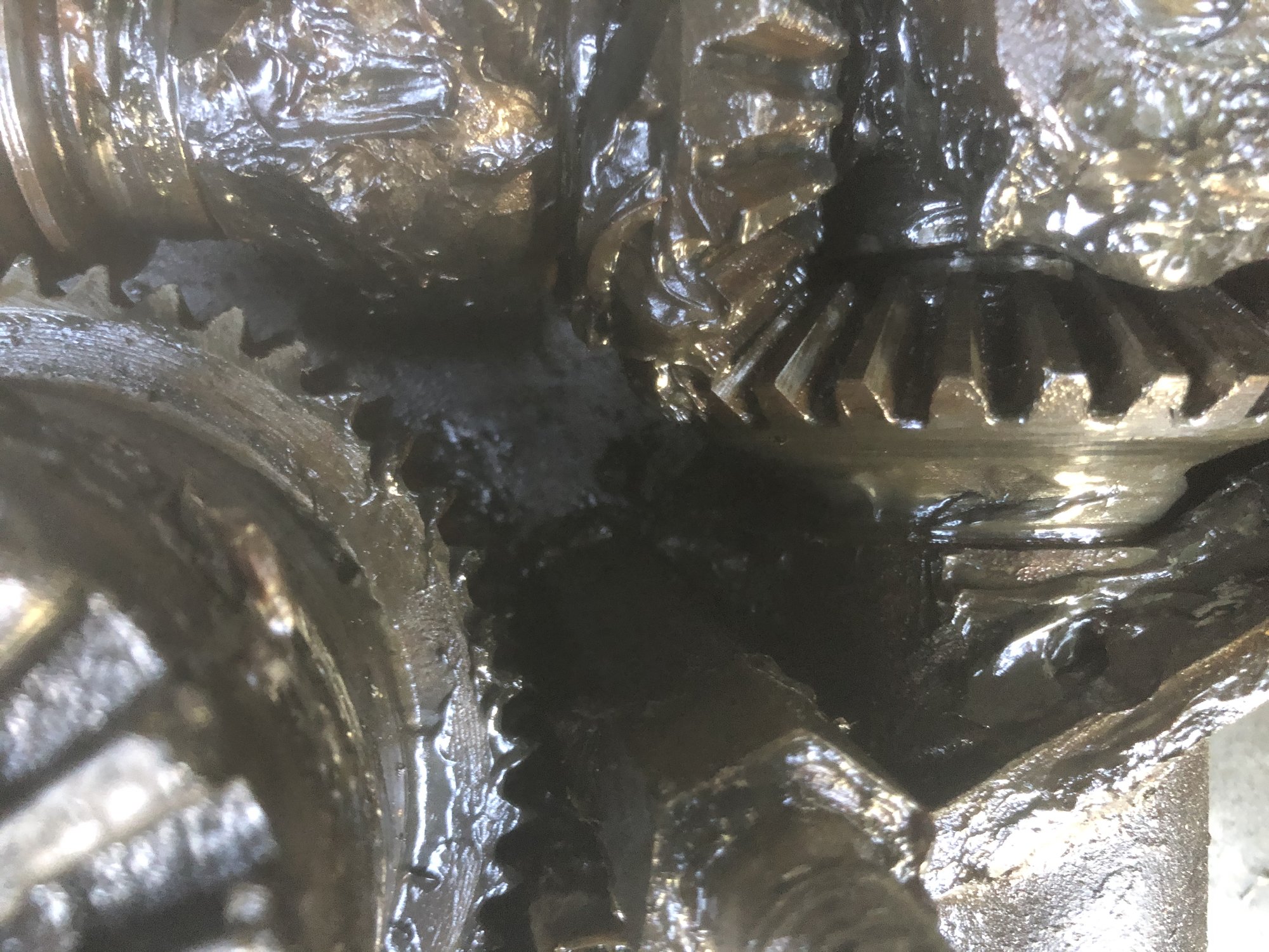

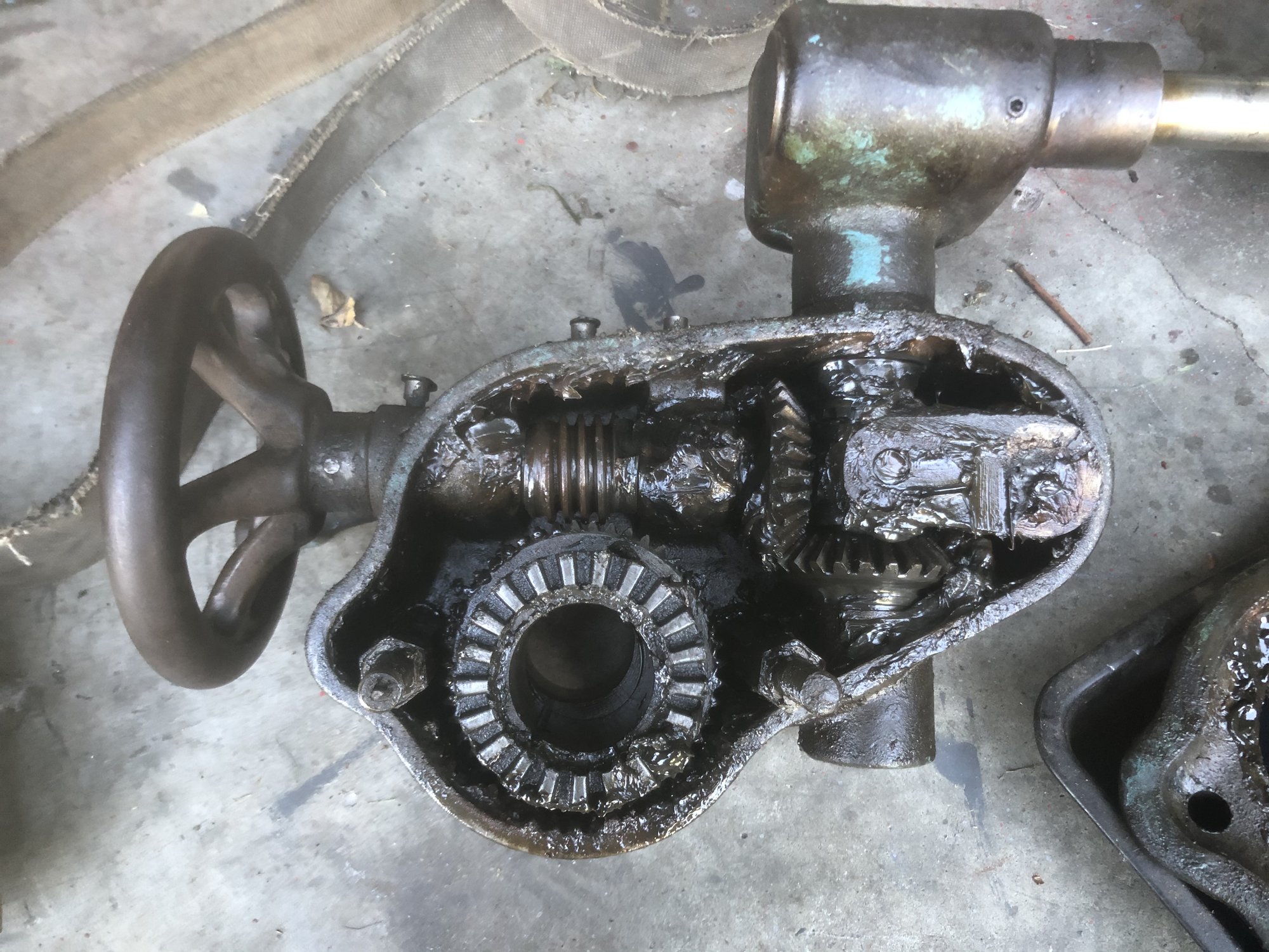

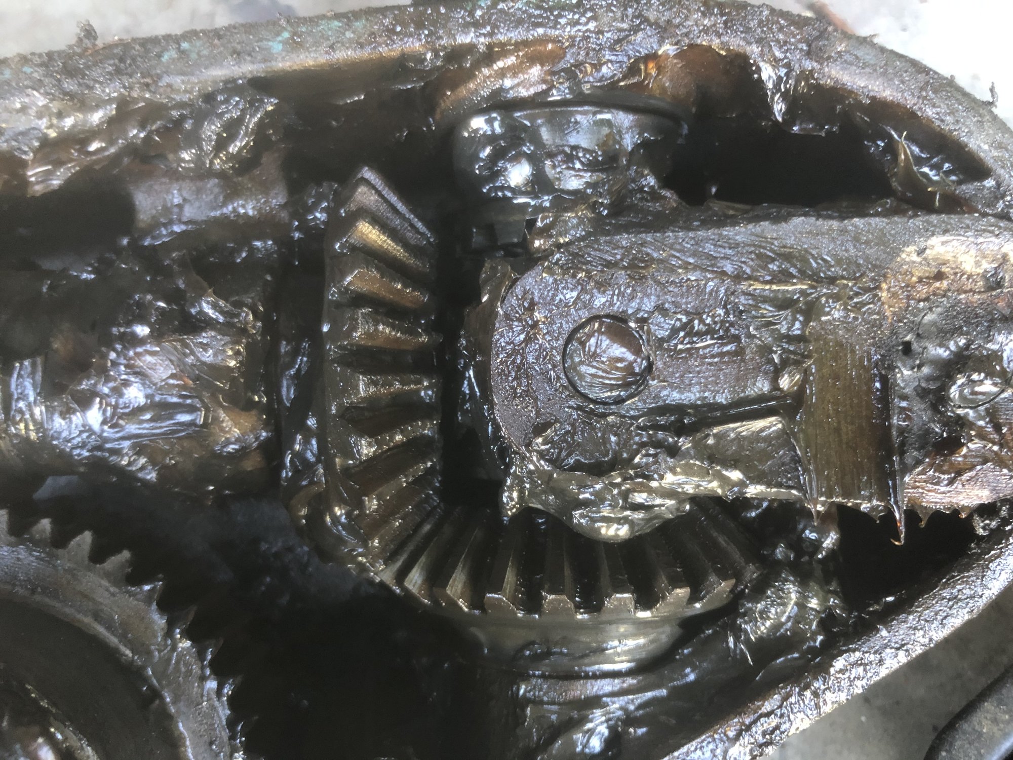

    So I decided to have a look in the power feed box. Wow. This is a complete mess. It’s meant to be oiled so no grease at all, there’s rust here too, so the grease didn’t even preserve much. They really slathered it in. On the plus side, the splines of the dog clutches function well. No restoration is complete without a ball bearing firing across the room, in this case I caught the ball but the spring is m.i.a.

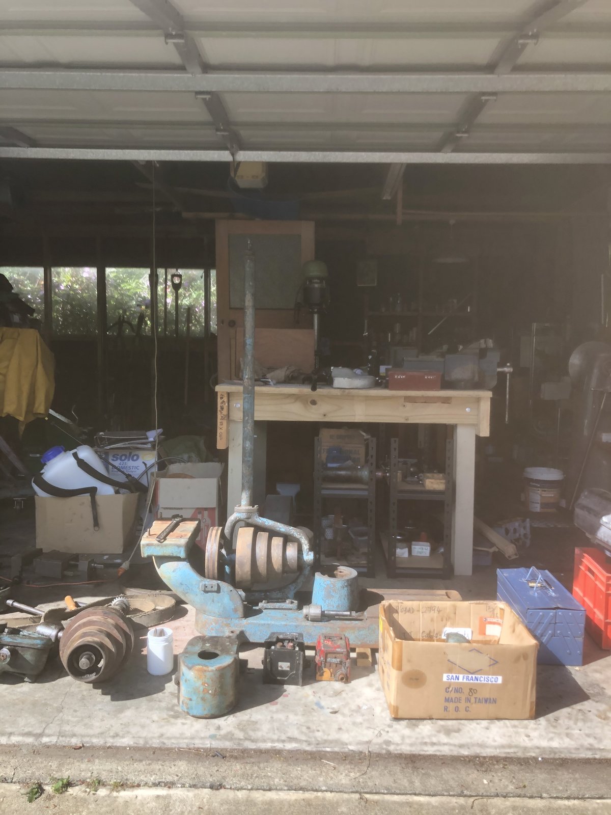

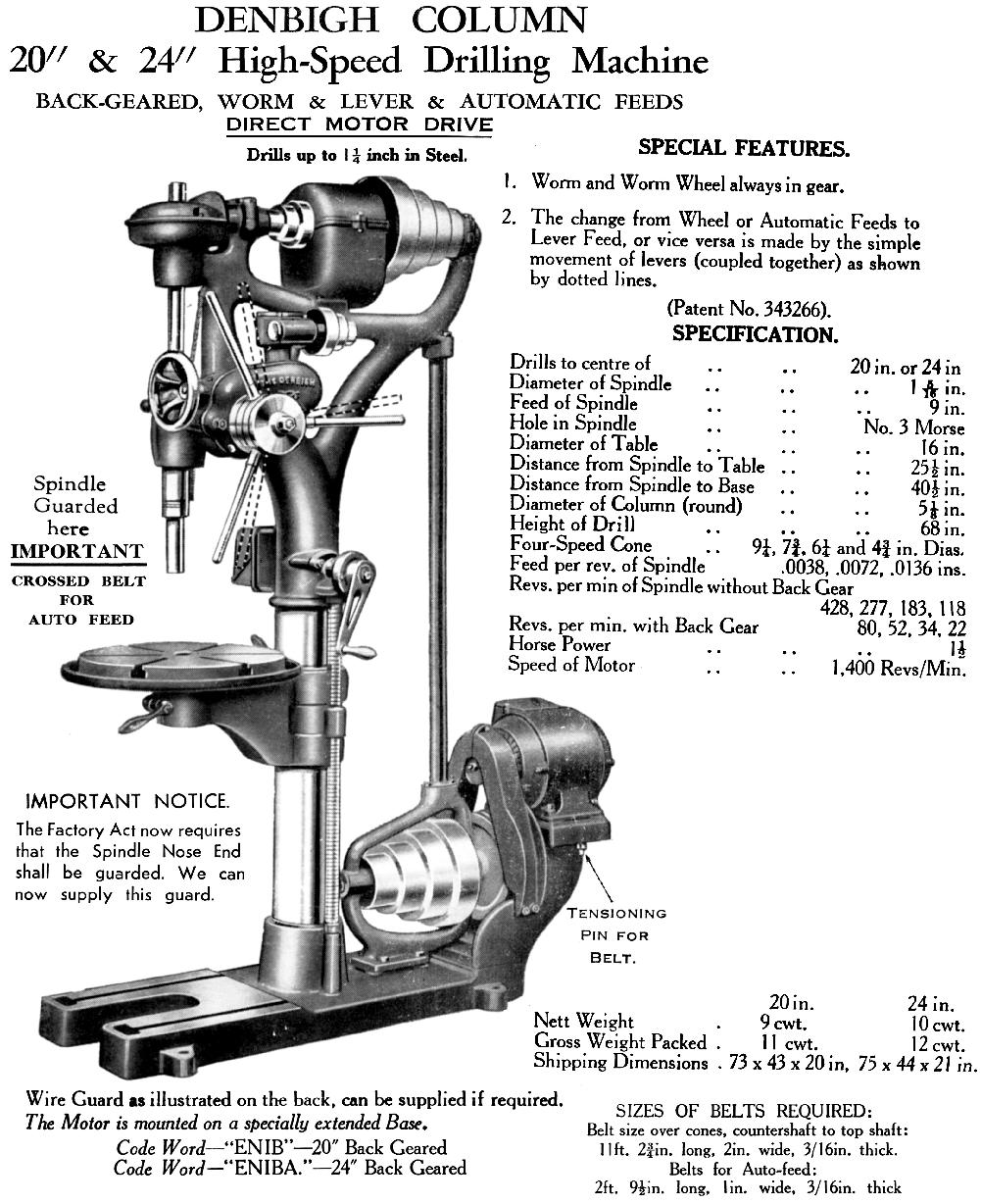

    Similar but not my drill. Mine has an acme raising mechanism whereas that one has a screwed on rack.
    This is mine

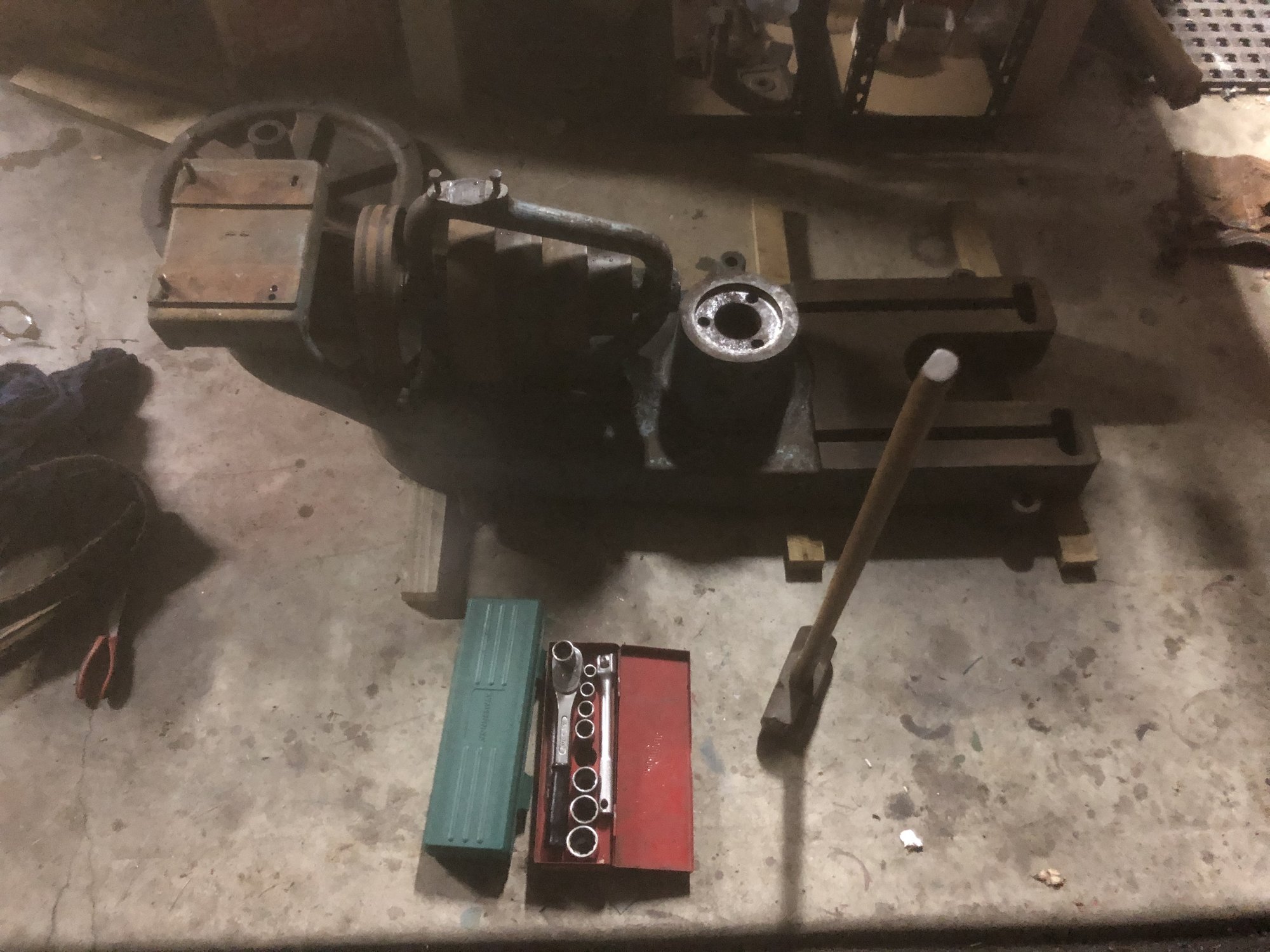

    The first job is stripping the paint on both the table bracket and table rise casting. Once these are primed and repainted, I can mate the column back to the base. This will consolidate the restoration process and stop the garage being filled with iron!
