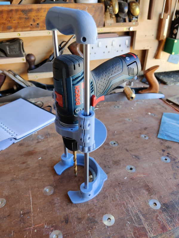

You may have seen this already on the metal ones sold for corded drills with a standard 43mm collar, but they show a use case with the rods projecting though the base plate, which is useful for drilling a hole centred on a piece of timber (e.g. mortice a door).Which turned into this perpendicular drilling jig:

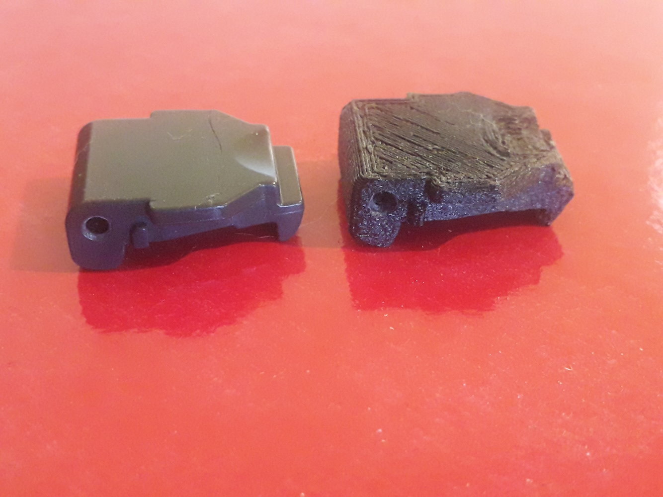

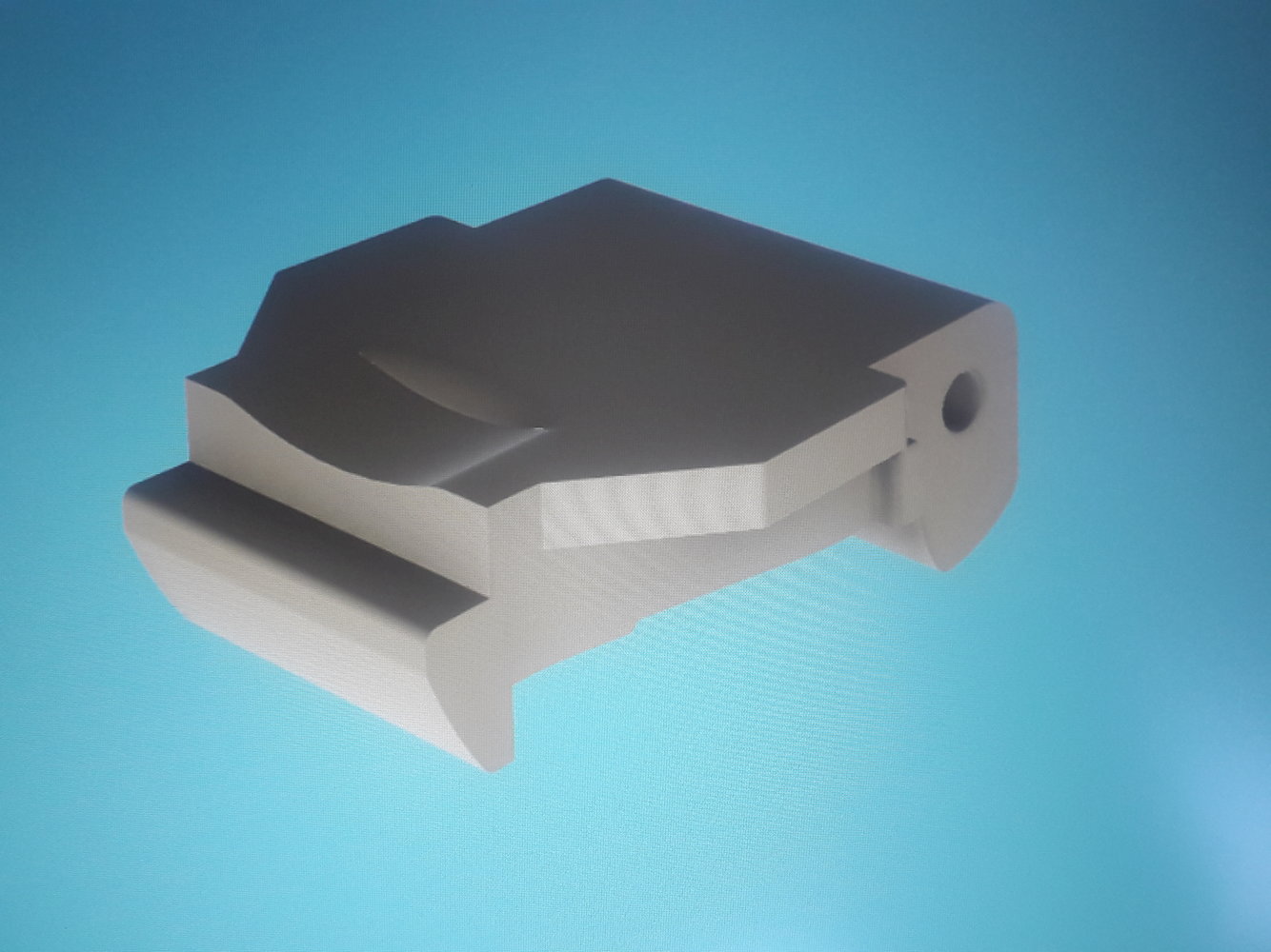

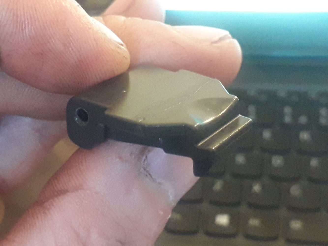

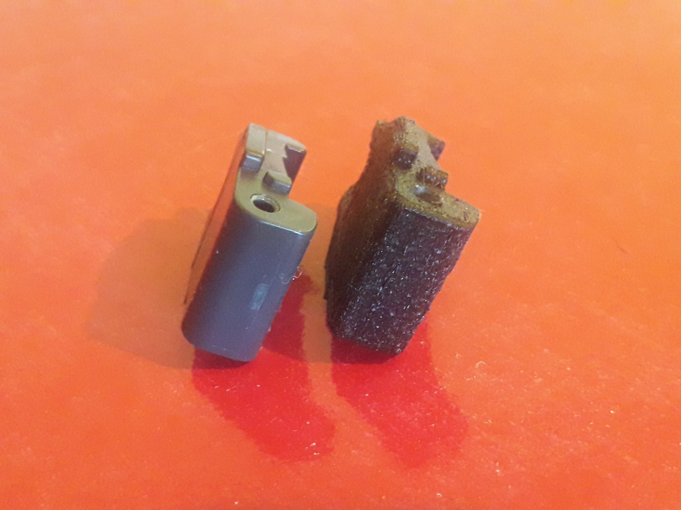

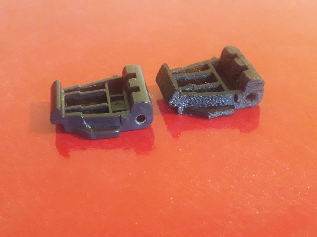

Very nice print. What material?Dads underwater camera housing snapped its retaining clip.
So glued it back together to get some measurements and a quick cad later.
Got a basic test print.
View attachment 327681 View attachment 327682 View attachment 327683 View attachment 327684 View attachment 327685

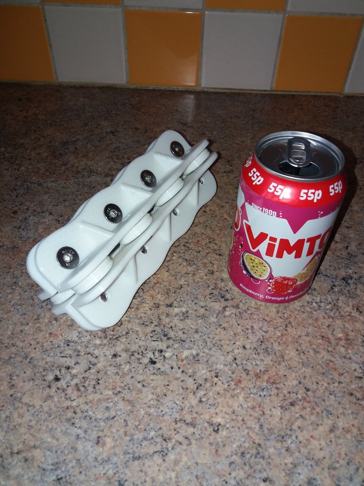

I noticed in a later thread some of the couplers split asunderHe drew them up.
I found I've only ever needed two jigs , one for hard woods & one for soft , both are made from anodized Z shaped die drawn aluminium. IIRC one at 25 % and the other 30 % . As the z is used like a bench hook it's easy to use a marking knife to draw in the dovetails over divider made spacing points , once one set is cut simply use that as the template to make the dovetail angles on the other piece of wood .
Could you redesign them with say an 8 mm thread running right through on all axis and screw in 8 mm stainless studding rod or do the same with 5 mm stainless threaded rods going into captive nuts at one end & use another nylock nut & flat washer at the other end to pull the axis into compression to stop it shearing off ?

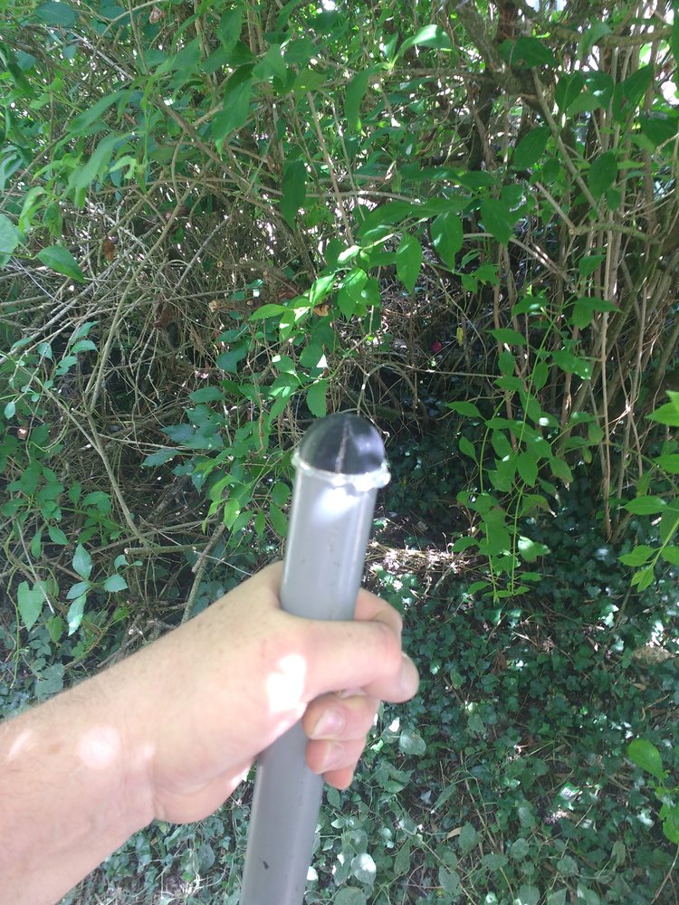

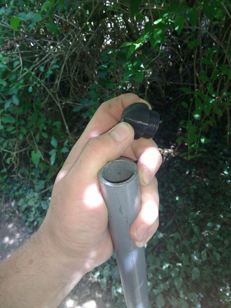

What’s a TPU?A protective TPU end in case I should accidentally fall backwards whilst pallet busting...again.
(That's CT1 to secure it btw).
