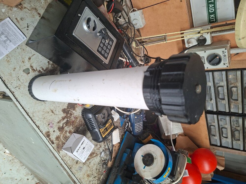

As I don't use amy sticks I only used 44mm OD sink waste pipe in hard solvent weld plastic popped a removable twist to remove blanking plug on each end . The lids have an O ring seal in themI printed some capes that fit 80 downpipe to take welding rods.
From Thingiverse as a fishing rod holder. The screw cap has a hole in it, which i tapped M8 and put a bolt in it.
I cut a leather washer to seal the screw cap.

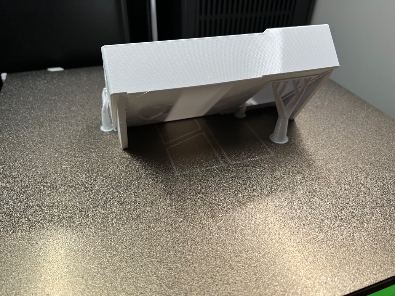

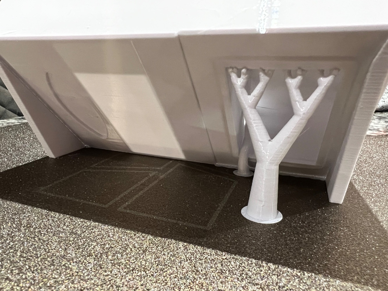

Saggy gate wheel bracket, is a success.
Annoys me that the bottom front did not come out well due to using supports, so next time I will print the other way up, so it wont be visible.
