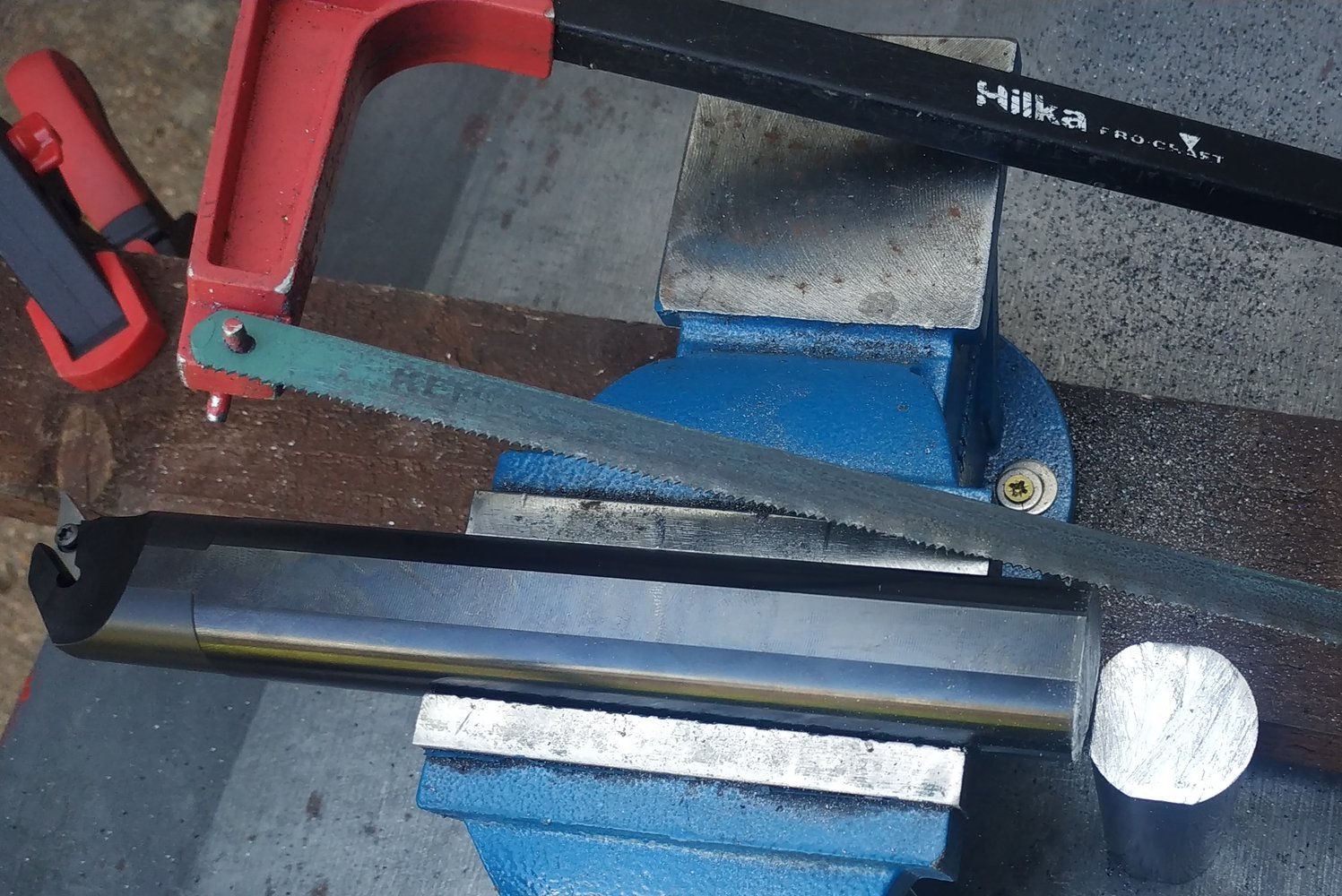

Easier with a slitting disc on the grinderView attachment 300771
Hacksaw practise. I think that wore a few teeth. 220mm long with 130mm to repurpose.
I did think that but didn’t want to say!!Easier with a slitting disc on the grinder![]()
Much too hot for hacksawing todayI did think that but didn’t want to say!!

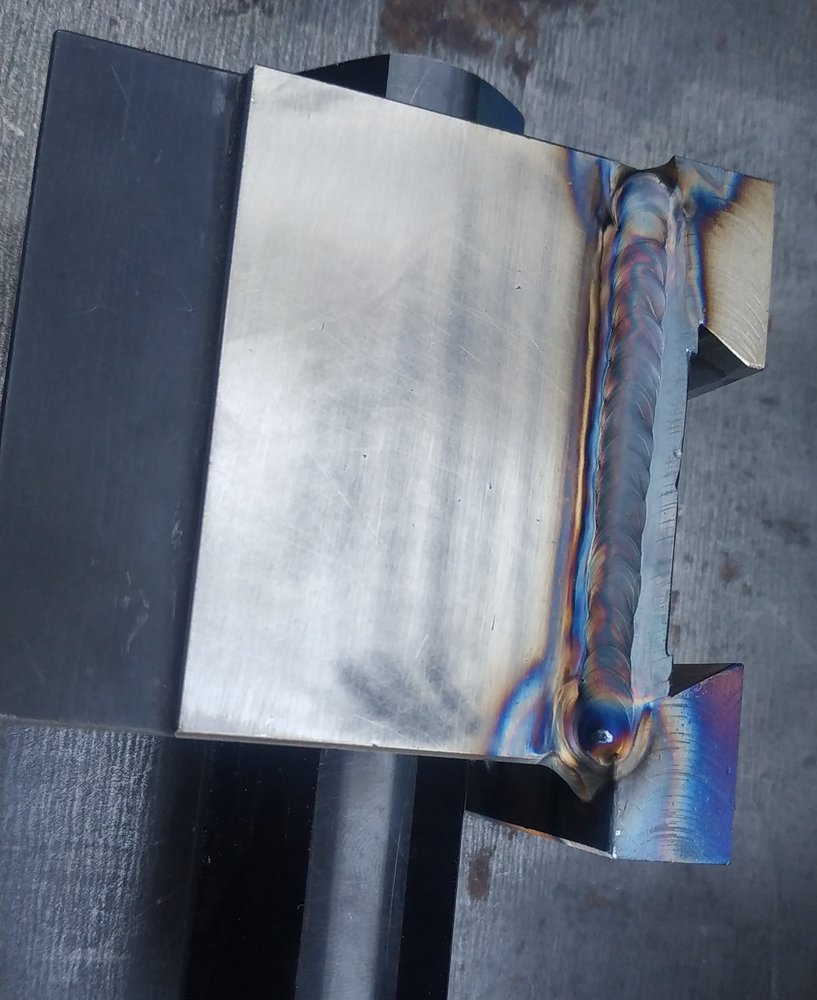

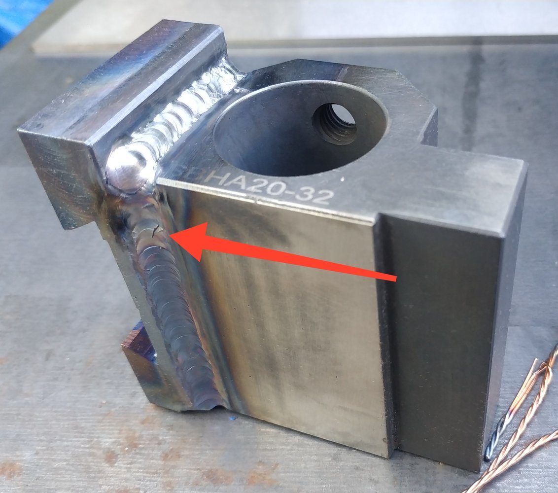

Interesting, theres a few. I had a look with loupe and they are proud of the surface, so I guess they form as the bead solidifies?That's a crack.
Tbh mate I'd leave it. It's the grade of steel and likely no preheat/slow cool.Interesting, theres a few. I had a look with loupe and they are proud of the surface, so I guess they form as the bead solidifies?
Grind out and reweld?

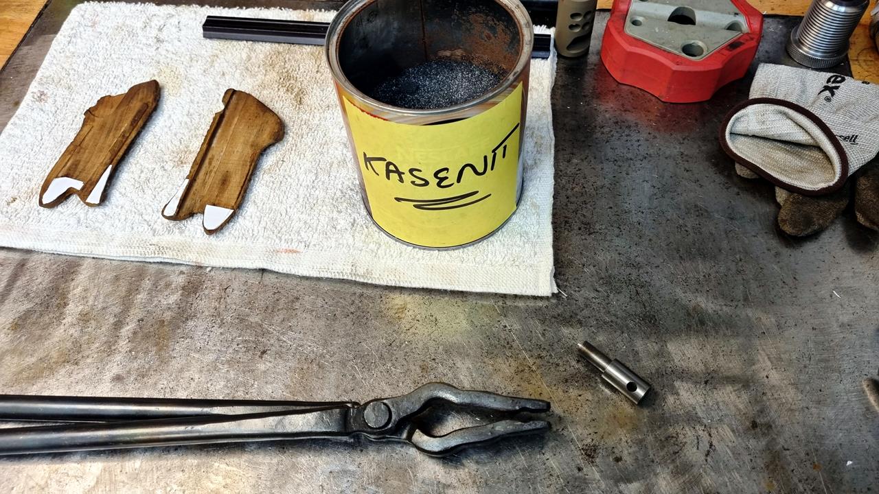

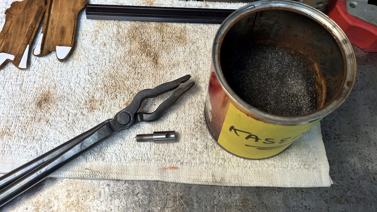

Well not today, yesterday. Dug my precious out (the tin of Kasenit, it is mostly the real thing) and set to with the big propane torch as the little one was definitely out of gas. Worth mentioning that the tongs you see in the pic were made for me by Glen a looong while back now, just after he was setting up I think and they are really really nice to use, I have a few pairs.
This is Glens website and yes, I know you are supposed to make your own as a "Blacksmith" and yes you can pick them up for peanuts (has anyone actually tried paying with peanuts?) but it's nice to support fellow tradesmen around the world: https://www.gstongs.com
View attachment 300881View attachment 300882

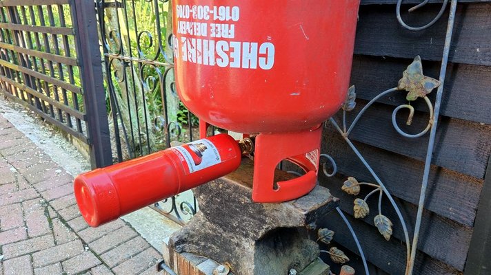

The little bottle benefitted from sitting in the fridge for half an hour first:
Slitting saw on the mill or even on the lathe were my thoughts.I did think that but didn’t want to say!!
A slitting disc (abrasive type) will cut through hard steel easier than any toothed blade/disc method in my experience.Slitting saw on the mill or even on the lathe were my thoughts.
