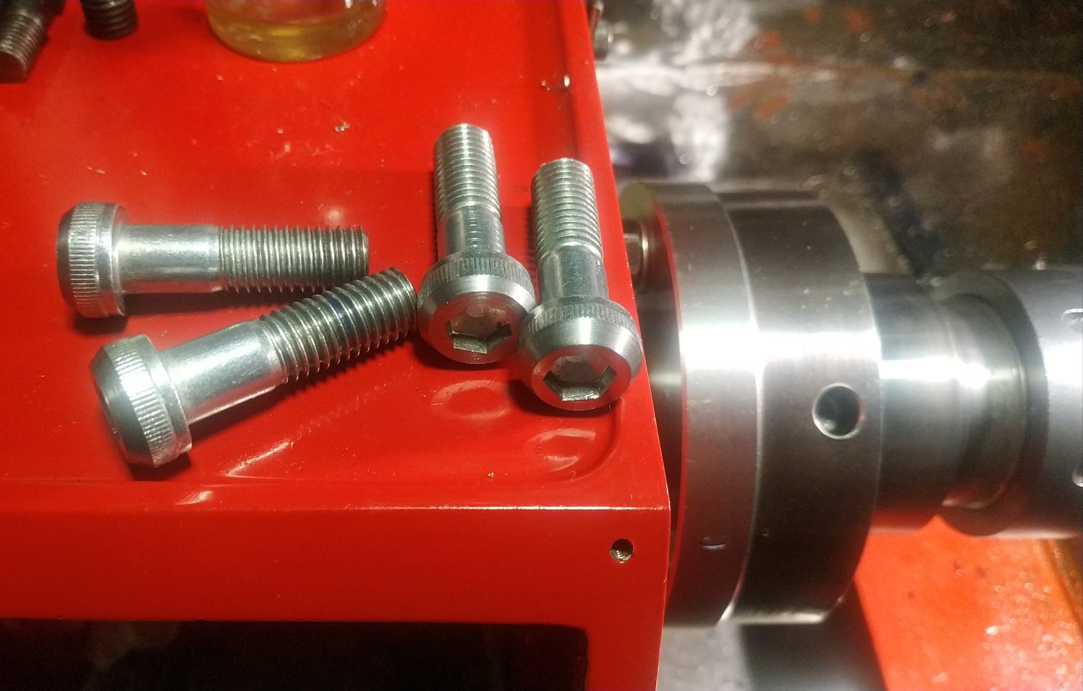

That's so that the part can be trued up. If it was making two points of contact on each jaw you might struggle to bump the face into square. Always use copper sacrificial pieces on anything I don't want to mark.Shortened bolts, took some effort but they are 12.9's. Couldnt hold them in collets to turn due to length. Shortened the head and the grade turned very nice.
Fitted with temporary m8 studs.

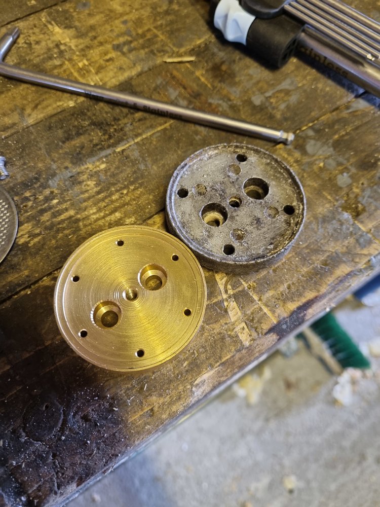

Part of an espresso machine, don't know what its called but the old one was a bit corroded for my liking. It bolts to the grouphead and the shower screen screws onto it. The holes around the edge are for water to pass through, six is easier to mark out than four.
Better hope I can get it back together then, it's been in pieces nearly a year.I will approve anything coffee (as long as it isn't decaffeinated or instant) related as a matter of course!![]()

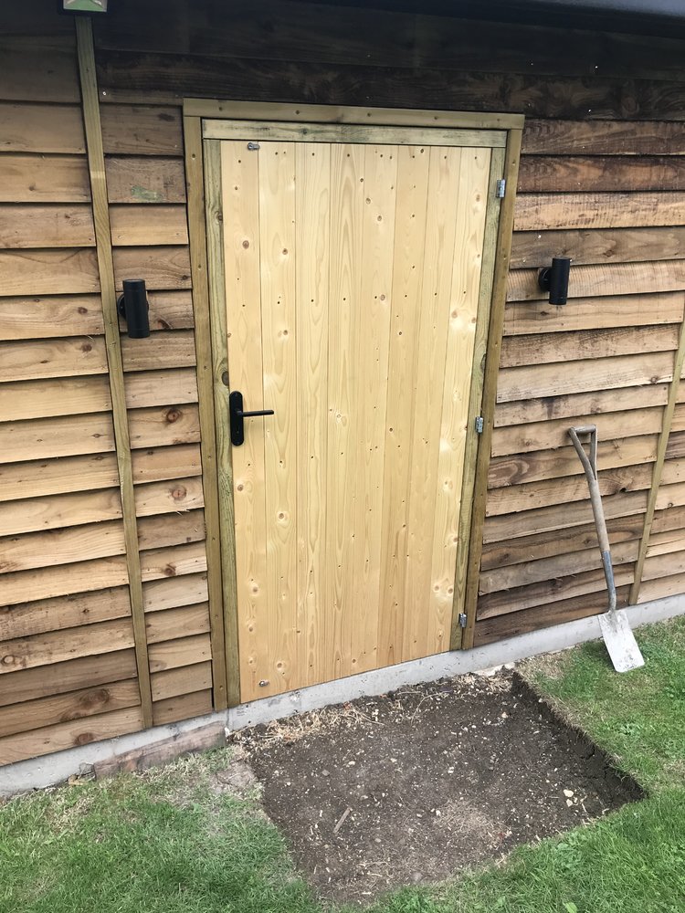

Also finished the side door on my garage.
