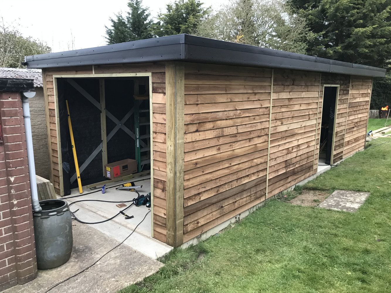

finishing touchpit metalwork painted.
that's it bar the ladder and the cover.

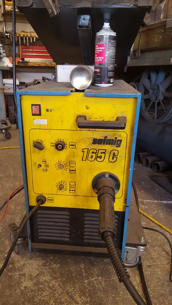

..My old Safmig was right on its limits but just about got enough heat in to get the job done

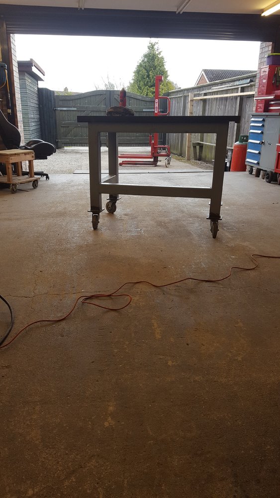

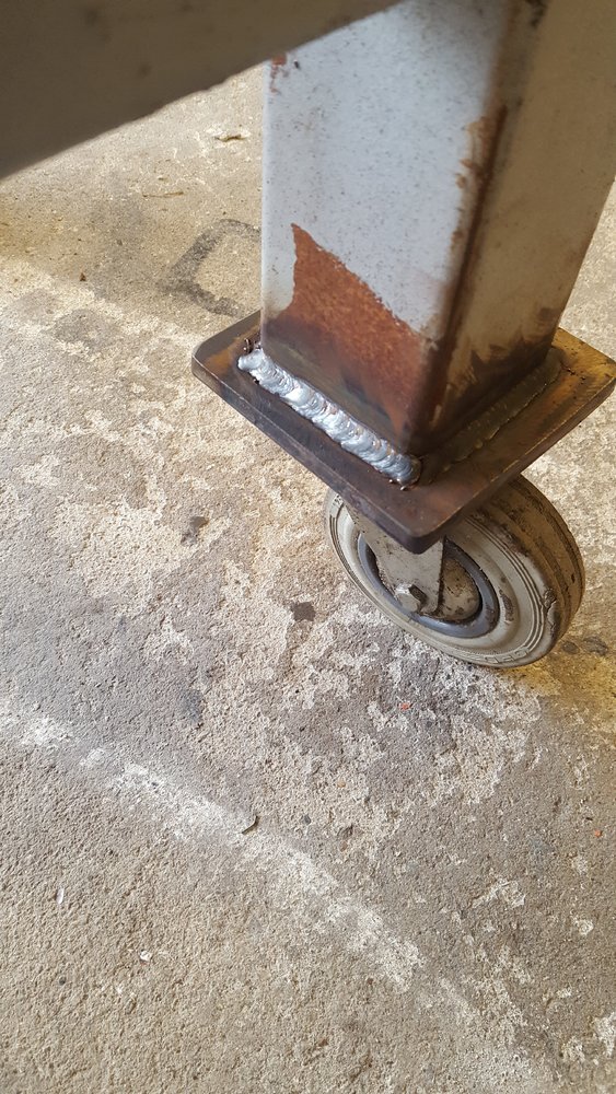

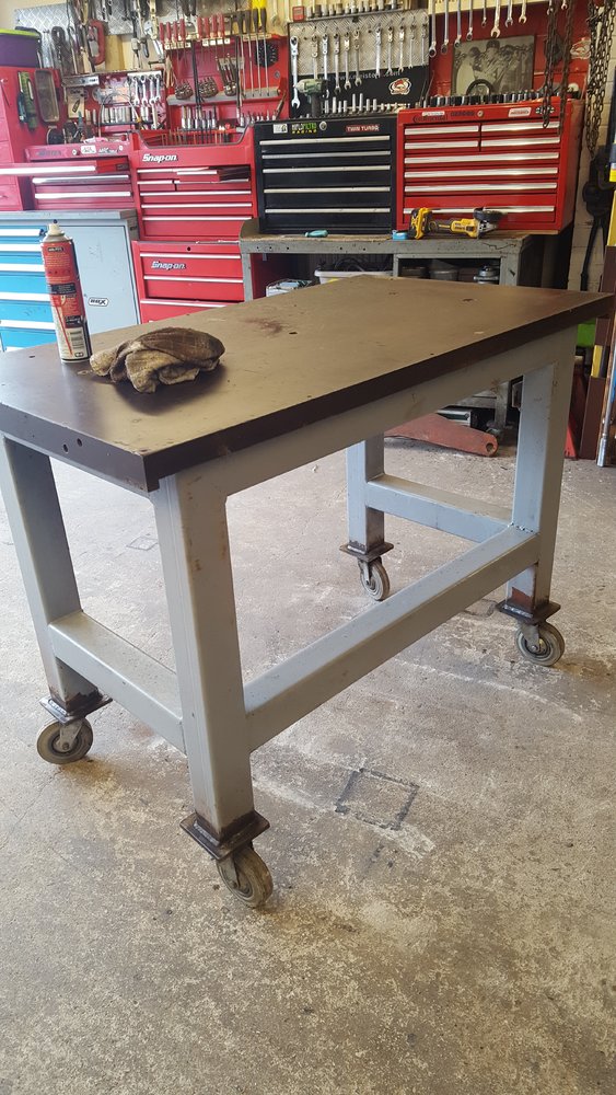

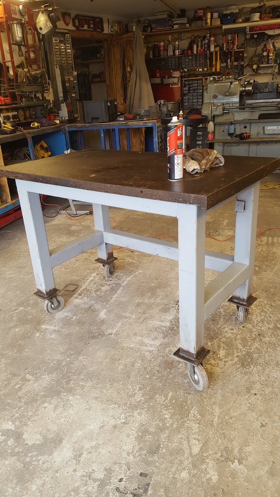

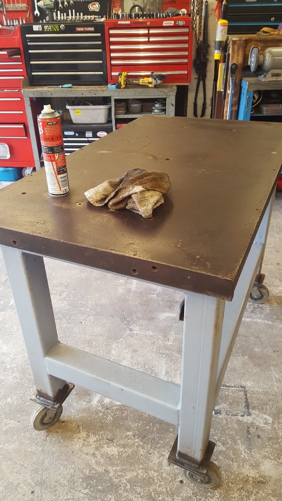

That's a rather nice looking workshop... Ooph.Recently picked up a very heavy cast iron table from zzr1200 but needed it a bit mobile so pics tell todays story..My old Safmig was right on its limits but just about got enough heat in to get the job done
(incidentally the best welder ive ever owned and ive had a few over the years). Dont know what John thinks but this thing must be close to 350KG.
View attachment 284728 View attachment 284729 View attachment 284730 View attachment 284731 View attachment 284732 View attachment 284733

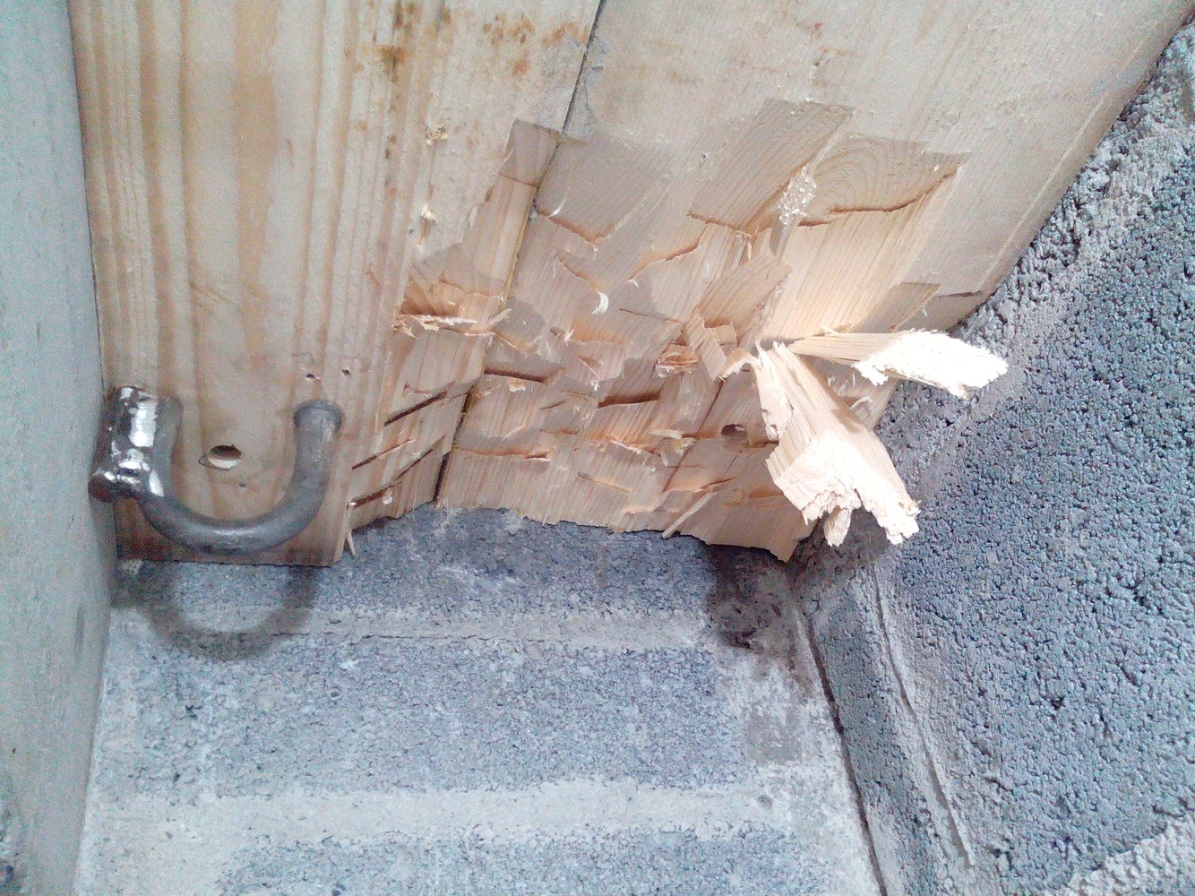

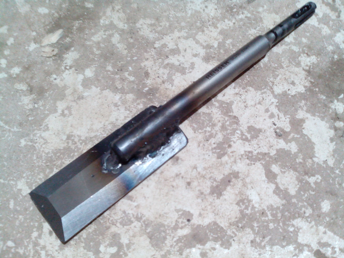

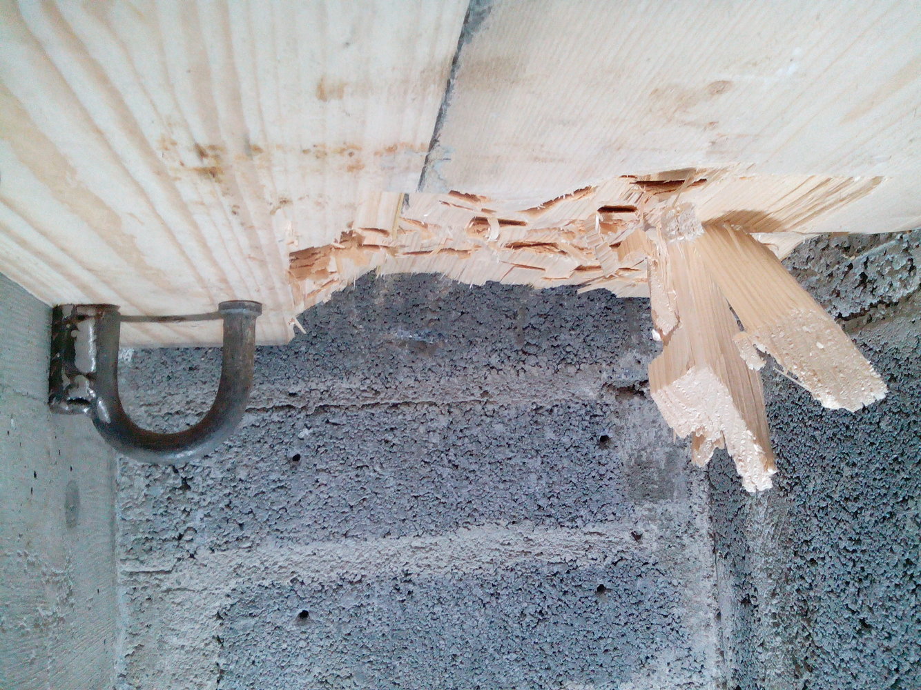

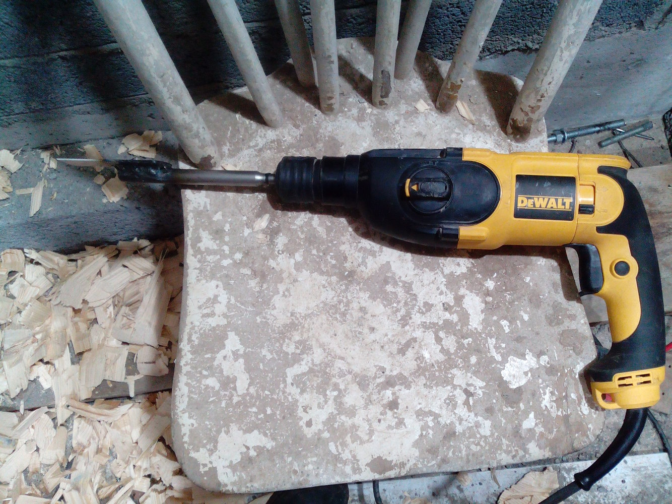

How about drilling holes through, across the width of the planks.I welded the blade of a 38 mm woodworking chisel to the shaft of an SDS masonry bit in order to use the hammer action of my Dewalt drill to chop out the scaffolding planks I used in the shuttering for the concrete head over my new fireplace. The planks are new, 3 inches thick, and a very tight fit with no way to remove them but to break them out of the fireplace bit by bit. I didn't fancy the idea of doing it by hand with a hammer and chisel so this was the solution I came up with and it works brilliantly. What you see in the second and third photo only took me a few minutes to do.
The galvanised hook is one of a pair with its counterpart on the opposite side of the fireplace. Both hooks are welded to lengths of rebar several inches long which are projecting up through the timber and are now firmly encased in the new concrete head of the fireplace. In the future the hooks can be used to support a steel bar from which I can hang cast iron kettles and pots. Incorporating the hooks into the shuttering before pouring the concrete avoids having to drill the underside of the slab afterwards.

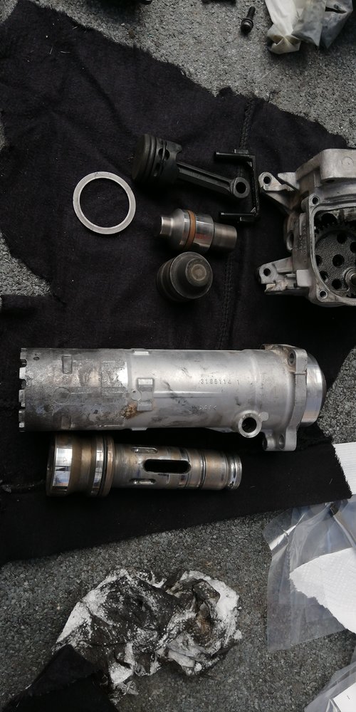

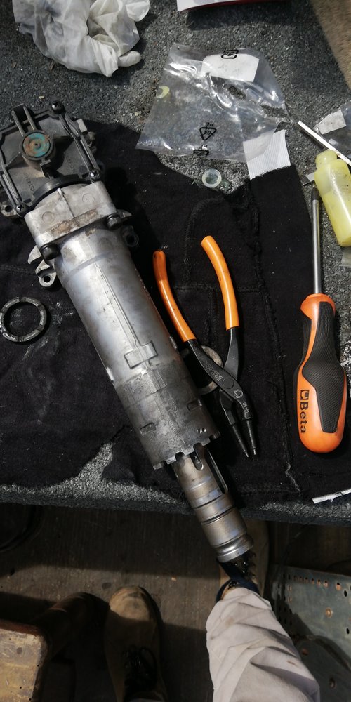

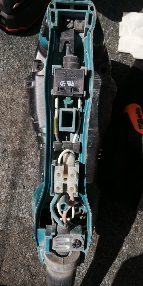

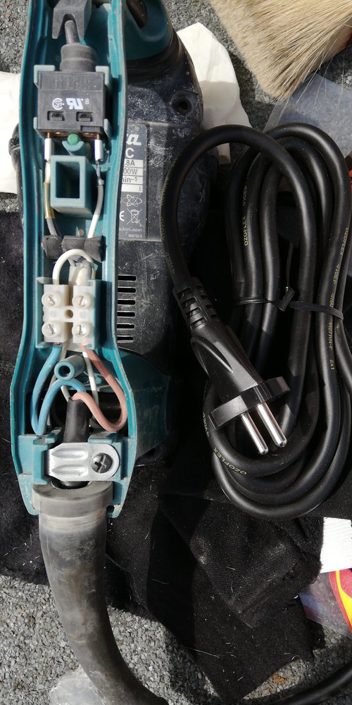

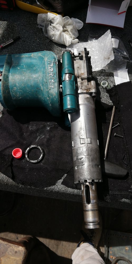

), new o rings and gaskets ,new lube,new tool retainer lugs, new cylinder seats ,new Seeger,new ball bearings, new powercord .
As soon as it's confirmed that a new armature is needed.. it's usually uneconomical to repair the equipment and make a sensible profit . You can get customers all day long and well into the night who demand Rolls Royce repairs at the scrap yard prices plus they'll want a six months warrantee on your repairs .So today has been a long morning .

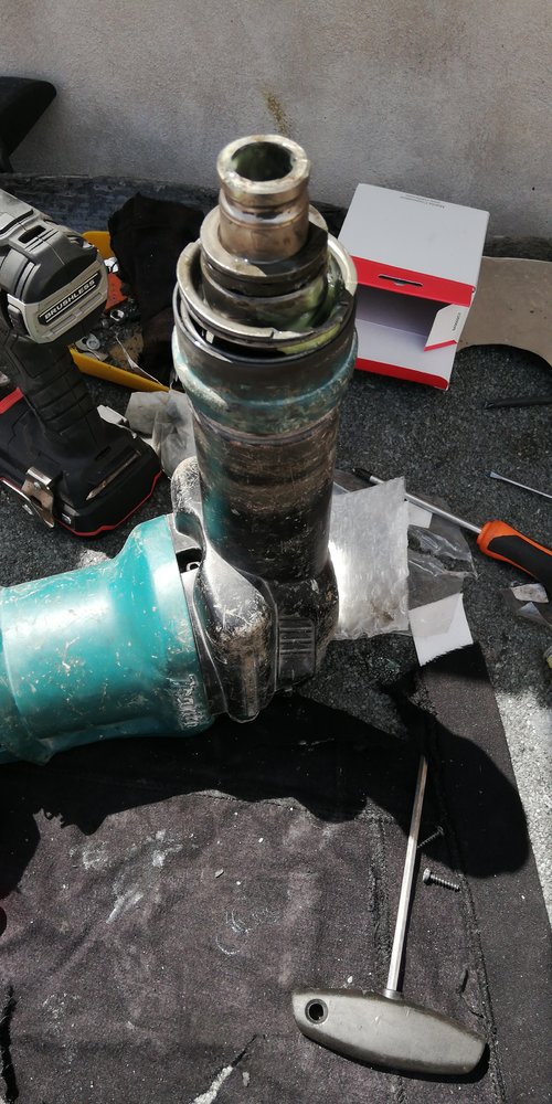

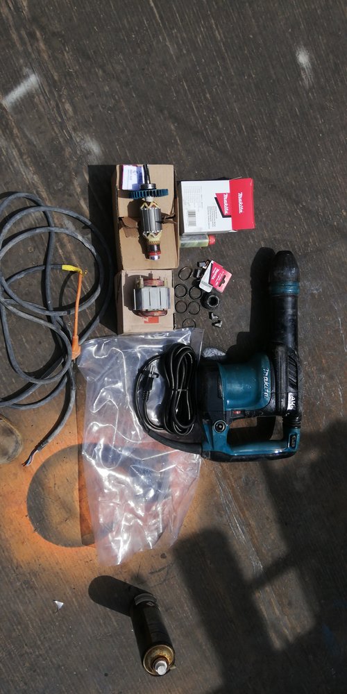

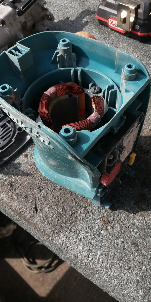

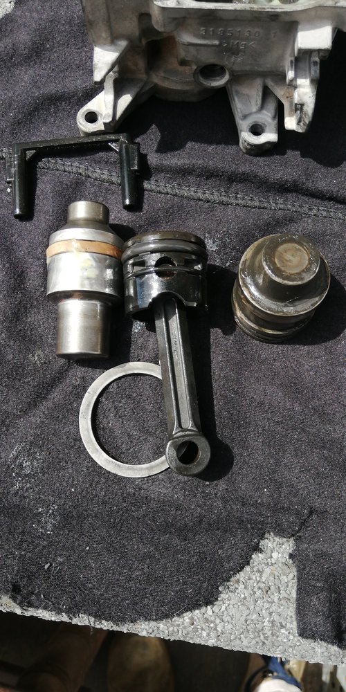

Makita HM0871C demolition Hammer.
Replaced the stator windings, armature ,carbon brushes, cleaned all the parts as well as I could (I still not able to make miracles happen), new o rings and gaskets ,new lube,new tool retainer lugs, new cylinder seats ,new Seeger,new ball bearings, new powercord .
Had to go to the car parts store to buy a 6201V ball bearing because it wasn't included with the armature .
Lost an half hour there.
Then coming back home ,an old cyclist made me get upset as well ....
3 km with my car at 10km/h and him always in front of me .
Then once home I've touched another car while parking (no damages )
Finished to assemble this thing at 2pm .
That's will hopefully write the end of a repair lasted three months .
I've disassembled this thing in January or first days of February , ordered the parts and waited them till yesterday .
130 euros worth of parts and consumables .
50 of profit .
I'm too honest I believe

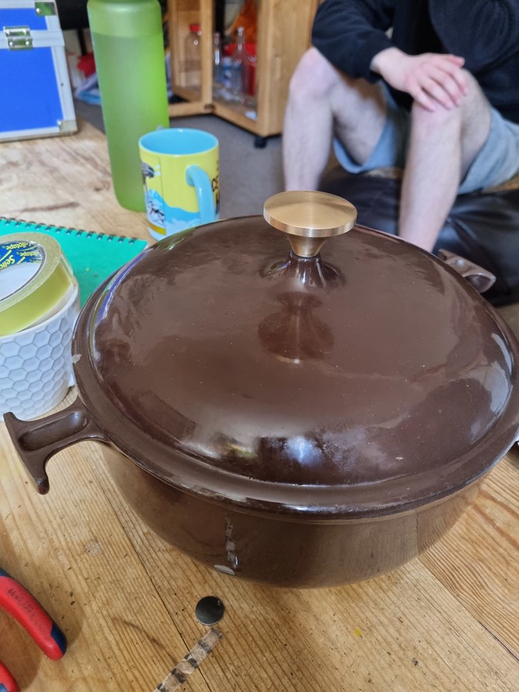

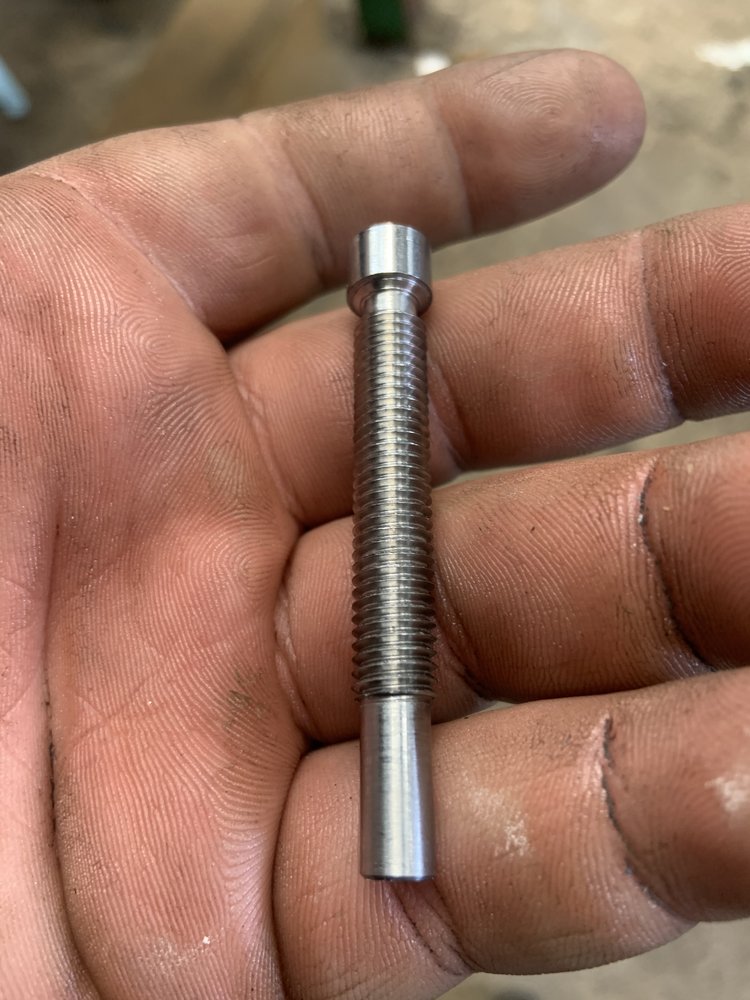

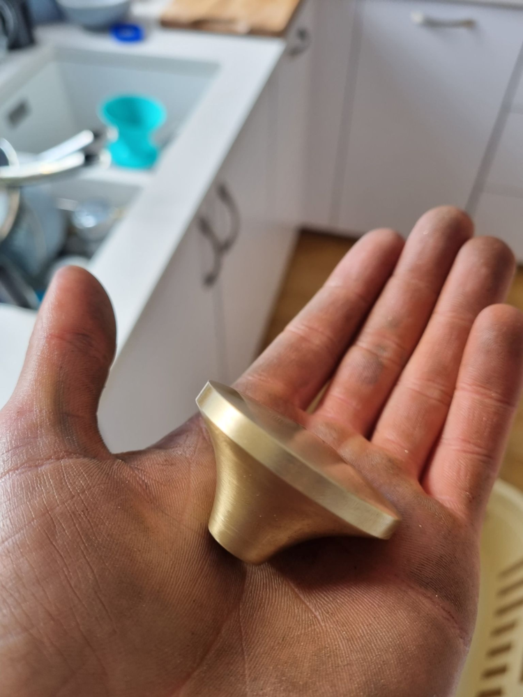

Made a knob
It's a handle for a cast iron casserole pan, the original was some brittle plastic and broke months ago. I did the bottom with a form tool ground from a parting blade on it's side, couldn't be bothered to grind a concave tool for the top so that was just freehand with a big corner radius tool and a file.M6 thread in the bottom to hold it to the lid and to conveniently hold it for turning the top face, it probably wouldn't have held up to the cutting force on an inch long form tool anyway.
The last time I saw legs like that they was hanging out of the edge of a nestWhomever those legs belong to, tell them to do everyone a favour & wear trousers.![]()

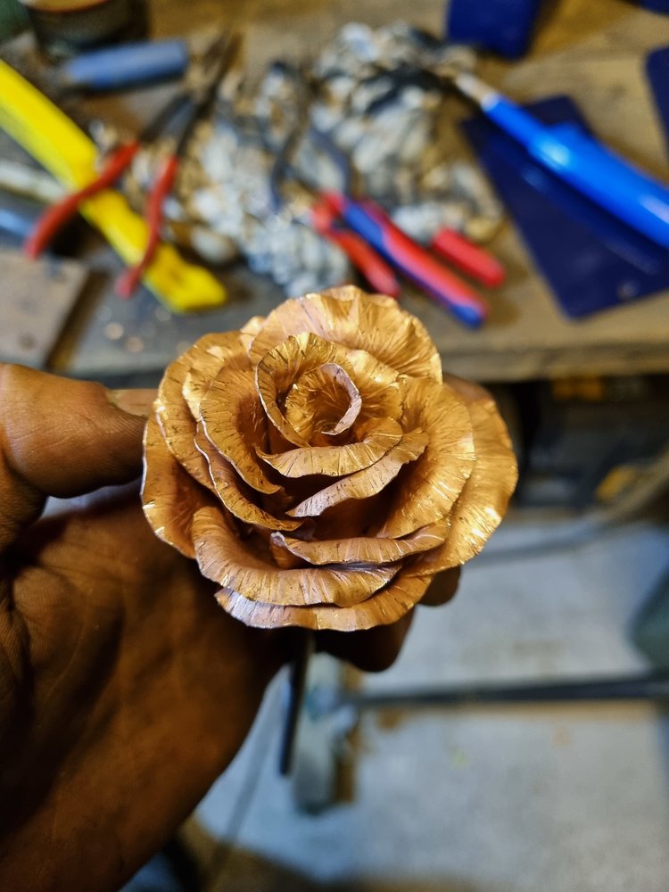

That is a very nice one!Present for someone.
Been a few years since I last made one, I'm quite pleased with it.
