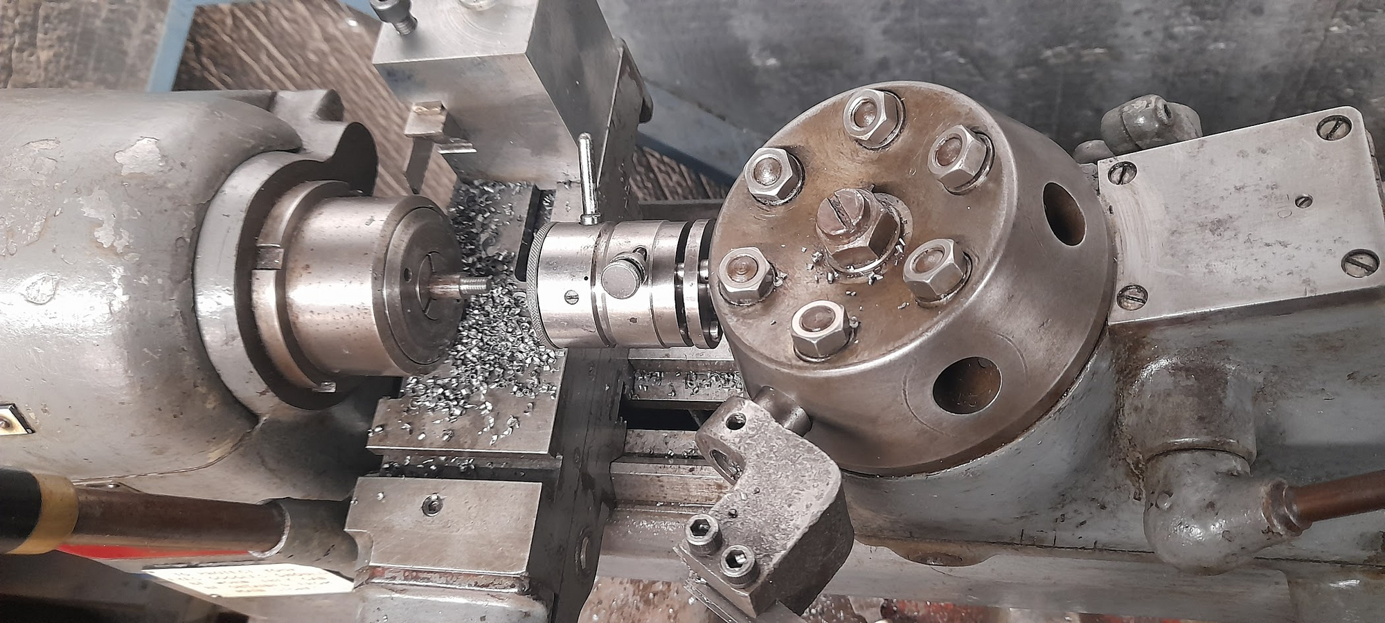

Just in case anyone plans to copy me, I should point out the rear tool post is getting in the way of the die head when it swings around on the capstan unit. I need to shave a corner off the rear tool post.A front toolpost to complement the rear tool post I made a few days ago. These will stay on the cut off slide. I still need to make a couple more t nuts and find or make a more appropriate hold down bolt. The cut off slide is very quick acting and nice to use.

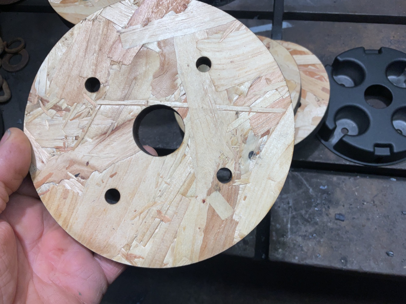

More assembled than made, needed to form perfectly flat and level concrete pads for some lighting bollards, spoke to a guy that does laser cutting and he said he would cut bolt holding templates out of osb, what sort of witchcraft is this
View attachment 521054View attachment 521059
Ubolts ready to push into the concrete.
What's that black round thing for?

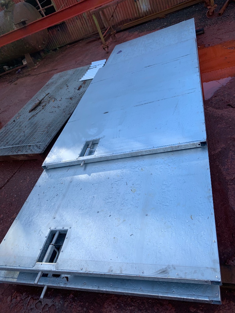

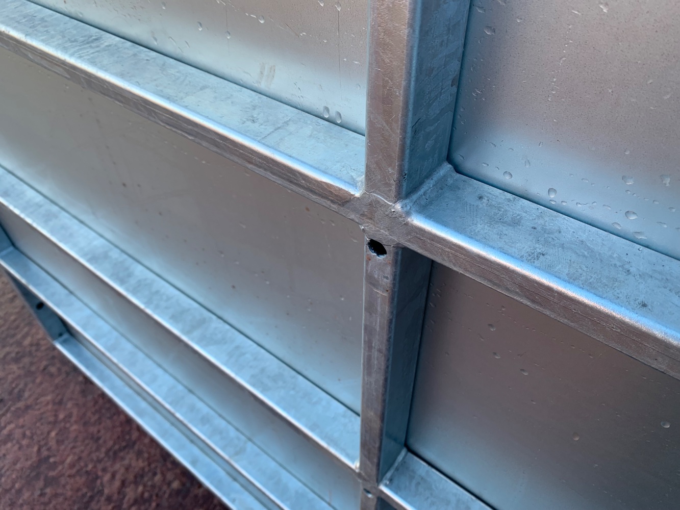

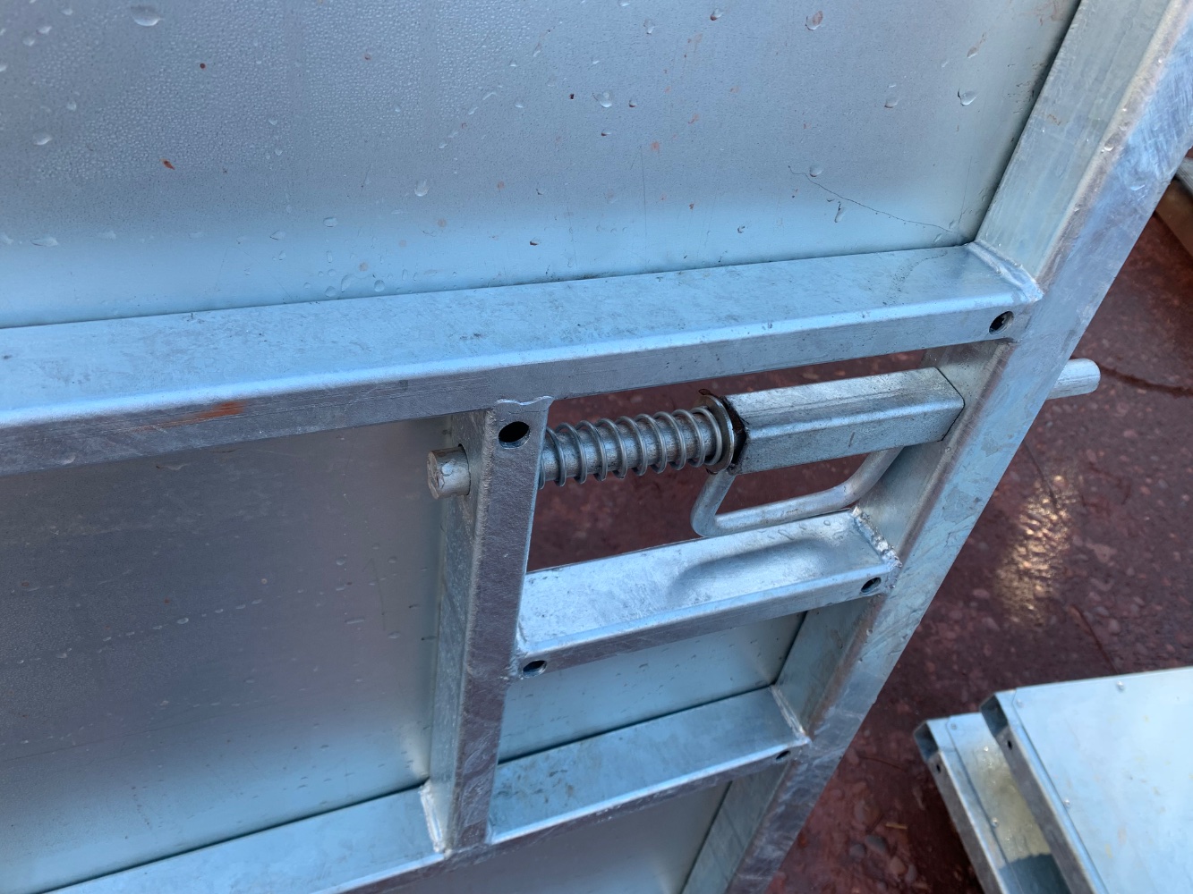

A few 1.5m tall sheeted gates, I call them IAE killers. Built to last a lifetime not just the first big just of wind

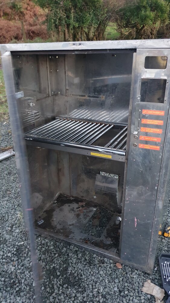

. All running happily now though with some replacement 12v leds!
