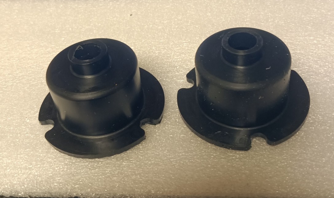

I had considered that but they are different makes and I have seen warnings about doing so. That may just be scare mongering so you buy the same type or it may be true, who knows but I will likely give it a try.Can't you mix the 20 and 80 shore in proportions to create something between the two?
Great work. I’m interested to see the final result.The 85 shore polyurethane arrived this evening, was supposed to be Tuesday but not complaining

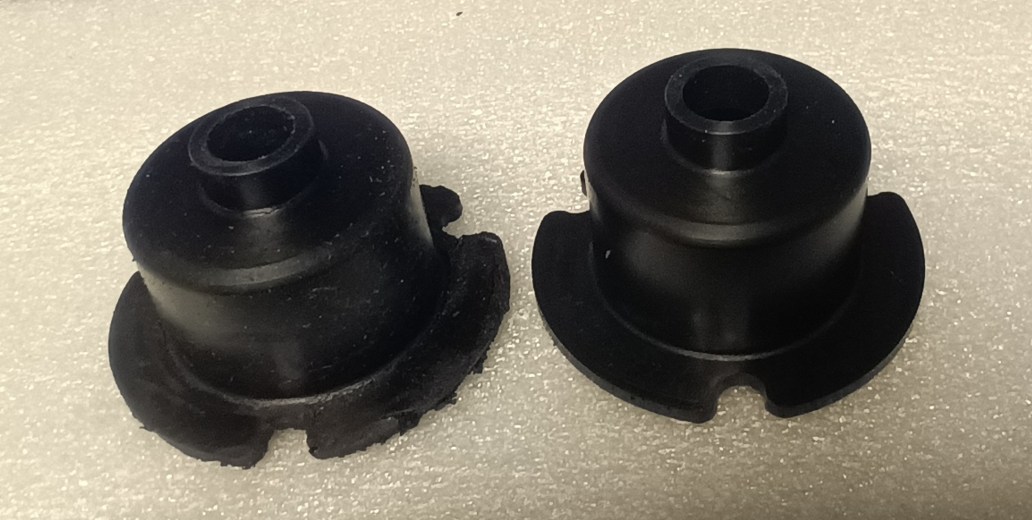

Gave it a go, first one was a disaster, not sure whether I didn't leave it long enough or whether I didn't mix it well enough but had another go.
This time it came out ok but it seems to be cracking too easily so maybe just too hard or maybe I have to leave it longer, it says demould in 1hr but full cure is 1 week.
Decided to try the 20 shore with the black dye and it worked well, I may see how that performs but I would like it slightly more tough/less flexible so might end up trying some 30 or 40 shore.
Anyway a pic of both, you can easily see the difference.

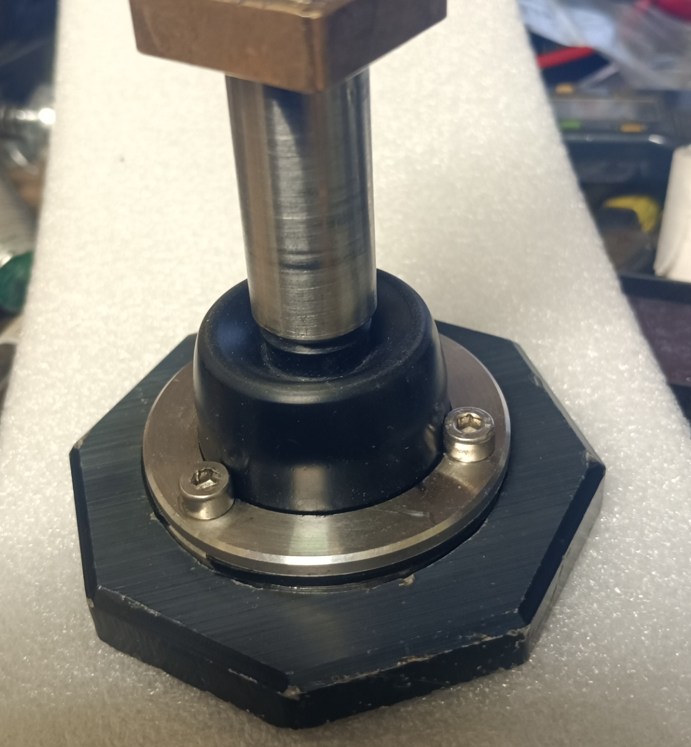

It is the neck part that I would like to be the softest as when the stand pivots the 85 shore can leave a small gap which muck could get in. I was trying to think of a way to achieve the soft/hard transition but as the pour gap is only 2mm wide it couldn't be done in a single pour.Would a two different mixes transition be possible, with the boot made of softer material than the flange?
It is for the electric side stand I made. I am currently using the tops of rubber gaiters I got from Aliexpress but they are not lasting so thought I would try polyurethane.what's it for?
I missed it, I've scrolled back but can't find the first posts :-(
A flanged cap would do it but I think the 20 shore is too flexible anyway as I am wanting something that will hold the ball joint a bit to stop it wallowing all over the place once it wears a bit.How about just controlling the compression of the flange - a suitable spacer/washer inserted? Might even be a use for those otherwise useless spring washers as they are usually a smaller diameter than a standard one?
It is for the electrics side stand I made. I am currently using the tops of rubber gaiters I got from Aliexpress but they are not lasting so thought I would try polyurethane.

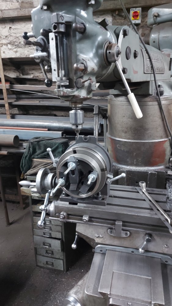

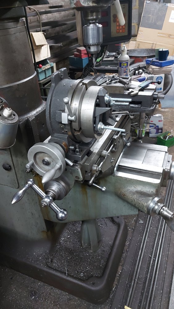

That table's clean enough to eat Christmas dinner off .View attachment 522196set up the rotary table to get production run View attachment 522197started !
