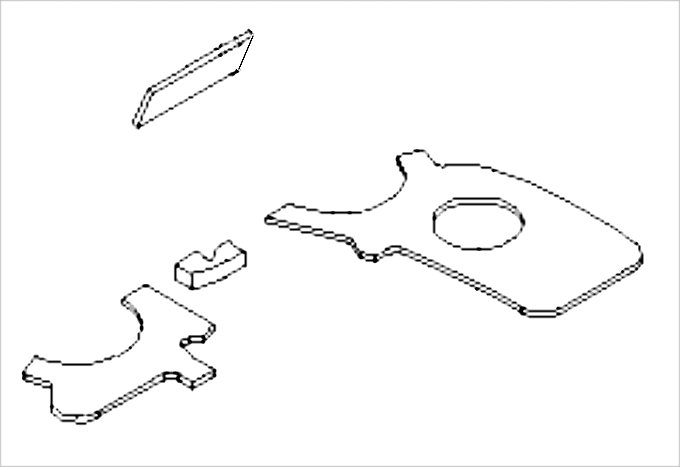

I have some white rubber hockey pucks that I sometimes use to support things that I'm working on, but for the fuel tank the foam needs to be pretty soft, and the pads actually cover quite a bit of area. Here's a drawing showing the general shapes of the pads. A couple of the pads have tabs that wrap around the edges of the tank.

A yoga mat would probably be fairly close to the density of the foam that I just ordered, which arrived yesterday.A thick yoga mat might do the trick.

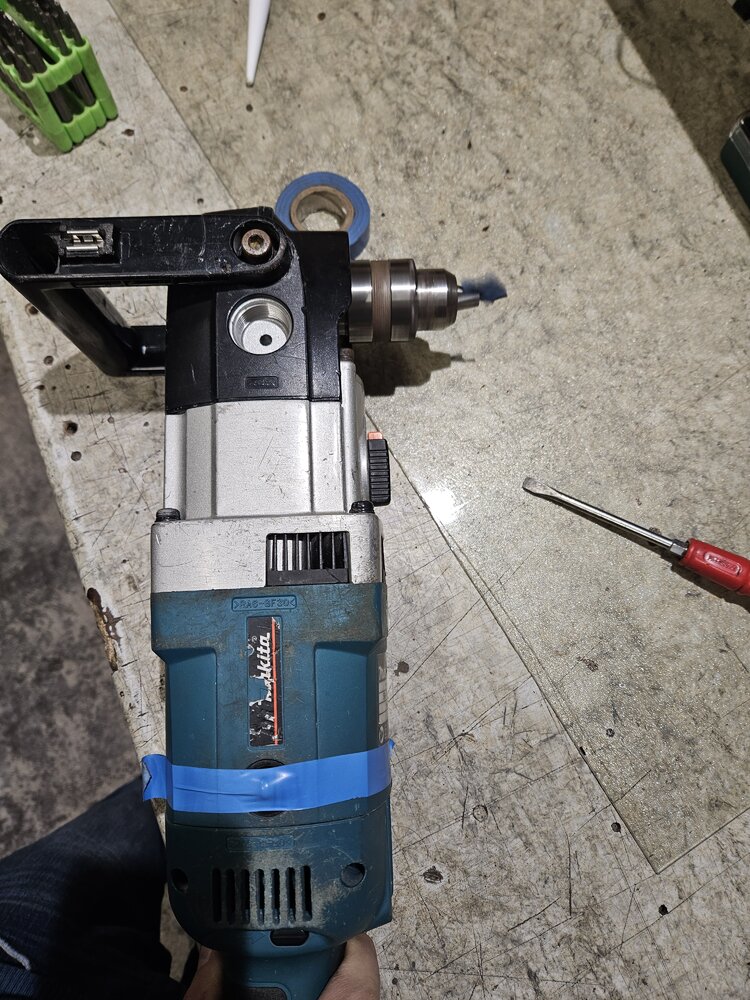

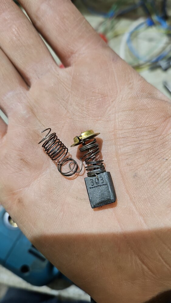

Got the Makita DA4031 working, turns out someone had **Language**ing the brush and shoved an extra spring in thus it wasn't touching and cross threaded the brush holder cap so I had to chisel it out in bits to test with a ball bearing pushing it down under the tape lol, new ones ordered.

I don't even know how they got the extra spring in, cross threaded the cap AND screwed it all the way in!The problem here, admirably illustrated is that some people have no understanding of their own limitations!.

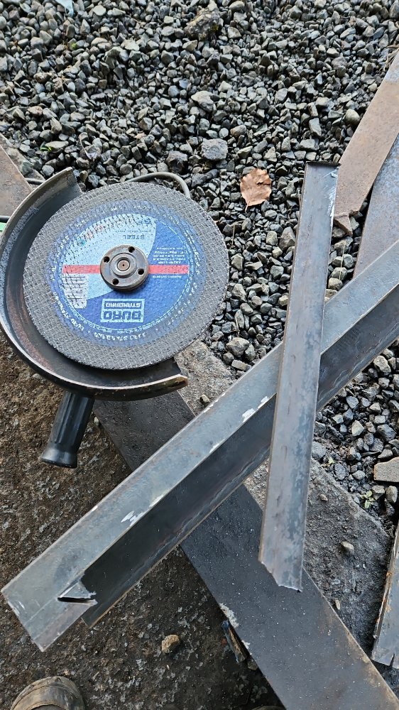

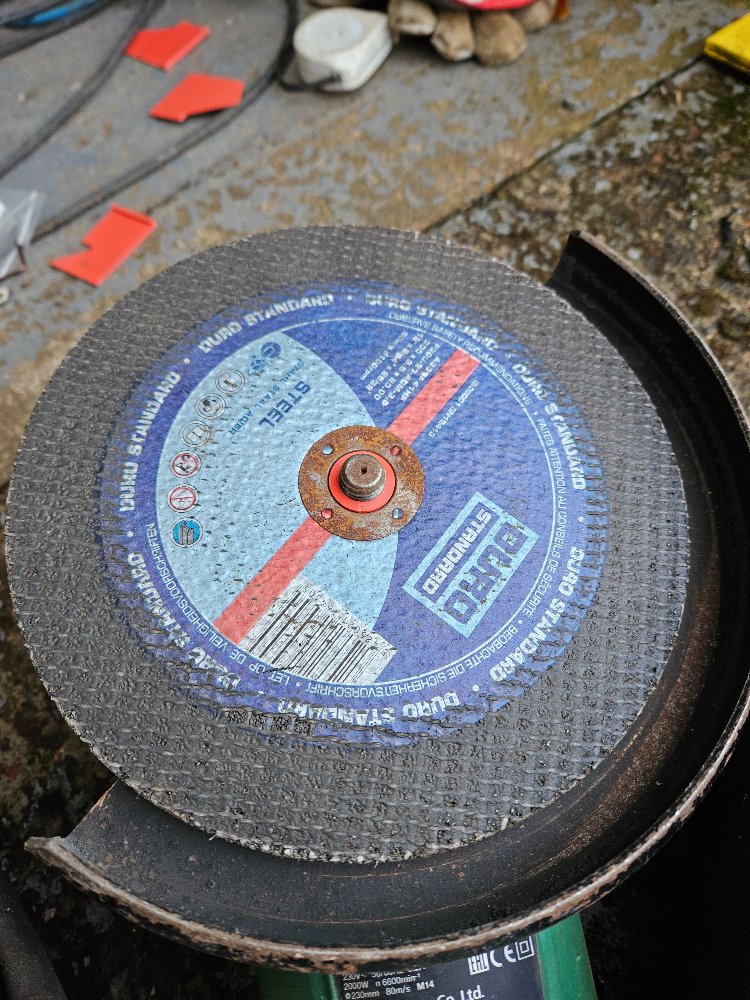

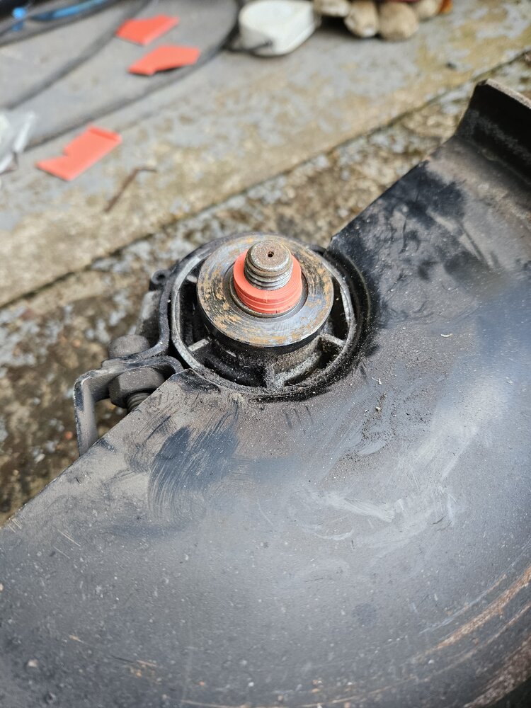

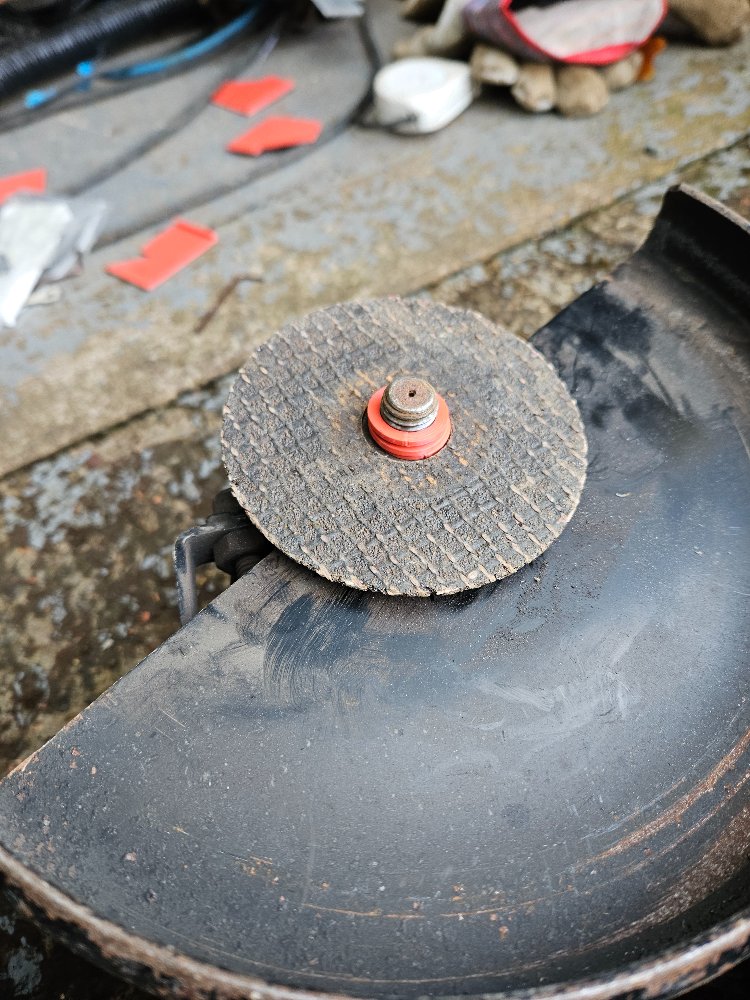

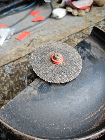

Fixed the wastage of cutting discs from the stihl petrol saw, it uses a 20mm arbour (9" is 22mm) and normally +6" left due to the design of it so printed some spacers and use a slitting disc stub so now I can get my moneys worth and it worked for several hours cutting![]()

Well this is a 12" with about 6" left shoved onto the 9" grinder till it can go on the 4.5"I run my 9" discs down until they fit into my 4.5 & 5" angle grinders. Then I run them down as far as possible......
So how do you get a 20mm disc onto a 22mm arbour?
Back when I was young, broke and knew no better I bought a stack of used quick cut discs from a scrapyard closing down sale.
I discovered that if you removed the metal washer from the disc you could squeeze it onto a 9" grinder and then a 4.5" to get the last bit of disc used.
I didn't know about disc rotation speeds and it could have ended badly but those discs kept me supplied for a few years!
Well this is a 12" with about 6" left shoved onto the 9" grinder till it can go on the 4.5"![]()
I've just remembered I've got a chop saw with a 14" blade. That's going to be run down until it goes in the 9" grinder......
Win, win, win!
There will somebody along soon to tell you that you are spinning them too fast.
