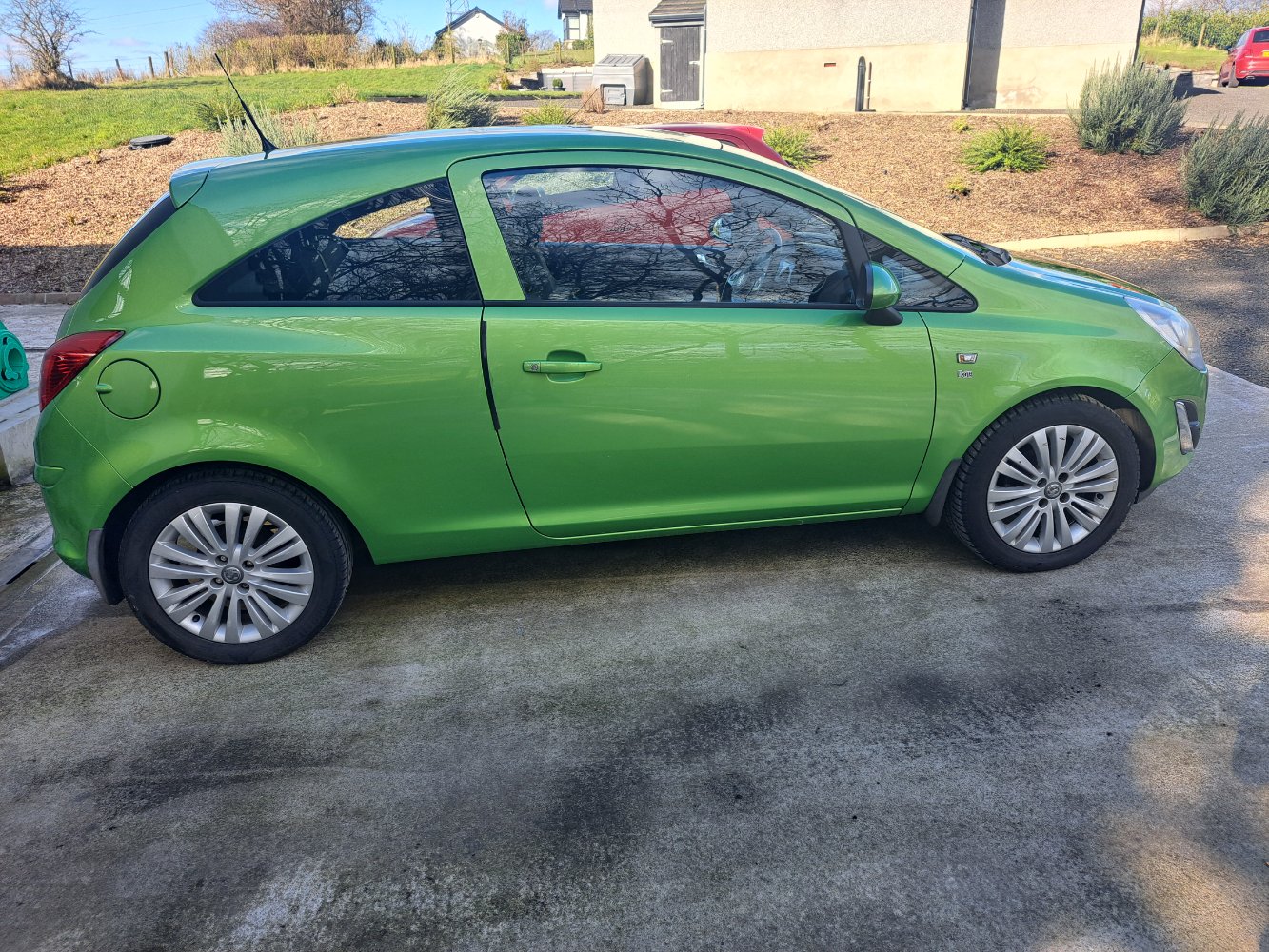

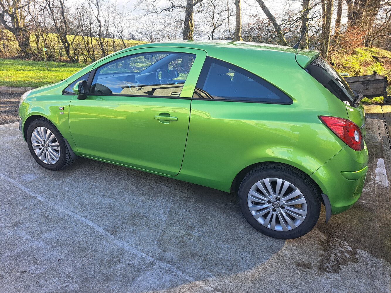

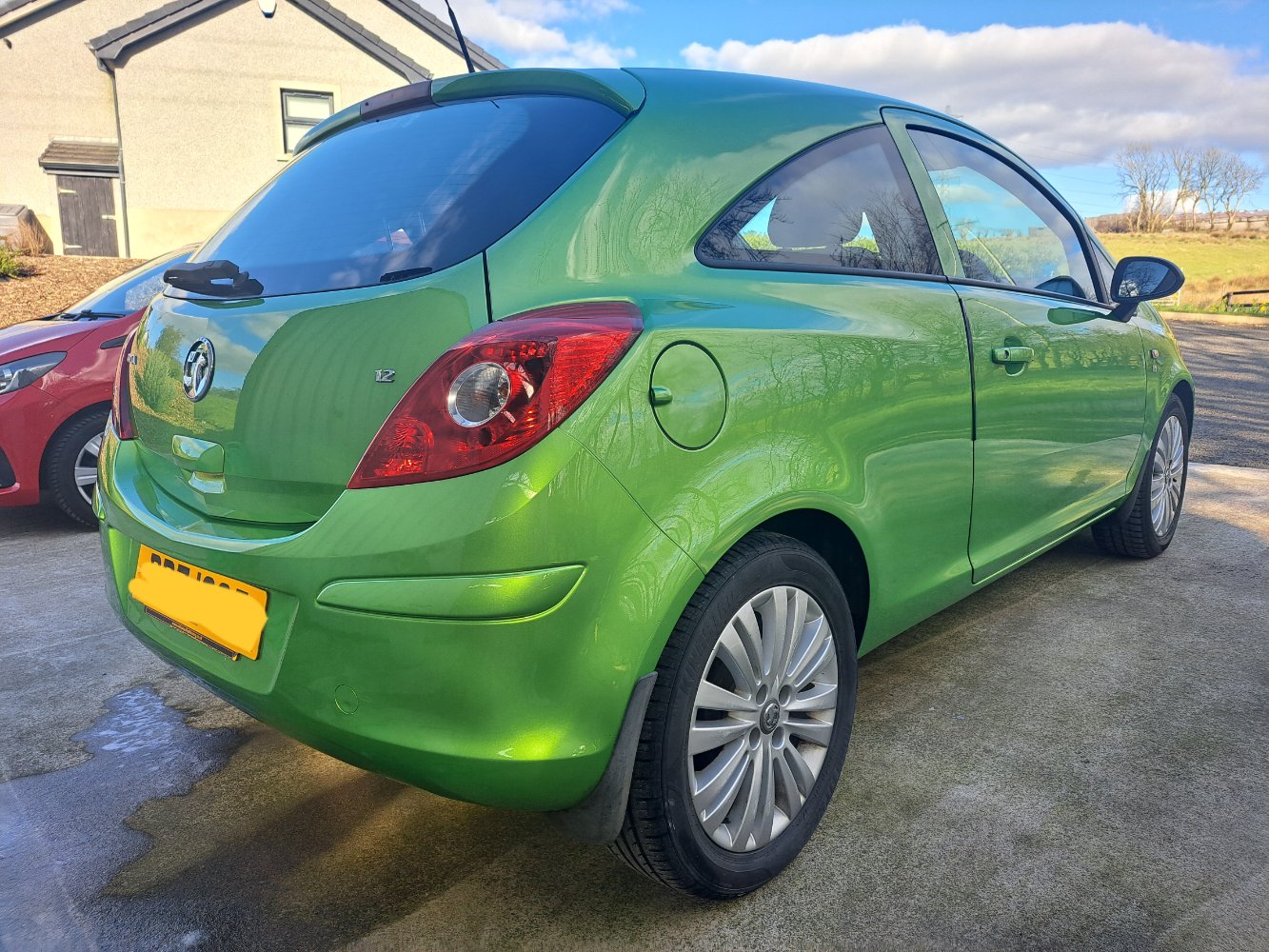

Son's girlfriend bought this Corsa last night. Decent enough little car but it was grimy, lived near a quarry so covered in dust and loads of tar contamination. A couple of hours washing, claying, DA polishing and waxing has it looking very presentable. Had the seller done this he could have asked another £500 for it.View attachment 488481View attachment 488482
Indeed, that's what my son saidReady for an LV advert now!
