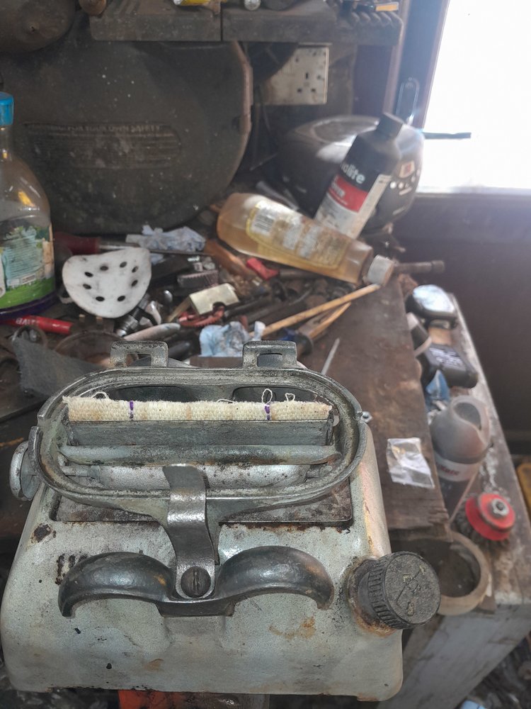

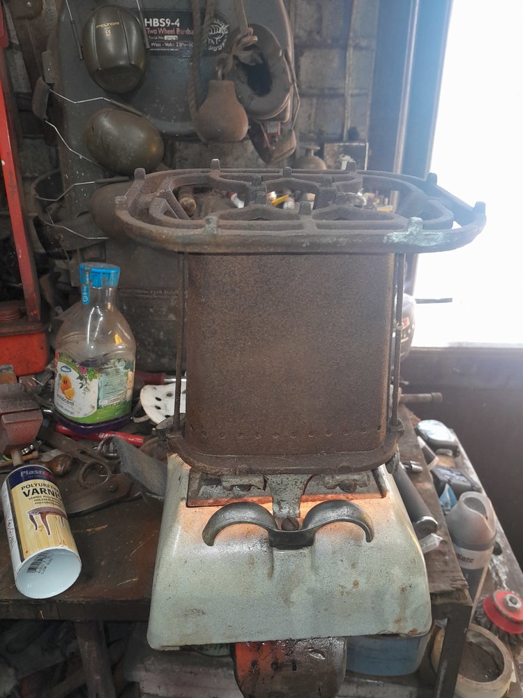

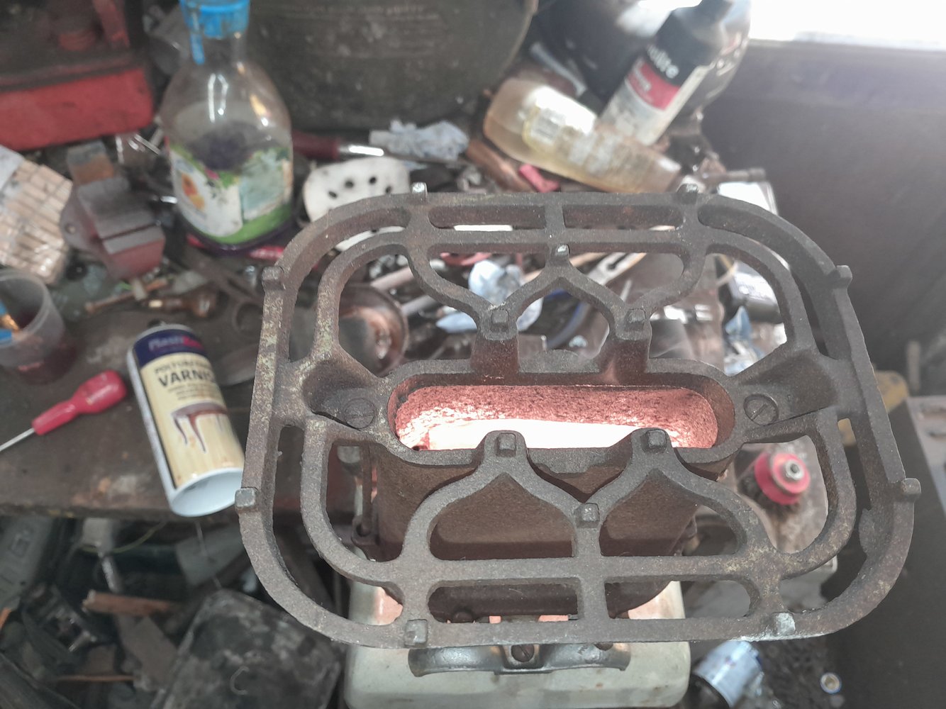

Fitted, but not seen is the cork gasket, this stops any fuel slooping out when the stove is moved.
This is how the lifting handls should be fitted. I see so many "Restored" stoves with them fitted wrong.
The Mica window is important for a clean and even burn.
