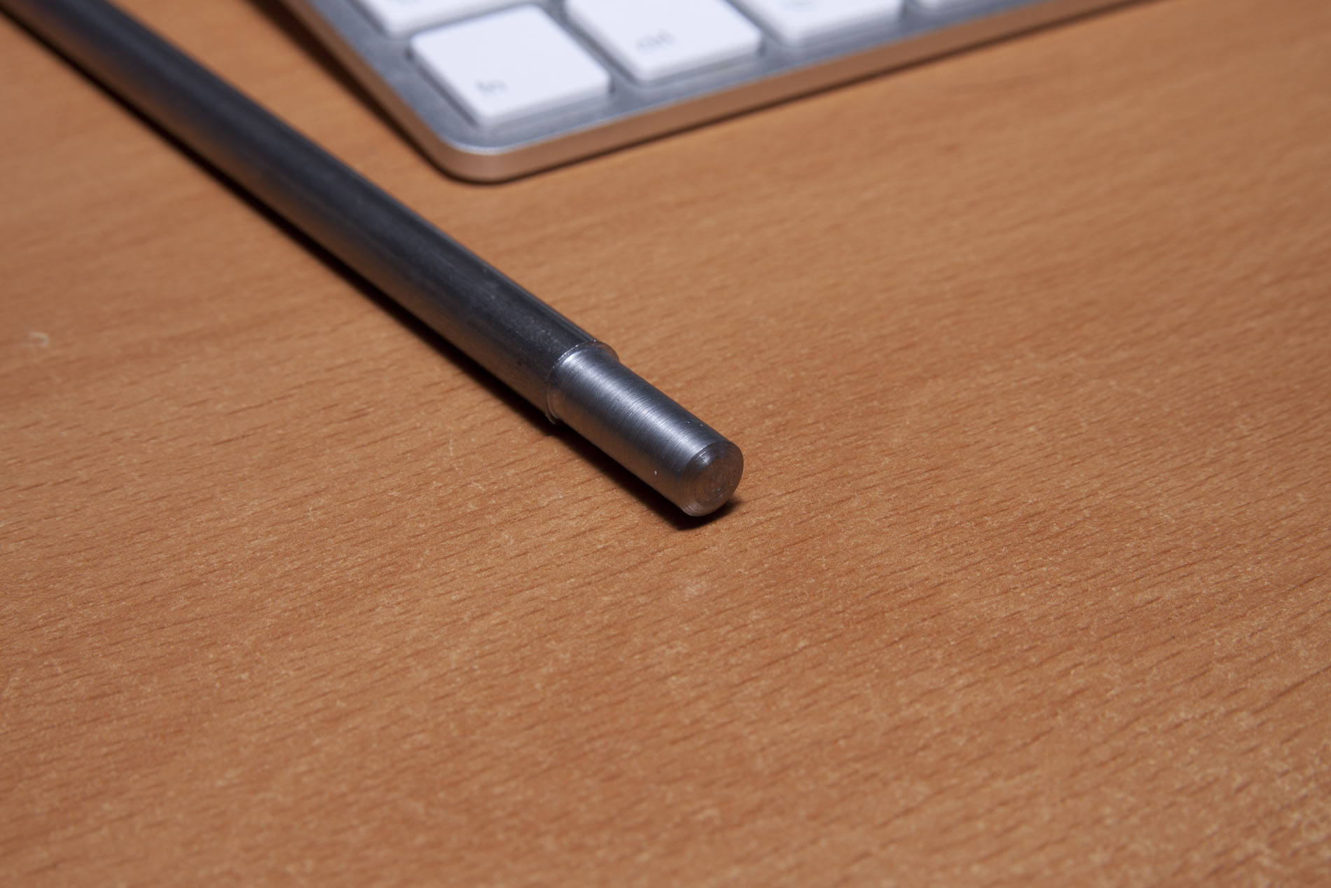

Ah, I never twigged it was a metric screw. The 72/18 is 4:1 and the 54/18 is 3:1 but you got nothing there that comes close to transposing for metric.
I do have a 127/100 that might suit your machine but it'll take some research to find out if that's as useful to you as a 135/127
