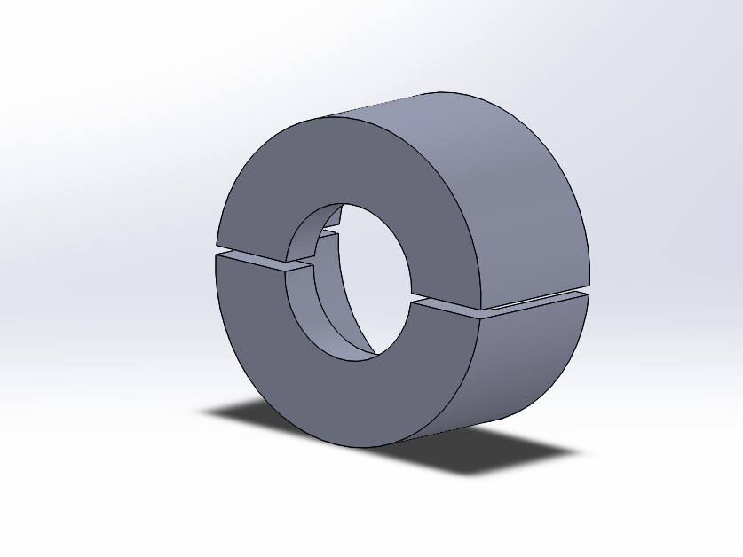

My Computurn is a real PITA, there is no way to get anything out of the tailstock on it. With it being CNC the only thing you ever have in it is a centre but it is worked via hydraulics and there doesn't seem to be an ejector so I had to make up a kind of split collar that slips over the small amount of taper sticking out and it has to have a dia bigger than the barrel, I can now move the barrel back via the hydraulics and the collar hits off the tailstock body and ejects the centre.
Pic below of what I mean. Originally tried stilsons but couldn't get them to grip without damaging the centre and with it being a 5MT it has a heck of a grip.
