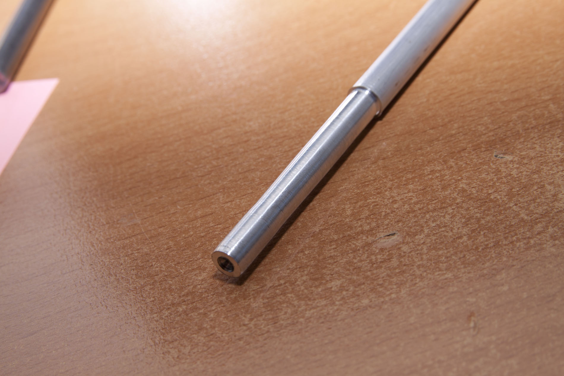

I'm using the HSS tool i grinded a few weeks ago, on the highest speed. Not using the power feed and cutting about 0.1mm.thats probably EN3 (a bright mild steel) and it will look like that when turned. What tool are you using? and what speed, feed and depth of cut?
They'll all make a difference to the finish.
