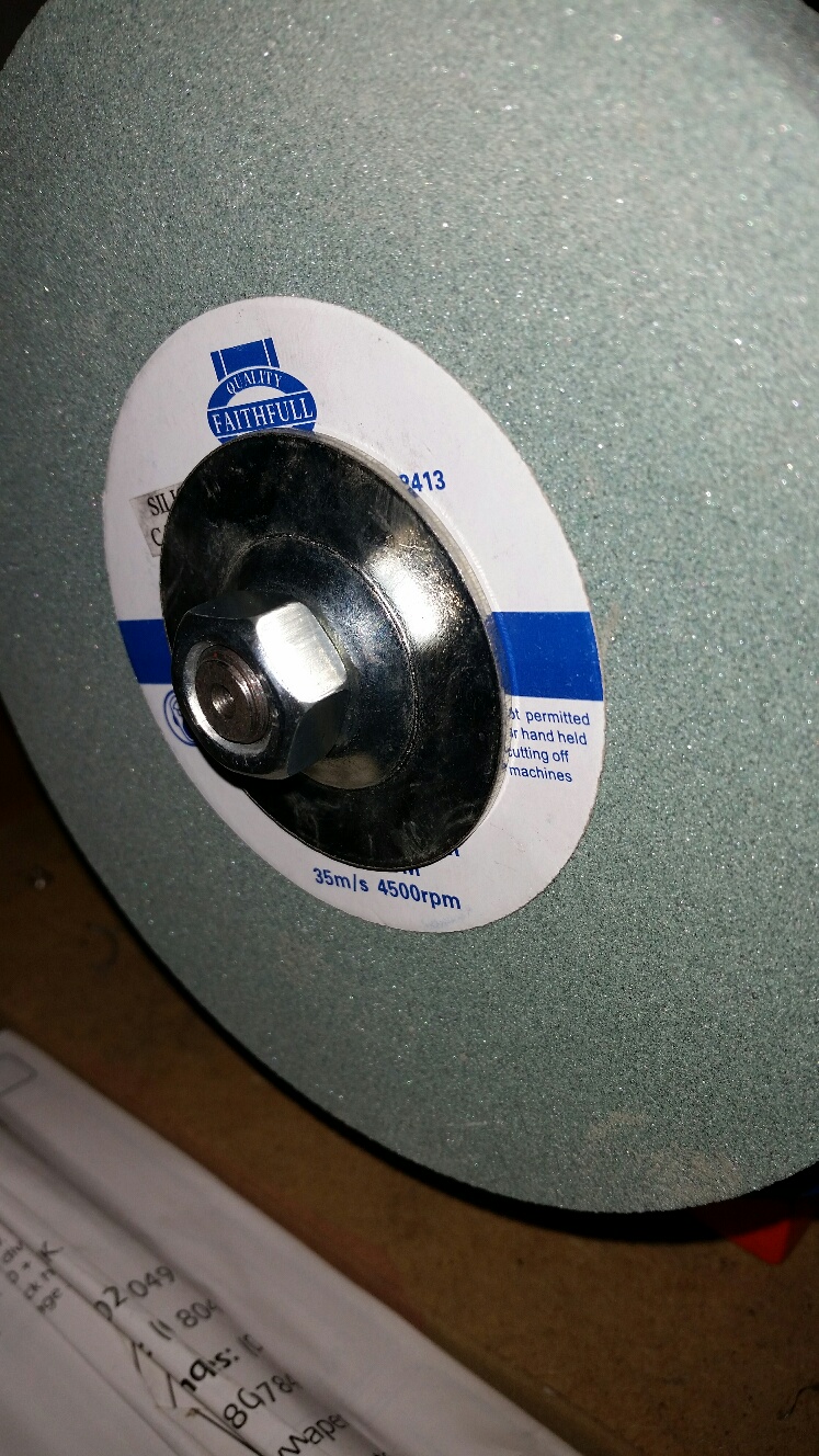

Wanted to grind some more tools today but the grinder is still vibrating the entire bench.
How about making something to replace these?
What material would be best? Ive ordered a bit of 50mm aluminium but don't think that would be suitable. This supplier only has the soft stuff and stainless so will have to hunt for another supplier.
Found this any good as a first project?
http://www.thinking-christian.com/articles/bench-grinder-bushings
I struggled to get the wheel straight then gave up. It was not that bad until i changed one of the wheels. Someone mentioned that these pressed plates are rubbish.If you are meaning the steel discs then I don't think that would be the cause of the vibration, more likely the shaft is bent or possibly the centre bush, if any, are not the right size. Often the bush is just made of plastic so delrin would be fine if that is what the problem is.
I will try the cornflake packet.plastic bush for the middle and cardboard washers each side - cornflakes packets - other breakfast cereals are available![]()

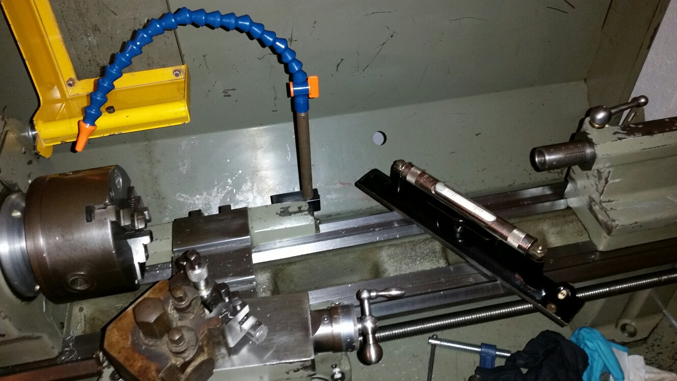

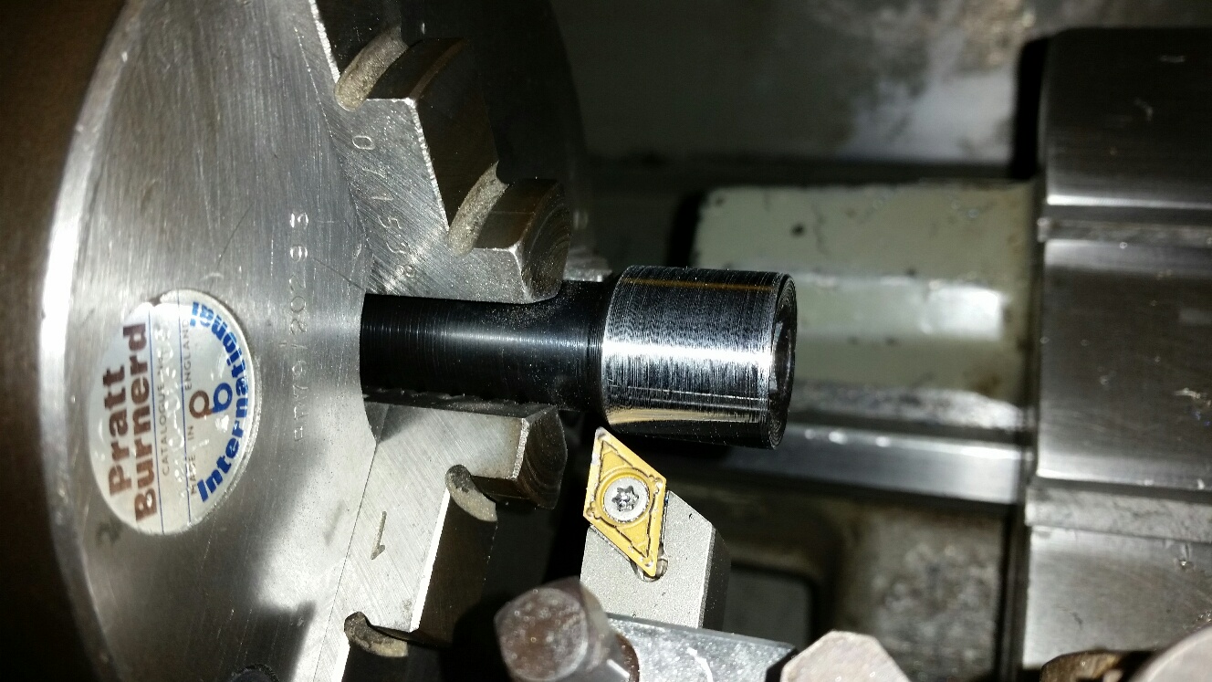

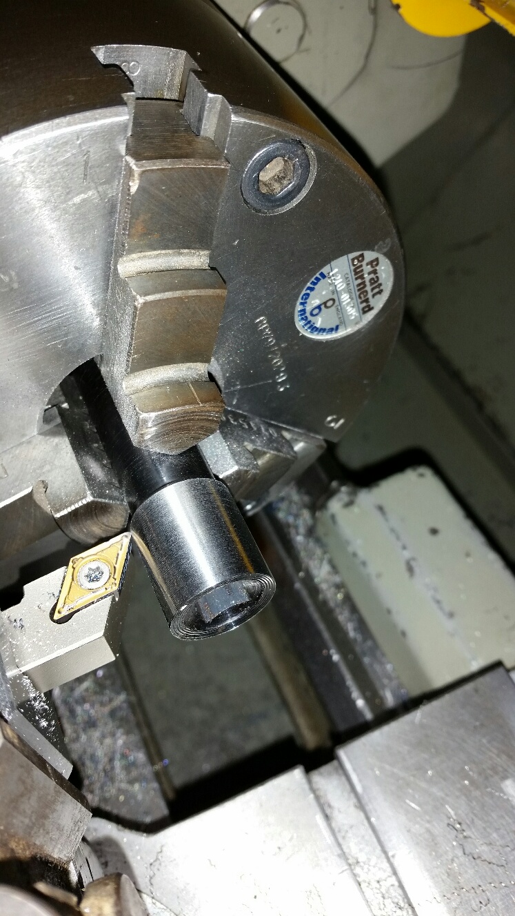

What tips did you go for in the end dazza? I got the same holder in the great Cromwell smash and grab!!Getting a better finish with the power feed cutting 0.15mm. Only another 10 passes.
I bought one mitsubishi insert which i'm using now, and some Sumitomo from ebay.de but think they have been lost in the post.What tips did you go for in the end dazza? I got the same holder in the great Cromwell smash and grab!!
Looking good by the way, must make an effort with mine.
Inserts like a heavier cut.
Cheers mate but you never know how many your going to need! Was just curious as to which type you ended up with - I didn't fancy ordering a load and finding out they don't fit or are rubbish - which would be about my luck!!Edit: if they do turn up i will split them with you, don't need 10.
