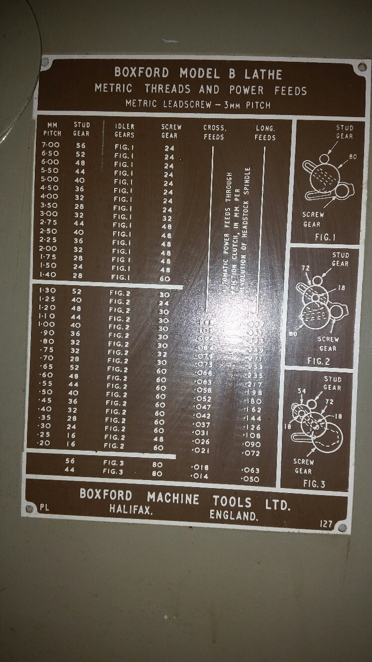

Funny my Denford is the same, had to pack out some of the gear hubs to line the gears up. Mind you Boxford were made by Denford at one time so it's not surprising.
I had a look at my gears more closely BTW and they are the same as the Boxford - the hubs are plain with no keys.
or screws.
