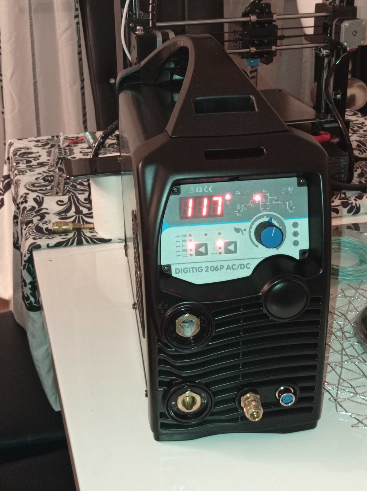

Have you put the machine in pedal mode? Otherwise it acts just like a switch. (Apologies if you have). To put it in pedal mode mode you hold the pedal down for five seconds until the machine beeps and the remote pedal light comes on the machine display. Take care where the torch is point otherwise it might arc up. I am only mentioning this as I was daft enough to get it wrong when I first tried with the pedal.
When I use the pedal on my machine I set the pedal pot to max and then set my maximum amperage on the machine. It make the side pot on the pedal redundant which I think it is anyway. Once it is set up it works fine IME.
I'm a bit averse to chopping new toys up, but that's a good idea. I think I'll leave the packaged torch intact and chop the DINSE adaptor line barb off instead and replace it with an M10 swivel barb instead of getting a 3/8" to M10 adaptor
