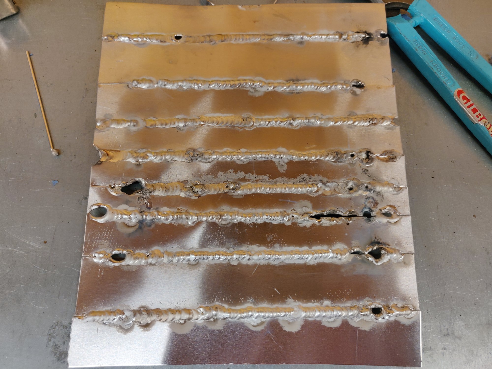

how is everyone finding the sherman, on fillet welds and outside corners how stable is the arc?
On AC it absolutely trumps (no political pun intended) the R-Tech TIG 210EXT I had previously in terms of arc imitation and stability.
On DC it's also better than the above... but not not in the same league as my Lorch MicorTIG, which is DC only.
