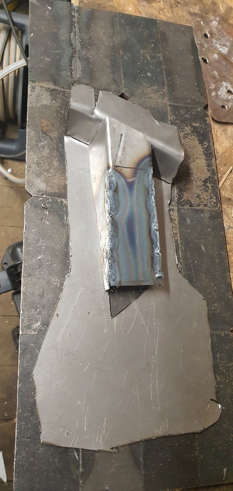

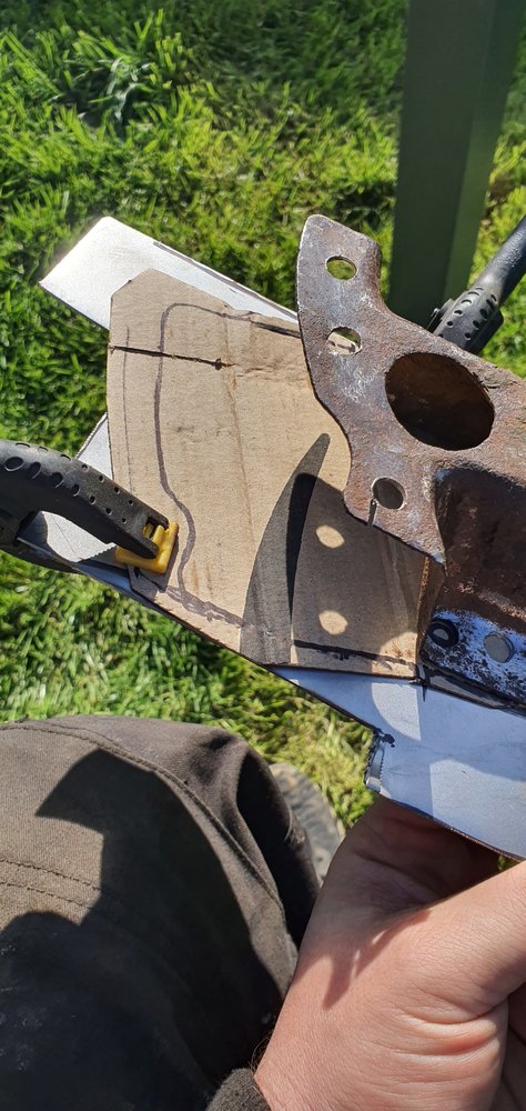

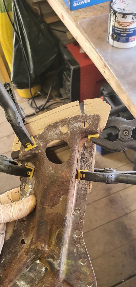

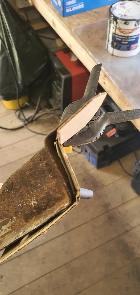

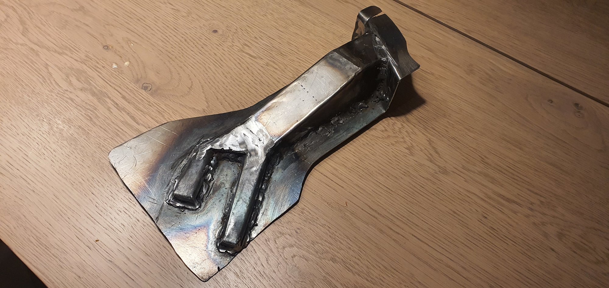

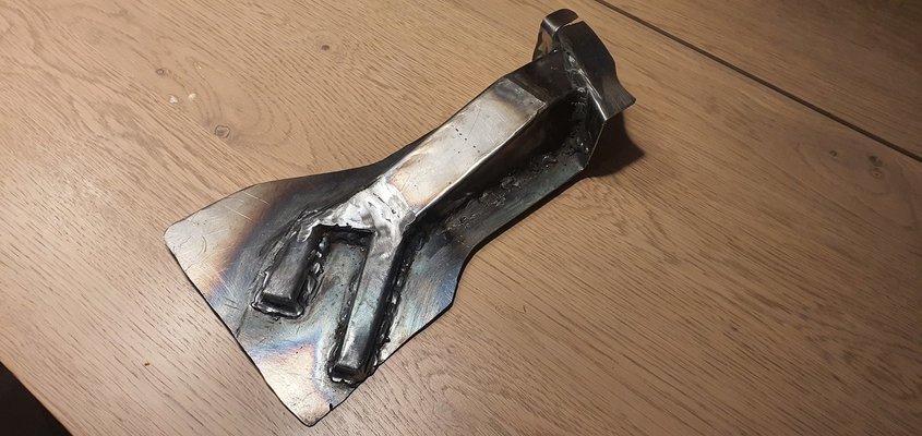

You could use a piece of 2-3mm plate to bend it over, to keep the gap uniform with the originalHonestly I was going to skip it I kind of had it in my head that the lip doubled over on itself is just asking to rust later (although the rest of the shield will probably go first.)
I might get the vice grips and fold it over.
Hahaha... One of the dangers of posting your work on here lolWhat I hear is .... Dan quit being lazy![]()

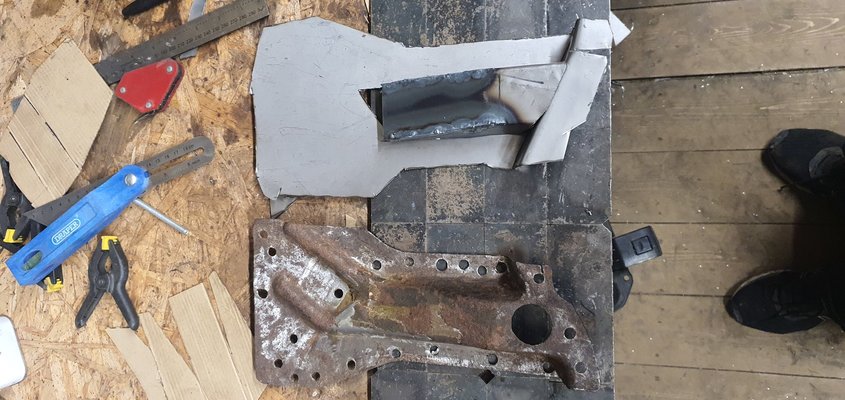

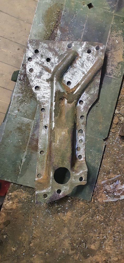

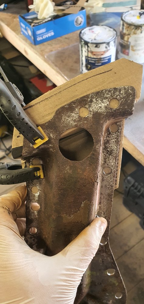

What I did deep was drill through the floor pannel itself woops.... No idea how I would be supposed to plug weld now of I was planning to put this back on the piece I removed it from?

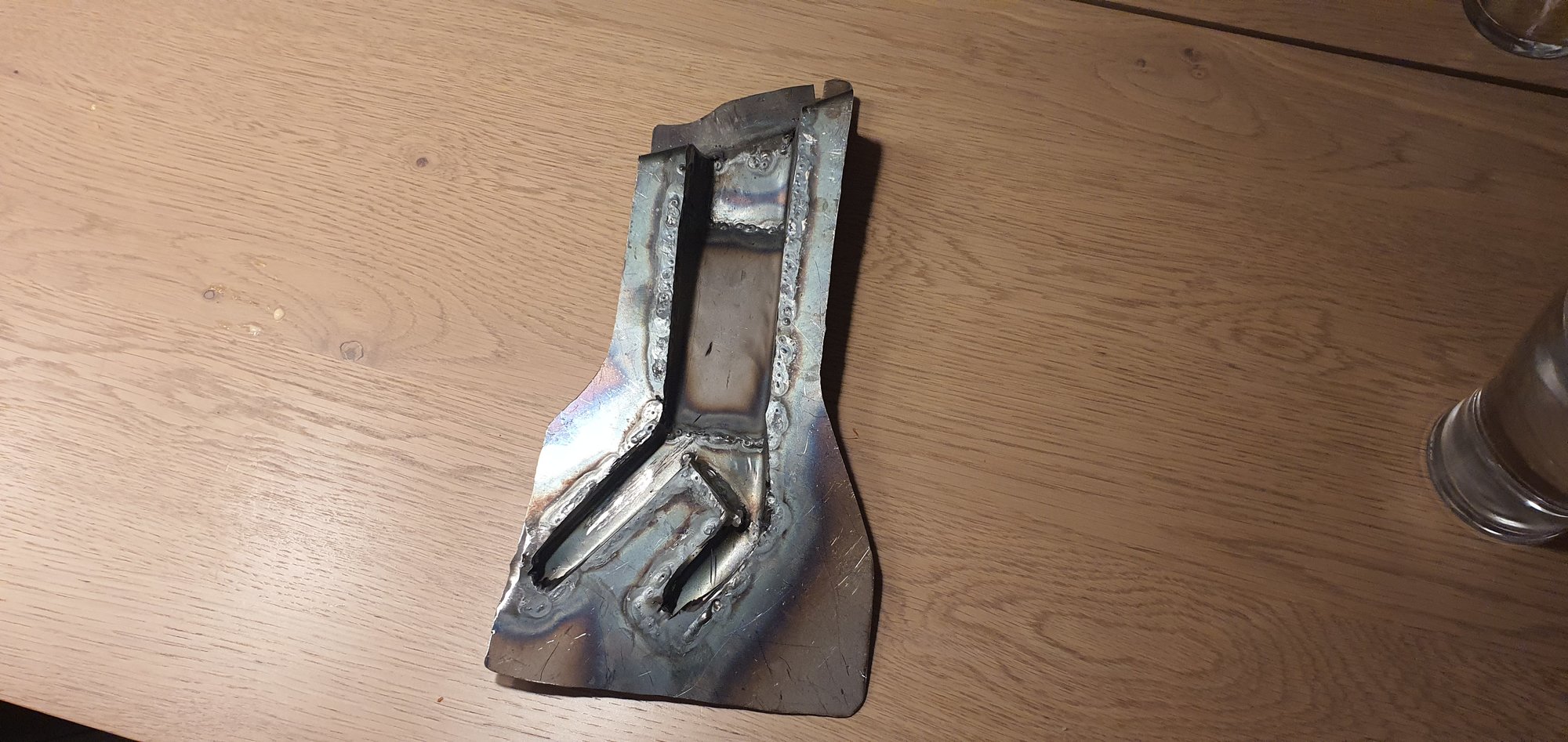

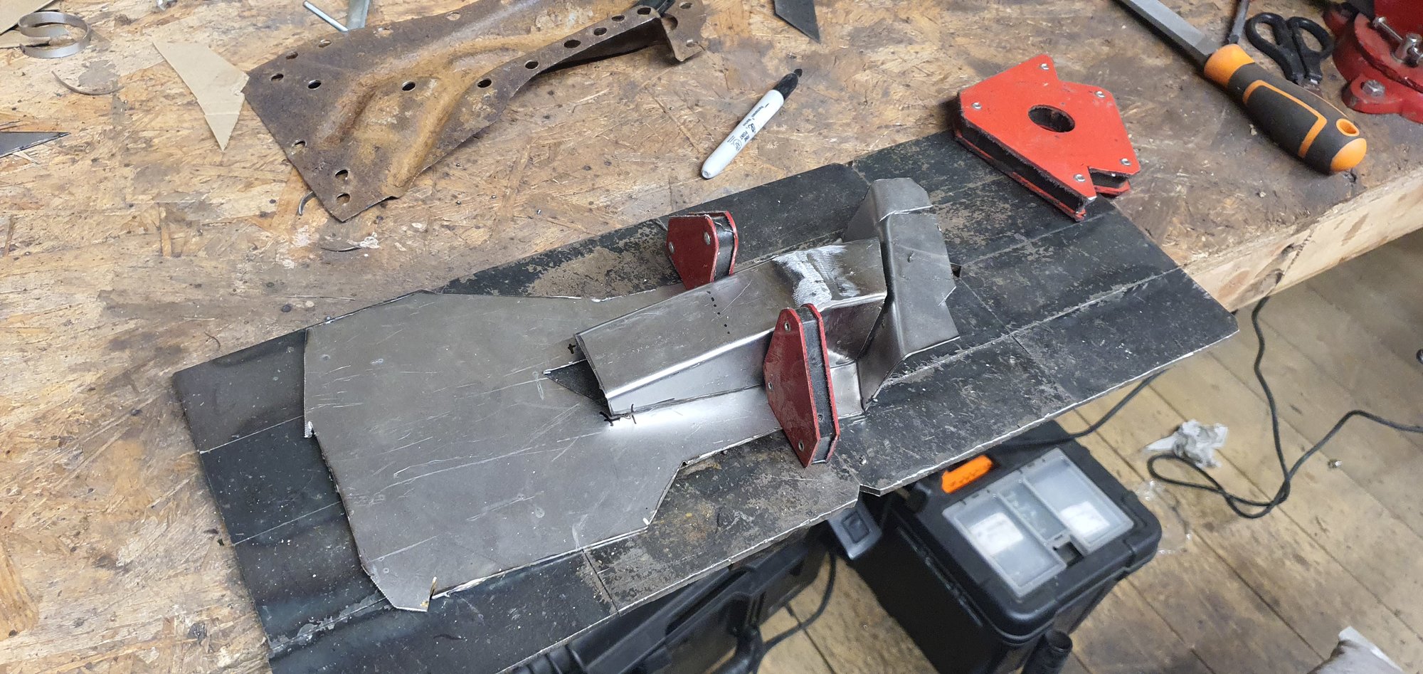

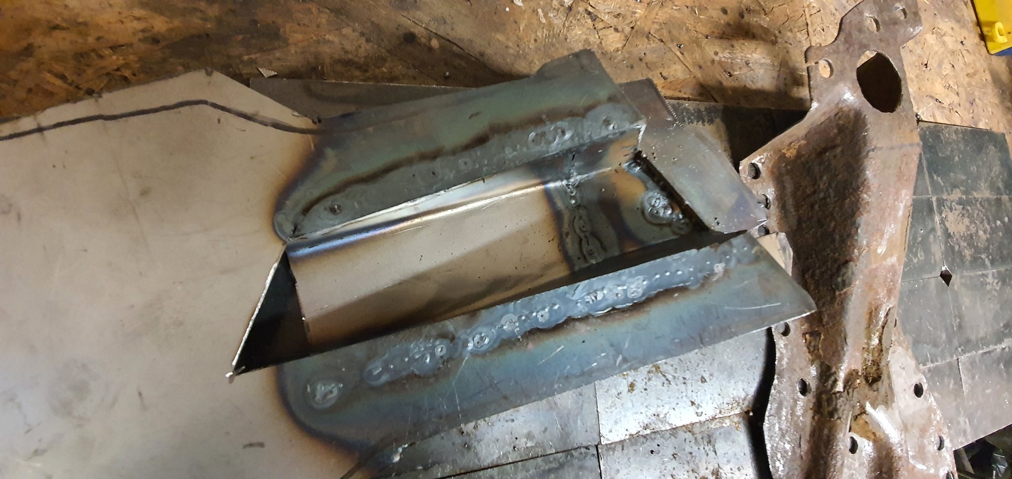

.... If you can't get clamps to reach use clecos or nuts and bolts in the adjacent holes to the one you're weldingGonna try copy the Japanese dudes video and try to fab this in sections with realistic bends that I (think) I can manage.

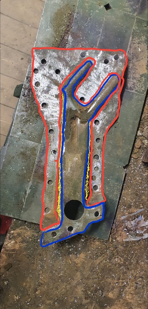

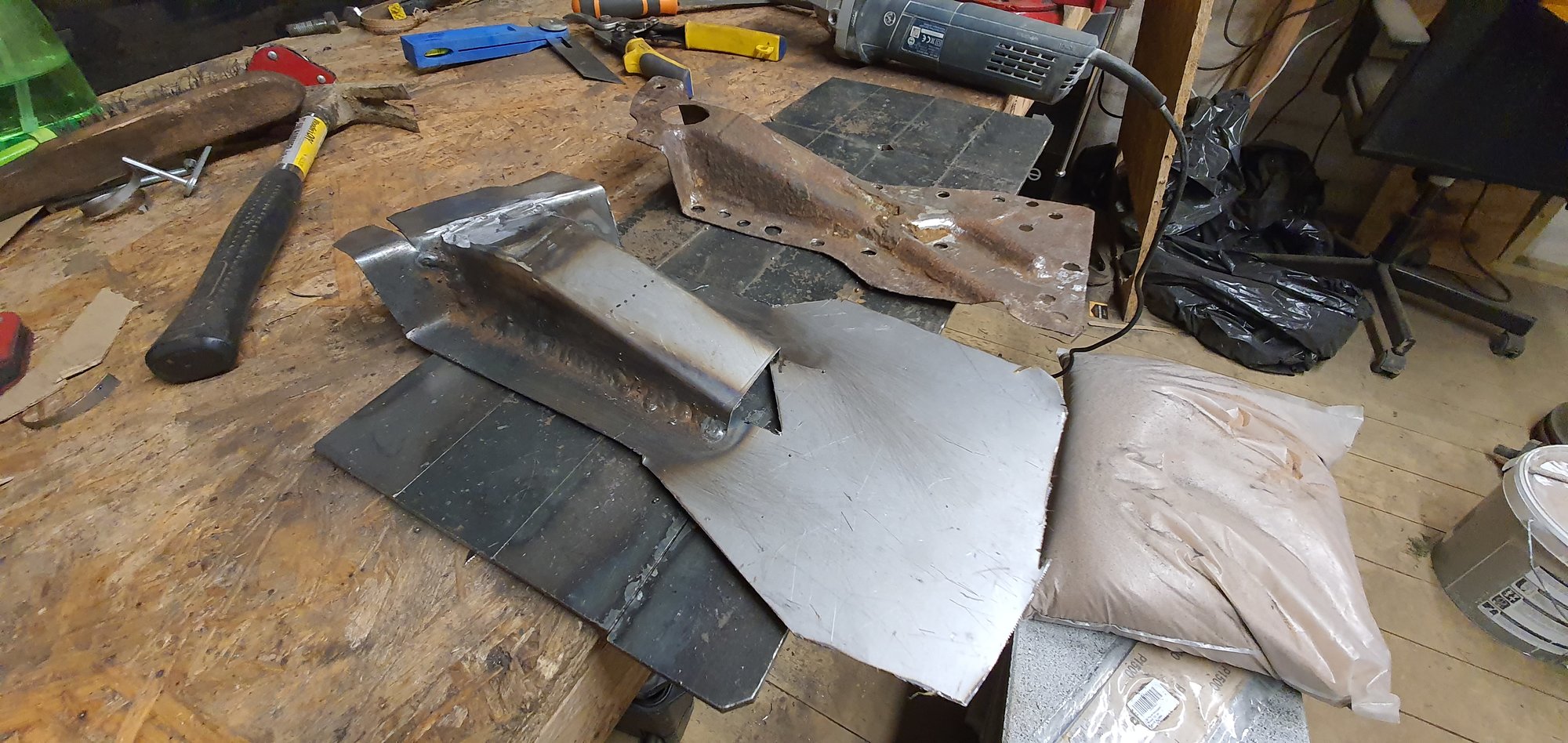

Once you see the below you're gonna say why take up welding because my calling is clearly art...

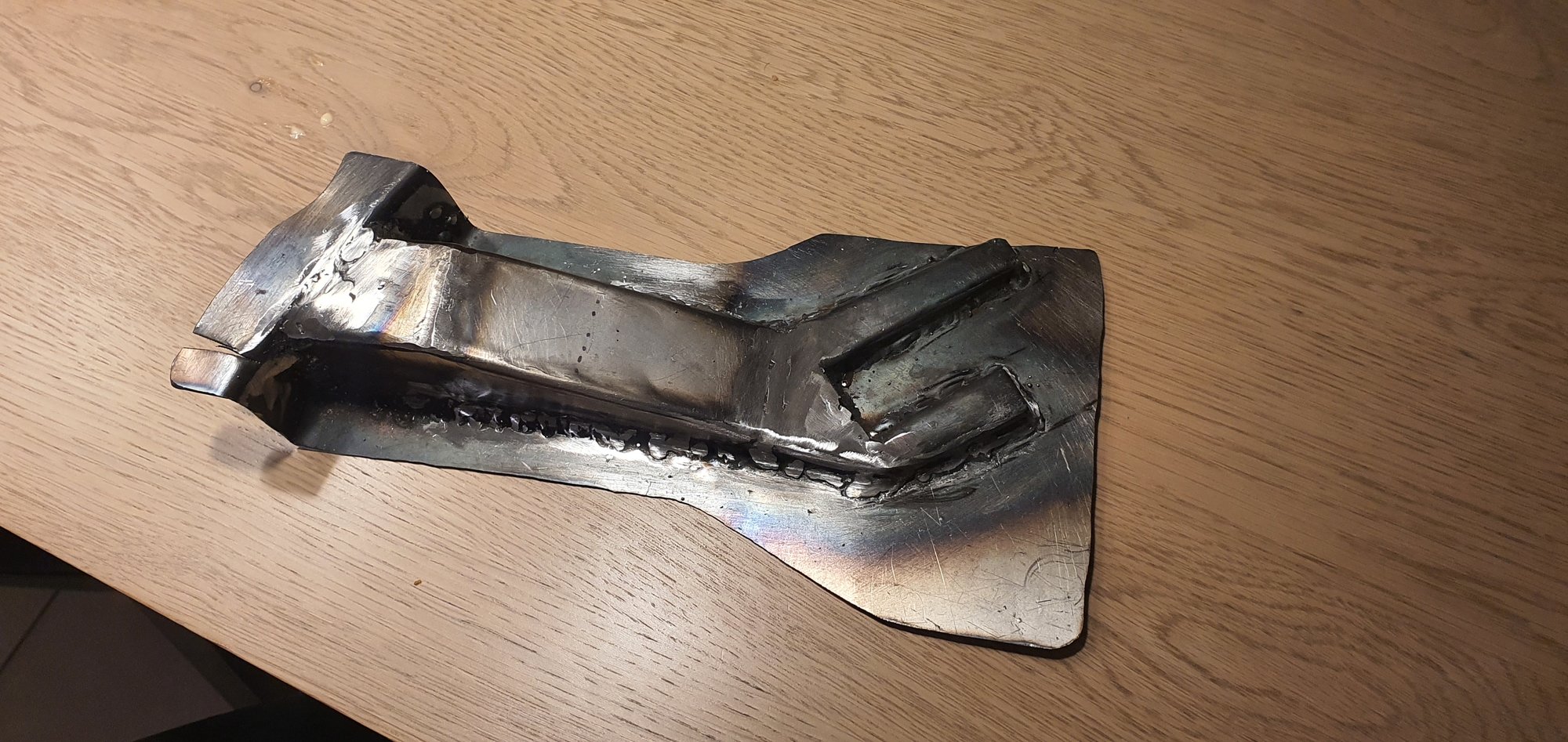

But in thinking bottom sheet can be made from a single piece,
Top piece the blue and then the yellow the side panel.

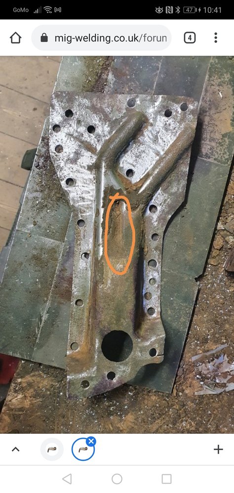

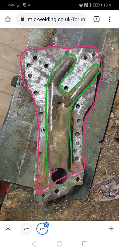

Do you mean this:I was going to ask if I could skip element's of the fork up the top but this is for the jacking point so I assume this to probably add more strength to the floor and rigidity to the overall piece. So I'm gonna try keep these in.
@Myles1970 how did you add the dipped section to the floor pannel you did? I'd like to try replicate that dimple in the top middle piece just below that fork.
