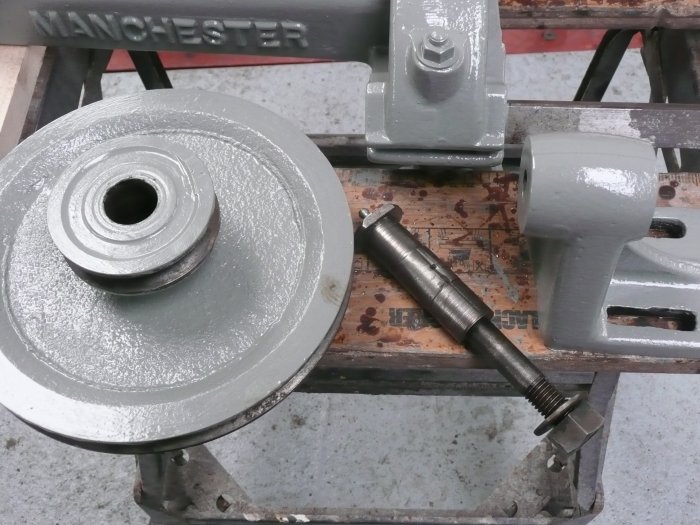

I had a closer look at the pulley tonight and I think your right BS, I'll finish filing it and leave it.

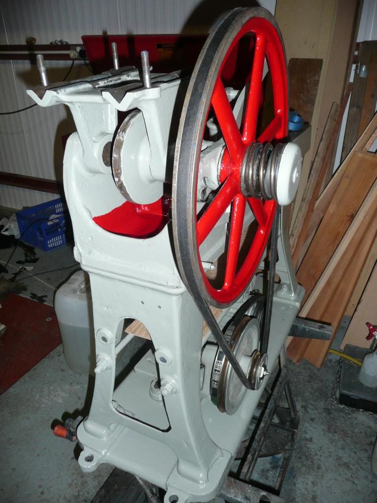

She is completely stripped now apart from odds and sods where the casting is rough. I've started to paint some components, the paint is like cream cheese because of the temp but is not getting a bloom on it. Painting by hand, I wouldn't attempt spraying in this temp and my fan parafin heater only takes the edge off. I take the paint into the house to warm up between sessions which seems to help.

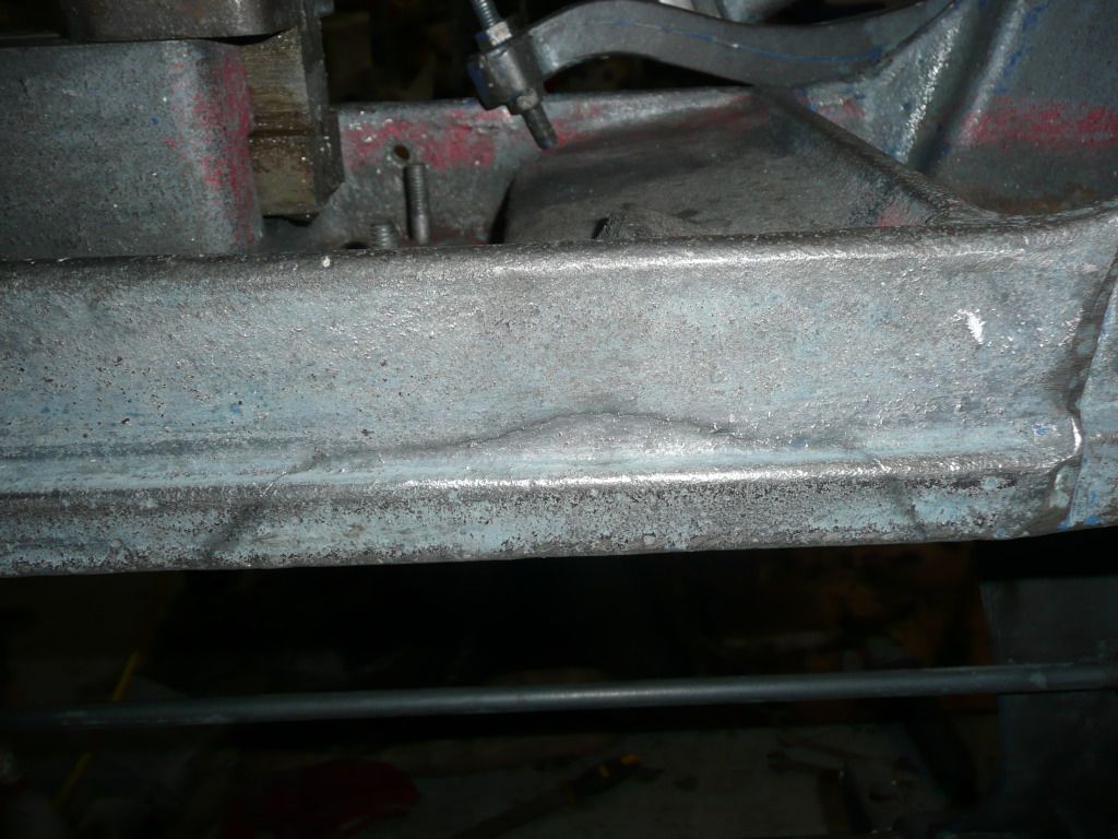

Here she is stripped off, I noticed some more cracking now the paint is off, you can see below and to the right of the vice on the egge of the main casting.
Here's a close up of the crack, it doesn't extend to inside the casting where it contains any suds and doesn't seem to move when flexes so I'm going to leave it well alone.

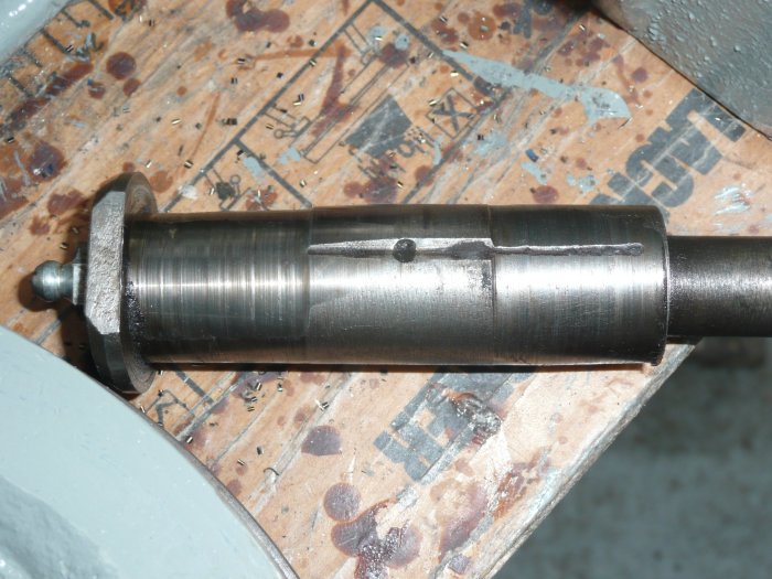

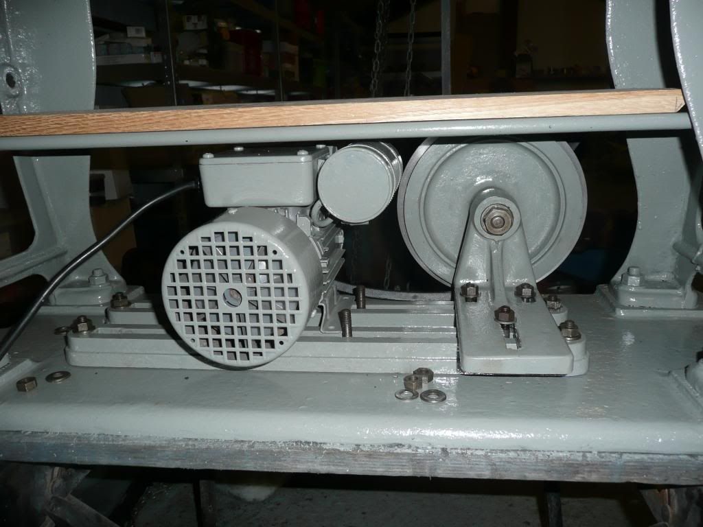

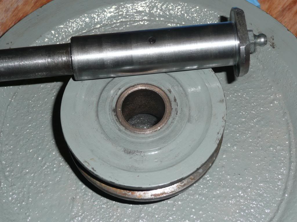

Most of the bushes etc. seem to be OK, not bad enough to strip down considering the use I'm going to be putting it through except the spindle for the intermediate pulleys between the motor and the hacksaw. This is well worn, Except for that I only need to mend the handle that operates the clutch and the suds pump.

Also can't get right up to the shoulder with a grinder.
