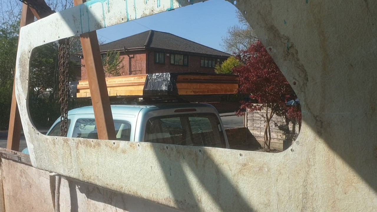

    Yesterday was the day for serious plastic surgery, as there was nothing else to do i cracked on with what i can again.
    As some may of seen i marked up the cut a few times and undecided how i wanted to go about it, This is not one of them things you can jump in straight away.
    Few reason i went with this cut.
    I can keep the height of the lower window edge so i can see out the windows when seated, if i did the lift all around the gunnel which would of been easier the i wouldnt of been able to see out due to the 150mm lift.
    I can have more room under the rear deck for the engine, the deck/engine lid is raised at the minute by 100mm to clear the engine this way i can now have a level rear deck.
    And to slice off just the roof at the top and lift it would of been a pain with little gain ( still have a low rear deck ) as there are a lot of profiles on the rear bulkhead to get around to section back in.
    Front section that will be lifted first to come off.

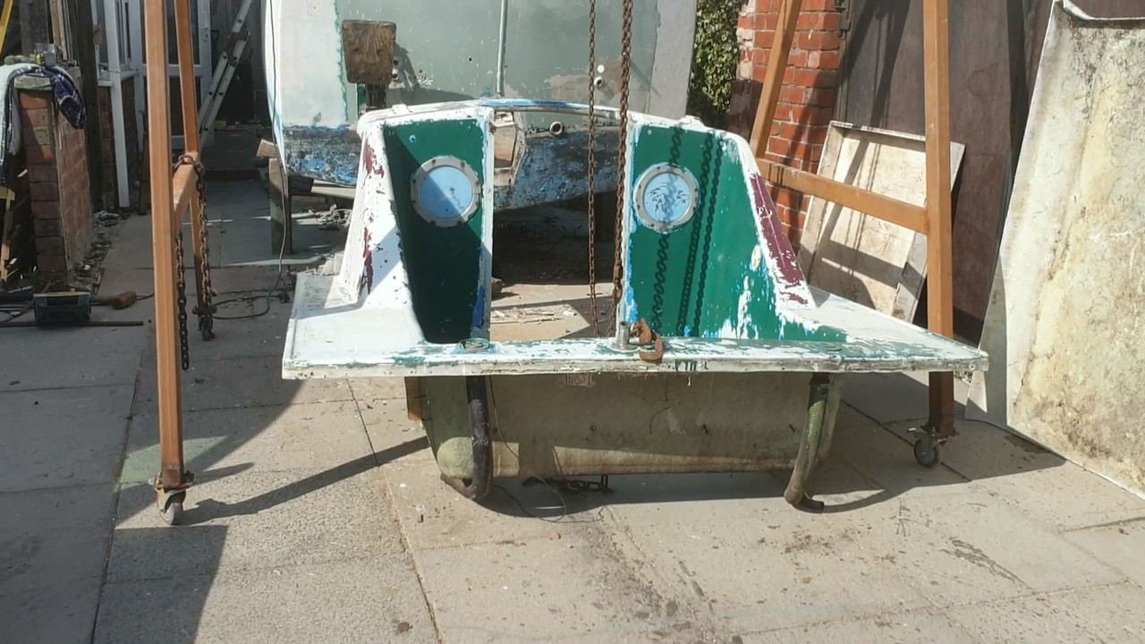

    As there are many screws from original manufacturing to new strakes screwed on over the years, all these had seized in so need cutting out. only one way to do so unless you have hours on end to waste drilling them out and using pliers etc. just get in with a cutting disc in the grinder. Will have new gunnel edge anyway made as part of the lift.
    [​IMG]
    On the inner side of the gunnel edge most boats have the superstructure bonded to the hull section. I was expecting ths to be a reat pain in the rear but not that bad, all of 5 mins cutting the join..
    [​IMG]
    This has a small timber batten in
    [​IMG]
    Then ensure it is separated from the hull as dont want to lift the while boat and lift away.
    Gantry in place
    I had to do it at 45 deg first as i couldnt get in to cut the transom bonded edge,
    [​IMG]
    [​IMG]
    [​IMG]
    [​IMG]
    So all to do now is stick it back together , i have materials on its way, still cant get any timber needed to brace it but once i get the front section back in place and then if i can find some PIR sheets i can make the bulkheads.
    Time to clean it all up, add/laminate the 150mm / 6inch to the roof section and the gunnel edge of the stern section. Lots to do now but little to show due to this dam lock down, got to watch the pennies now so cant spend on the boat to much until we know whats going on. Shame as next is to make the extension mould and we have such good weather for it.

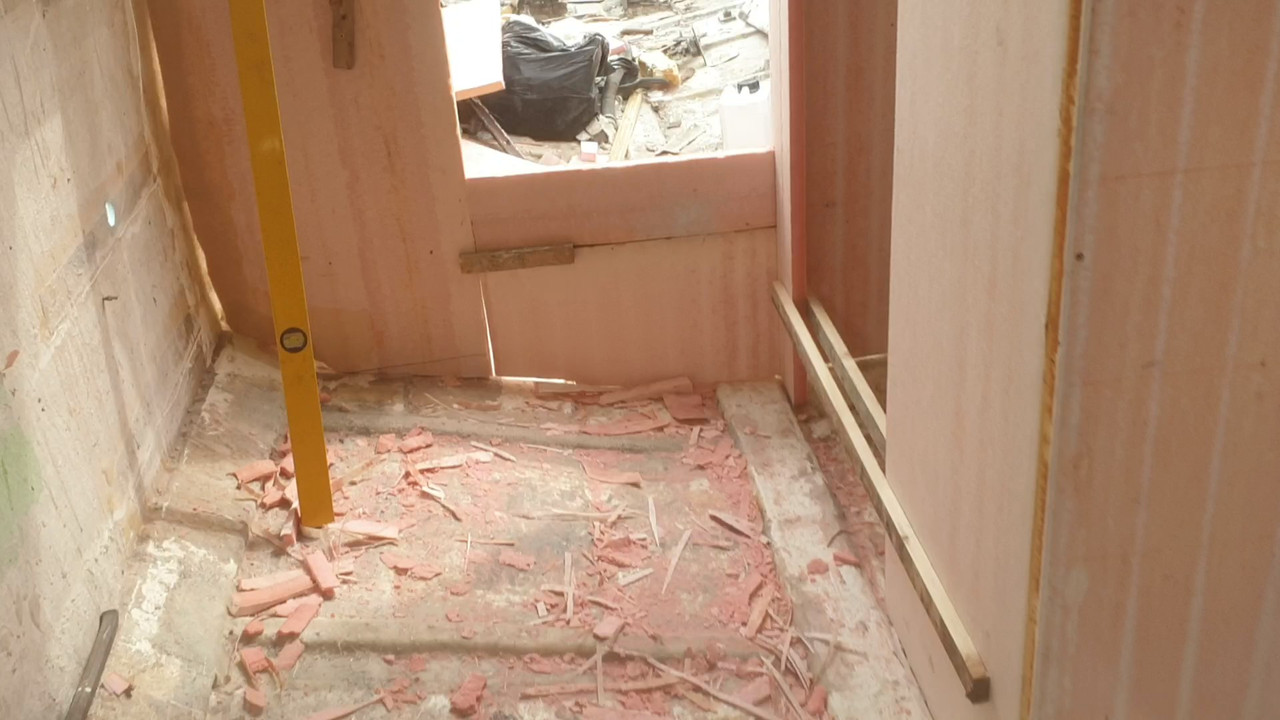

    So the rear section has been butchered so i cant di anything on that yet for a while so i may aswell crack on with the front cabin. Being fitting new bulkheads and the Heads room walls.
    I had to go out to get supplies for work so while out i got some for my own boat. MMMMmmmm why have the letters gone chunky ??
    Anyway i can see them better now ha ha.
    Well i found this place pretty local as i didnt want to go far from home even for work and glad i searched as i found these PIR foam at bargain price 1/4 of what i usually pay. Factory seconds though but no massive damage to them. 25mm /1inch thick for the Bulkheads and walls and 60mm imperial, not a clue @vas sorry lol but near 3 inch.
    The 60mm is for making the hardtop canopy later on in the build.
    All walls, and Bulkheads will will laminated in place to a thickness of around 6mm - 7mm ( 1/4 inch ) either side with 600grm CSM and 300grm Woven.
    [​IMG]
    So much of the itchy n scratchy going on here upload_2020-4-29_16-53-30.gif ground/cleaned all back.
    I ddi start with 1500 / 6 inch polisher with 60G but these are quicker
    [​IMG]
    [​IMG]
    [​IMG]
    I used timber to keep the sheets straight as possible.
    [​IMG]
    [​IMG]
    The deck height here in the door way is going to now be dropped as the step down will be in the deck not in the cabin. It will interfer with the Heads door opening.
    [​IMG]
    Under the deck will be the FW tank, of around 650 litres. I am debating if to have the batteries under there aswell, or above deck in a locker to one side.
    And this is as far as i got as ran out of materials and as i was off on a job at last upload_2020-4-29_16-53-30.gif and as i was getting them materials i got some more in, so again reducing my travel with the darm lock down.
    I managed to get one side of the Heads done but that was it and now .......

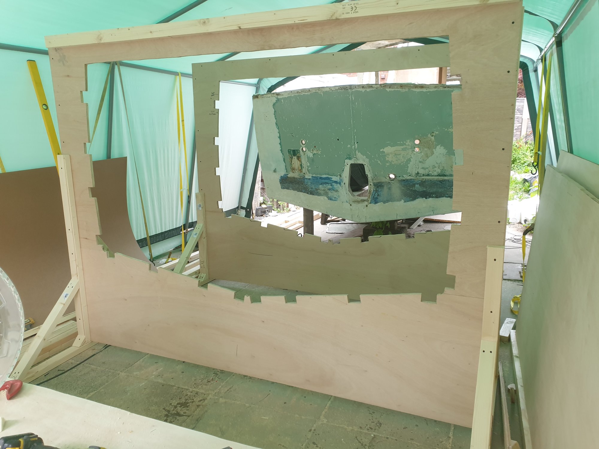

    20 foot x 12 foot or 6.1m x 3.7m. I will need to sit in on a raised bed of some sort as its 600mm low.
    Hey i mite just spray paint the boat now, in two halves but still be better than brush it upload_2020-4-29_16-53-30.gif

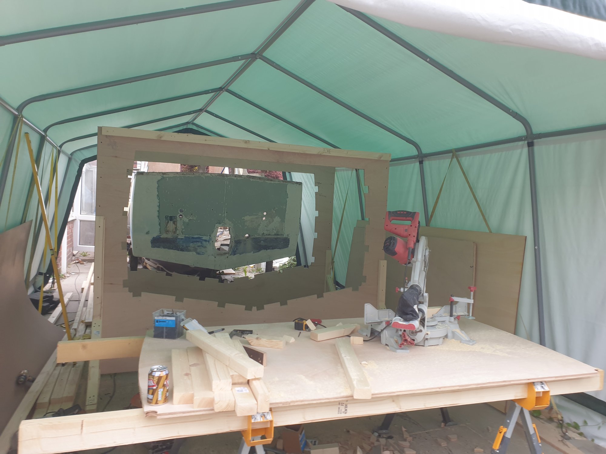

    Location:
    Radcliffe, Manchester
    Afraid nothing really due to work kicking off big time. I had half a day last week trying to line up the mould profiles etc but struggling to do so. Spat my dummy and that was that lol.
