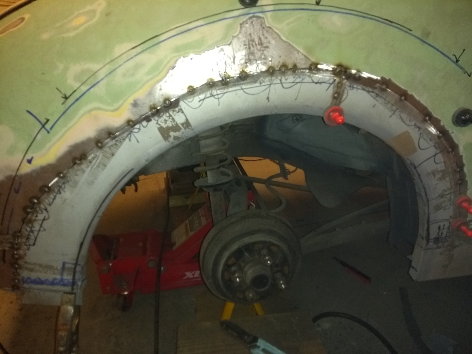

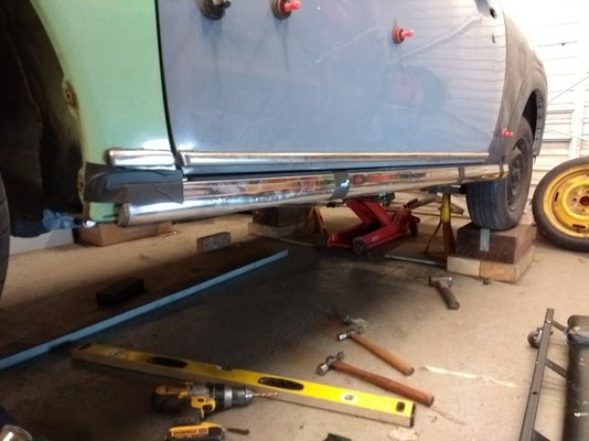

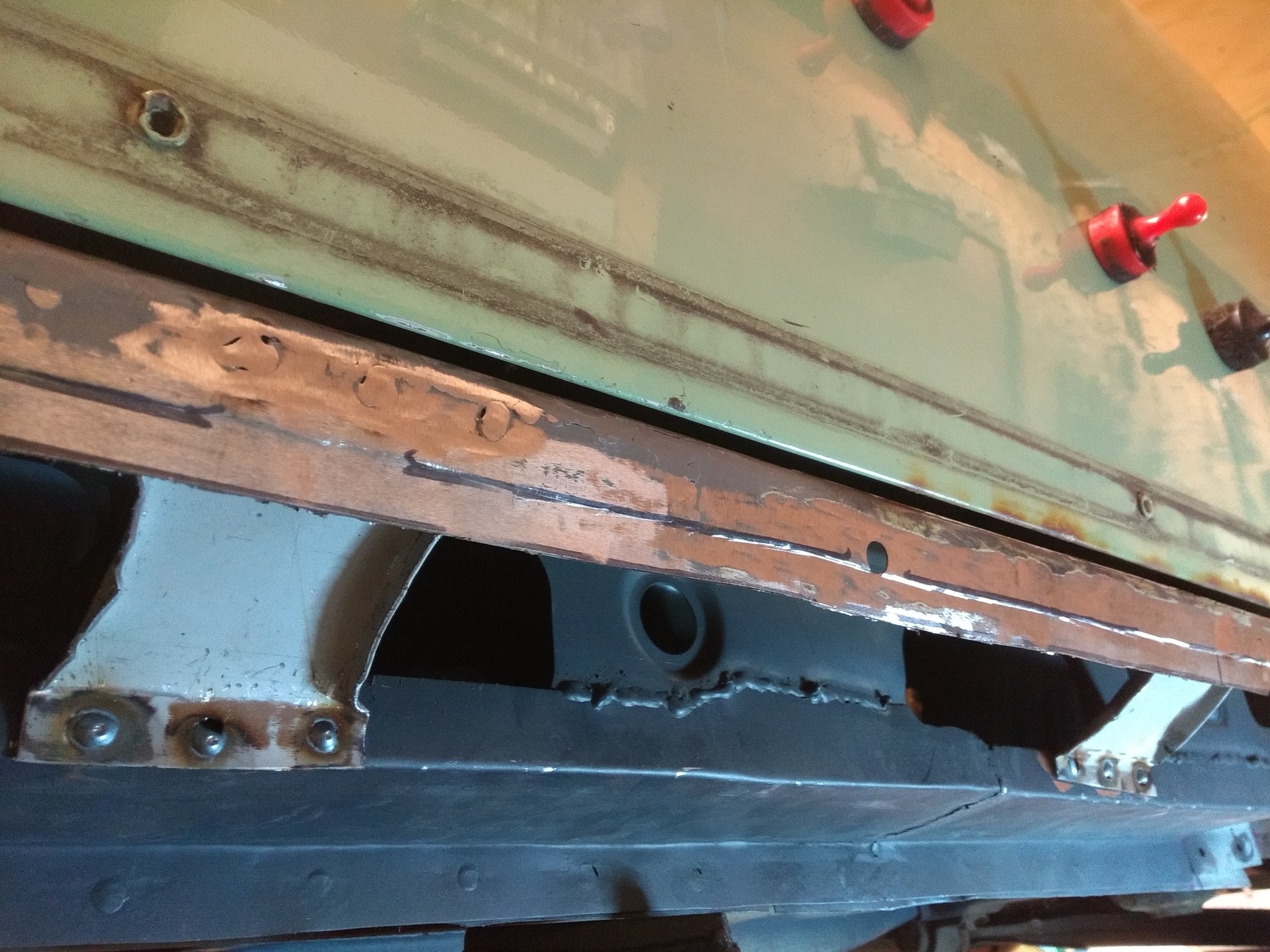

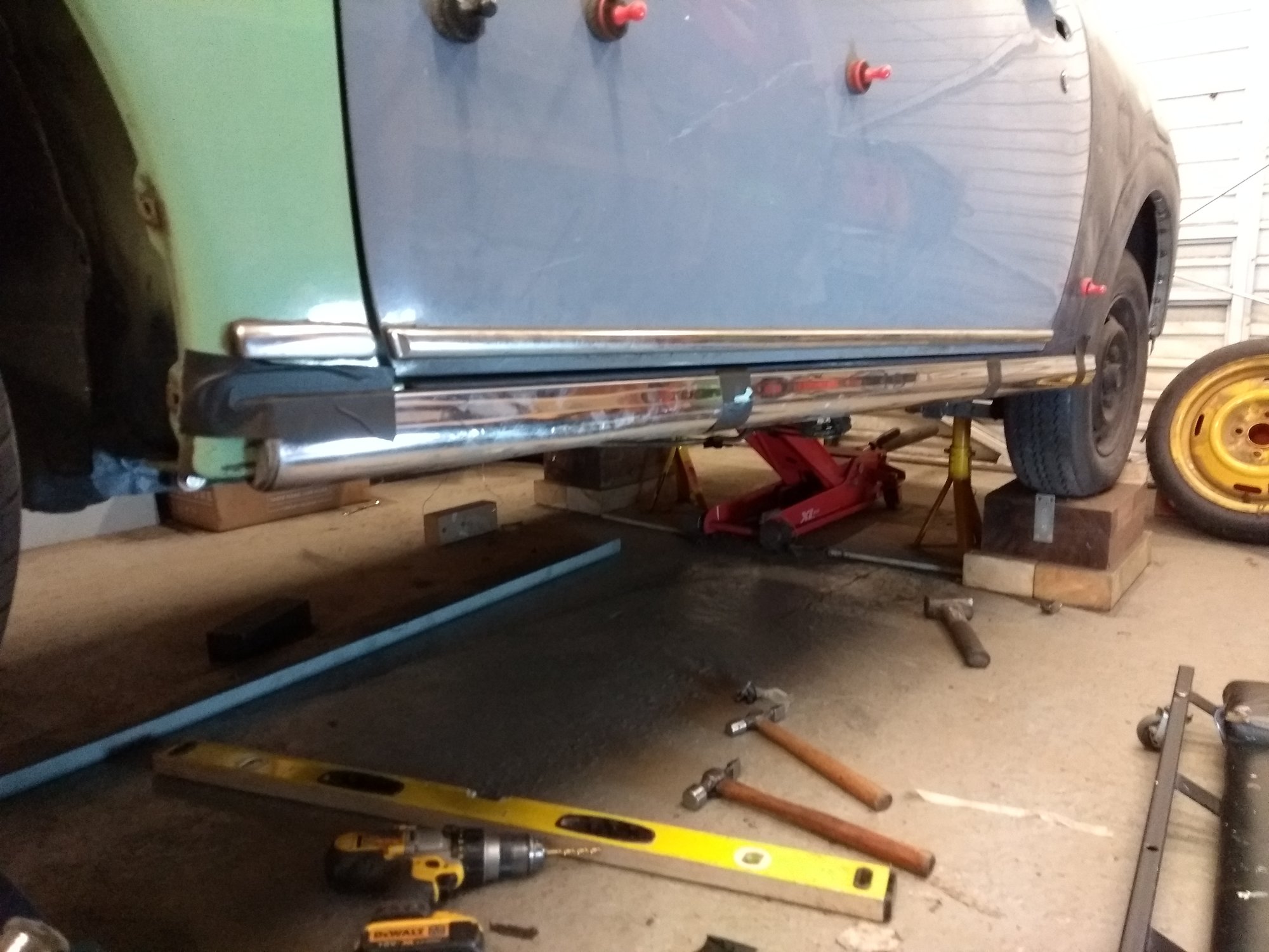

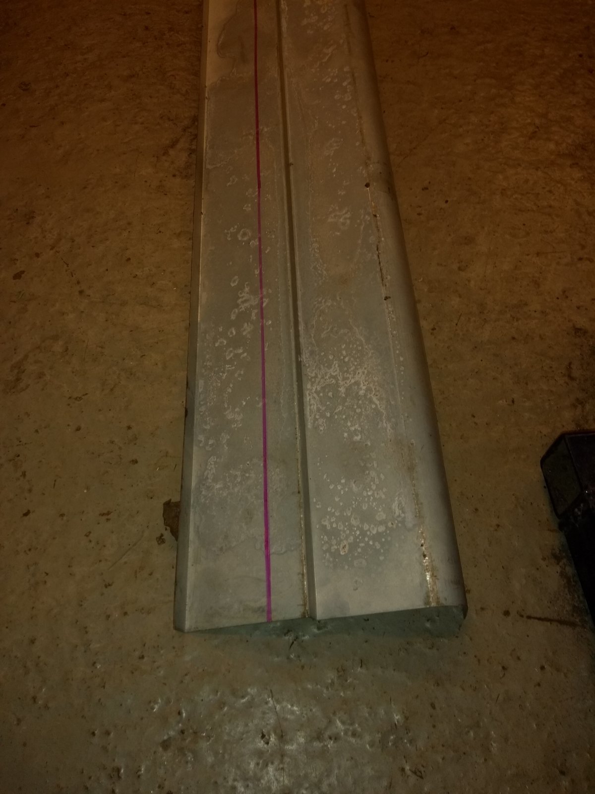

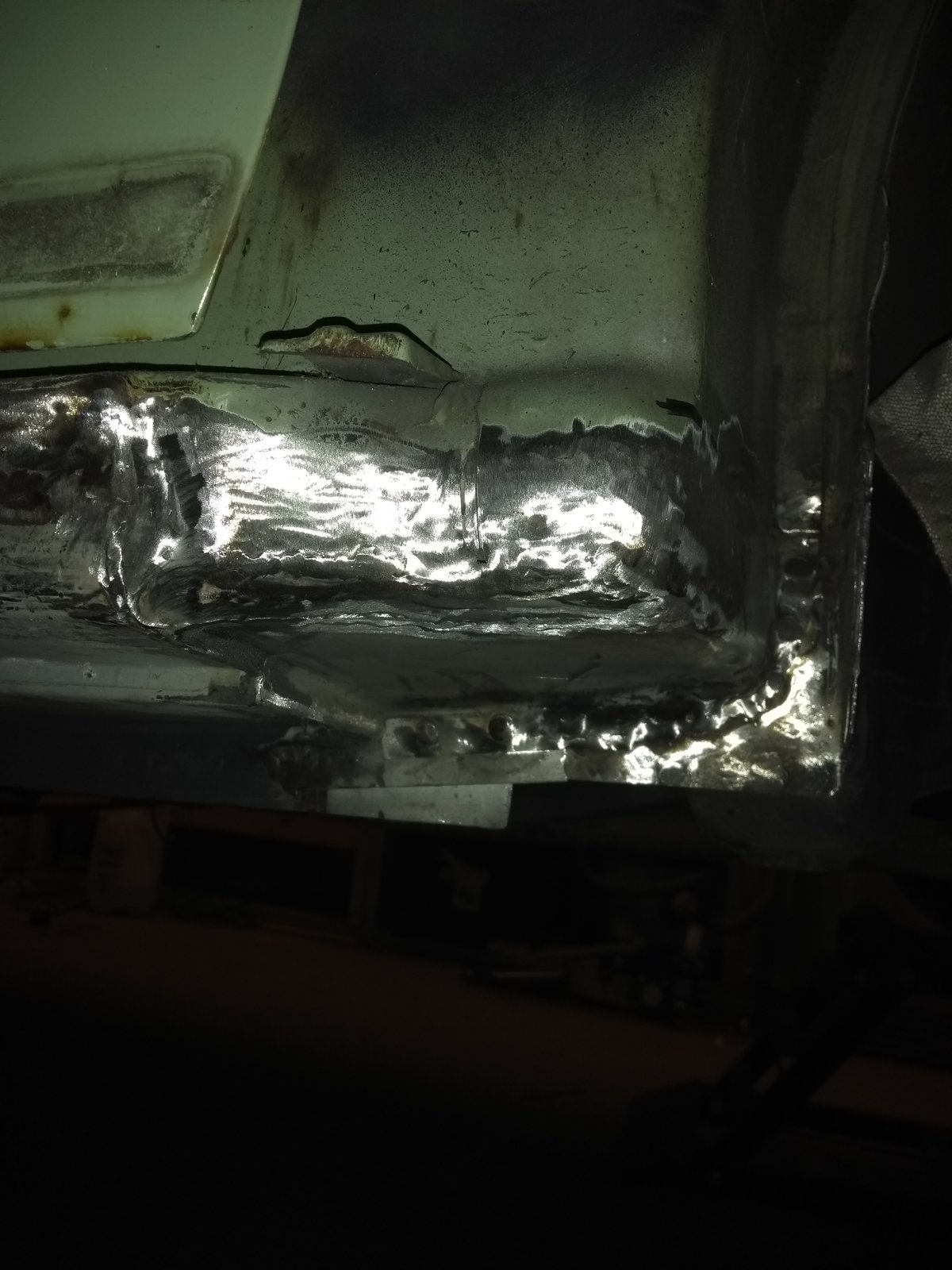

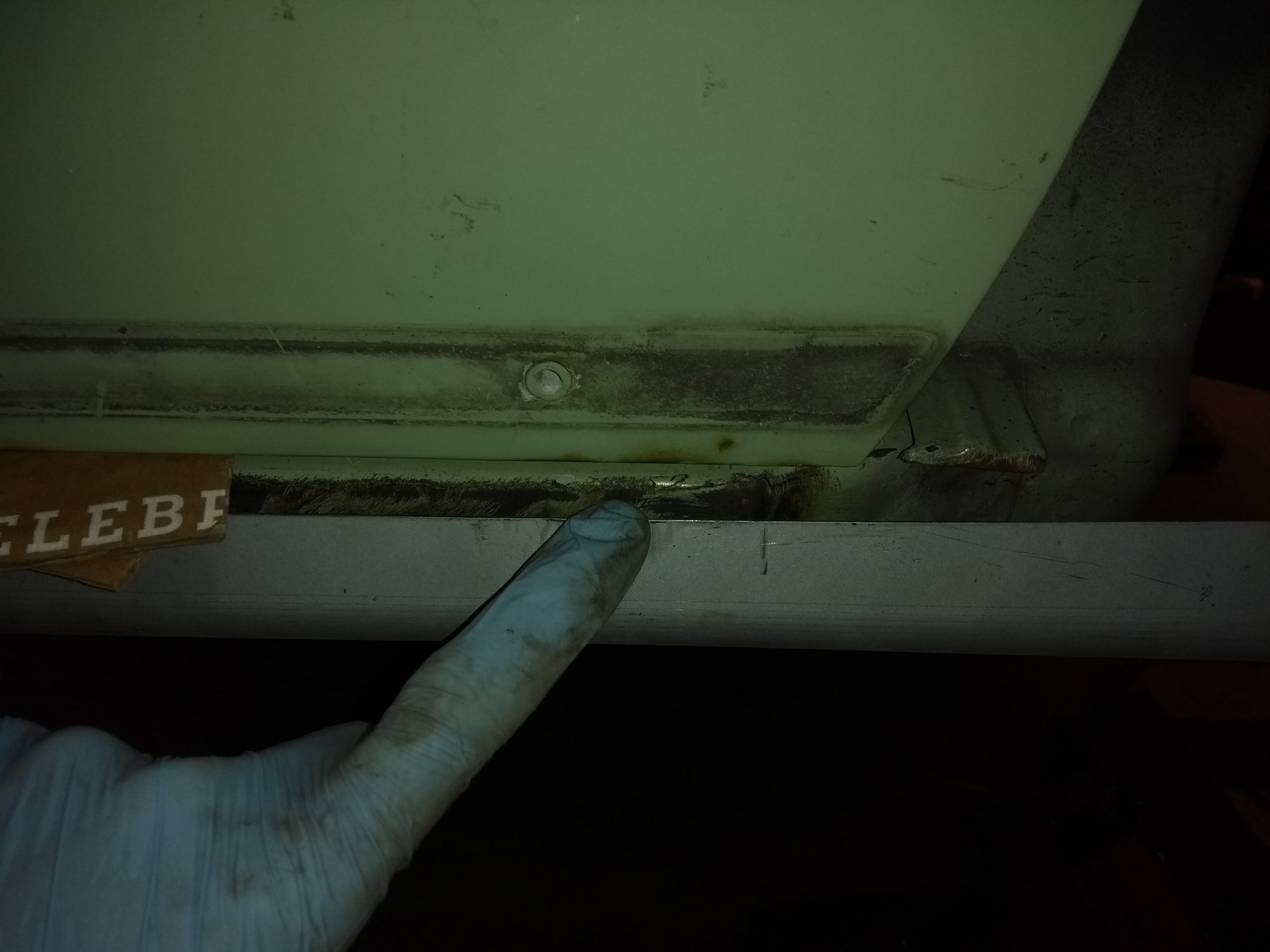

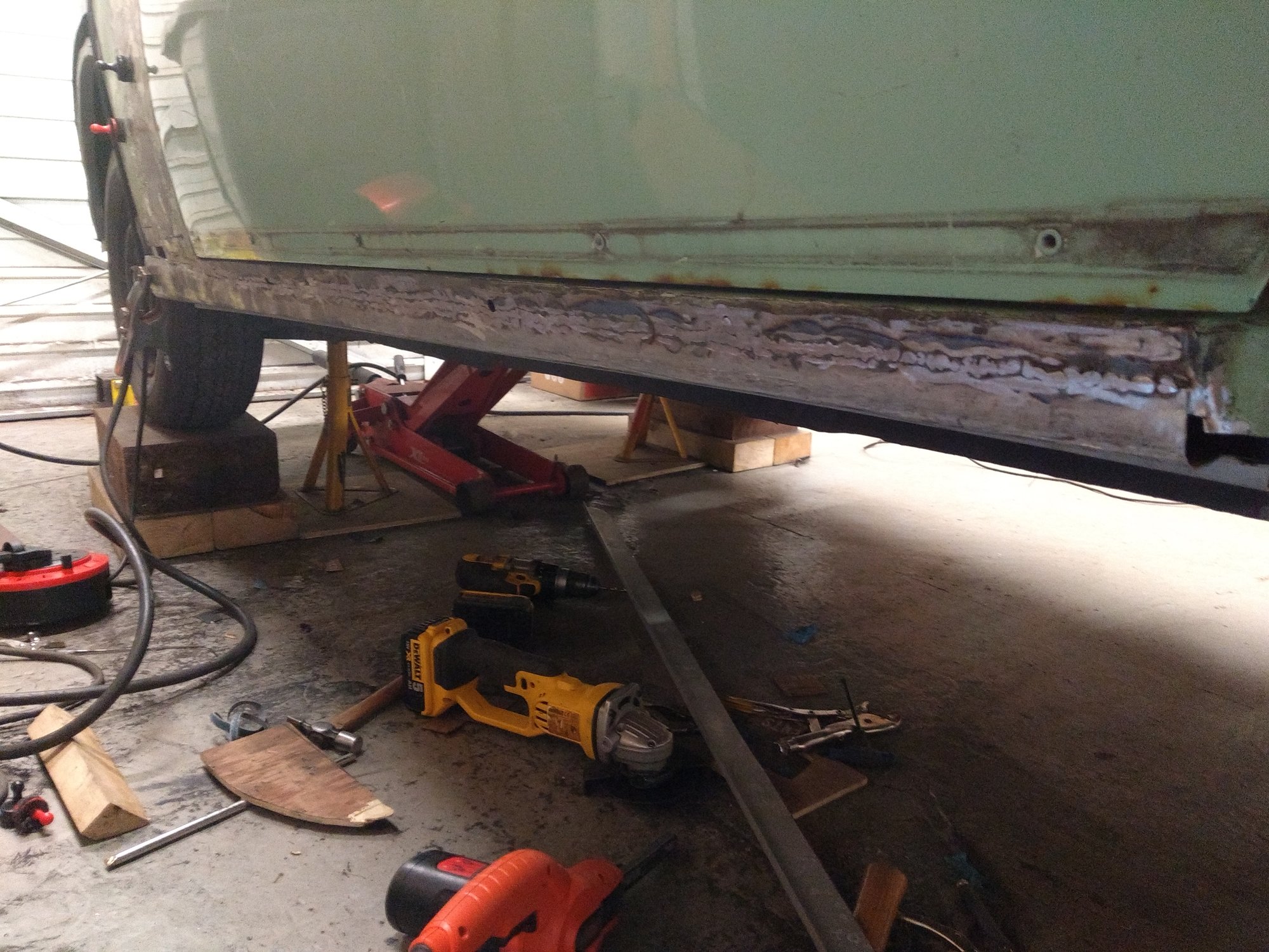

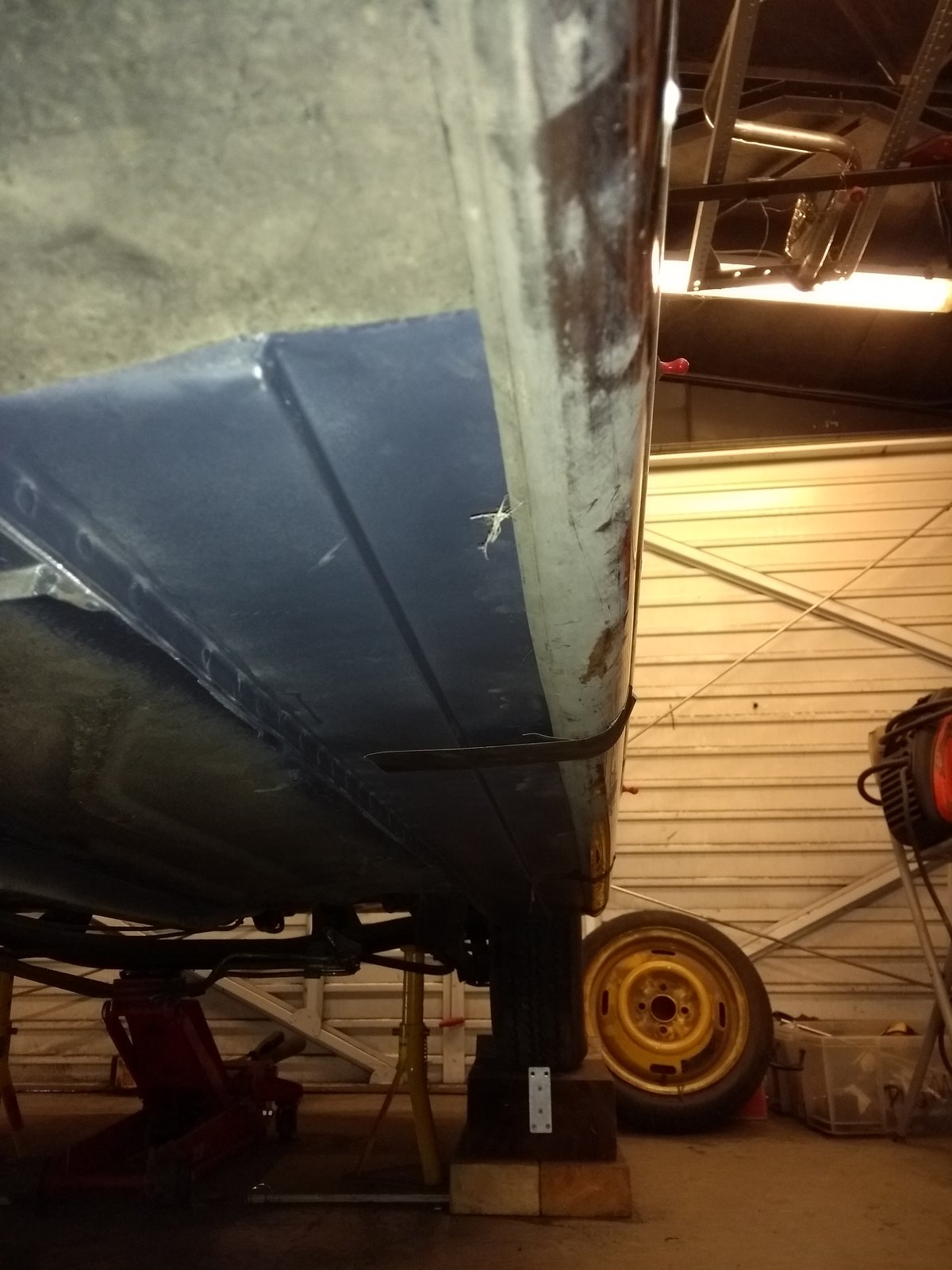

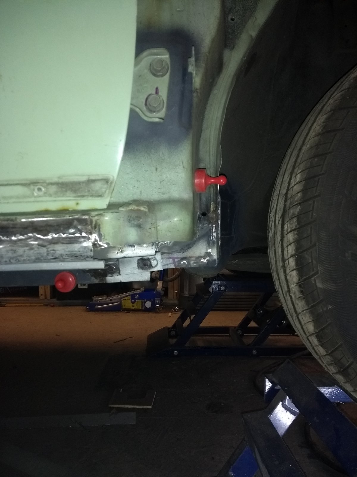

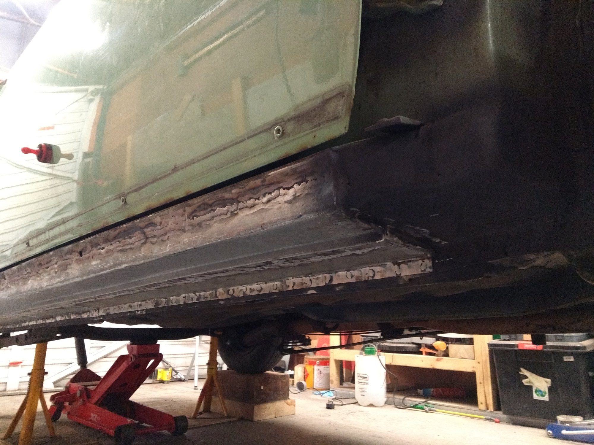

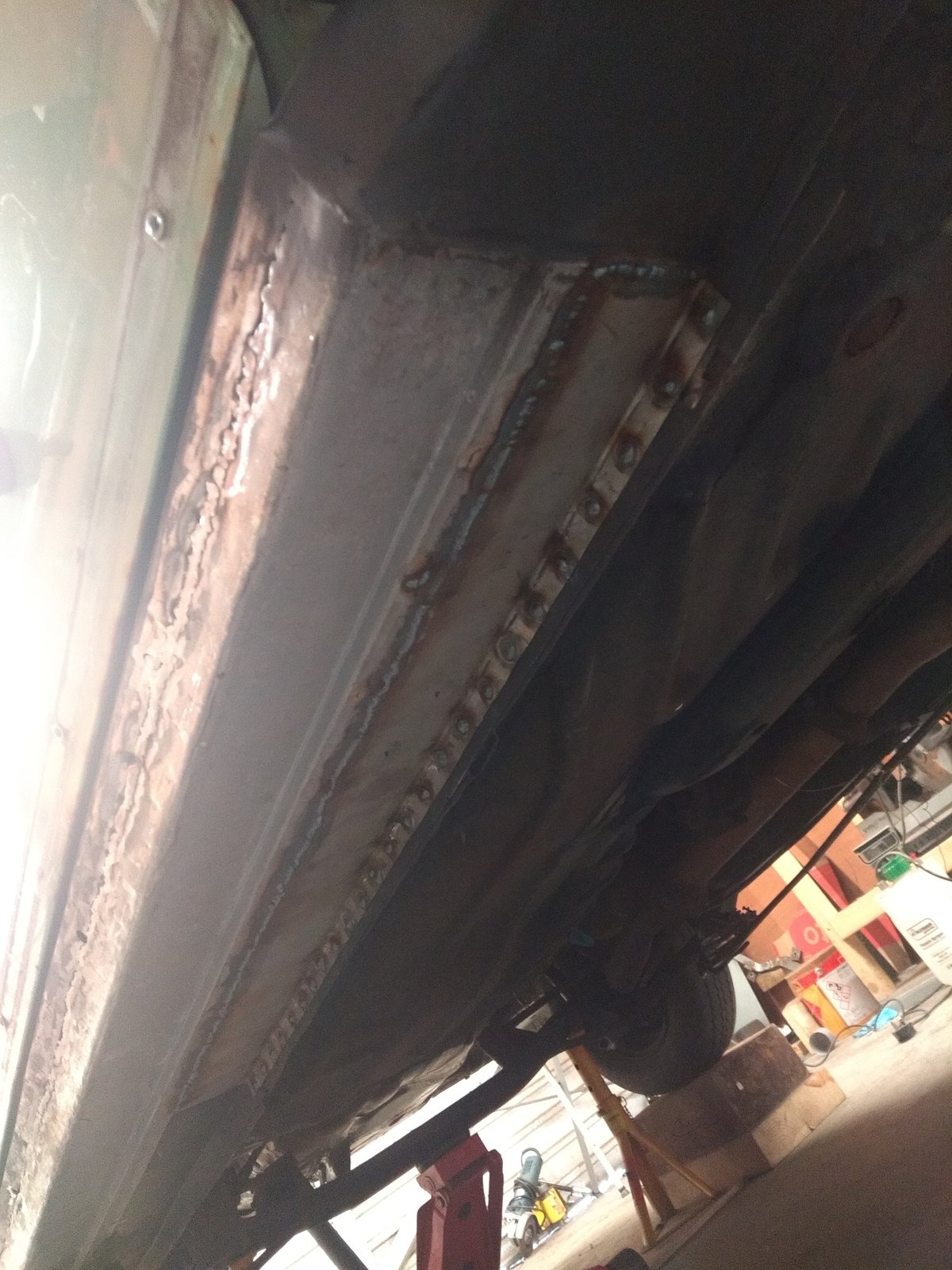

The figgy has chrome over sills so none of the welding will show...plan for the sill inside is to leave it in etch and then to wax the hell out of them every couple of years. I painted the insides of my mr2 sills but I kind of think that a lot of the paint got burned off during the welding! I think the key is to replace the outer sills early before the rot gets to the floors so will be keeping an eye on them going forwards....I've built some additional drainage channels in the sill lower flange which will hopefully help.
The London/Brighton is 3/6/2018...would be fun and theoretically "plenty of time"...but I'm about to be buried with regular work up to my neck in the next few weeks so I kind of need the Figgy done before that happens otherwise I'll be sticking a sheet over it and coming back to it in 5 years time!!
