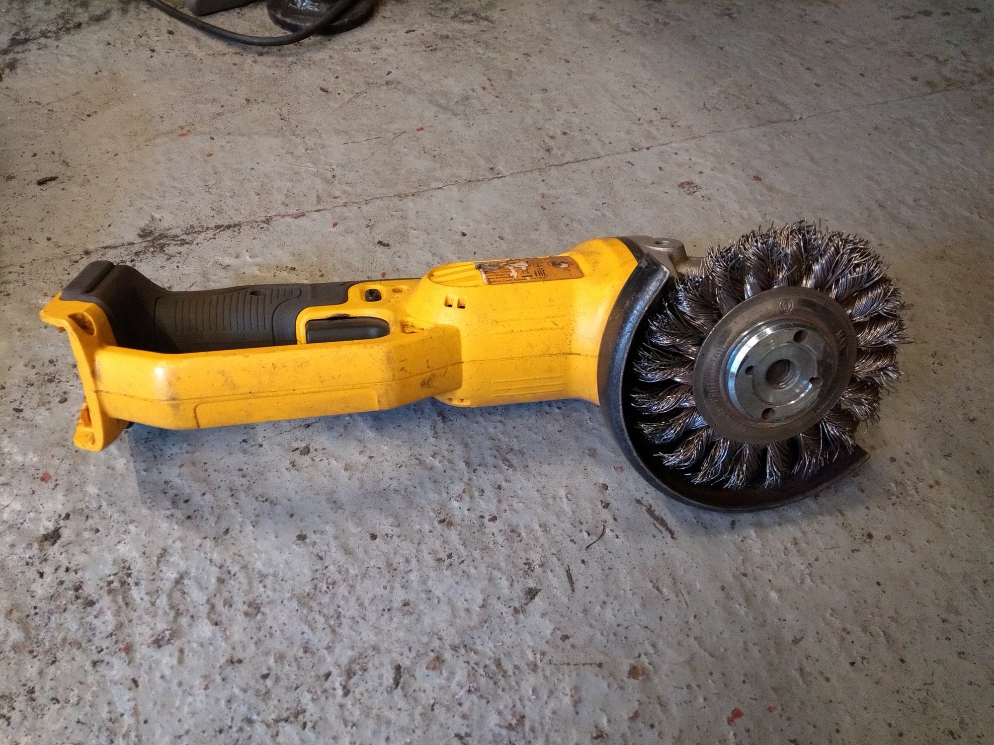

but that wire wheel sure did eat the batteries.

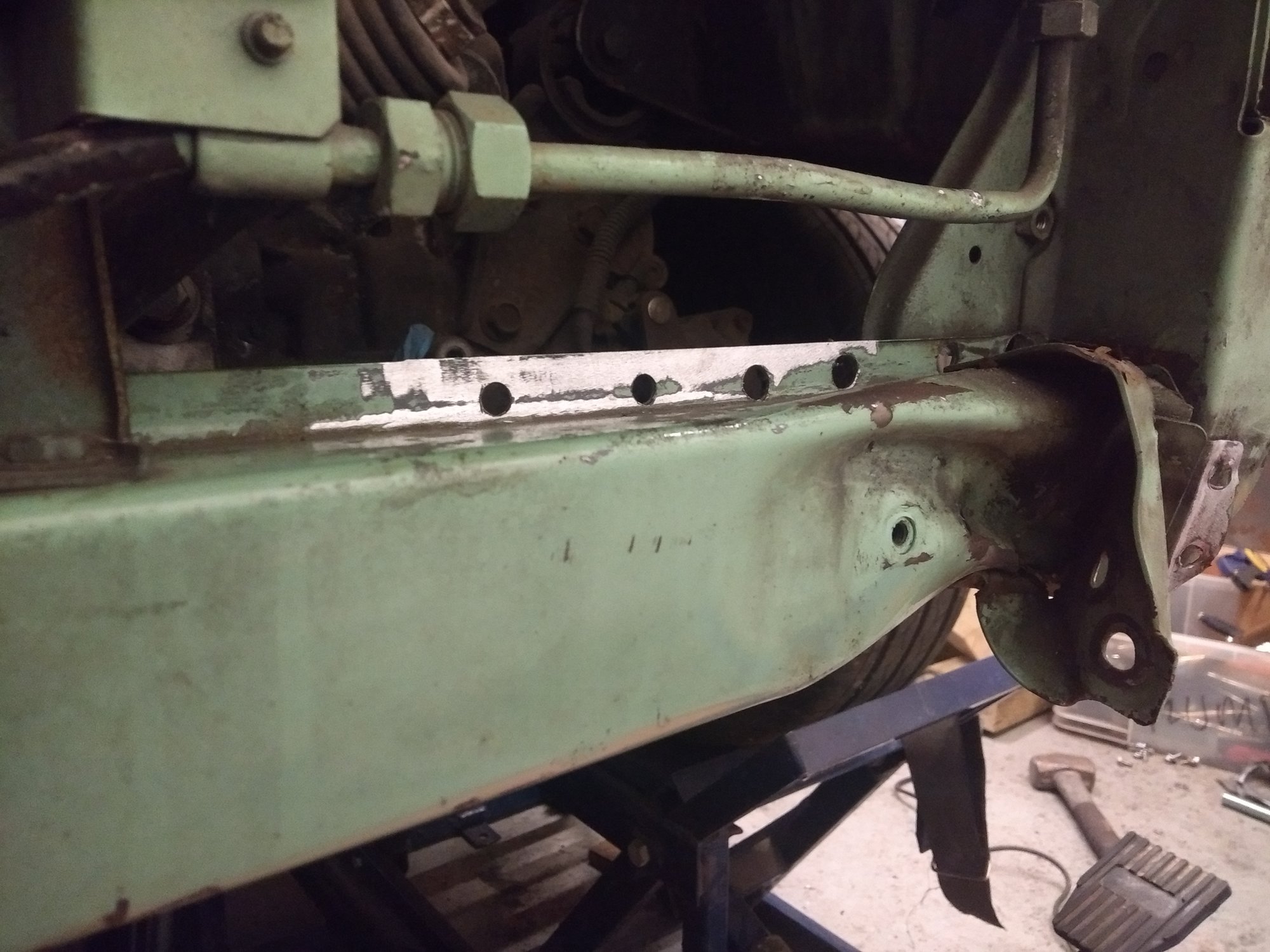

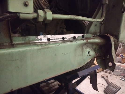

Geez I really dislike drilling welds....pretty much blunted every drill I had.

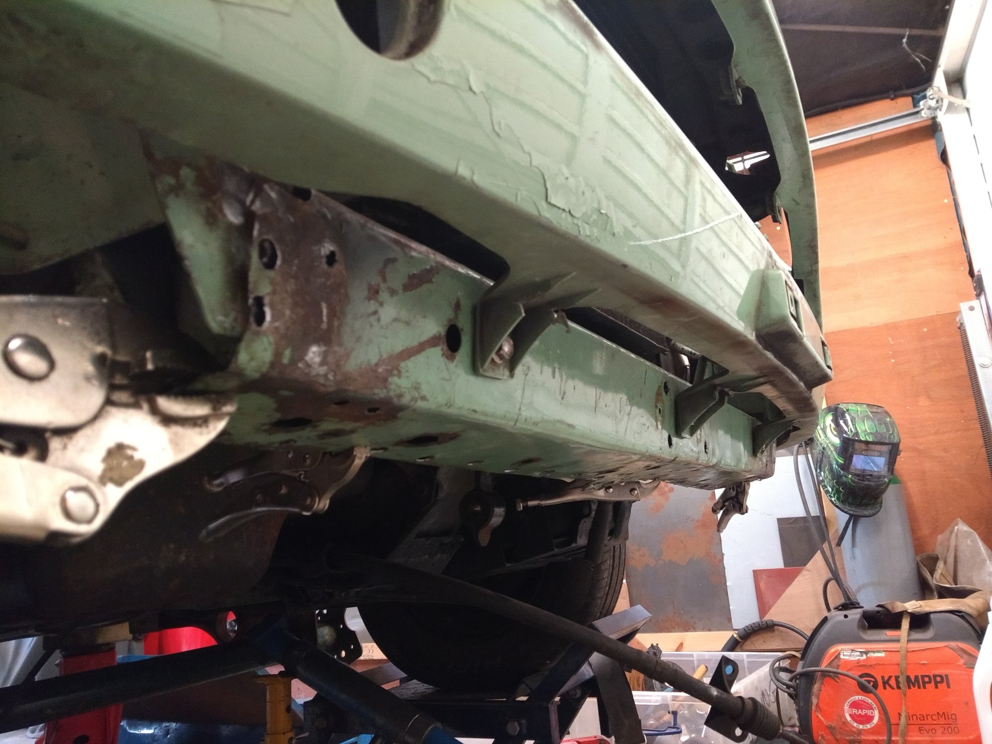

BeautifulBit more of the sill done...geez that's alot of welding! Looks great in the pics...however the weld did pull the face of sill in by 3mm or so along the weld line about the half way point. I will do my very best to ignore it as the door gap looks very nice....I'm thinking a bit of filler...but I know what I'm like. To be honest it really doesn't matter as there is a chrome cover going over the top anyway...but I'll know!
Next job is to fit the sill end cover and do the plug welds along the lower flange.
This was done with successively closer tacks until the tacks were about 20mm apart...then successive 20mm welds. It took a long time as had to keep letting it cool down!
