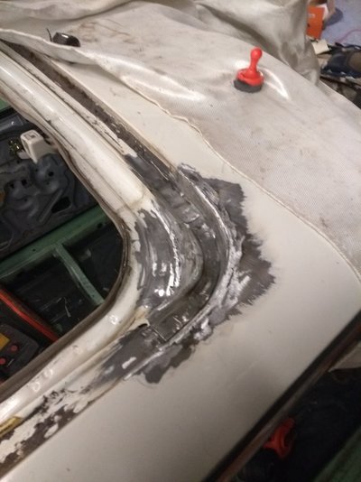

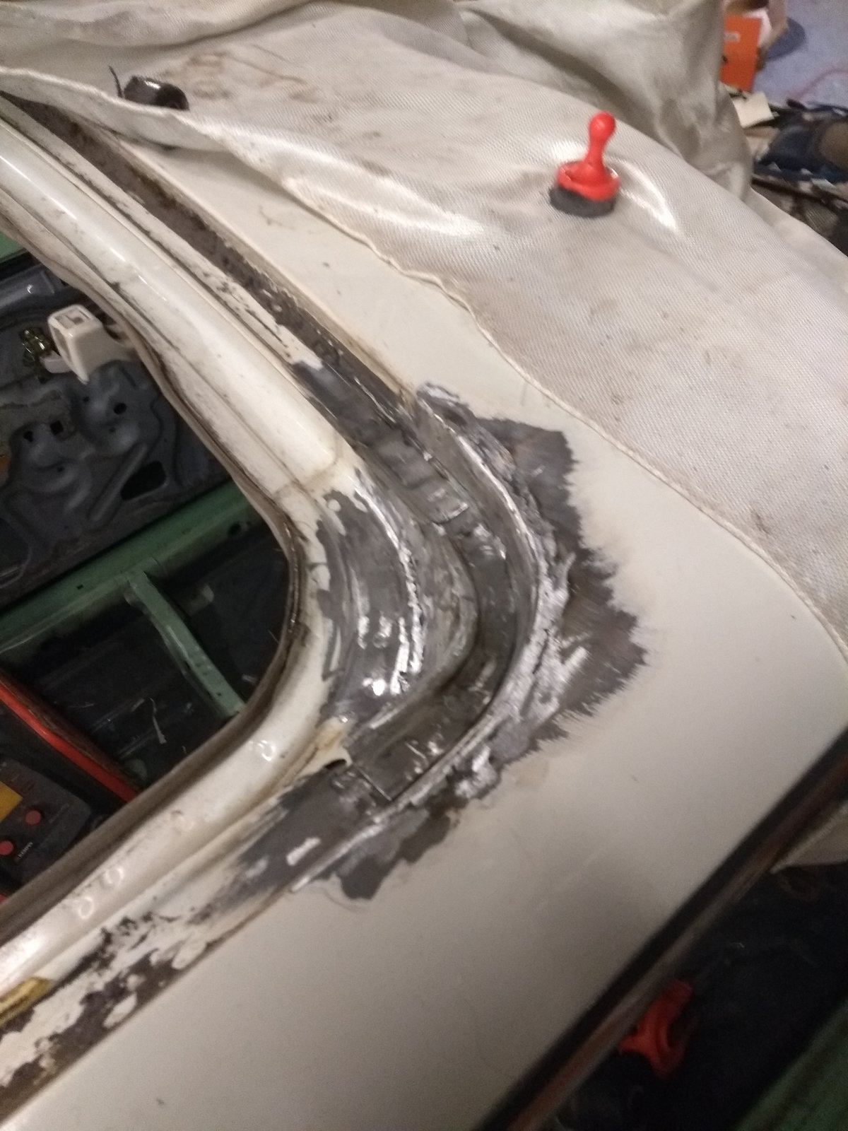

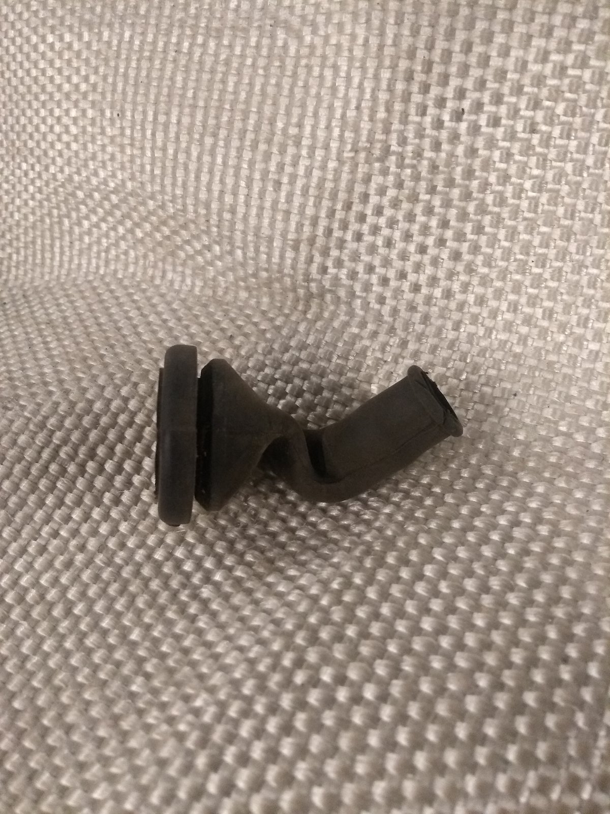

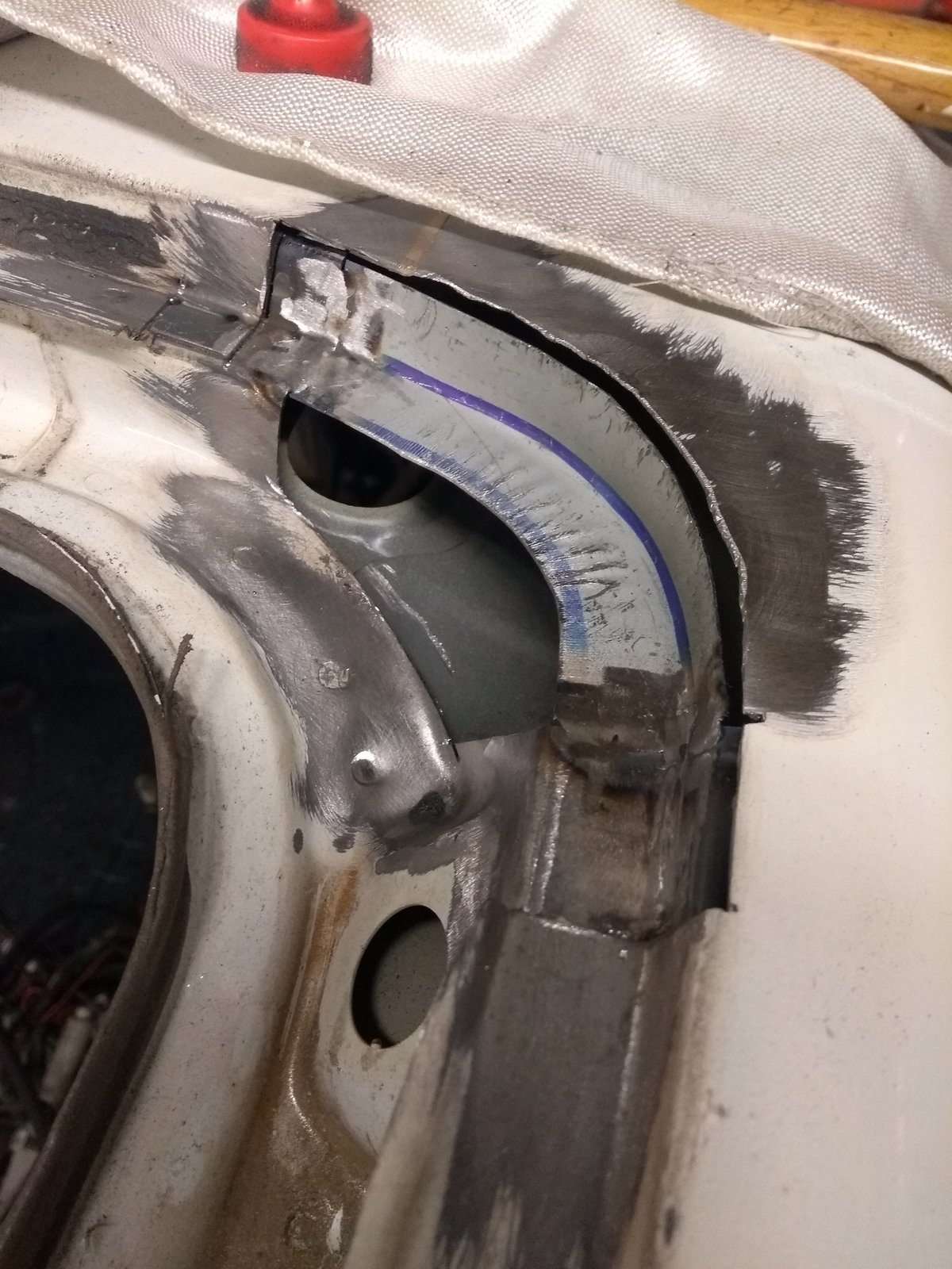

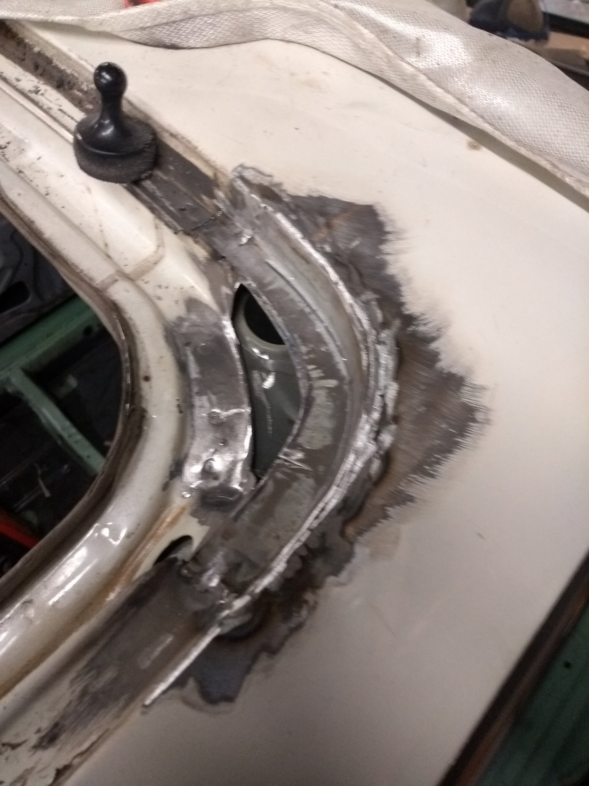

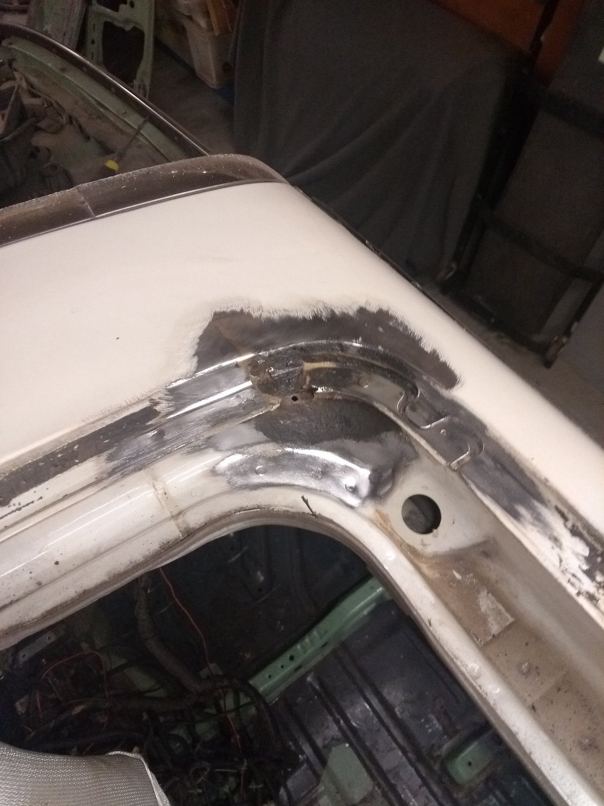

Drivers side is a different story...the rot has set in....I suspect it's because the drain was twisted when fitted so pretty useless as a drain! If you look carefully you can see that the roof has a brazed joint running from the corner to the front screen...I do like a nice brazed joint

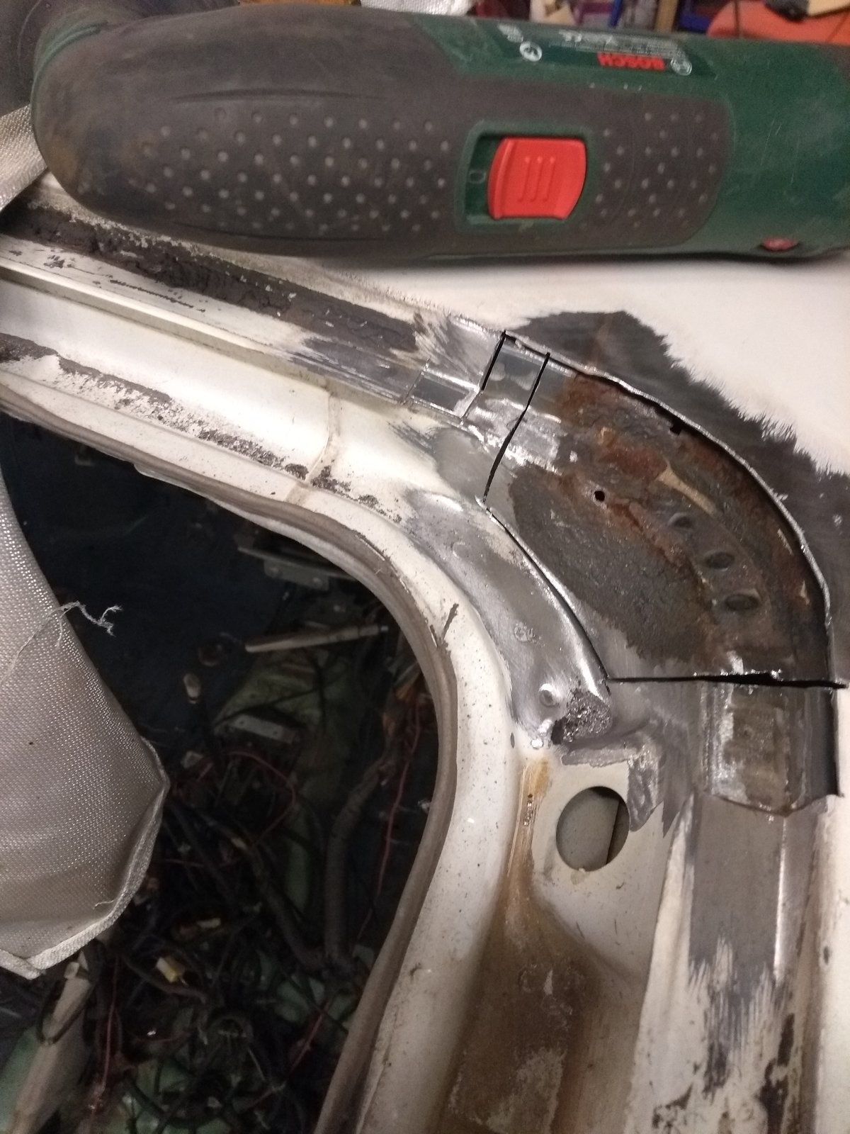

This one is going to be tricky to fix...I think the first step will be to template the curve before I cut anything out so I retain the correct curvature so that the roof fits properly. The rot runs down to the bottom of the corner so it looks like the whole corner will need to be removed
.This one is going to be tricky to fix...I think the first step will be to template the curve before I cut anything out so I retain the correct curvature so that the roof fits properly. The rot runs down to the bottom of the corner so it looks like the whole corner will need to be removed
