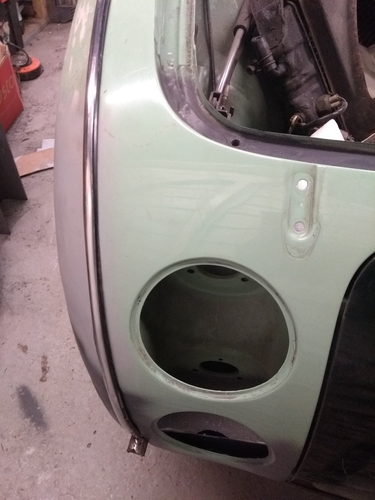

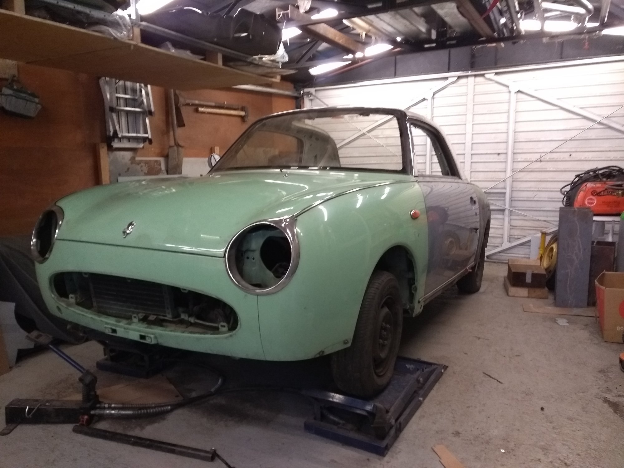

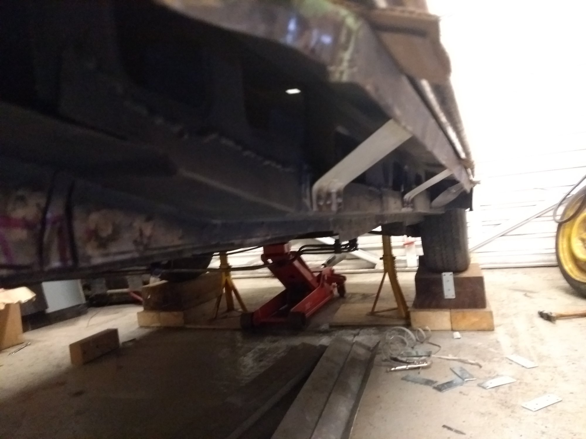

Don't give up so easily I'm sure there will be more.Finally back on track...doors and front panels loosely fitted (few bolts finger tight). So far looking very good. I need to fiddle with the driver's door but otherwise think we'll be finally ready for welding in the sills.

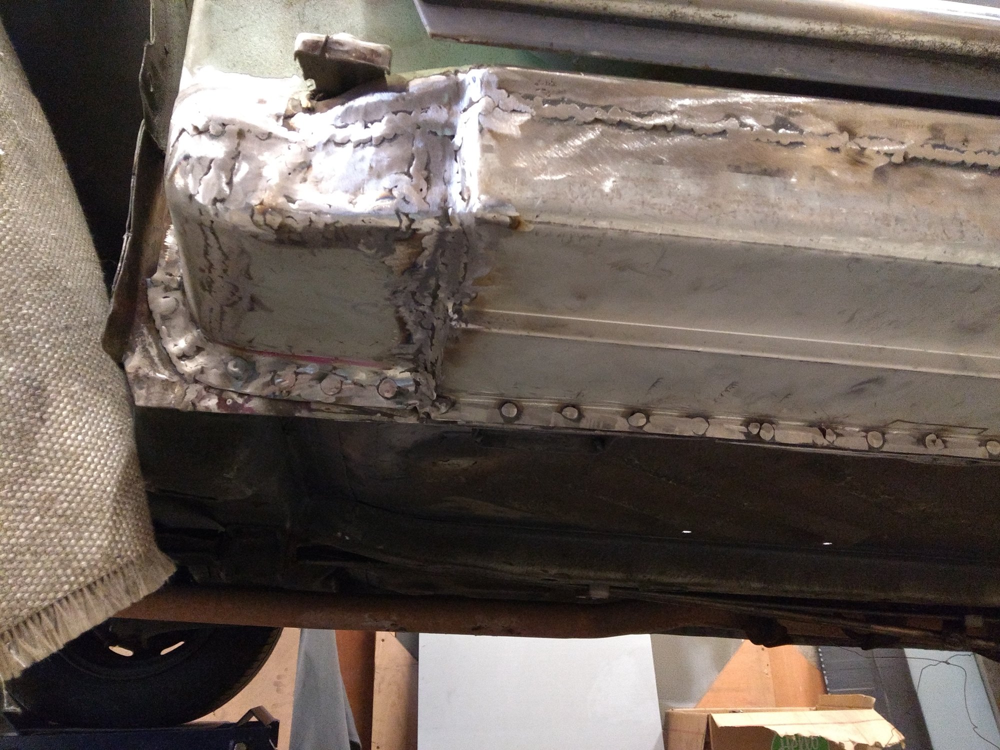

I can't believe the welding is almost finished...in the end I just ran out of rusty holes despite my best efforts to generate new ones by poking around.

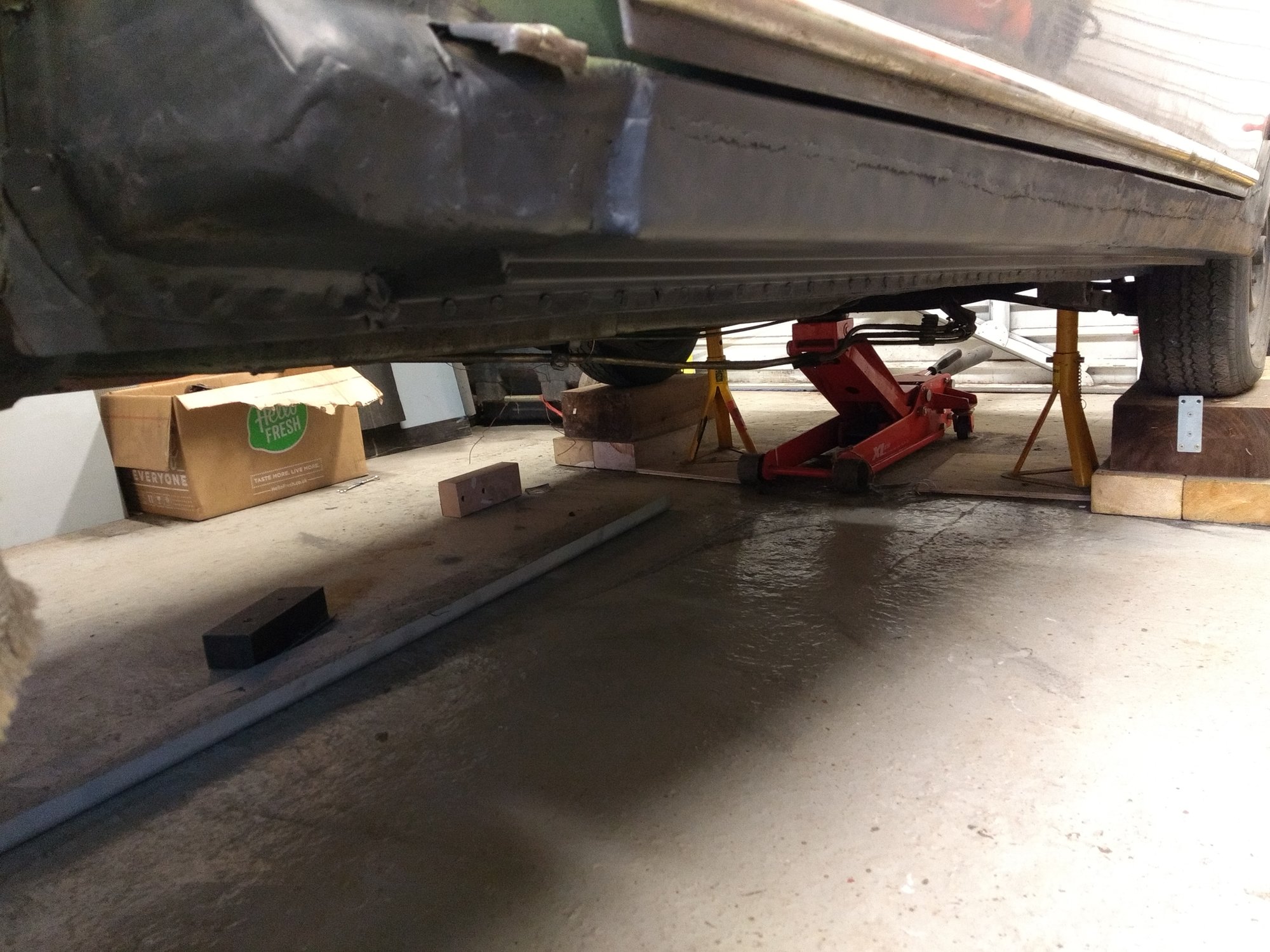

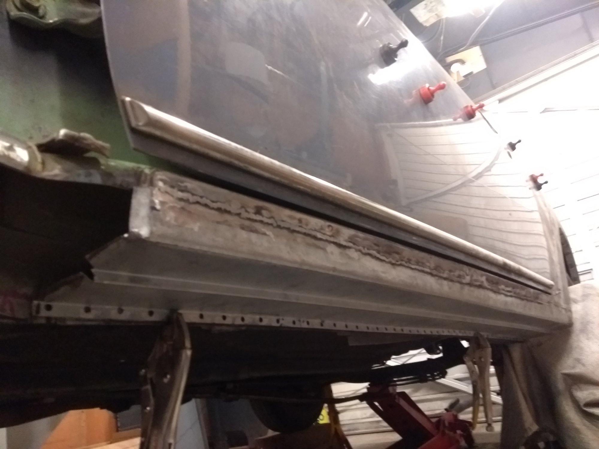

. But I do have 3 separate means of support for a car which weighs about 800kg!

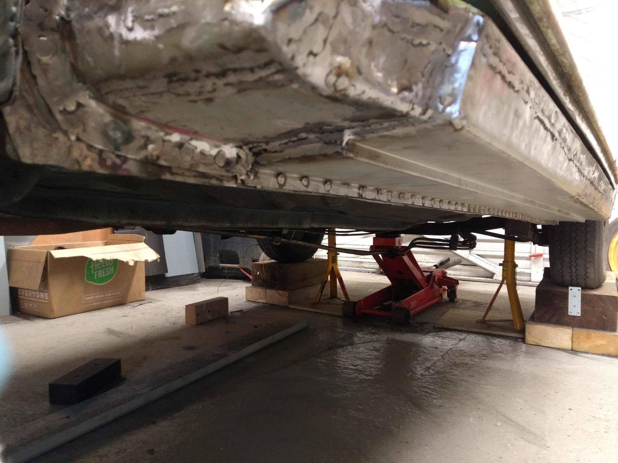

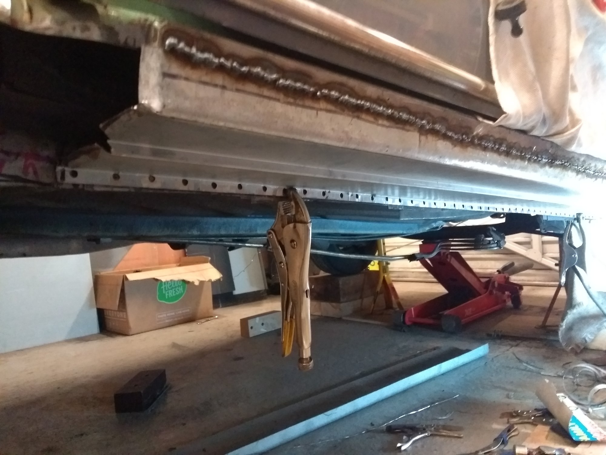

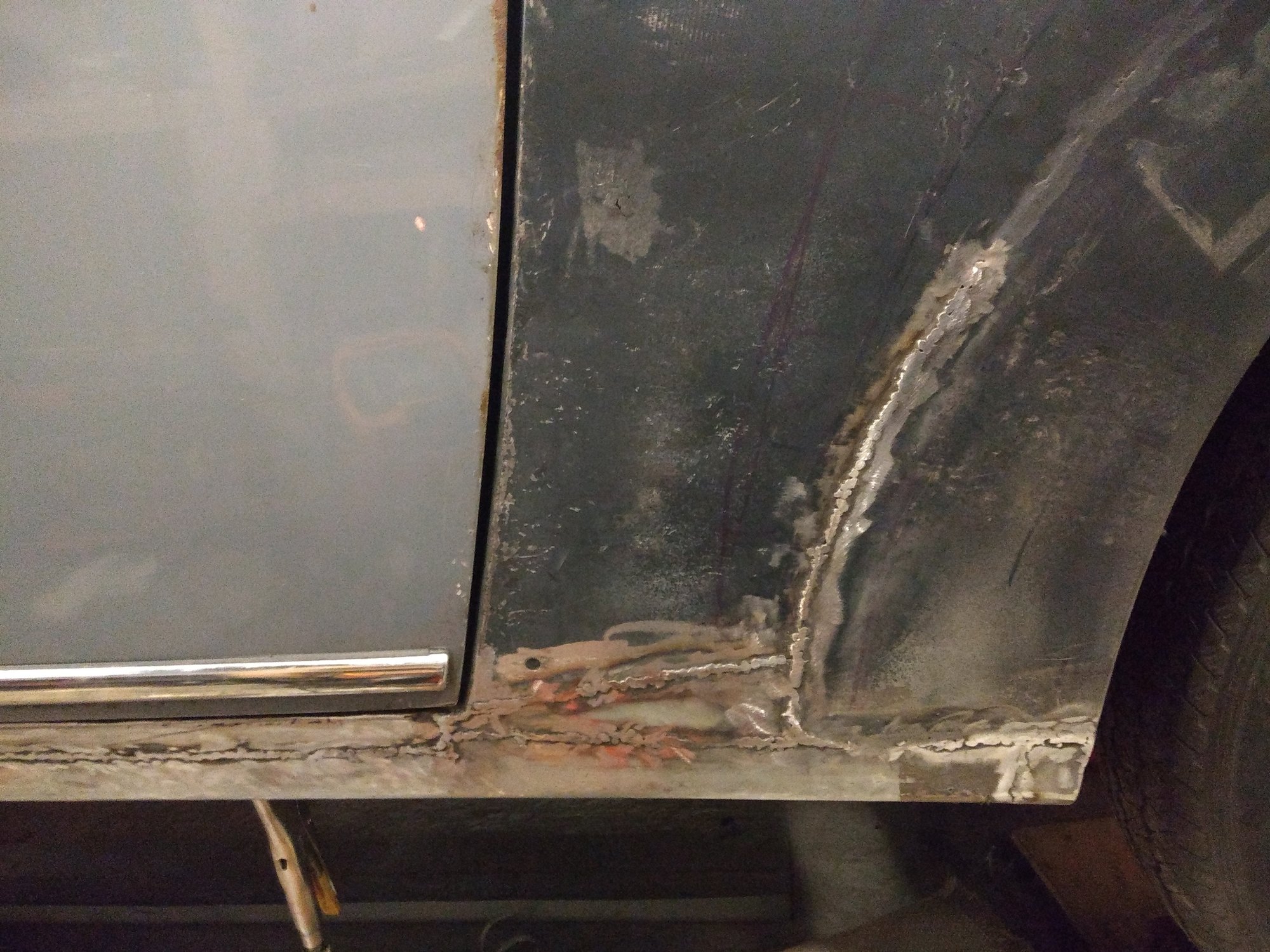

. I think this is the easiest approach...just don't want dodgy door gaps after all this work. The issue is the top of the sill protrudes outwards by about 8-10 inches from the doors plus they are 1mm steel....crazy!.Bit more of the sill done...geez that's alot of welding! Looks great in the pics...however the weld did pull the face of sill in by 3mm or so along the weld line about the half way point.
I have a deadline looming so trying to get the welding done and out the way (it's the London to Brighton run and I'm hoping to participate in the Figaro)
