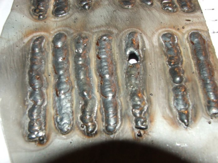

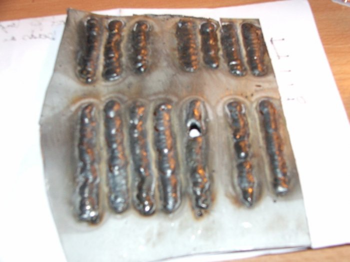

Try tensioning the spool so that it just prevents overrun on your fastest wire speed. This should be adequate. As far as ill fitting adapters go, I have used offcuts of drain pipe as packers, notched to fit.
Try it on Argonmix gas instead of CO2 & it will seem like a different machine
weldequip
Right potentimeter used in my welder is a 2K2A - well thats whats written on it)
You could rig it up to run from disposable gas canisters, just to try it on Argonmix. I know disposables work out expensive but, trust me, you'll notice a huge difference in performance...and might wonder why you've gone to all the trouble with the modifications(Don't get me wrong, a change in gas won't cure the inherent problems with some SIP machines, but the proper gas makes all the difference).
weldequip
- think of it like learning to drive a car with no power steering, no ABS and a crash gearbox - thats what I learnt in - it was hard work and difficult but ultimately you understood clearly what was happening as a result of your inputs.... I'm not saying it makes me a better driver but a clutch cable snapping 100 miles from home didn't result in a call to the AA and services of a flatbed - I just carried on driving without the clutch matching revs to speed thro all the gears.

I'm also enjoying the thread. I bought a used SIP just to see what everyone was on about.
Experimented a bit but slowed up a little as what I really wanted to do was measure the speed and voltage variations in real time.
One thought though - have you considered pulse width modulation for the speed control? http://www.mig-welding.co.uk/forum/showthread.php?t=4481 Advantage is it ought to give the motor a little more torque, and ought to be less prone to speed variation through heat than the original.
I like the idea of the multi-turn pot. It'll look good.
