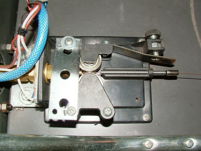

OK I've bridged the gap with a piece of plastic tube
Not ideal but it seems to stop the birdsnesting
I'm going to have a go at spacing the torch end by changing the washers and electrical connections to get the end of the liner closer
So Plan B
Was
Nut
Washer
Electrical connection
Washer
Wire feeder
Washer
Nut
Now
Nut
Washer
Wire feeder
Washer
Washer
Nut
It's moved the nose of the liner much close to the drive wheels![]()
Are you still running gasless wire? if so are you running .9mm tip? i find they run better with a .9mm tip rather than the .8mm.
Do you mean the bracket at the left of your photo, the one where the two bolt heads are just visible, behind the wires and blue pipe? If so, that bracket isn't there on mine.
There are a few differences between your welder and mine, judging by that photo, but they're both Cosmo 170. I'll try to post a similar photo of mine later so that you can compare.
Have you changed the brace that you added across the wire feed wheels, that you posted a picture of previously? I only ask because I've still got this mod to do so if you've discovered that it works better one way than another, I'd be interested to learn from your experience.
