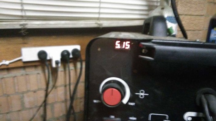

Oh I like the display - how coarse do you find the adjustment on the wire feed pot - this was what I struggled with in the early days as a small adjustment made a huge swing in terms of wire speed - not a problem welding thicker stuff but a complete pain when down at the bottom end welding up bacofoil panels on a mini

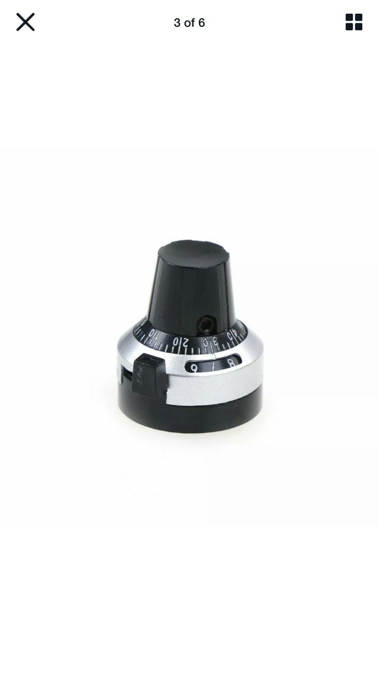

I replaced the single turn pot with a 10 turn one to get the finer adjustment, did make WFS adjustment loads easier.
