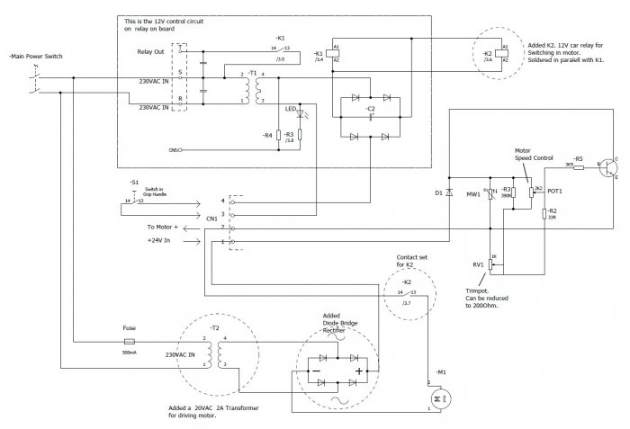

But with no schematic, I can't suggest where in the circuit to put the resistor.
Robert
IF what I'm trying to do doesn't work as well as I hope or the 10 turns becomes tiresome I'll have a go at trying to get a schematic from SIP and resurect your points raised.
