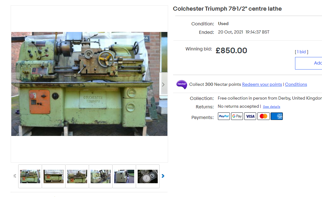

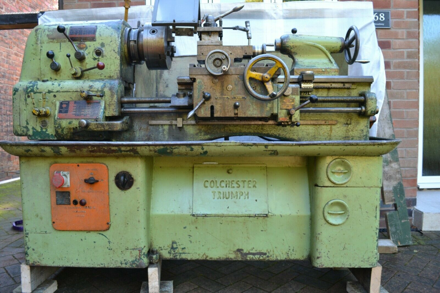

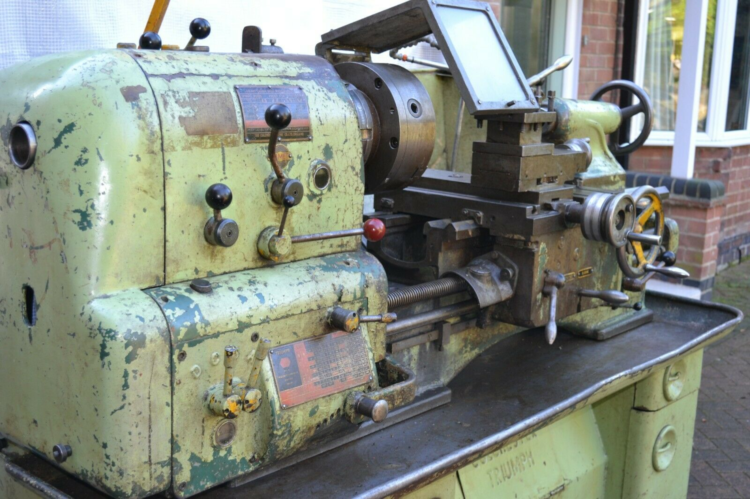

Nice machine and nice price. I notice it has the early feed lever system? Where you slide across to change feed axis. Word of caution if it is. Be careful we re-engaging the drive that it is still in the same postion and hasn't slid across. I found out the hard way.Well just won my bid on eBay and very happy with my purchase, Seller states 1964 Colchester triumph 30" between centres with a 15" swing and 2" hollow centre
View attachment 315293View attachment 315295

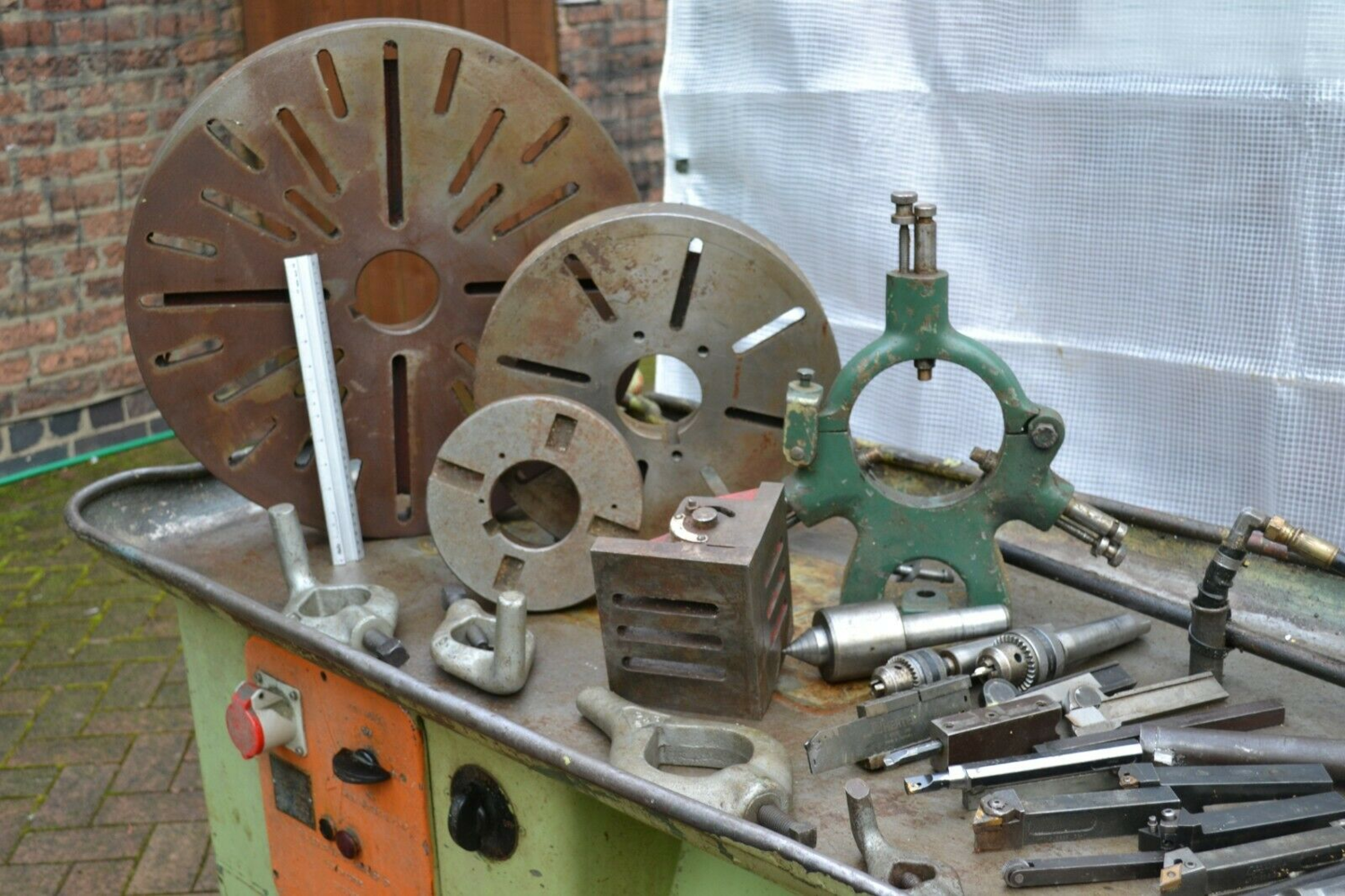

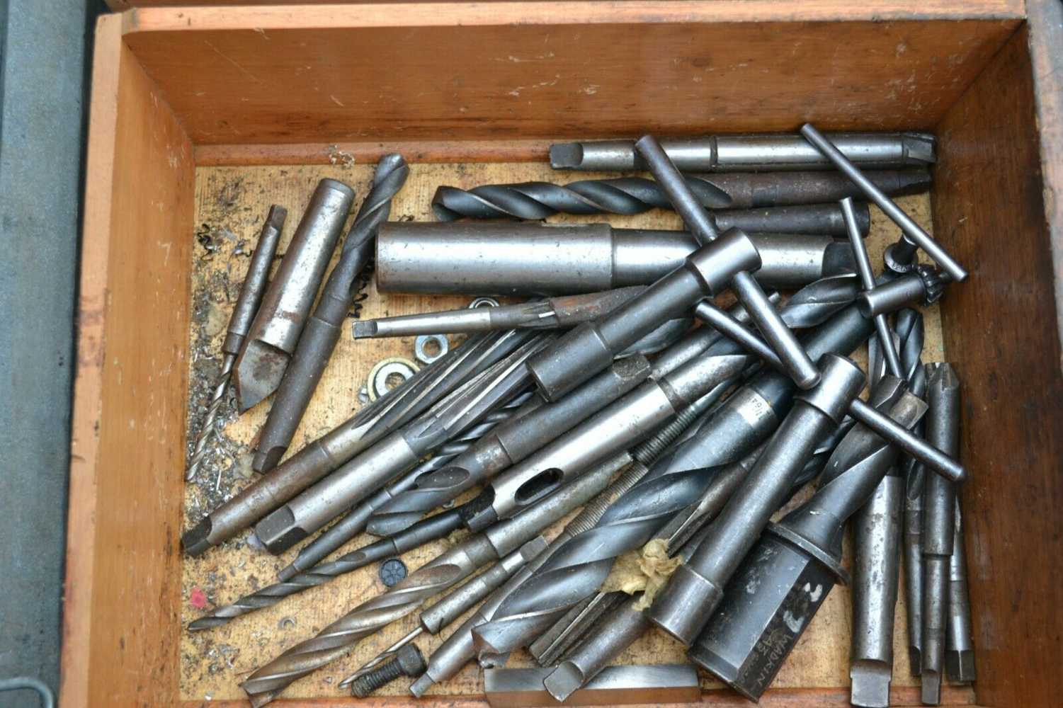

21" faceplate, then 14" and 8" along with the travelling steady ,12" 4 jaw and 10" 3 jaw fitted to machine and some drive dogs along with carbide insert tooling centres and chucks.
Also comes fitted with a rapid screwcutting box which I thought it meant it cut the threads physically faster
Only ever worked on my small new mini lathe at home and a brand new Colchester student for apprenticeship training so will be interesting learning about this.
Now just waiting on getting it home and building a three-phase power supply for it, thanks to @fizzy for helping me figure out how it can be palletized
happy with my purchase think it was a good deal and look forward to making some chips on it![]()

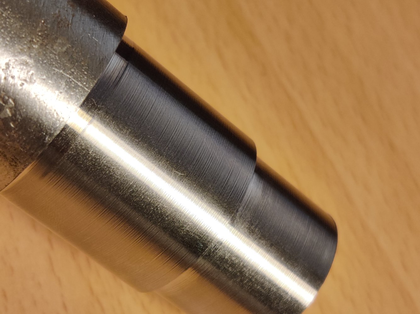

All the feed lever needs is a gravity drop down gate. Thought of making one when I had the apron off. But now I just double check. Mine was fitted with a safety clutch on shaft, unfortunately set to high. When it goes into heavy load it's almost impossible to disengage the lever. It just carries on until switched off. I intend to readjust it. But slight technical issue to pull the feed shaft out (pic) Involves a farm jackAlso I have been having some issues with lines in the finish so this could be what is causing it vibrations in the tool maybe but it also could be separate and just down to wear and other things , It is a 50 yr old machine after all

Also had a shot at sorting out these resonance and vibrations seeing if unmatching belts caused the issue but it was not as one belt ran them just fine and all the belts have unique matching marks so I imagine they where a matched set
here is lines in finish with 3 belts that remained unchanged as the vibrations did when it was taken to one belt

I do have those tools which make finer lines but still not ideal lol , Easier to show on the heavier cut tool.I had the lines - you need those tools I linked to!
I found around 400 to 600 rpm with the finest cut gets rid of them. That or a 1/4" cut with a cnmg or similar![]()
