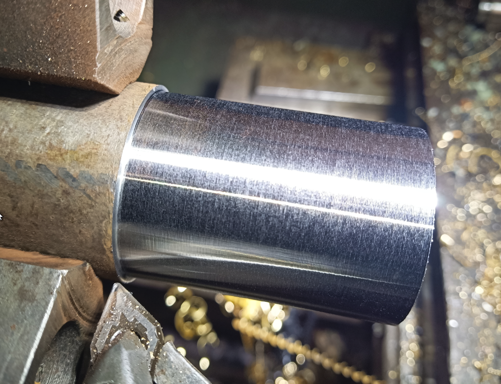

Here is an example of what I am saying.
Both were same insert, same spindle speed, same depth of cut, same feedrate.
First is some kind of mild steel, no idea exactly what.

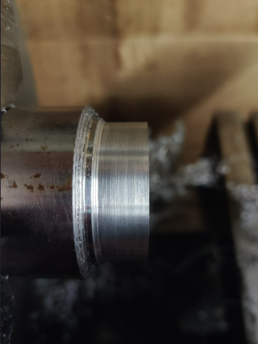

Next up is a piece of F51

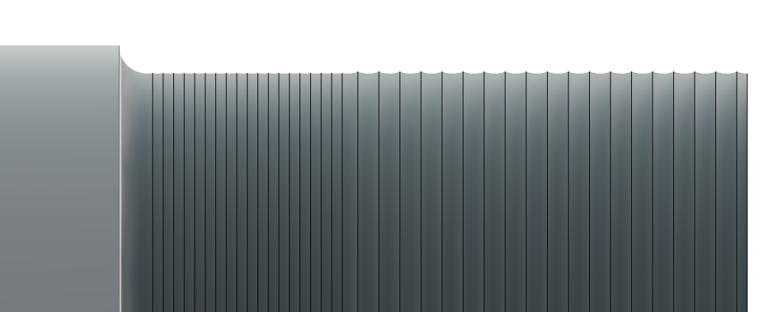

Ok a drawing in fusion.
Tool rad 0.8mm
First part is 0.3mm/rev, second is 0.15mm/rev.
As can be seen grooves there but much less pronounced at the lower feedrate.

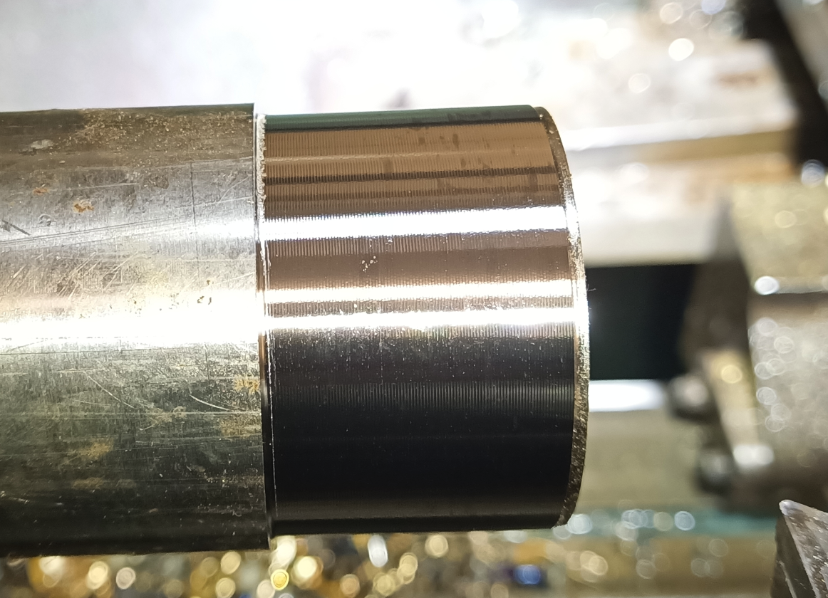

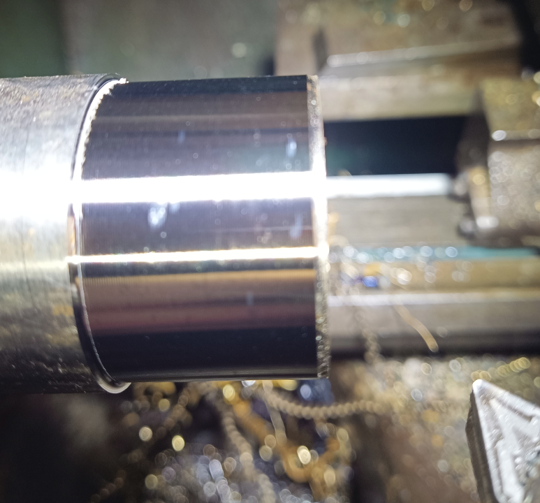

@Munkul I know what you mean with the insert that was a photo from before I knew better just to show the finish , I was trying some of those ultra sharp alloy inserts and it still gave a line finish on lowest feed rate but it did feel smooth to touch just not a ground type finish others experience with them.
This is the alloy VCMT finishing insert result, Some of the Kennametal 0.4 radius inserts gave a nice finish but still lines unfortunately.

I find if i am turning a bar of "draggy" steel that's giving feed lines i just max the chuck speed out and go really fine on the cut with sharp HSS...really helps things out.
In softer steels, suitably ground/sharpened HSS does typically give a better finish, especially with small cuts.I was getting lines like that on my much weedier lathe. Tried HSS with a fat radius and managed better. Stay away from pointy carbide.

Just to clarify, my pictures were of a roughing feedrate of 0.3mm/rev. It was done specifically to show the difference in appearance between different materials.I was getting lines like that on my much weedier lathe. Tried HSS with a fat radius and managed better. Stay away from pointy carbide.
12mm diameter.
Also big difference between hot and cold rolled.Mild steel will mar and rip as it cuts, higher alloy steels will cut better with less ripping. Aluminium and stainless are more ductile so tend to leave a really nice finish as they sort of smear.
The problem with going too low on the feedrate is you will get long stringy swarf which will mar the surface of the material you have just cut.
I ripped out the old switchgear out and put the VFD in there. The motor had been repaired, the ends of the windings had been jointed internally, making it permanent star, which was no good for 240. So I had to separate and extend to a new terminal block to make it delta. I am certain that the vfd should never be disconnected from the motor, but switched on the supply side. For belt & braces isolation I unplug it (13A).That's the plan at the moment seems cheapest and easiest way to get it sorted so should be fine
Interesting, just for mild or all steels? Im aware that cold will move as the stresses change but no idea if it cuts better or worse.Also big difference between hot and cold rolled.
