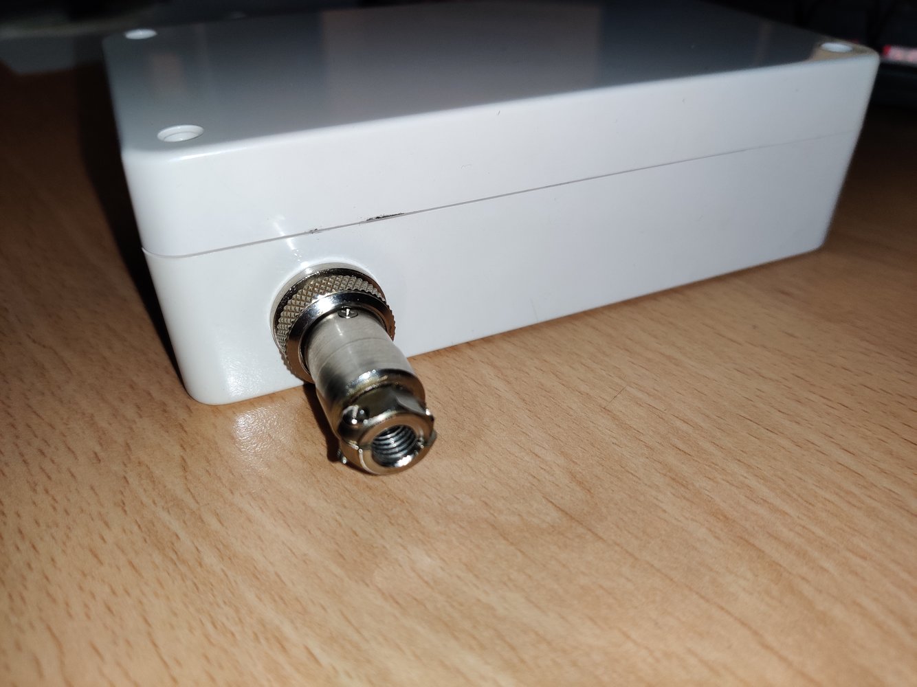

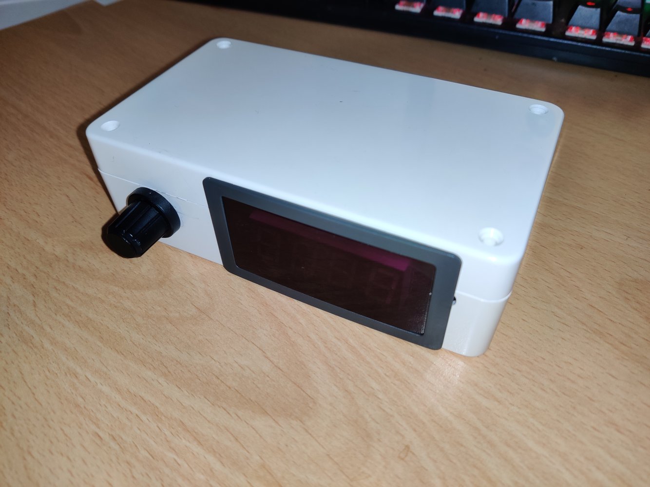

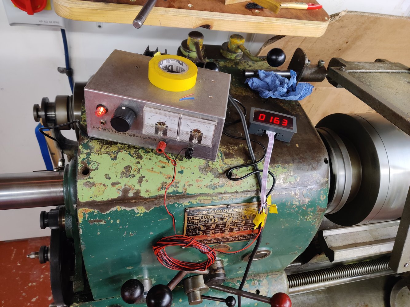

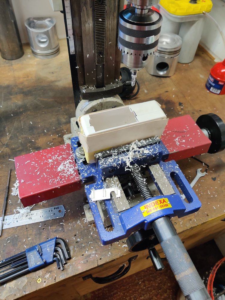

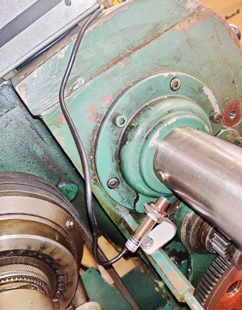

Well that is a nice job, but I can honestly say I never look at the speed (selected by gear) on my triumph. Perhaps I should..Making a mess milling out the box for my RPM display and potentiometer
Quick test to make sure it all actually works , needed to fine tune the gap between the sensor and magnet but apart from that pretty good
Made a little bracket from scrap to hold the sensor
Box ready to be screwed under my shelf just by the headstock gear selectors, will have 8 core cable coming out for the potentiometer and display all in one nice neat cable.
I can use the gear table for speed but as soon as the motor frequency changes I have no idea so this should help also a lot easier to glance at than studying a table.Well that is a nice job, but I can honestly say I never look at the speed (selected by gear) on my triumph. Perhaps I should..
Aye, I put the rpm meter on my Triumph but if I am honest I never look at it, I just know by experience what is right as I have used it for years by just turning the pot to get to a spindle speed.I can use the gear table for speed but as soon as the motor frequency changes I have no idea so this should help also a lot easier to glance at than studying a table.
With more experience you probably get a feel of RPM's and feeds needed but I'm using all the help I can get while I get the hang of it
Same with feeds, I didn't have a clue what the actual feedrates were until I looked the last day.
I've got no way of knowing, the vfd shows frequency so I could work out the motor speed but I don't know the ratio between the motor and the spindle. You won't bother working out the "right" speed for a given material, tool and diameter so there's not much point in knowing it.
Feeds I just do a couple of passes by hand to get a feel for it then set the feed so it looks more or less the same. It's all very scientific.![]()

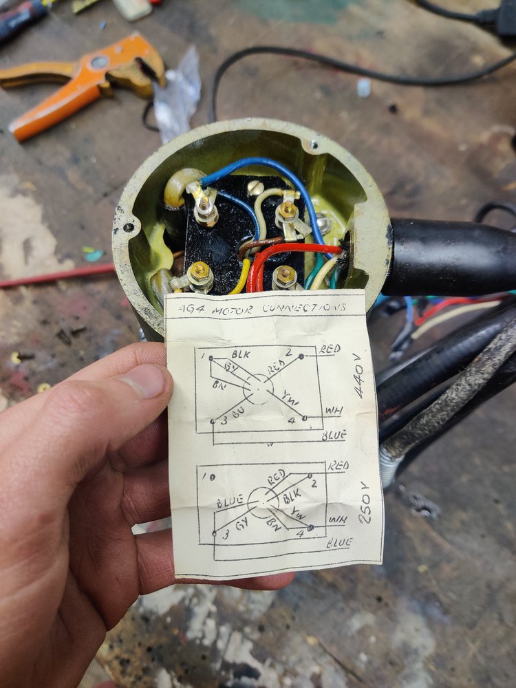

That's the same one fitted to my Town Woodhouse mill, has the same bit of paper inside too...Thanks to @Pete. thread on the coolant pump capacitor mod

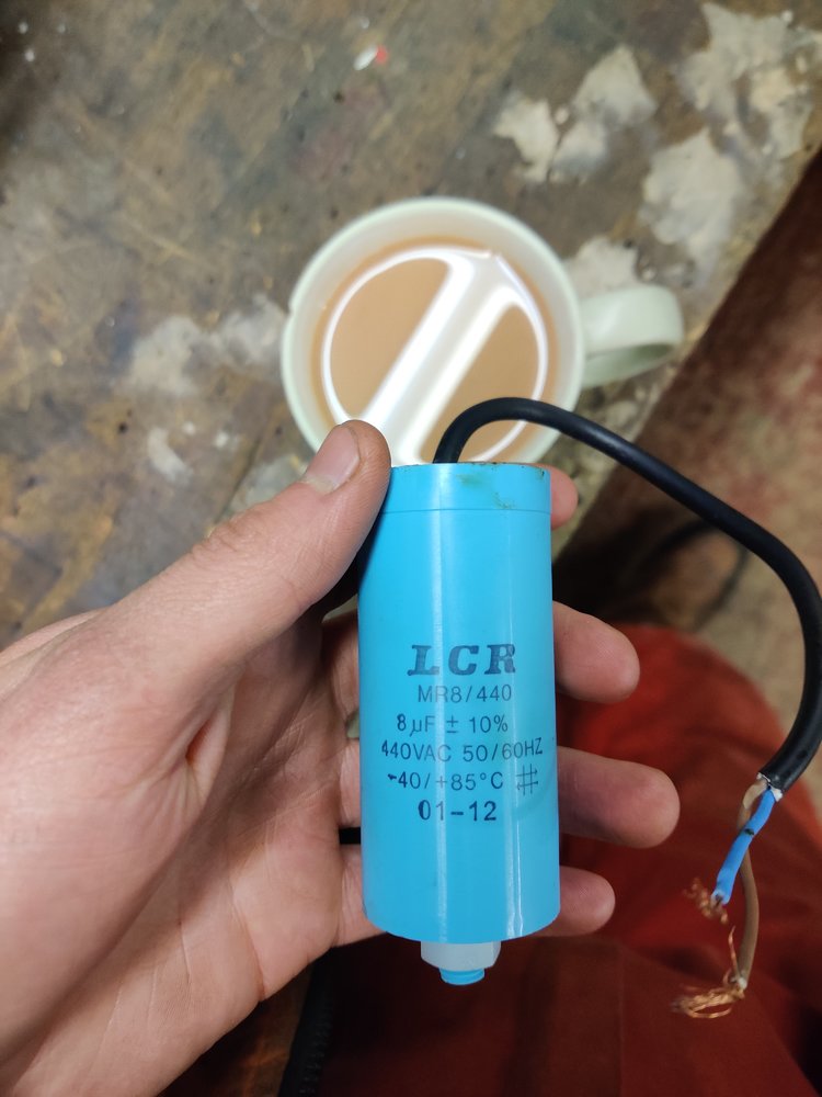

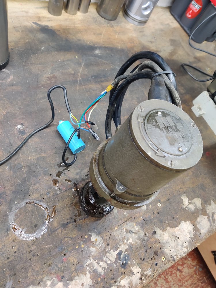

Just wired up the capacitor with the wires direct to 240v wall socket but was running really slowly lumpy could not go under any load at all it would cut out.
Then decided to crack it open and wow someone back in 1960 was thinking of me in this very moment this folded up paper was inside the motor terminals box , OEM I think it had not been opened
So promptly wired it to the 250v setting and suggested by the paper and what a difference sounds a good bit smoother still not VFD smooth but what can you expect from a capacitor, Dunked in a water bath and was pumping well. After cleaning the top I saw it actually said 250v/440v on the top but it was so much I didn't see. I think I am right in saying that is now in Delta connection but I am no spark lol.
Was thinking of installing it to an external tank behind the machine and piping out the original drain hole in the lowest centre point as the OEM tank was the inside of the lathe which seems a waste of space I was using as storage.
8uf ,, had to buy on eBay as we sold a big box of random size caps a while ago thought no use for themThat's the same one fitted to my Town Woodhouse mill, has the same bit of paper inside too...
What size cap did you go with?

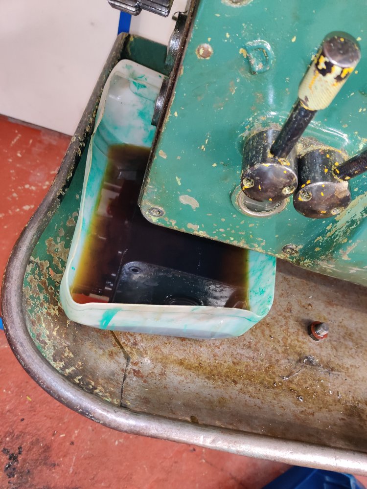

Oil changed in the headstock and screwcutting gearbox
For some reason all my text is changing to italics now

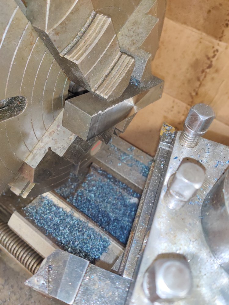

Little bit of glitter sitting there but not too worried about it no idea how many years it has accumulated that over

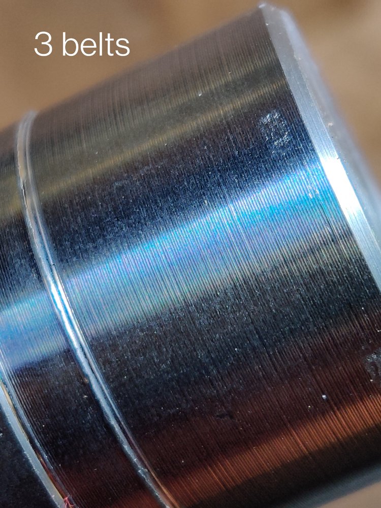

Also had a shot at sorting out these resonance and vibrations seeing if unmatching belts caused the issue but it was not as one belt ran them just fine and all the belts have unique matching marks so I imagine they where a matched set
here is lines in finish with 3 belts that remained unchanged as the vibrations did when it was taken to one belt
Intresting however , When the belts where loose the vibrations where a lot lower IIRC
A quick vid of vibrations and a weird resonance at about 1000 RPM shown by my handy RPM sensor , These vibrations make it impossible to read dial guages etc when you are near resonance RPM unfortunately however the lathe was never geared to run at 1000RPM but the non two-speed ones were so quite confusing.
Think thats all to report may have more to add in the morning.
That's a big assumption to make. I would take the chuck off to try it - put the small drive plate on. If the vibration is still there try a lower gear, same motor rpm. If the vibration is still there then @prepman is probably right.There's an issue with multiple belts. Because of slight differnces in length they don't all drive evenly. There's details somewhere on the net. My Student has one wide flat belt.
