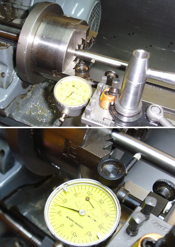

If you take the chuck off what is the runout on the mandrel?
Will check in a sec ...

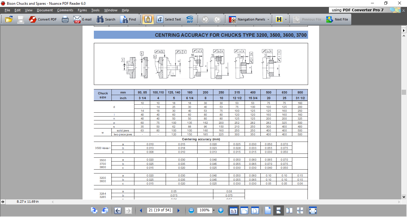

You can dial out runout with a 4 jaw chuck with independent jaws. It takes some skill and practice though.I had previously understood that only the repeatability of the three-jaw chuck was so poor, not the clamping accuracy per se.
Can I assume that I am reasonably correct with a centering four-jaw chuck?
the same as any other 3 jaw chuck if your turning down metal. the 1st cut you make and your job will be accurate it just means you cant take it out of chuck and put it back in if needed you can only do that if you use an independent 4 jaw chuck and not a self centering one

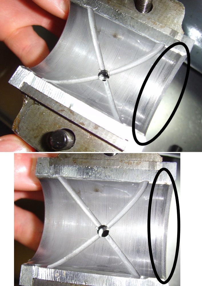

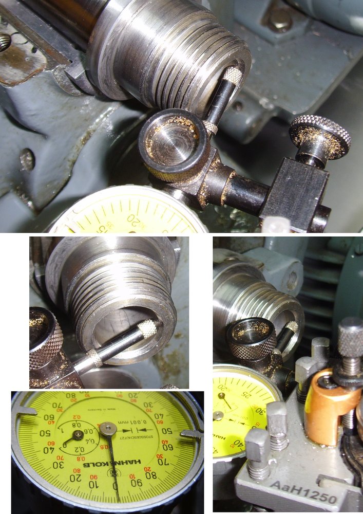

The only thing which would worry me is the "bed" edge of the bearing may be starting to pick up. Have a look at it closely, the bearing may be too tight, ref - your shim thickness figures. What does it spin like bolted up with no belt and no gear train?
I'm glad your mandrel is roundI don't know why I didn't think of this myself again ...

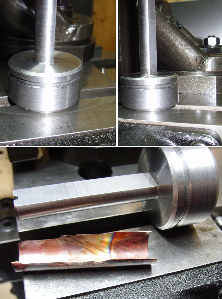

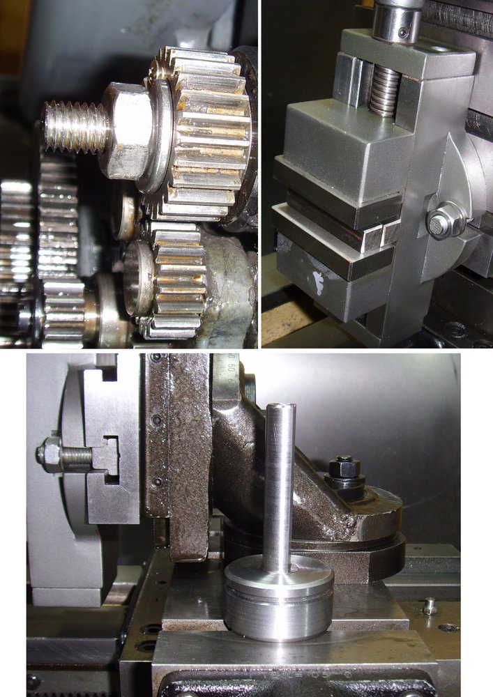

Measured like this, there was nothing to see on the hundredths clock, on the thousandths clock, the shaft runs within 1.5 thousandths.
Then quickly clamped my small self-centering four-jaw chuck:
Error halved compared to the three-jaw chuck!
What do I do now with the three-jaw chuck?

- Bring the machine in balance?
- Leave the bearing as is, at most get the shims a little more homogeneous on a whetstone?

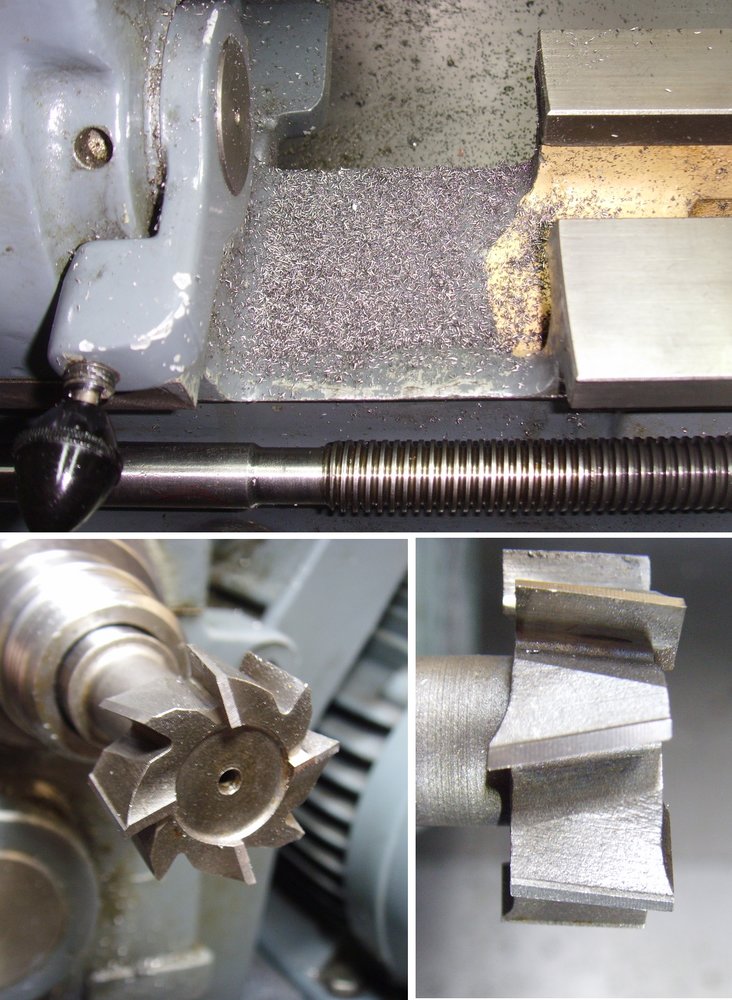

Active recirculating cooling is currently not in the planning stage, but the tray was nevertheless necessary, if only because of the total-loss lubrication of the two main spindle bearings.
The amount of oil that remains to be absorbed after the chips have been vacuumed out is still within the range of what the blue workshop tissues are capable of absorbing - this should be even more successful now that the machine has been raised.
The tray has become so luxuriously large that it should be quite easy to install a drain at a later date - if, say, there is a milling machine with a built-in circulation pump to the right of it ...

If your using a piece of ground stock in a 3 jaw then you are effectively checking the 'true' of the three jaws. To check the spindle then you need a morse taper shaft. You can produce this yourself. Put an oversize bar for MT2 in the 3 jaw chuck. It doesn't matter if the 3 jaw is out or not, If if was running a 10mm off then it would be awkward. Remember it is the axis of spindle you are checking which the lathe produces no matter what the chuck does. If you put a piece of square bar in the 4 jaw chuck and put at 10mm to one side, providing there's enough 'meat' it will still end up with a shaft parallel to the axis of the spindle.I don't know why I didn't think of this myself again ...

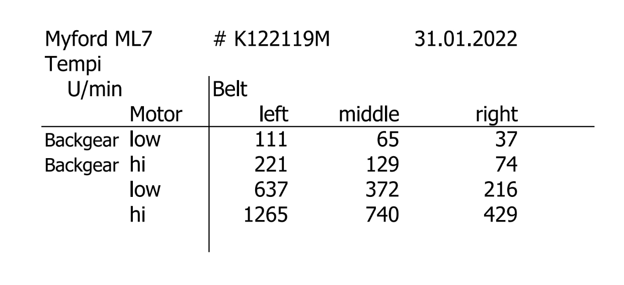

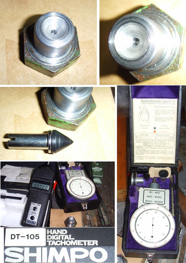

But how should I calculate cutting speeds without knowing the speeds of my machine ....?
Yesterday I wanted to get to the bottom of it:
The fully mechanical hand tachometer developed a nasty gear noise, so the break in style had to be done to measure electronically - but the trusty Shimpo is also a bit on the older side.
