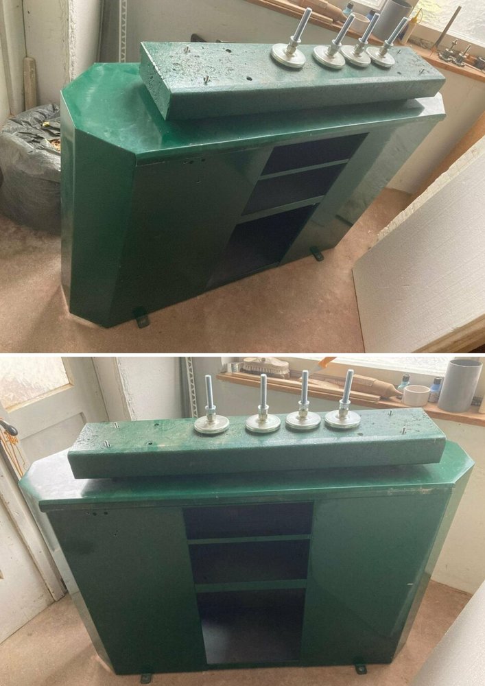

@25.4_mechanic That one has no drip tray, so coolant would be everywhere.....
They did several cabinets industrial one is beefy. I think the octagonal one is the consumer version.
Of course, I'm constantly looking at all the Myford-related offerings in my area.
In doing so, I came across something a few days ago that I do NOT want, but find fascinating:
This discovery suggests to me that at some point long ago, someone - probably here in the south of the country - came to the conclusion, as I did, that their base cabinet was a bit flimsy.
Only where I resorted to a stout steel plate because I could, he cast himself a concrete head weight, apparently to compensate for the same deficiency.
With @slim_boy_fat's help, we had already established by comparison that in his base cabinet, the flat irons that form the feet are about 50% stronger than mine.
Together with this find, I would think that it is fair to say that this form of Myford base cabinet was built "lighter" for export to the continent.
Which, in addition to the direct material savings, may have also reduced freight rates ...
