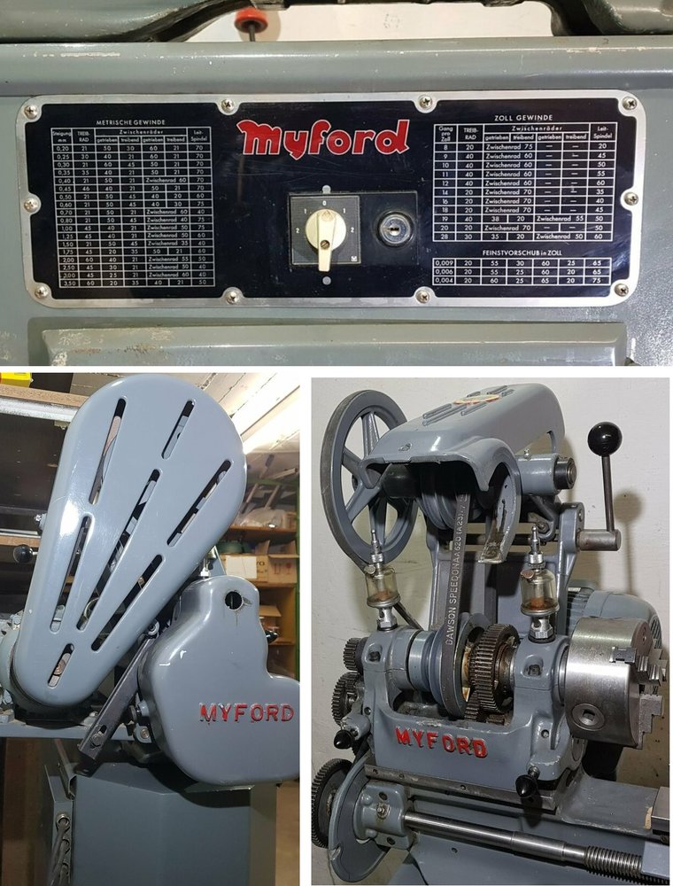

I am currently looking for a small lathe with a draw and lead spindle, as I want to be able to cut threads in metric and imperial, the more the better.
I can now buy a Myford ML7 with change gears.
I'm sure these things are a dime a dozen with you guys, but they're rarities with us.
I wouldn't mind fixing up a machine myself and making it beautiful again, this one is already pretty nice.
It's a "metric machine", whatever that means, at least adapted for the German-speaking market.
I haven't been to the machine yet, but I don't see any obvious traces of lacquer application in the pictures - apart from the signature, of course: A survivor?
Some accessories are included, as well as operating and set-up instructions ....
Question:

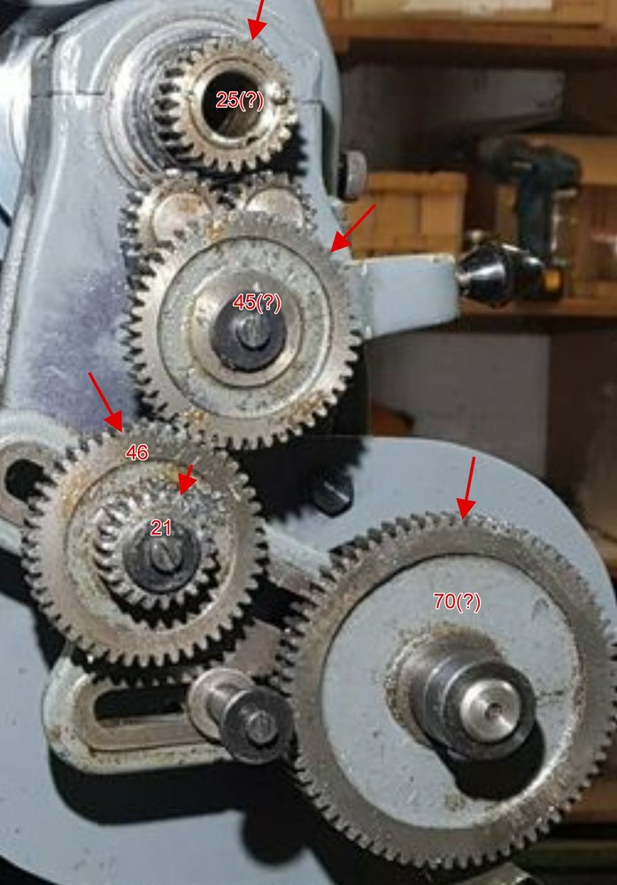

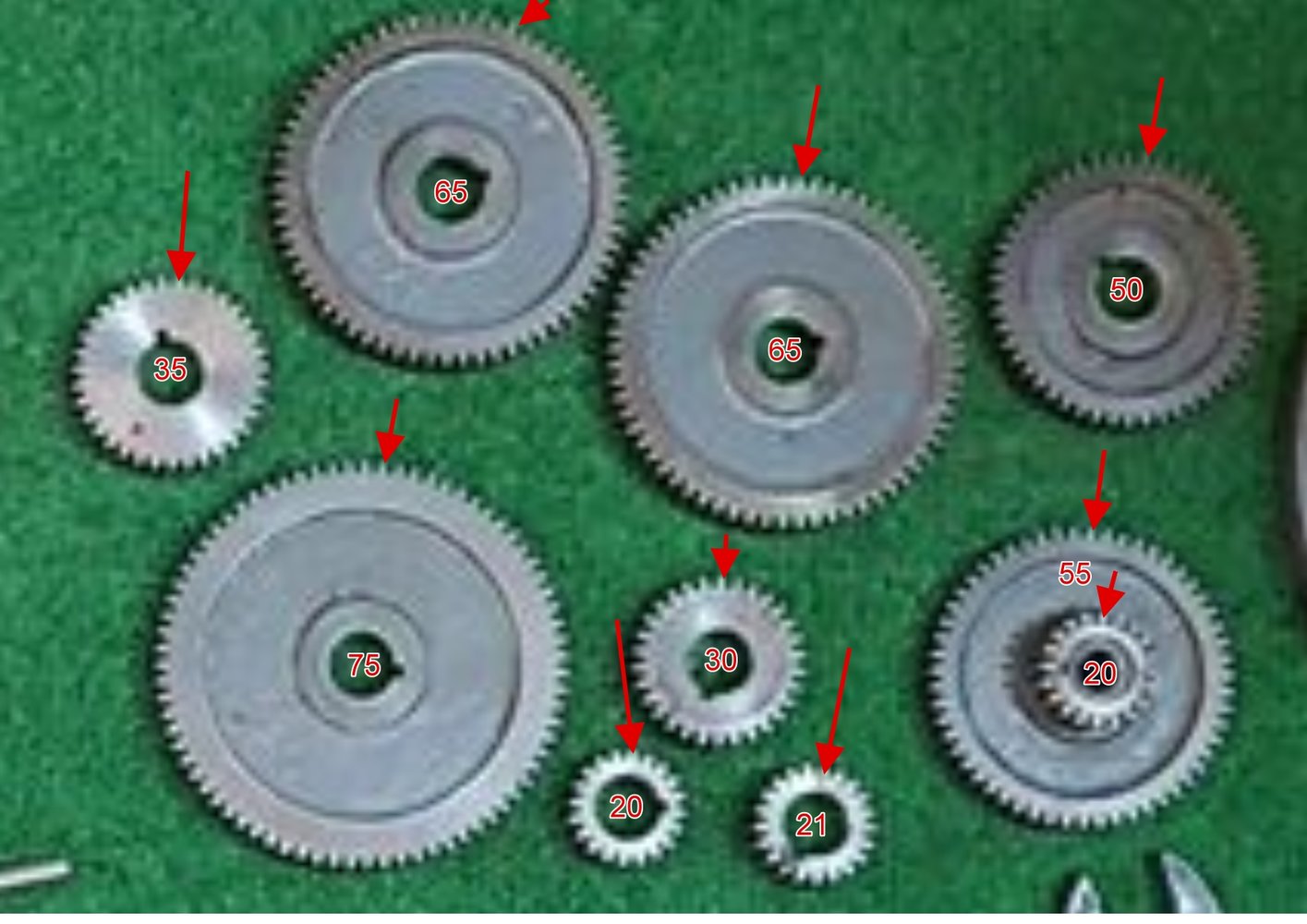

- How many change wheels must be in the accessories for the set to be complete?
I count 15 different gears in the thread table and see nine or ten gears in the picture of the accessories ... but there must also be some in the machine ...
- How much can one spend on this machine?
I know, everything is worth exactly as much as someone is willing to pay for it.
But what is realistic?
I don't think this violates any forum rules, it's not about a trade between participants here, but just estimations.
Thank you in advance for any advice,
Have a nice Sunday all,
Carsten
