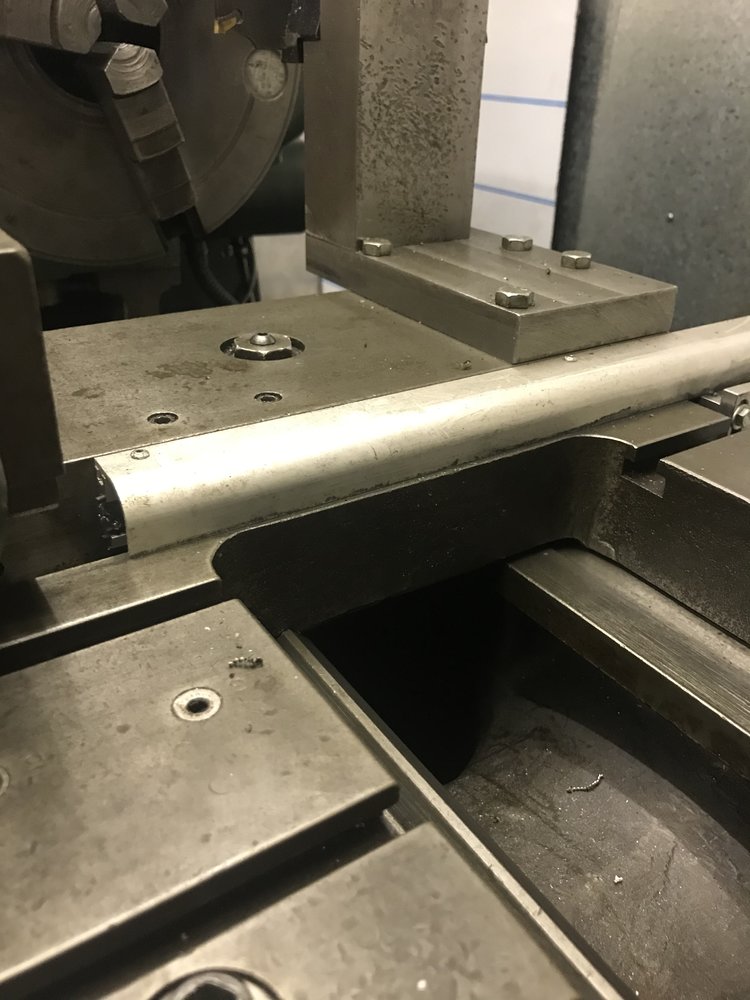

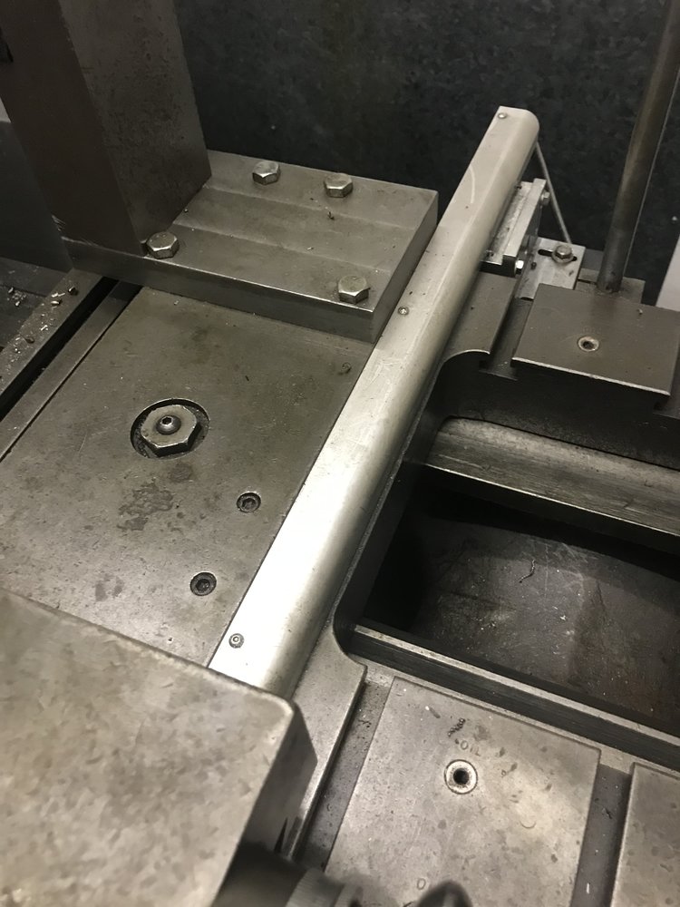

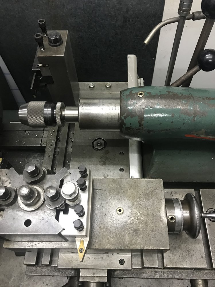

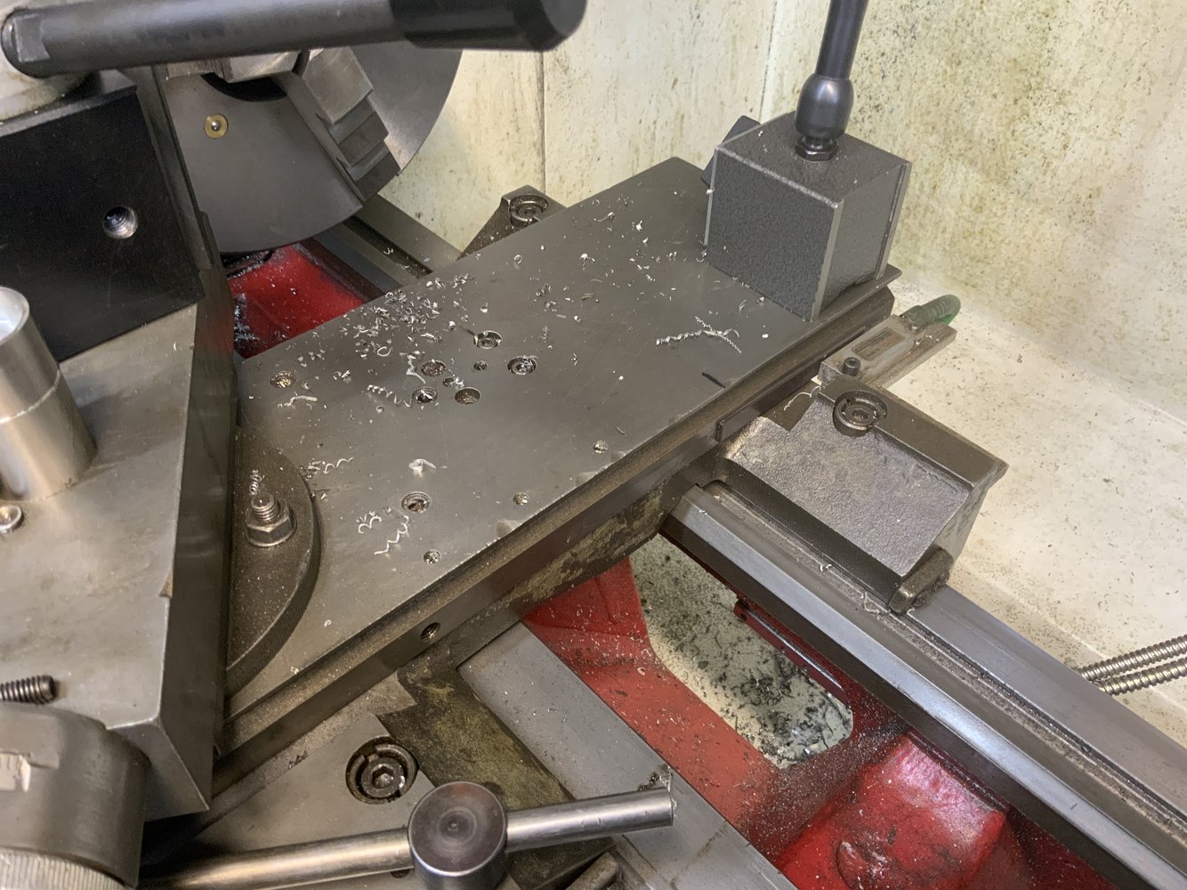

I fitted Mag strip to the M300 C/slide. You only need a bit. Doesnt go anywhere near the tailstock. Only problen is swarf If not covered. I'll do the same as on the TS and fit it to the underneath later this yr.If you have not yet ordered the DRO, perhaps have a little look at availability of dual dials for the machine. Nobilla Machine Tools might be a good place to start. Another option for long-travel is a Trav-a-dial (but they are not easy to find either).
I am not a big fan of DROs on a lathe: too much compromise on making them fit. The cross-slide one always seems to get in the way of the tailstock and the longitudinal one prevents use of a taper turning attachment or hydraulic copier.
The best I have seen is someone mounting a magnetic one under the cross slide. On a different machine I have seen a slimline Newall sphereosyn (maybe it was microsyn) on the back, co-existing with a taper attachment.
That’s how I do themIf its going to rob too much distance from the tailstock movement. The cross slide scale could be mounted to project into the splash tray, there's plenty of room And well out the way

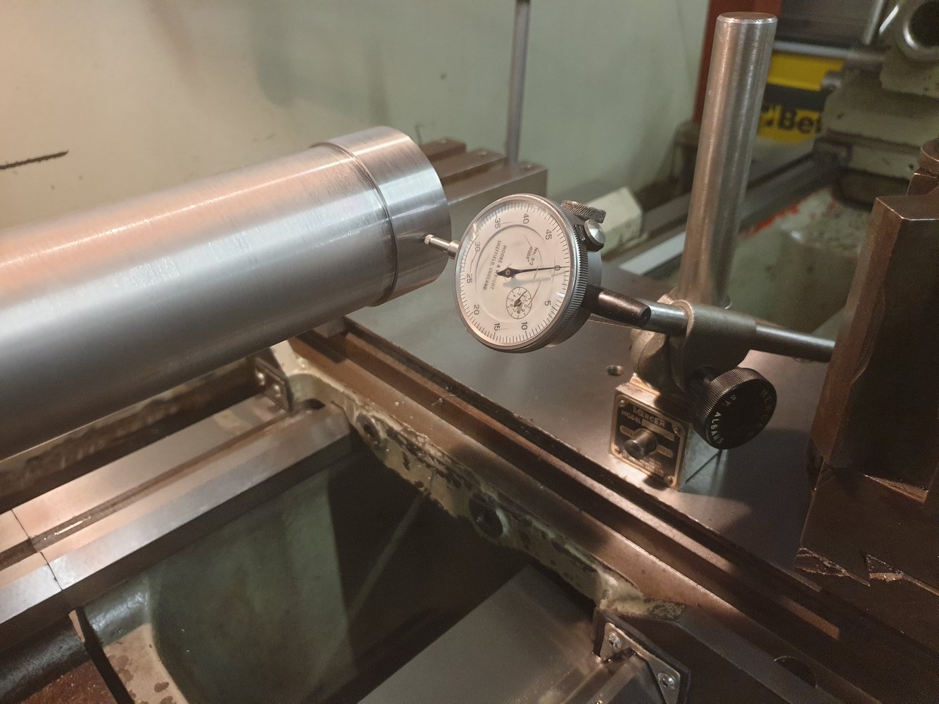

Run the clock along the test pieceI got an hour or so at it last night.
Changed tools, and took out the centre of the test bar down 5mm or so. Started to get a nicer finish with more speed and bigger DOC.

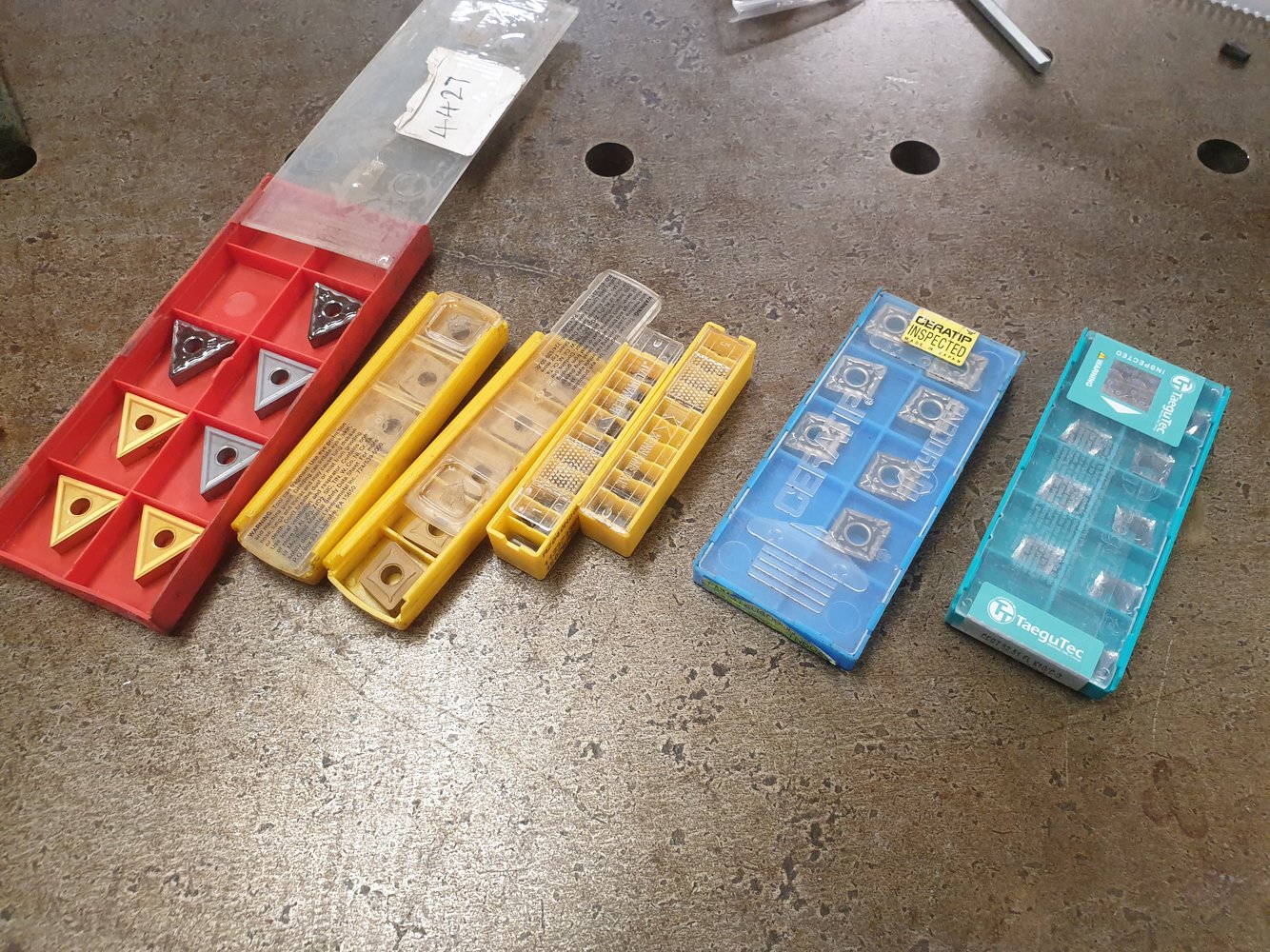

Now bear in mind, when I went crazy buying used tools and a load of inserts on ebay a while back, I knew nothing about ISO insert codes. I was just looking at the tool shape and making sure I could get replacement inserts,
The CNMG inserts I started with really don't like shallow cuts or low speeds, I understand now that they are a proper roughing insert, but the TNMG inserts seem much better, sharper edge and smaller radius.
Nothing to do with the insert shape code, just luck of the draw that I ended up with roughing CNMGs that hate small cuts
Now I'm starting to see what effect the built-up edge has on carbide at low speed/load... and what sort of inserts are better for what. Learning the ISO insert codes the hard way
I've ordered some CNMG finishing inserts for that tool, it's a general purpose left handed turning/facing tool and I ended up with two of them, so may as well leave one dedicated for light finishing.

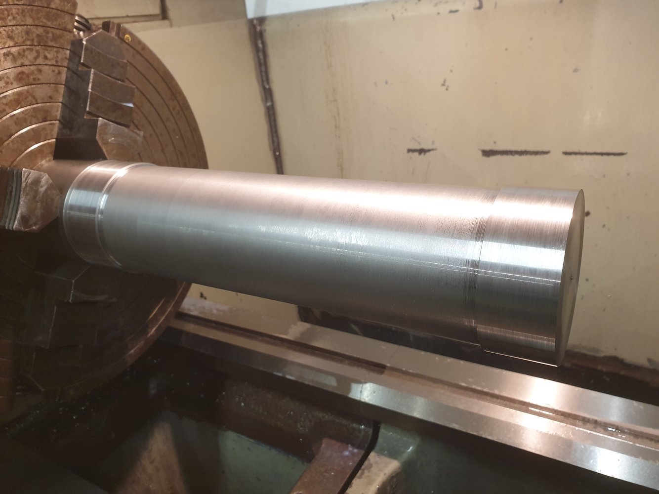

I then put my small boring bar in, it has some crazy sharp carbide Taegutec finishing inserts to go with it. Used this for the test shoulders.
500rpm, 2 thou DOC, 2 thou feed. Spring cut after first cut. Using my good mitutoyo mic and estimating the 0.00X.
First few cuts - much the same as before - 0.040mm big at free end.
Jacked up front right corner of lathe.
Next few cuts - 0.018mm big. Goes to show... short and stout lathes still can twist

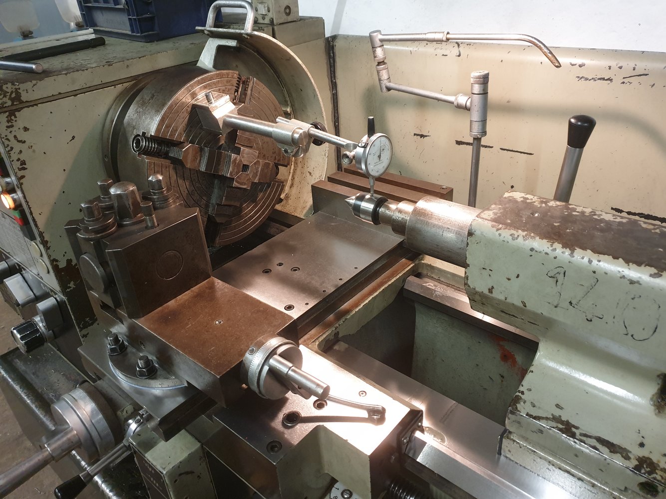

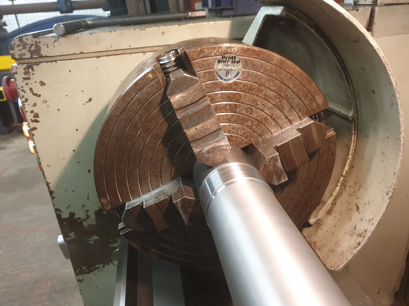

I'm going to talk to Brian and see what he would suggest, as I don't want twist in the bed. Will involve doing something very minute with the headstock probably. Even slackening the bolts, whacking with a hammer and re-seating it might make enough difference.

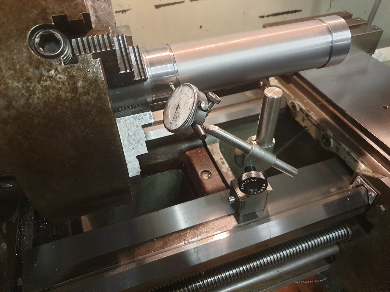

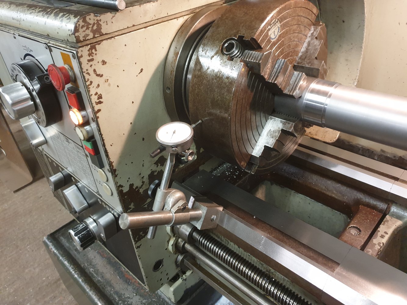

Fair playRun the clock along the test piece
If zero deviation then indeed the headstock is out
If the clock agrees with the micrometer readings then maybe some bearing play or chuck is allowing slight movement
Return your bed to levelFair play
My only clock isn't sensitive enough though... it would have to show in tenths and it only shows thous. Might have to buy that lever indicator sooner than later.
Plus it halved my error when I jacked up the corner? Or maybe that's over-compensating for the spindle.
The taper is very consistent, though. It shows pretty much the same on the relieved areas where I took much deeper cuts.
Thankfully the headstock bearings are OK and the chuck isn't (too)worn out.
