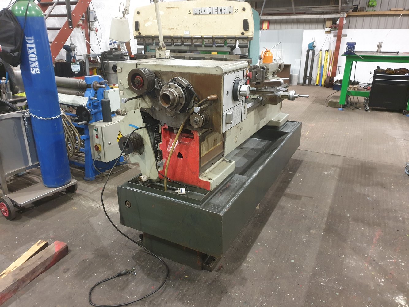

I know what number the chuck is, it has the original Pratt number stamped in. Its a 250mm iron super precision 3jaw.Rotagrip are excellent in this regard. if you can tell them the tooth pitch (they will explain how to measure them) and the slot dimensions.
I am confident they will be able to workout what number the chuck is.
alignment wise, I'll have to level the machine, take some test cuts, see if I can take anything out with the levelling feet, and shim/scrape the headstock as a very last resort.
