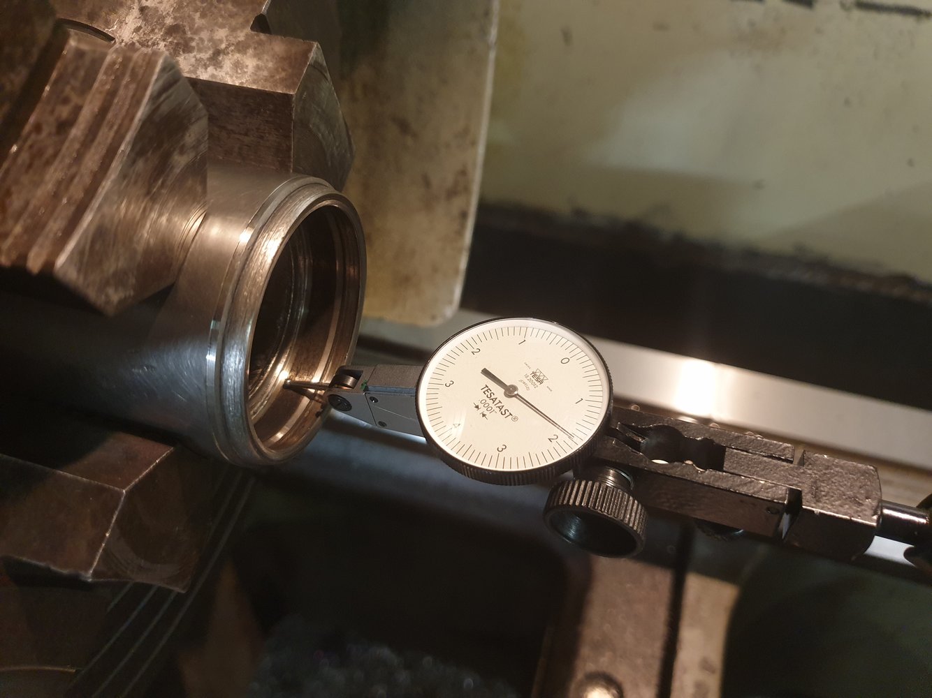

I used the 3jaw for the first one and it came out OK, but this one had a 3 or 4 thou runout between the OD and ID and I didn't have much spare material to skim off it so I had to clock it to the ID!Man, 4 jaws are for irregular shapes when you have an AutoStrong with soft jaws,

How about a simple tool-holder mount and use the tool height adjustment to line it up? A dovetail on the end of anything rectangular that will fit in your tool post.View attachment 293519
I have 3 DTI stands now... one "good" one that has a feeble magbase, one Mitutoyo with a damaged mag lever, and one "bad" china special which has the universal joint design... and it's the only one that can clamp the Tesa 8thou lever indicator, which is unfortunate cos the fine-adjust screw is too cheap to work properly. Bah.
I can see a Noga or similarly decent joint-style stand being bought soon... the problem being, trying to find one! Or I could get a dovetail mount for one of the others... for my needs it would be fine...
You still need an adjustable arm, as you only get 1" of height adjustment in the toolpost It's fine, I just need a dovetail mounting end for the Mitutoyo stand, and live with the broken lever (it doesn't affect function)How about a simple tool-holder mount and use the tool height adjustment to line it up? A dovetail on the end of anything rectangular that will fit in your tool post.
The Mercer stand has a feeble magbase but works well with the 1" DTI I have.
I hadn't thought of that... of course it makes sense! But I still like mag bases and arms, it's what I knowI have one that I've found it very useful, you can use centre height for inside and out! Just rotate the holder so that the indicator is facing you, an "1 of adjustment is ample!
