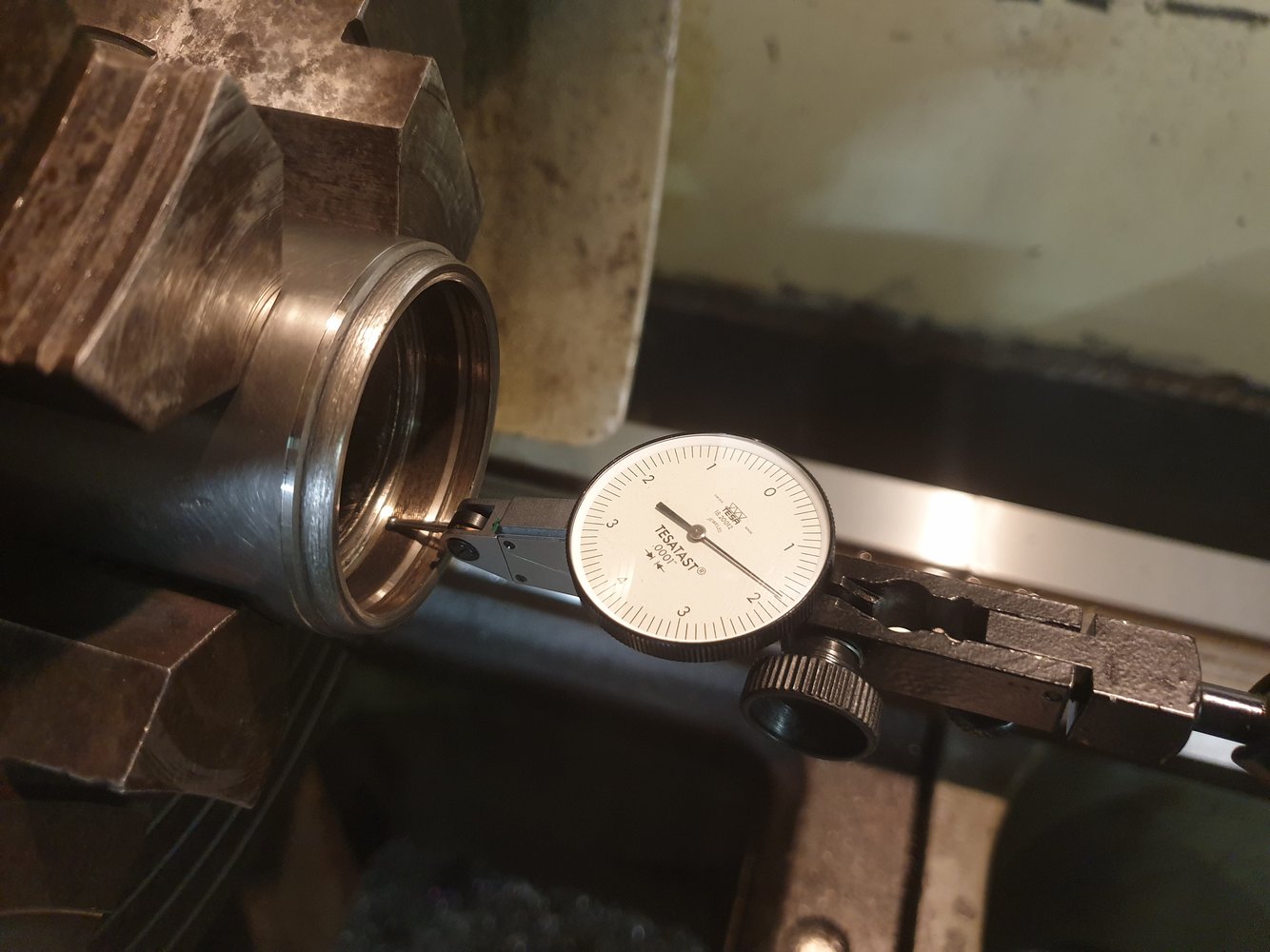

Try Indicate off the outside of a good sleeve. A stack of three in the tailstock is introducing plenty of room for errors.
if you need to sort the wear down the line you can either hard chrome the barrel Or bore the tailstock and fit a bronze liner, I think that’s an option.

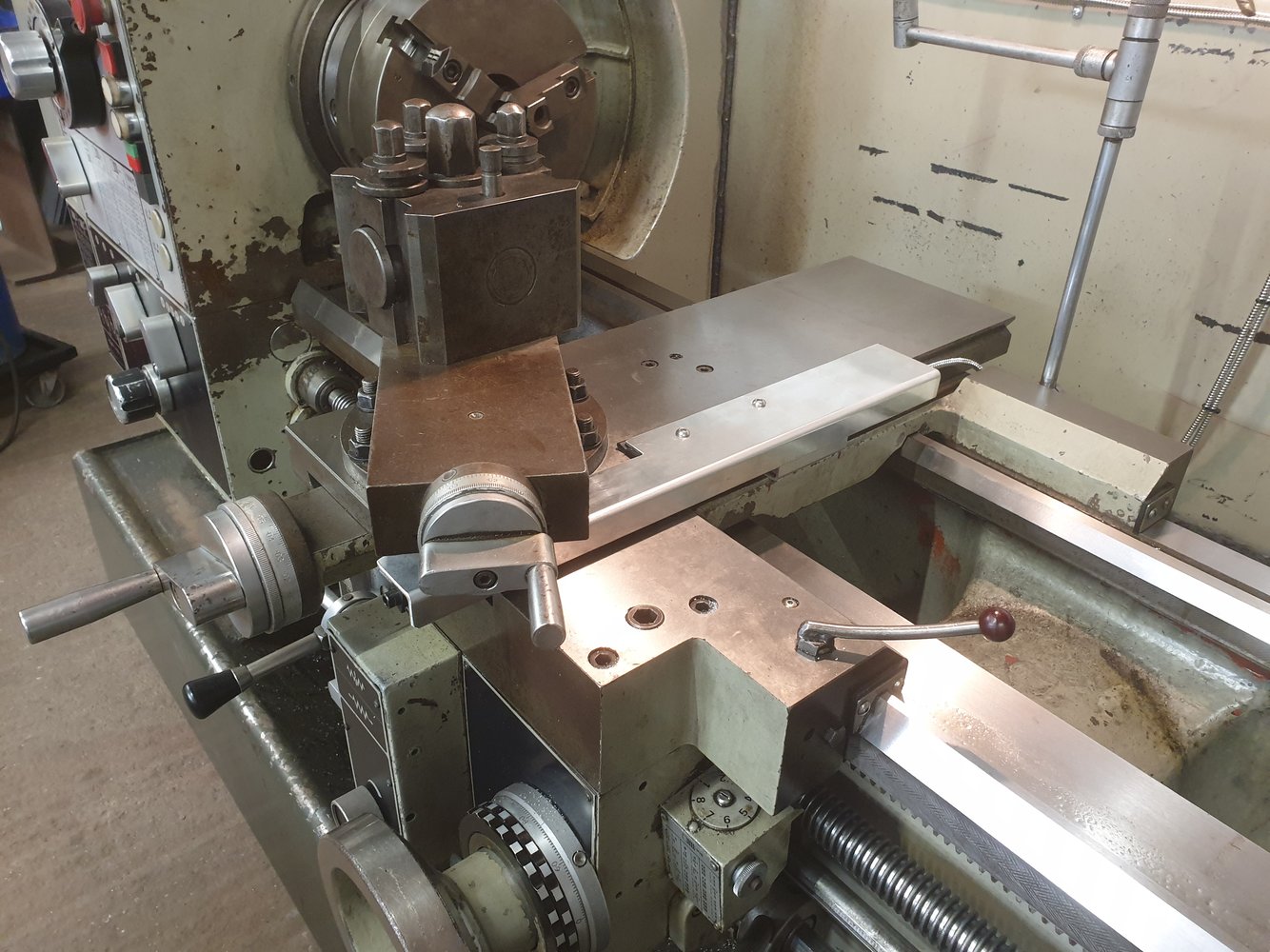

and fitted it.

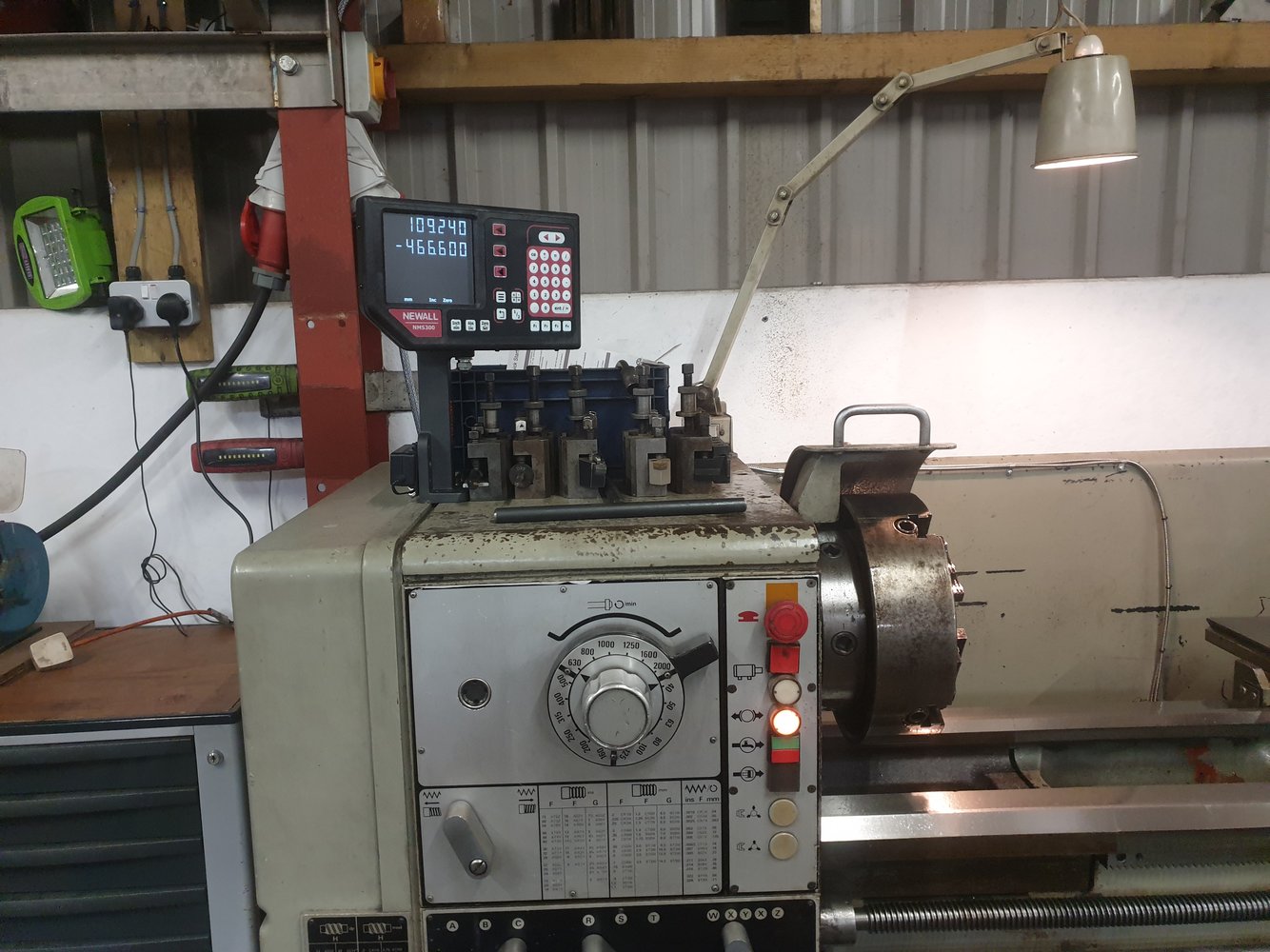

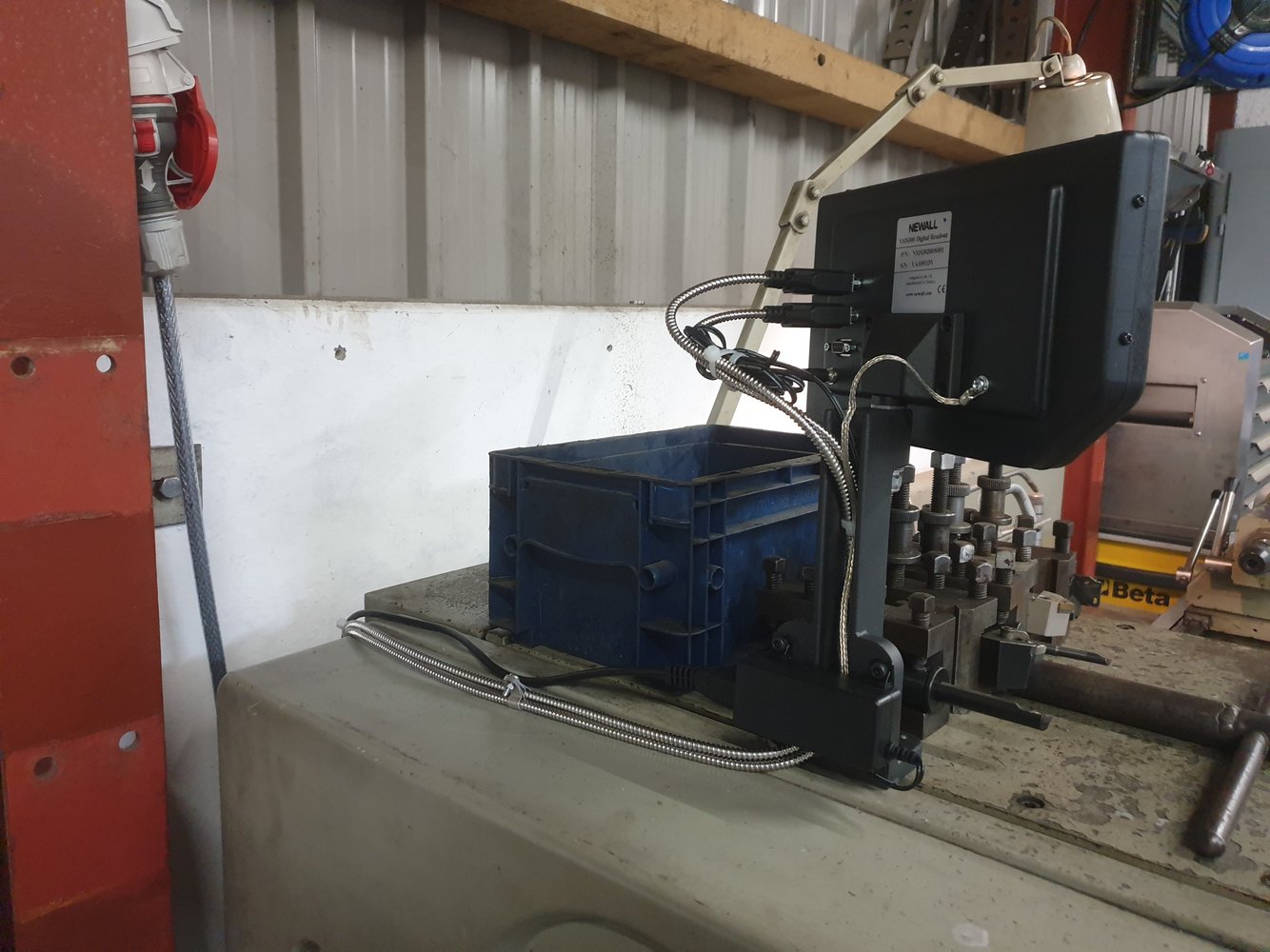

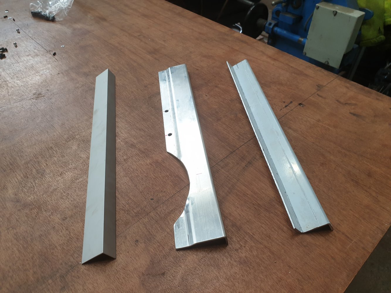

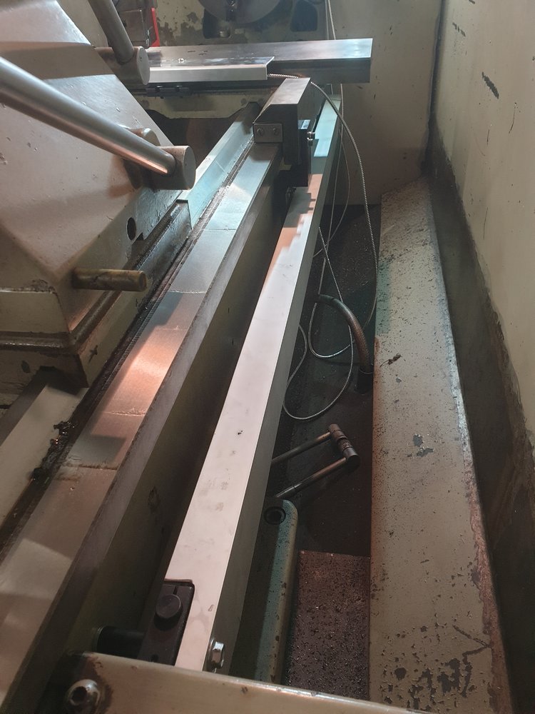

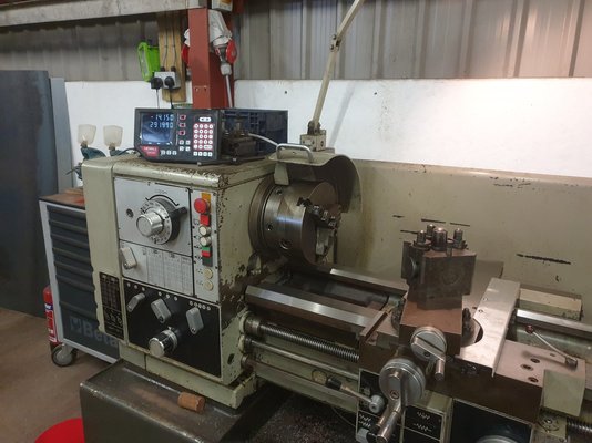

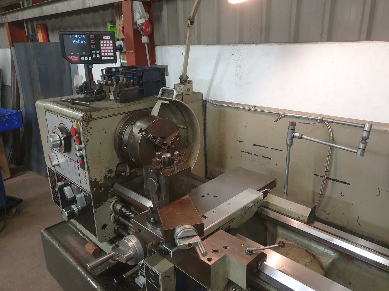

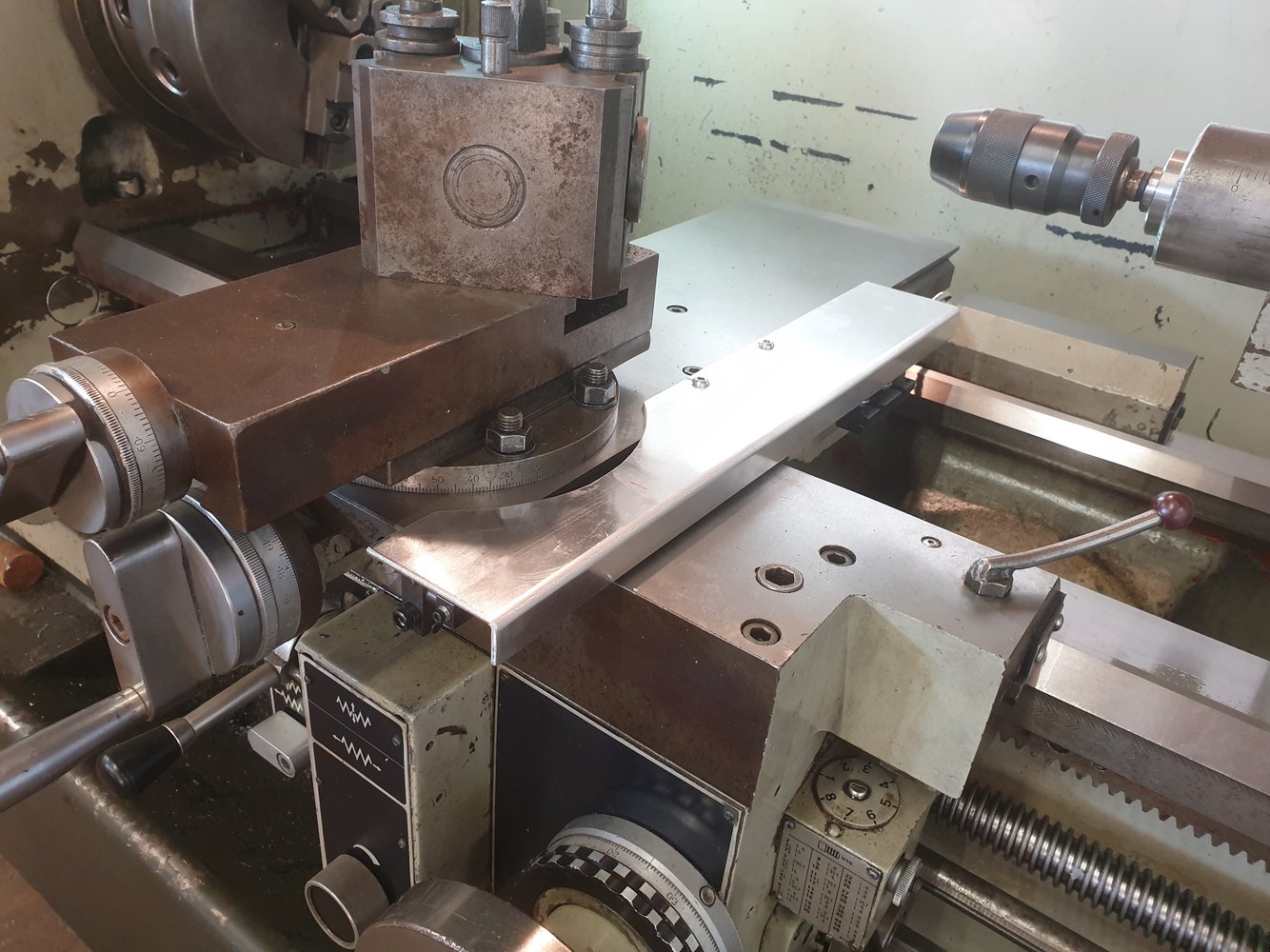

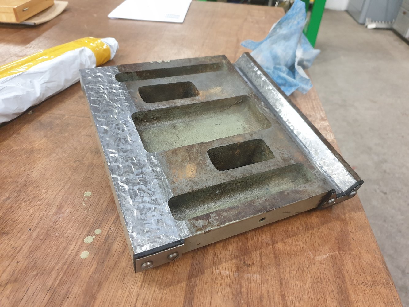

Part of the wait was because I asked for custom length scales. I should have made do, and in retrospect i could have got away with shorter on-the-shelf scales, but it wasn't much more cost, so... never mind.
Ah well, only took 10 mins
I see my mistake... Z axis!
