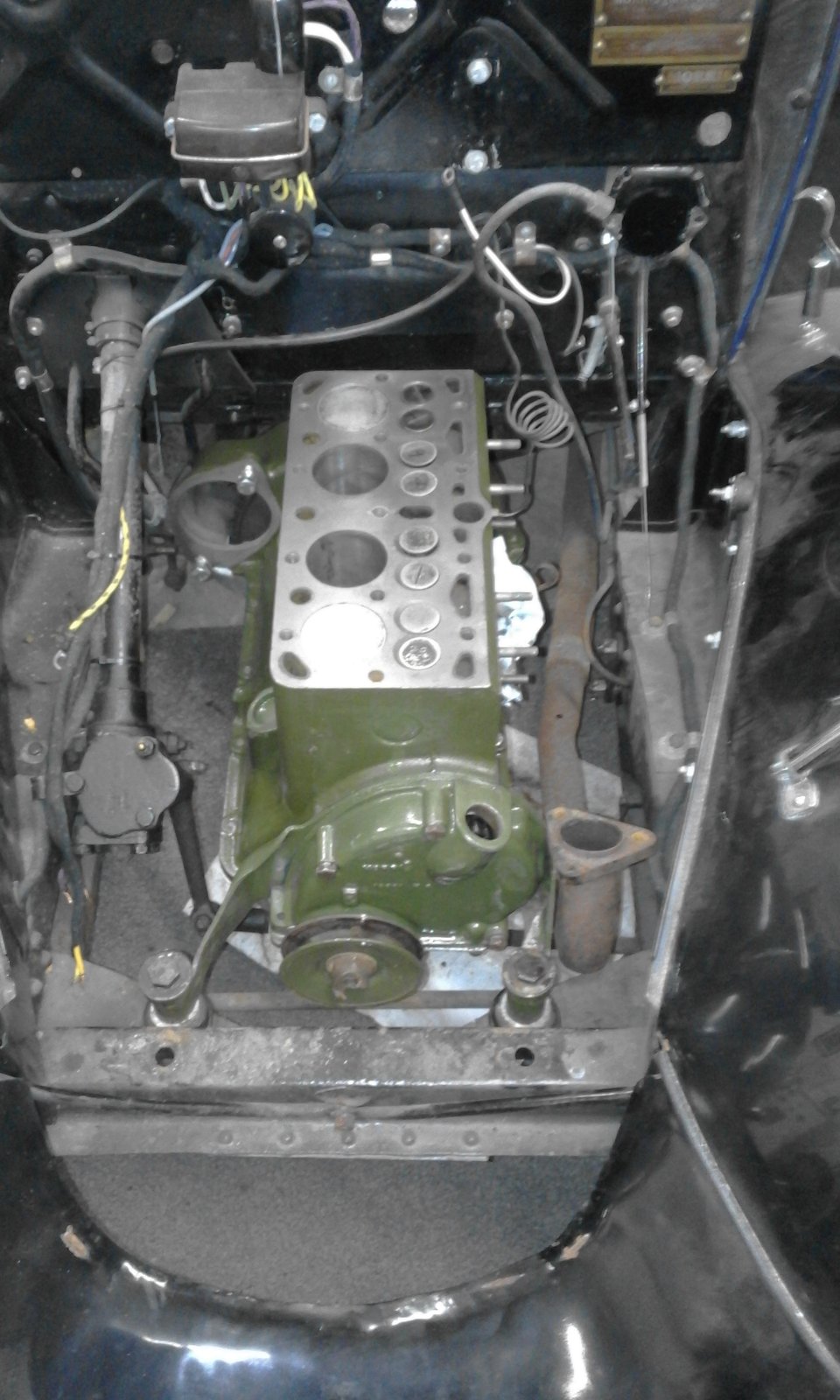

Glad you got the piston rings in OK . At least the valve clearances are adjustable unlike some of the old Ford sidevalve engines , they had a lump on the tip of the valve and used split valve guides, to reduce clearance you recut/lapped the valve /seat To increase clearance you removed the split guide to get the valve out then reduced the length of the valve.

2 bearing crank, daft idea. Three, now that's the answer....
I seem to recall, early 7’s were 2 bearing & later ones were 3. The 2 bearing ones, if you were tuning it, you shaved the middle 2 piston tops to take up the crank whip at revs. I’ve never had or taken apart a 7, just what I was told by those that had. I’m sure someone will be along soon with the full story.There you go, I allways thought they were 2 bearing. Learn something every day

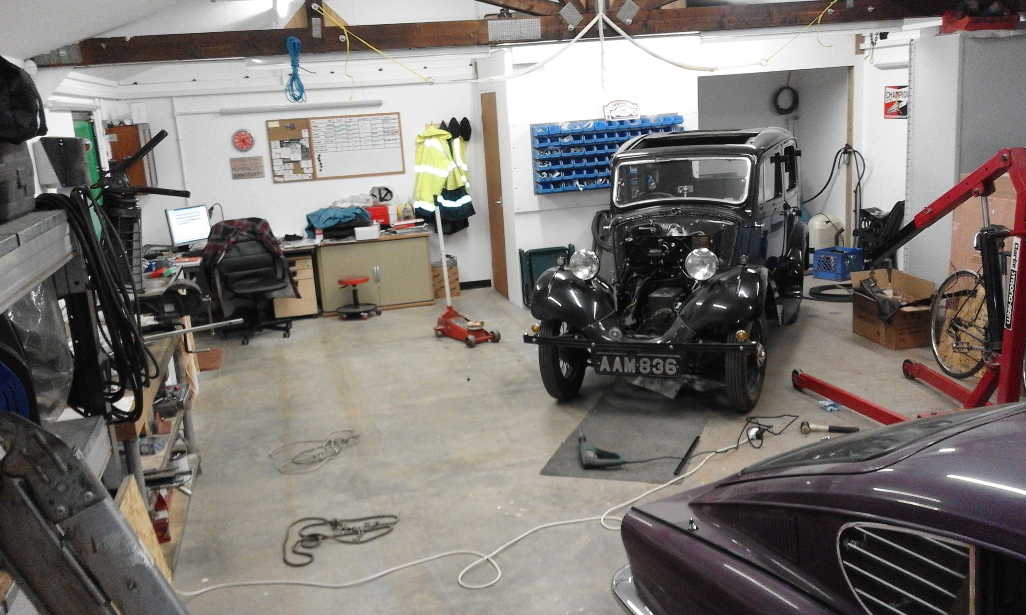

@RWD3M Is that a GT6 lurking there?
