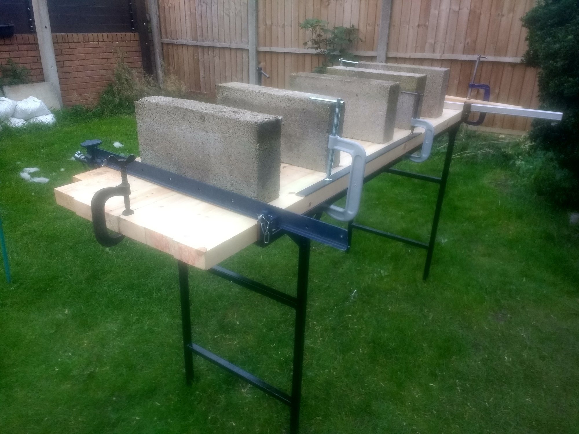

    Still not got enough clamps tho :doh:

    Cheers lads, been collecting clamps for years
    Timber was not expensive really. Bought 5x 4x2 planed all round, 2 metres long, and 1 3x2 same length. Cane to £33
    Think might actually be cheaper than b&q stuff i was going to use
    Told lad at timber yard looking to make a bench top and he did his best re flat pieces.

    A couple of lengths of timber shorter than the width of the top. One each at the top and bottom. Making a sandwich arrangement. Clamp the perpendicular bearers to the two edge pieces and then use some strapping across the perpendicular bearers to make a tourniquet arrangement to clamp together. Probably could have done the whole lot in one go. The perpendicular timber prevents the boards from curling up

    Good suggestion re timber to sandwhich it down.
    Cant make it all in one go however, only got 3 clamps wide enough. And one of those is aluminium and doesn't exert half as much force.
    So for now making two halves that have been clamped as much as possible. Then buy or make more long steel clamps.

    Tempted to make them but even then it means buying a sacrificial g clamp of decent quality for each one. Looked into coarse threaded bar and nuts, g clamps cheaper., about £4
    Like your suggestion Parm but i think i more confidence in the pressure obtained from g clamps than strapping like ratchet straps.
    With steel underneath wood being laminated and protective wooden offcuts across the top, you can really muller the clamps
    Got a good result Saturday :thumbup:

    You shouldn't really be doing a Geoff Capes on the clamps !!
    Too much pressure applied will just squeeze out all the expensive glue that you are using.
    Its the glue that sticks the wood not the pressure from the clamp !!!
    Light pressure to keep them all together and aligned is all that's required

    I get your point re glue n wedges lads, but that's all easier if every single piece perfectly square along full length
    Some of these had slight pulls one direction or another. Dont think wedges alone would close gaps enough for glue to do its stuff
    Hence brute force lol. No point being a northern gallute if ya cant bend a 4x2 now n then :drunk:
    Thankfully the two halves done now, next gonna make some "Capes" clamps to fasten them together
    Seems like frame strong enough.
    Finished painting the frame yesterday and got holes drilled for securing the top, will use 8mmx30mm coach screws
    Hoping tmw to trim top to size, sand it free of pencil marks etc
    Next few days treat it and get it into shed.
    Hopefully next photo is finished item

    Worse thing about using breeze blocks as weights is touching the slug that was at home on one of them
