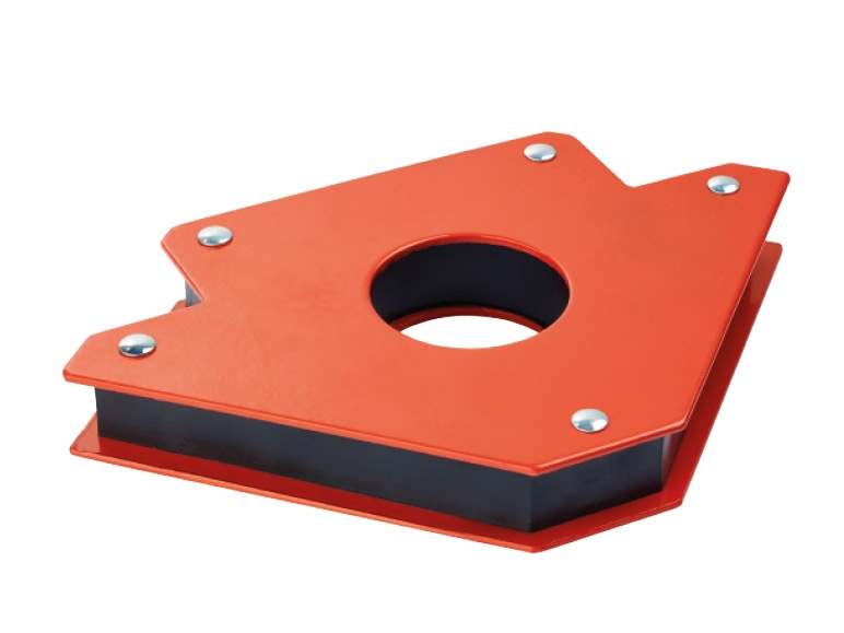

    those magnets are fun to use arnt they lol
    there also fun to get off your metal after use as well
    i got 3 of them when i had the chance a good buy at that

    Lidl magnets are the future. Today was the triangle ones. But the two rectangles on a bracket even stronger, much stronger !
    Gonna use them when i can pry them off girder in garage :doh:

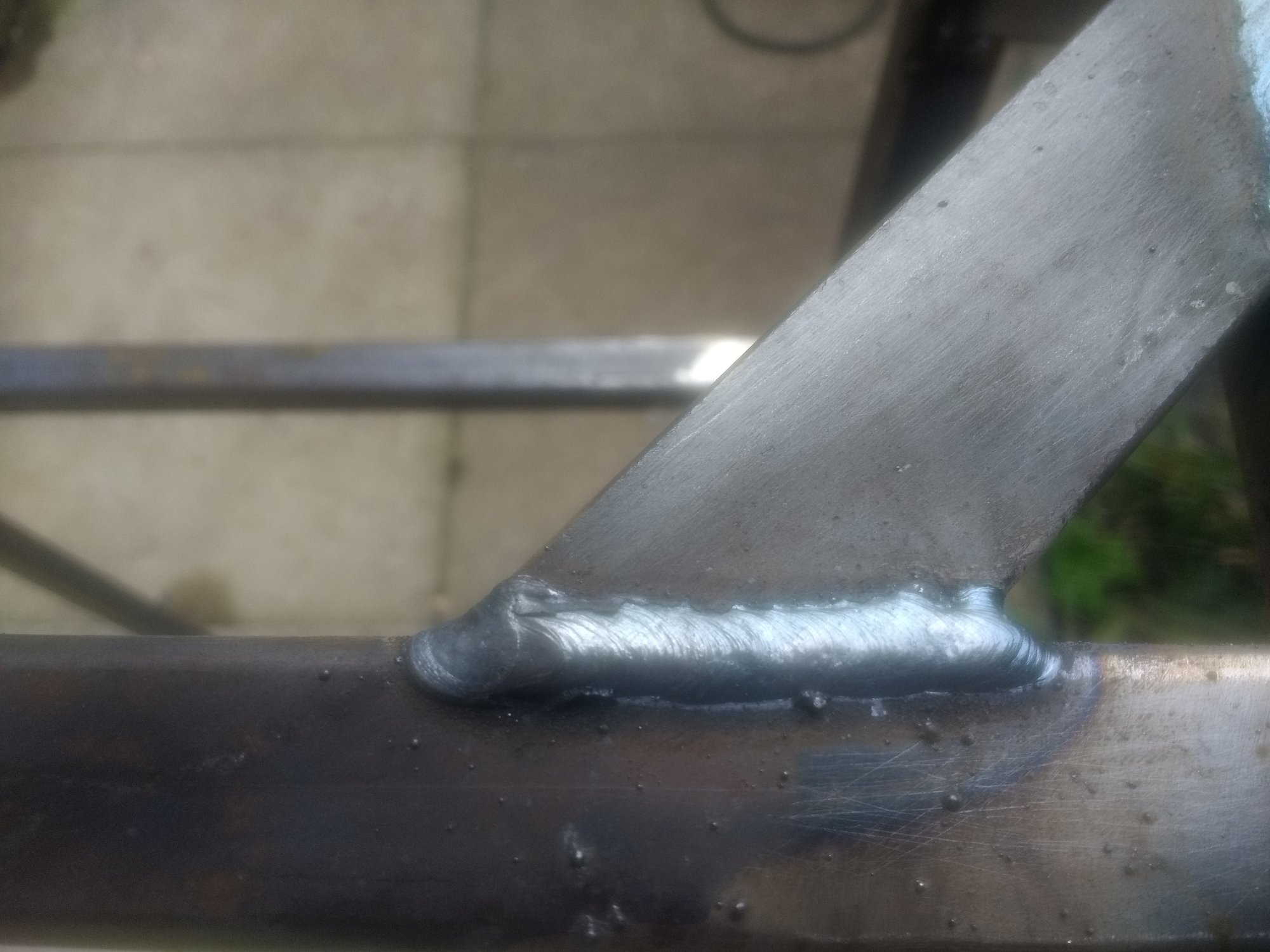

    This one a bit better, tho still need to practice wrapping the weld round corners at start and end
    Think i did this one a little slow, maybe a bit high as a result which is more grinding.
    But i did take time to ensure it was flowing down into yhe joint, probably just too long

    Didn't even know Lidl did welders magnets; will have to have a look for them.
    I've got 4 little ones from Ebay; only used the one and liked it so much I ordered another 3, so much easier than trying to balance things or clamp with the return clamp which is what I was doing before.

    Lidl seem to have them in every 3 months or so,,about £4 each if i remember. Very strong, reckon excellent value for the price
    But lesson learned today. Uptil now been wondering what folk was on about, now i know lol
    Sort of curious how they will affect a MIG arc. Guessing it maybe even bigger effect

    Use the magnets to tack, then move the magnet to finish welding.

    Yeah, that's what i akways did....til LIdl magnets. It was the tack that got blown away

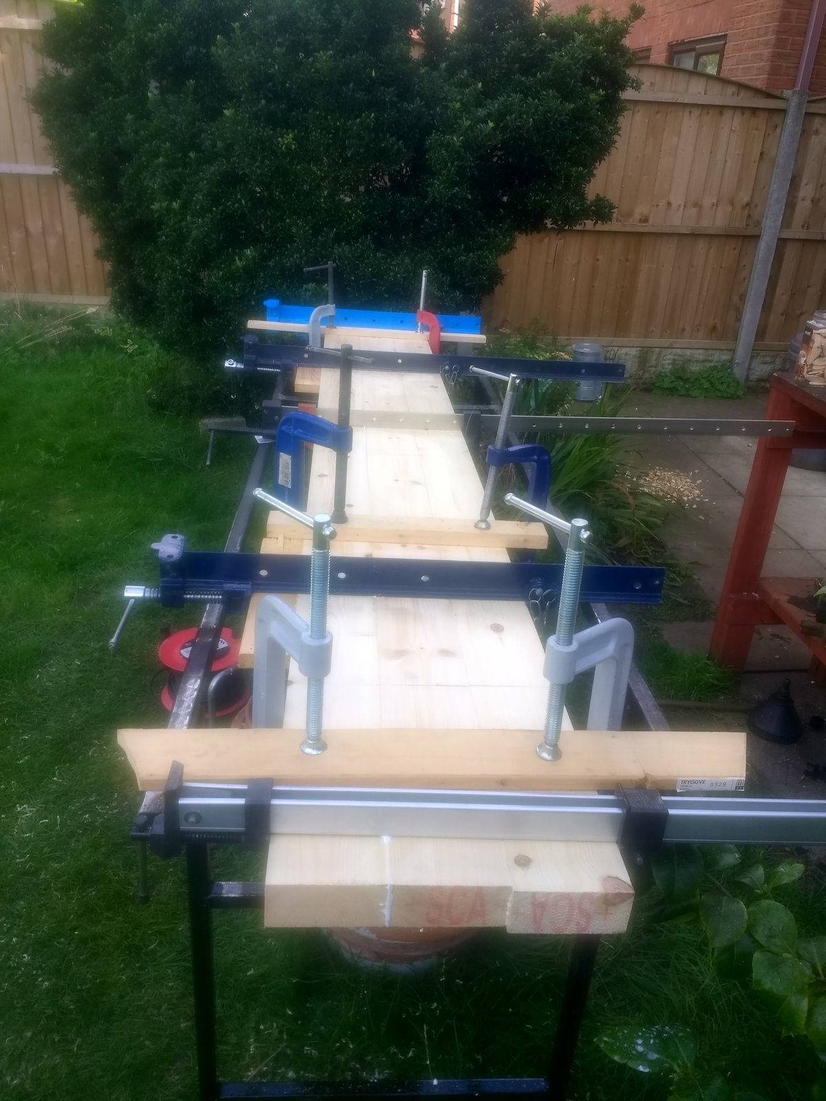

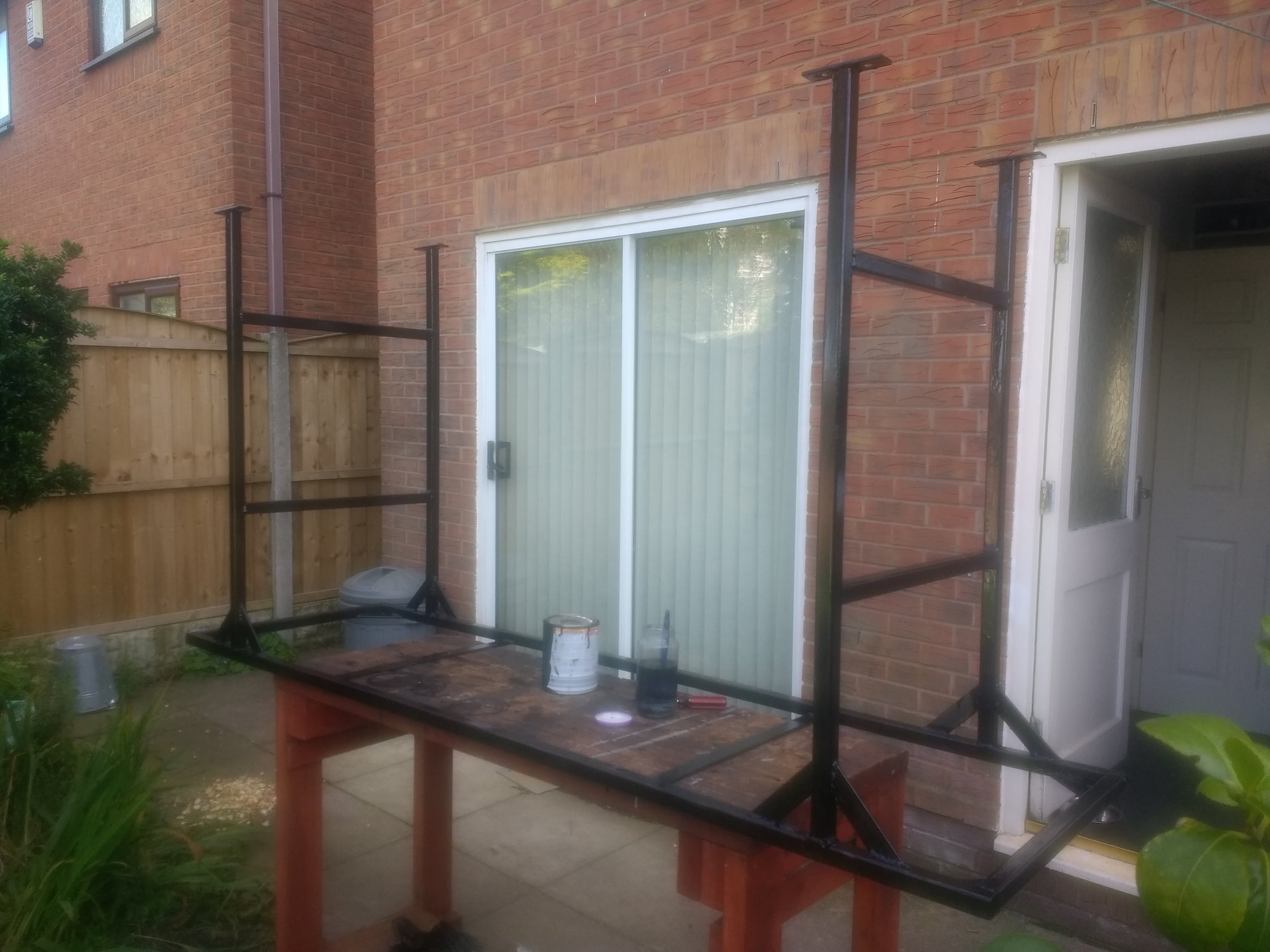

    Frame finished and most of painting done, decent weather this afternoon
    Hopefully this weekend will get the wood to make the top. Will be same type top as little bench the frame is resting on.
    Good excuse to buy a couple more clamps too
    Does anyone know how well PVA wood glue lasts, know I've got some outdoor graded stuff somewhere
    But must be 3 yrs or more IMG_20190913_153610539.jpg since used it
    Yamhon likes this.
  15. Yamhon
    Yamhon Member
    Messages:
    667
    Location:
    Yorkshire, UK
    Don't know how long it lasts, but all of the makers I know use Titebond 3 for outdoor applications. I used some recently, seems to work well, but it's quite runny and takes longer to go tacky than the indoor products, if you're gluing a large area I'd recommend using a sponge or glue brush to spread the glue out.

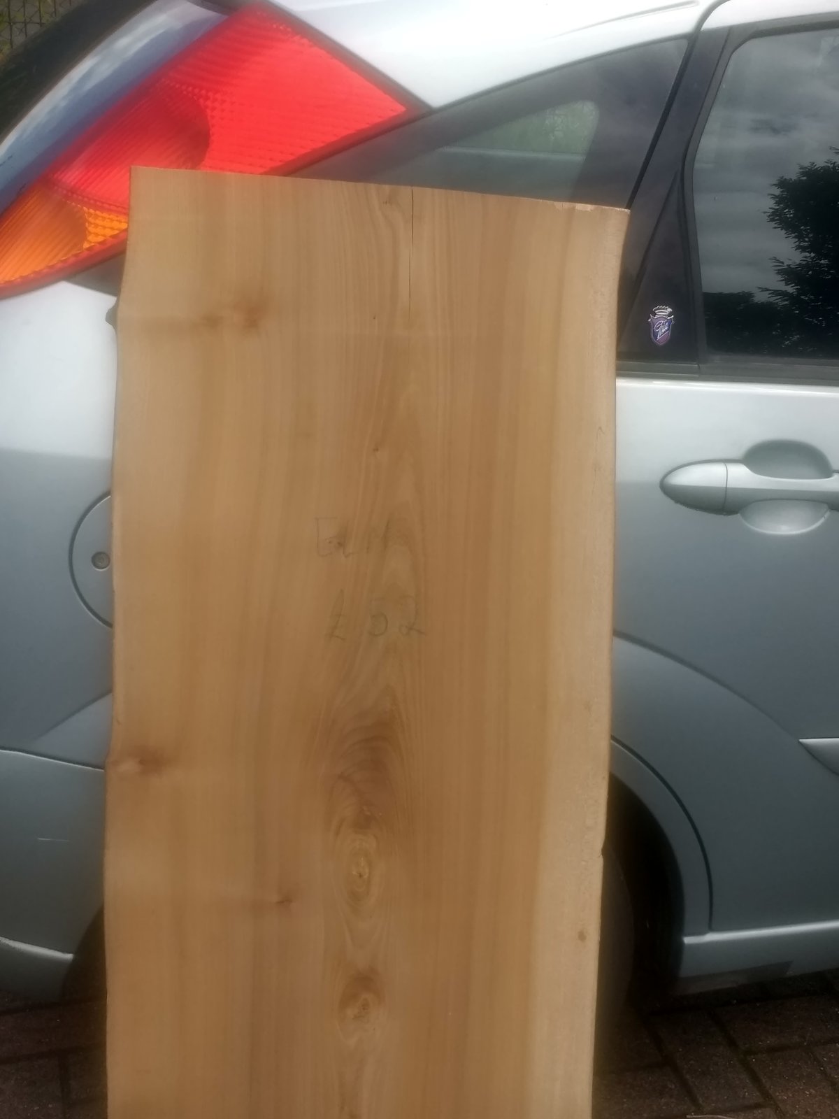

    Seen this slab of Elm there and instantly had at least four projects it could be used for, not decided yet, coffee table favourite IMG_20190618_122207634_HDR.jpg
    Was £50 but is a proper chunk of wood, about 3cm thick

    First half of top getting glued and clamped. Brushed glue on like ya suggested Yamhon. Using frame its for to glue on as it allows ya to clamp down as well as across, unexpected bonus IMG_20190914_143800853_HDR.jpg
