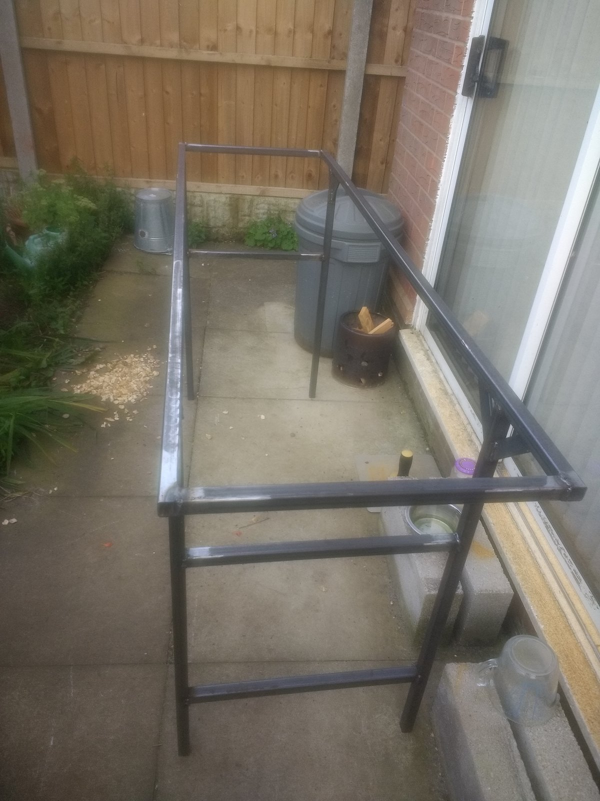

    Seemed like a great day for a bit of outdoor MIG today, nice n dry, gentle winds
    So thought I'd make a little progress on workbench for shed, this has been welded with Arc til today
    Photo below is how project left as i knocked off for the day

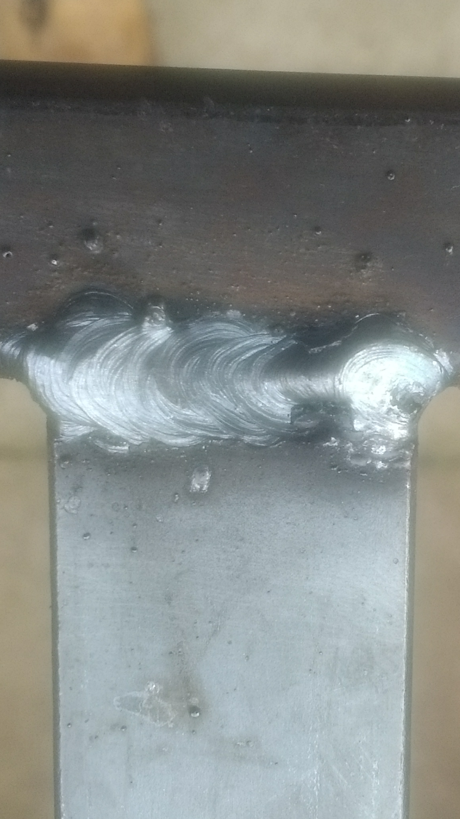

    Overall so far I'm happier with the Arc welds ive done. Not that they are great, just that they are more consistent to each other and I'm confident with them
    The MIG welds kept catching me out, do a couple I'd accept for what the project is....then rubbish to be polite
    Obviously I'm learning and will persevere, but did as many mistakes on the flat as i did vertical, which to me is odd :doh:
    Think i need to finesse wire feed speed a little more, will get there
    Do love the speed of progress with MIG tho, no chipping etc, and tacks super fast to do
    Going to finish this bench with MIG only, practice only way to learn eh !
    Need another horizontal brace on leg pair at far end and considering 2 lengthwise braces between the two sets of legs
    That said its already sturdy, especially compared to battered wood bench i built it on
    If i get drunk in the week will share dogs mess welds from today :laughing:

    Is it me or do the far legs look bowed,i see you've put a cross brace on the near ones they look straight,bang one in on the other side;)

    Its 25mmx25mmx3mm box. Its just over 6ft long and 21inchs wide. Height 38 inches? Forgot lol.
    Far legs are a little bowed, thats why i plan the extra brace mentioned. Same thing happened to near legs before second brace.
    Not that it shows in photo, but top bows a little too on outside edge of each pair of legs. Tried to minimise distortion but hey ho
    For top i plan to make a laminated wood top, probably CLS timber from b&q, cheap n cheerful
    My wooden bench that lived outside for a few years and had a hard life same top. Still doing ok
    Its strong but this bench wont be used for anything very heavy, definitely nothing like an engine

    But, if that was my frame, I’d put some feet on those legs, prevent them from biting into the floor substrate if your giving it any welly on the surface. Appropriate size and thickness washers might be ideal, think penny washers or similar. You may already be planning this

    Yes, its getting feet, they will be used to fasten bench to wooden floor of shed
    The top of frame will be fitted with flat bar cross braces and flat bar corner diagonal pieces
    These will be drilled and used to screw top down on the frame. I'll post pics when done
    And the horizontal braces on each pair of legs will support shelving

    Always a good test, but I’d put some more legs on it to stop it flexing. 6’ is quite a long bench with only legs at the corners

    Dont Dhink it'd survive mate, , I'm 118kg. I shouldn't be, but i am haha
    Fifty odd years of pies n pints :thumbup:
    Re distortion I'm sort of at a loss how to stop it with small box section. Tried clamping down, sequence etc
    If anyone any tips or advice at what sort if size it reduces that would be good
    Think it might be less with 40mm square like Yahmon is planning

    Bit short on time today so used stick. Saved lugging MIG out.
    Most welds went ok but had my first weld affected by magnet. New ones from Lidl much stronger than old Draper n Aldi ones.
    Bought them few months ago but not used til today, never experienced that before but read about it.
    Arc bounced sideways with a proper loud pop sound and threw my concentration a bit. Moved magnet but still messed it up
