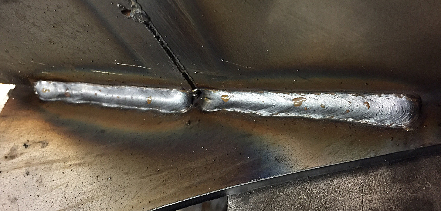

    Possibly, not asked that yet.
    The main issue is that it was (so far) a one-off incident and has now magically cured itself.
    I have just got back from a trip up the road from the day-job to an engineering company that i knew did welding albeit much higher current stuff.
    The guy had never seen a flare-up or heard of it, his suggestions were gas related - contaminated, flow level, poor regulation. Suggested another bottle but this one is only 50% so would be a waste if it were not gas, I do have a bit of Co2 left which might help diagnose if it does it again.
    I will look into a good 2-stage regulator.

    Well, had some more play time,
    I tried deliberately backing the wirefeed off so it stalled and stuttered and that was exactly what it did - the weld was stuttery, but she still welded a bead! It was nothing like the fault in question so i know its not a WF issue.
    Next i returned the WF to normal, tested it and all was OK.
    Moving on, i turned the gas down to silly levels, at zero the weld was as porous as a sponge but from 1lpm upwards to 15lpm+ it made perfectly acceptable welds - i was surprised how well it worked at 1lpm but this is indoors so no draught etc.
    I put all settings back to normal - for me that's about 6-8lpm and made what i consider to be two perfectly acceptable fillets...
    I have no idea at all what was going on - from searching the 'net i see only "flare-ups" in relation to TIG welding and a electrode contamination, nothing in relation to MIG
    at all.
    I did see a post that said gasses can settle out if not used - my cylinder had been standing for a good few months without being moved so i gave it a good shake up just in case :)

    If it welds like that at one lm my thoughts are your reg. is fuba.

    The thing is though Dave, if you turn the wire feed down the welder adjusts for that, with the wire sticking due to a tight tip (spatter/hot/deformed) then it may not be the same as simply turning the feed down.
    I used to get a similar flaring arcs when using the previous Migs, all Aluminium of course as that is all I use the Mig for. But when the tip was coming near the end of its life due to the high temps of Alu welding then the wire would start sticking and not feed properly and start to burn back towards the tip and you would get a wide bright flaring arc.
    Obviously you have not done enough welding to wear out a tip yet so that is why I was thinking that some spatter had blocked the tip a bit and was slowing the wire feed.

    Been a while but my problems has returned - the weld changes from normal to flare-up. This is now on the ESAB Rebel so its the same fault i got rid of the R-Tech for!
    The one constant is the gas - still on Argoshield light.
    I am half-bottle now and thats about where the issue starts, I have now found a way out though - stop welding (not much choice really) take that gas bottle, shake it as hard as possible by tipping from vertical to floor and back a few times, run a few beads on waste metal and get back to work.
    As far as i am concerned the gas is crap - I don't use much, about a Y cylinder per year, but it seems it settles out and really makes a mess.
    Its not air getting in as the gauges will stay up for weeks on end so the system is tight, the welder is new, torch is new, wire is ESAB new.
    Its the BOC gas.
    Question is - what do i change to?
    I want nice clean welds with low spatter.

    You're using a bottle a year. That's your problem right there. The gas is settling out or going above the dew point.
    You need to go over to an X size bottle.
    Or roll your bottle across the floor before you start welding!

    Not really a newbie - been messing for about 5 years now, no professional though.
    The torch is the standard Rebel supply, not sure on the number but it takes common tips and nozzles.
    The flow is about 9-10lpm set on a proper flow gauge, wire feed is good etc. I did very extensive tests when this happened on my old welder and in the end just bought a new one!
    Yes, a bottle a year - i will look into X size but not sure if BOC do them on the special (volkzone) hobby deal??
    If not then maybe change to another supplier - can't remember the name but the bottles are yellow/green IIRC
    I was told many times that the gas doe not settle but my simple shake test proves otherwise i think.
    There are no gas leaks pre-welder as the lines will stay pressurised for weeks with gas off, if it was after the welder so in the torch line it would do it all the time - this is intermittent.
