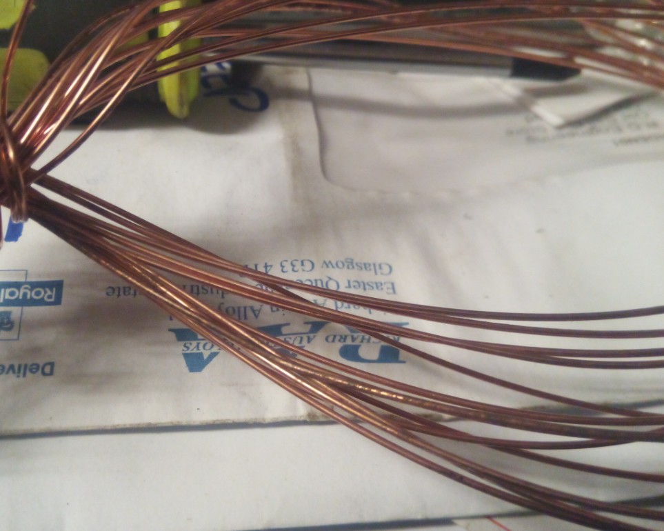

    Just dragging this up for an update.
    The problem with the flare-ups is most definitely a wire-feed issue so thanks to all those that suggested wire-feed.
    On Friday i had another flare-up, mid-weld and the usual bacon sizzle was replaced with a bright flame and loud hissing noise, i managed to drag the torch back about 1" before it went out and was pretty surprised at that.
    On investigation i had zero wire-feed, turns out the roll had finished and the end had snagged on the core so it stopped abruptly.
    What i can't figure out is how there was enough voltage to draw a 1" flame and maintain it, it was damn hot too, loud and smokey.
    So my previous issues seem to be either poor wire - tangled/catching on unwind or my feed tension is way too low - either is an easy fix, a new roll was fitted, new tip and not happened yet.
    Maybe i am pushing tips too far - what's the life expectancy of a 0.8mm mig tip in terms of 5Kg rolls of wire to the tip ratio???

    Well it’s not a wire feed issue if you’ve run out of wire.
    These flare ups? It’s just the wire burning back to the tip? And then melting the end of the tip?
    Tips and wire get hot, and sometimes they just get stuck. Air cooled setups being used at the limits of their duty cycle will be more obvious.

    No, the wire stopped but the flame/arc kept going permanently - i managed to stretch it out to about an inch and for about 10-15 seconds, pretty much like a carbon arc would but the flame was green/yellow not white.
    The tip/torch would be practically cold as only the 2nd weld of about 30mm long.

    The welder doesn’t know when the wire has run out, so of course the arc continued if you had your finger on the button

    yes what i am trying to ask i guess is how was that arc maintained - there is not enough voltage to bridge a 1" gap, i thought the gas was inert apart from the 5%? oxygen?
    Arcs need voltage & current, yes the current is there but its only what? 140v?
  13. Brad93
    Brad93 M J B Engineering
    Messages:
    8,508
    Location:
    Essex
    A good TIG will hold a 1” gap and that’s at 100A and 18V
    easy for a Mig with up to 27V to play with.
    Davek0974 likes this.

    The gas ionises and aids conductivity. This is why a tig’s HF often appears to be unable to jump from the tungsten to the workpiece if you forget to turn on the shielding gas.

    Tips last a very long time if you are rolling work about on a bench, not so long if you start cranking up the amps and doing overhead, vertical up/down or anywhere torch angle is compromised. Keeping the shroud clean helps tip life.

    As does tightening the tip up with pliers or a spanner so it doesn’t overheat.

    50% of feed issues and tips not lasting is down to this.

    anecdotally: i found when I was welding 10-20mm steels all day every day, I was having to tighten my tip up every hour or so. Lasted weeks between changes, even with heaps of positional welding thrown into the mix.
    now in the habit of checking every so often!

    My old boc mig was machine gunning a couple of days ago, worked out the tip was loose. Tightened it - hey presto all of 150A again...
